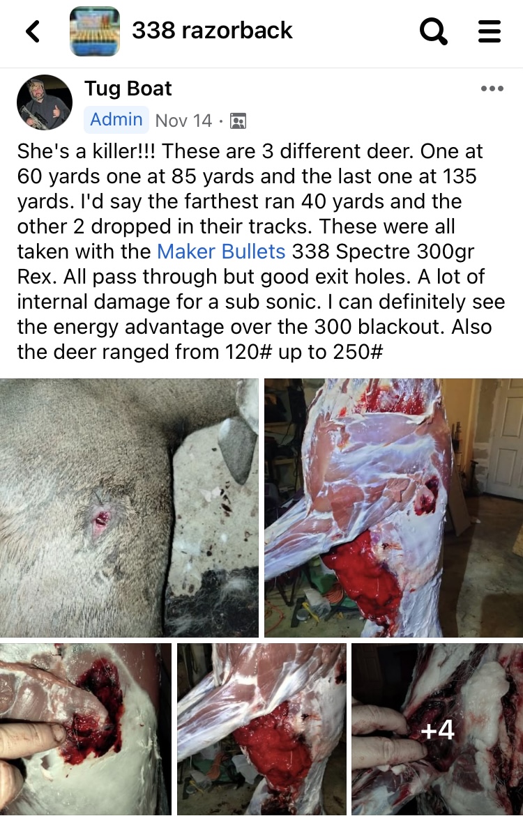

This is only one sided data, without a compatible shot from a slower twist. But I do have to say this subsonic expanding solid from a 1:3 twist created a fantastic permanent wound cavity here. It definitely turned temporary cavity into permanent and didn’t just use crush/laceration. It’s atypical for subsonic bullets to turn temporary cavity into permanent.
10 inch 1:6.5 twist
Maker Rex 300gr 338
Spectre damage on whitetail deer
I don’t have Facebook. But I’ll assume it is an example of wounding from a 1:6.5 twist 300gr expanding solid? Able to download and repost the picture(s)?
338 razorback and spectre seem like really solid options for people who only want subsonic capability. I’d argue better options for that given the weight and size savings for cartridges and platforms. I would personally be happy to see 8.6blk flounder with factory support and see one of those two get picked up more.

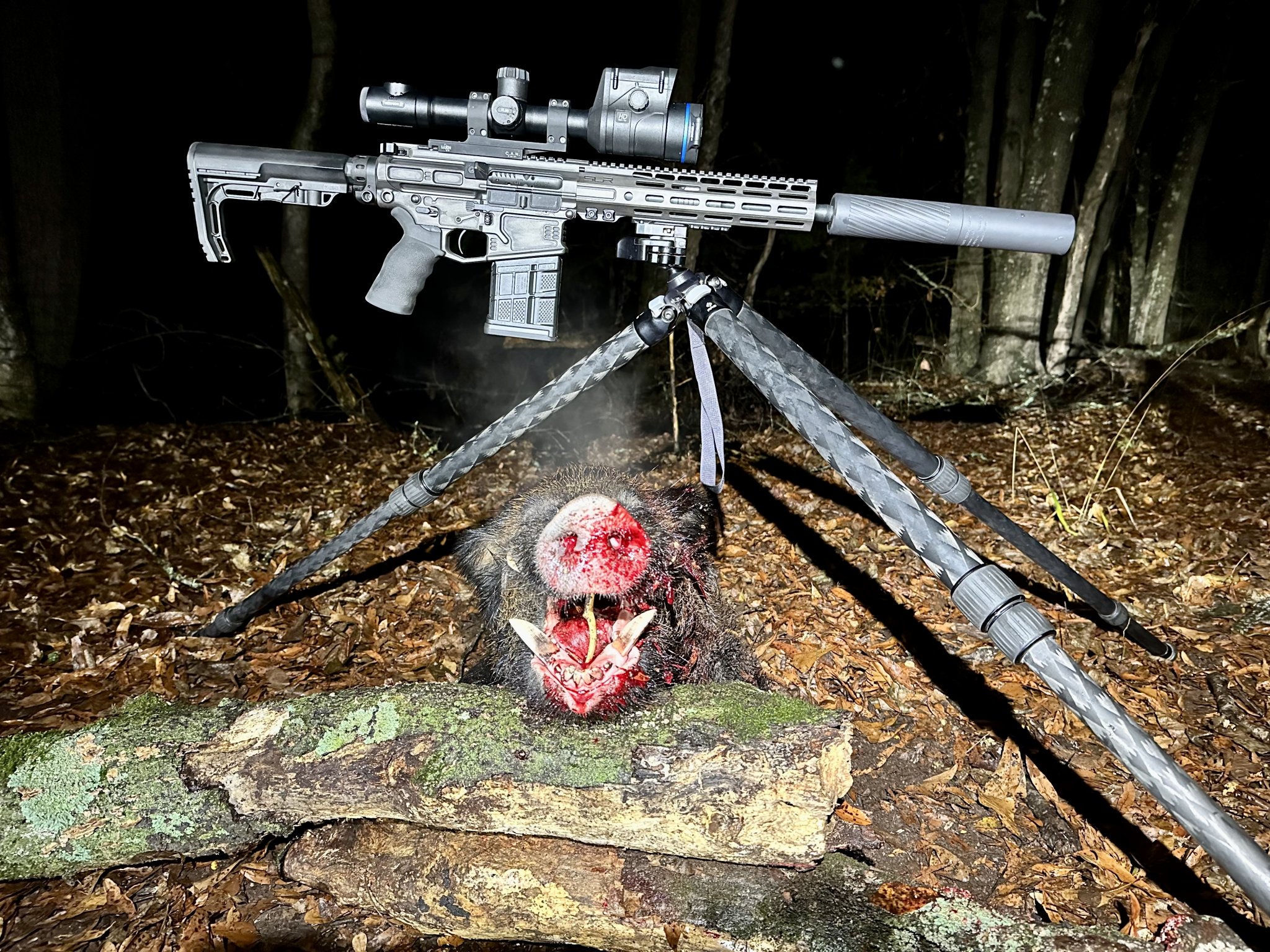

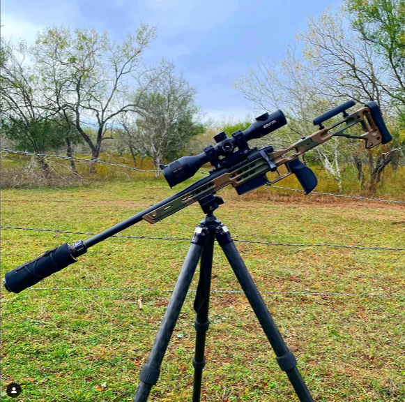

I bought an 8.6 barrel from Mos-Tek in 1/3 twist for my Terminus Zeus QC action. I am getting MOA groups at 100 yards with Gorilla 285 Subs. Velocities averaged 1050fps. This bullet obviously is not for everyone. It is so far a perfect subsonic hunting bullet for me. I want to try their 342 Grain bullets next
I am going to be using it for night time hog hunting mostly in the city limits. I plan on SBRing and cutting the barrel down to 9" that is the shortest i can do on the MPA ultralight with my suppressor. Currently using a 9mm Dead Air wolfman. It is very quiet. I ordered a Diligent DTFT 338 suppressor for it a couple months ago. Hopefully I will get it by summer
Nice setup!
Mos-Tek seems to be the way to go. I have heard good things about their 8.6 barrels of any twist and they did a beautiful job on my raptor barrel.

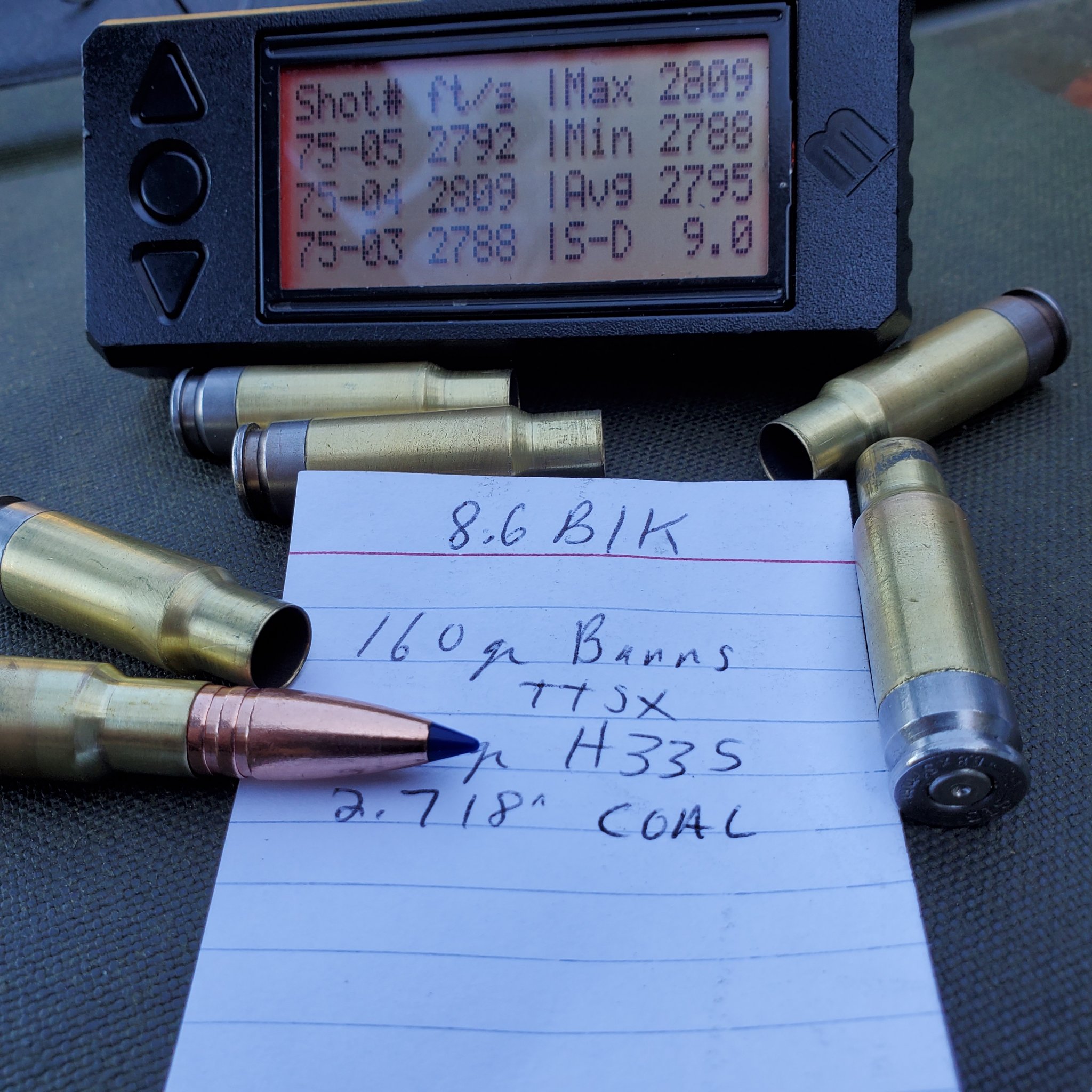

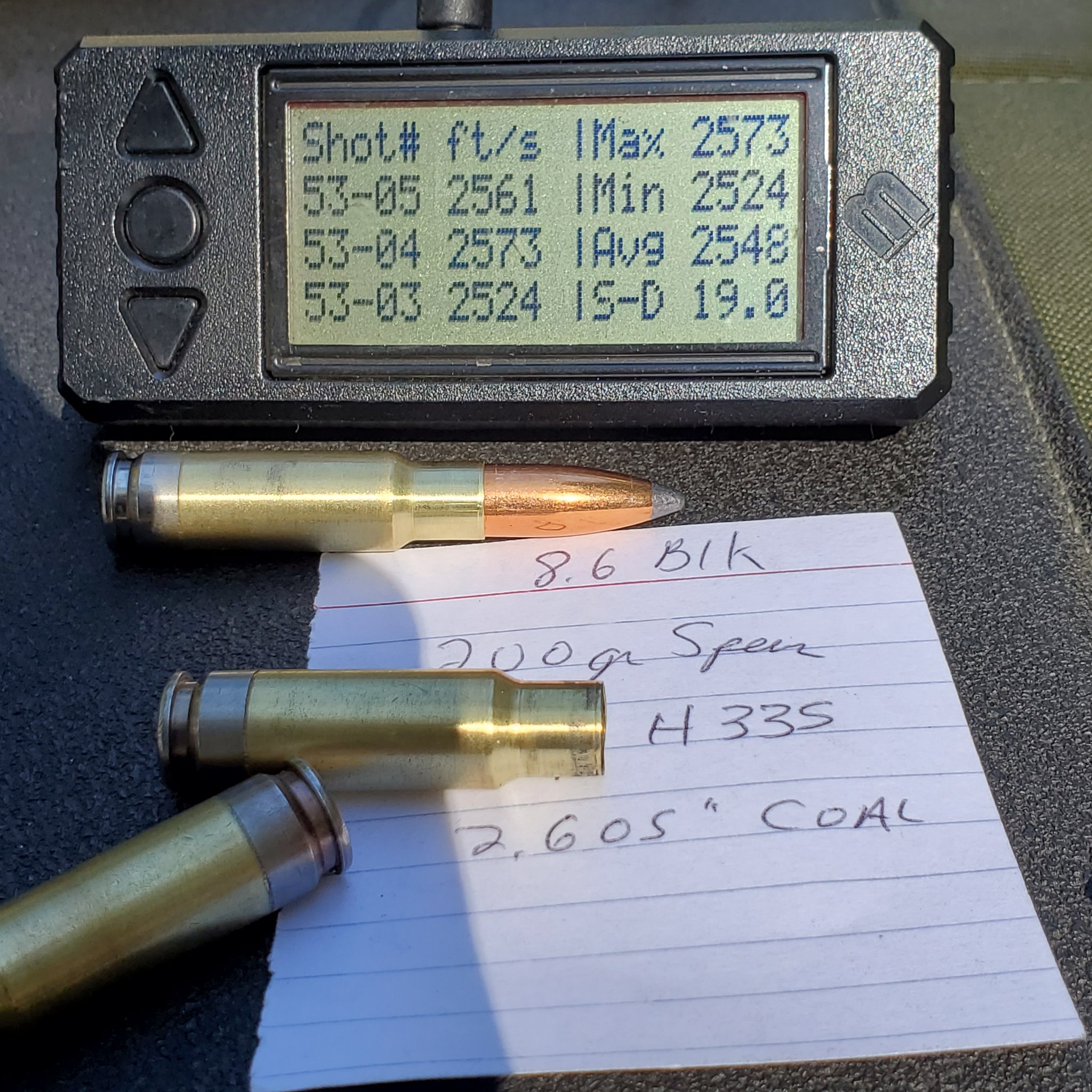

I have the 8.6 Blackout in both the 3 twist purchased early with all its faults and a 6.5 twist purchased much later after being dissatisfied with the horrible Faxon 3 twist.
A world of difference in accuracy and compatability with all bullets.
Excellent accuracy and high velocity with cheap lead bullets.
200 gr cheap lead bullets at almost 2600 fps
Or 225 gr sp bt hunting bullets a over 2400 fps...
300 gr SMK with 1680 subs shot low in the tape 8 shots, into a nice ragged hole.
Or 160 gr Barnes at 2800 fps.
The change from AR 10 Faxon 3 twist upper, to Rem 700 McGowen barreled 6.5 twist bolt gun is unreal.
All problems absolutely totally eliminated.
The 3 twist was unworkable for me no velocity, no accuracy, way too limited on what one could do with it
But I didn't give up on the 8.6 Blackout, I saw what the problem was, the torn, smeared, crappy rifling of the Faxon barrel. And that the 3 twist was a mistake...at least in terms of accuracy and usability...and for my needs.
These supers can run with much larger cartridges like the 308 or 30-06 in factory loads for some real killing power in the field.
This was my journey with the 8.6 Blackout, from a destructive but limited device to a cartridge with merit.

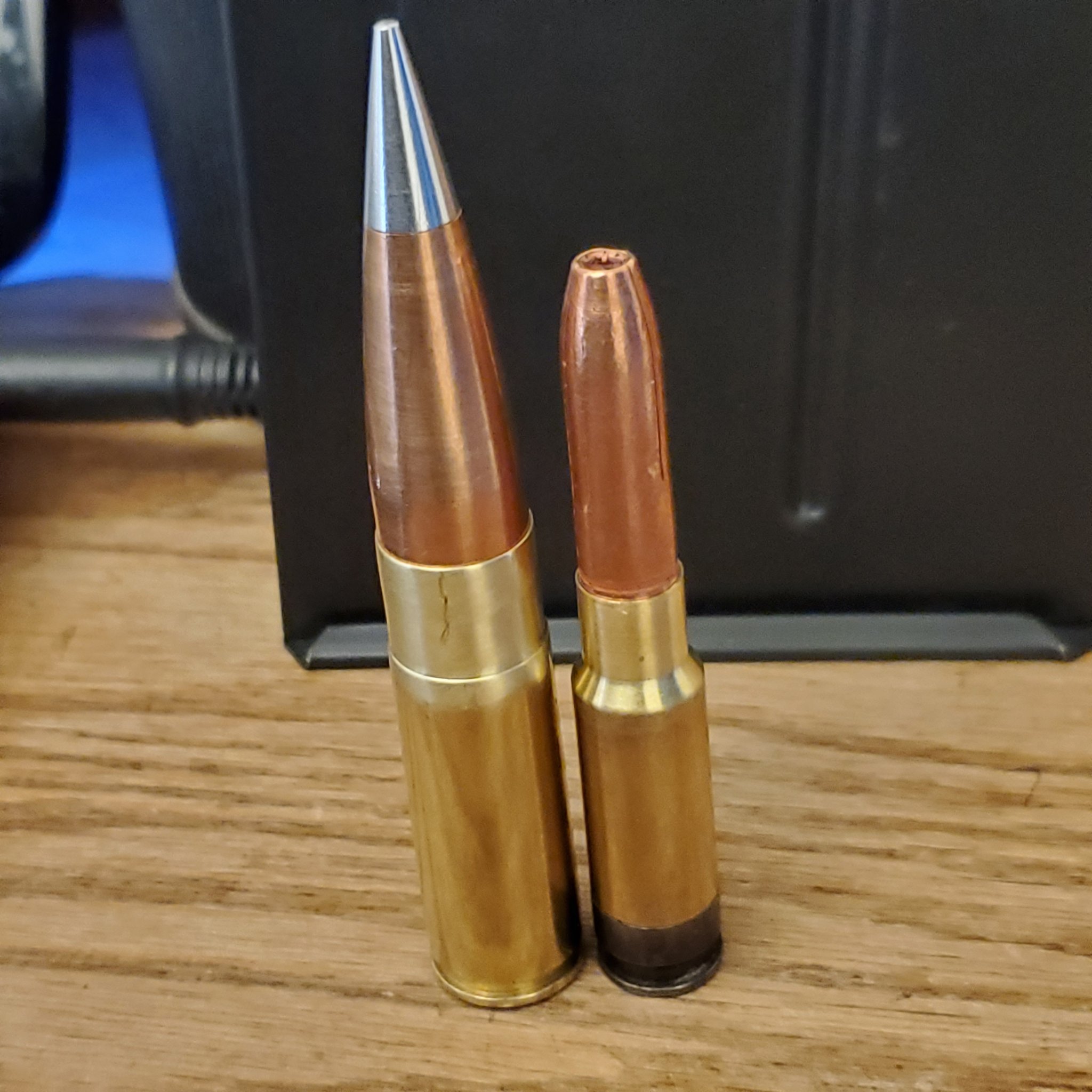

Another caliber to consider is the 510 Whisper, pictured here with a 750 Amax along side a 8.6 Blackout with a 350gr Maker.
They also make a 750 gr sub bullet for the 510.
The 510 Whisper is versatile, low velocity subs or lighter supers were putting out 4700 ft/ lbs of energy on the first bullet/ powder combo tried.
Just got the 510 put together, as I spent alot of time getting the 8.6 to shoot up to my expectations, which took a barrel change to 6.5 twist and get away from the 3 twist.
No twist issues with the 510 Whisper it has a 10 twist, normal for 50BMG is 15 twist.

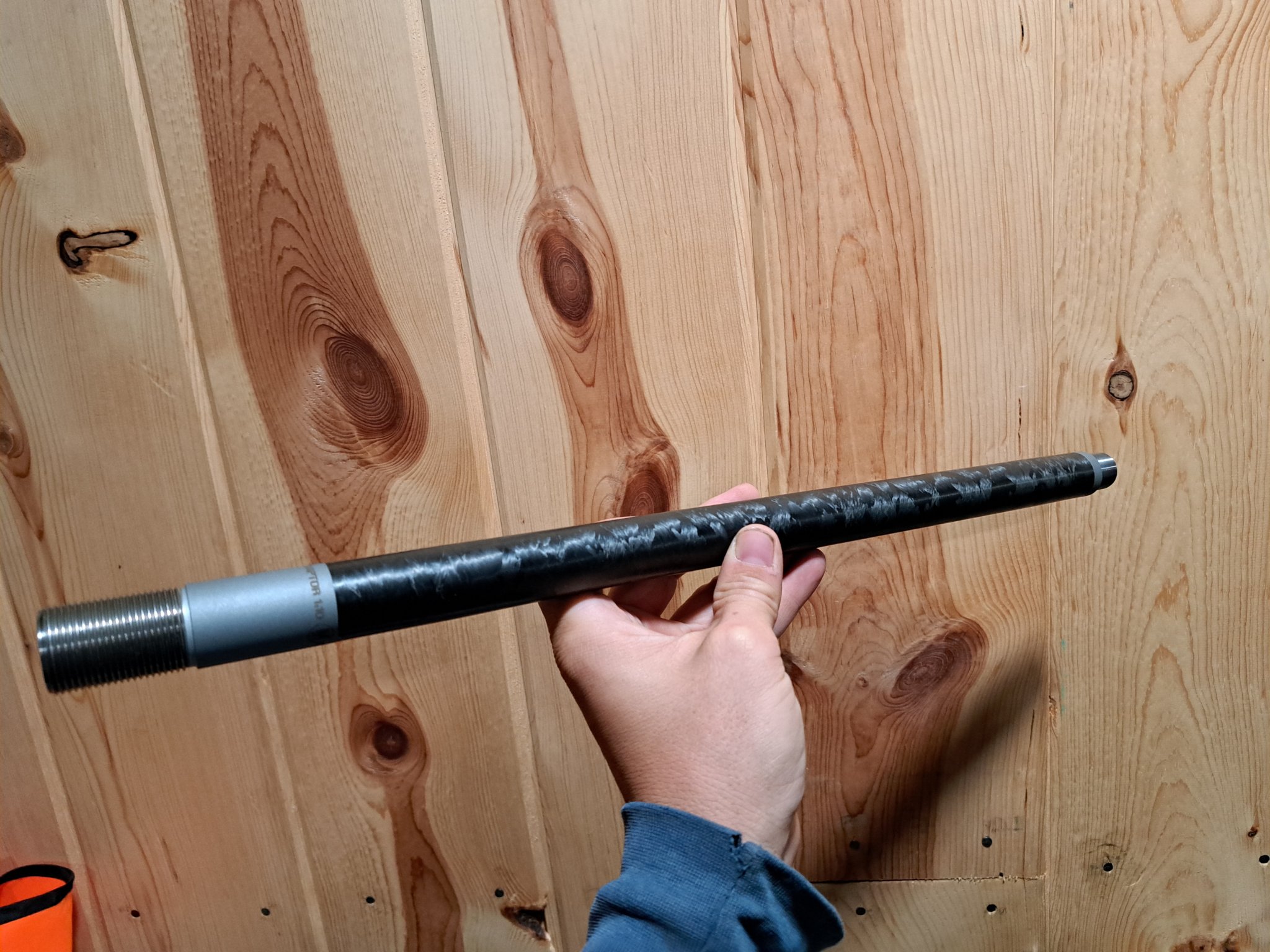

I recently picked up a 8.6 BLK barrel from Ballistic Advantage. It's a 1:3 twist. I have only the barrel thus far for an AR10 build, but I'm scouring forums of anyone who has gotten into 8.6 to see if there's reliable beta. @45-90 you seem to have the most informed and strongest opinion against the 1:3 twist in concept, and Faxon specifically at least in regards to the barrel you received from them. @Frank Green you come with industry insight and on this topic which is highly valuable.
My own take comes from listening to the developers of the cartridge and their respective firearms. Yes they are all selling something, but logically it would make no sense to throw this much investment at a physics fail. Sure you'll get early adopters and acolytes, but that's not what'll get them the ROI...they'll need the normies for that. Q blatantly doesn't market to the poors, and has openly been critical of other companies trying to break onto the 8.6 scene before they've even worked out all the kinks themselves. I recall a video featuring Kevin where he specifically lambasted the 1:6.5 twist as basically the best the rest of the industry can accomplish without upgrading their tooling, or something to that effect.
Really what this cartridge boils down to is a pet project that has gone somewhat viral. In any cutting-edge development, you're going to have extensive T&E. Time will tell if the 1:3 really is THE ideal twist rate for 8.6 or if something slower is going to be more widely accepted. Kevin has spoken about going as low as 1:1! They're manipulating all the variables (bullet weight, powder charge, bullet composition/shape, barrel length, muzzle device, etc.) which seem to be trending towards something very niche: high penetration, subsonic performance out of 8-12" barrels. In my listening, this was the rationale for arriving at 1:3. But is this what customers will want or even find useful/worth their money?
