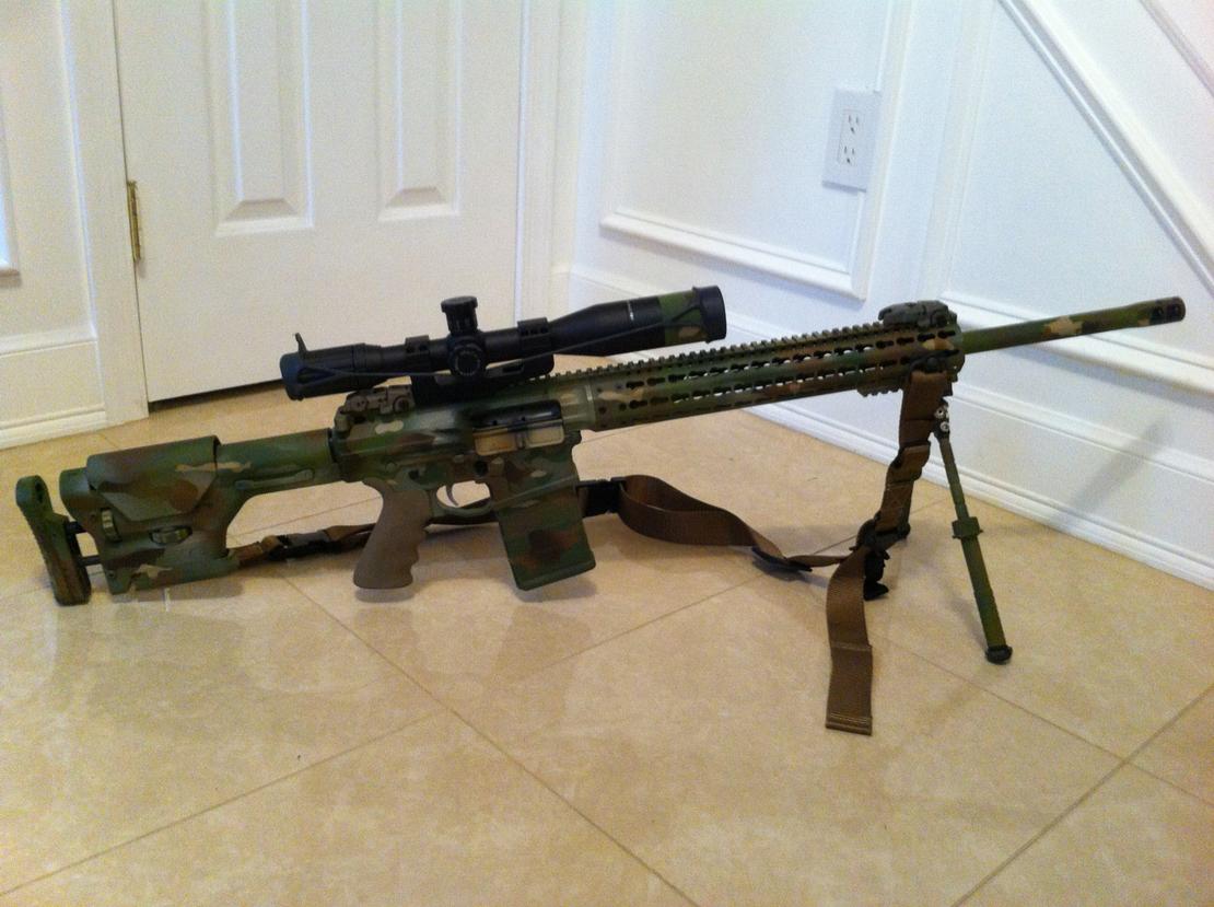

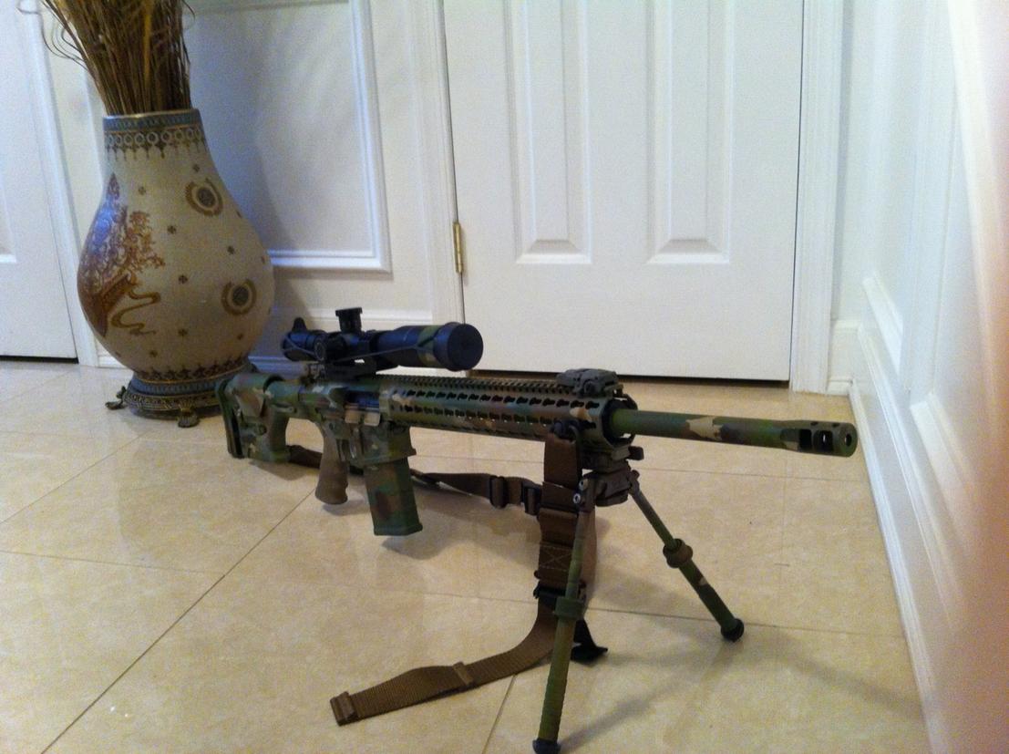

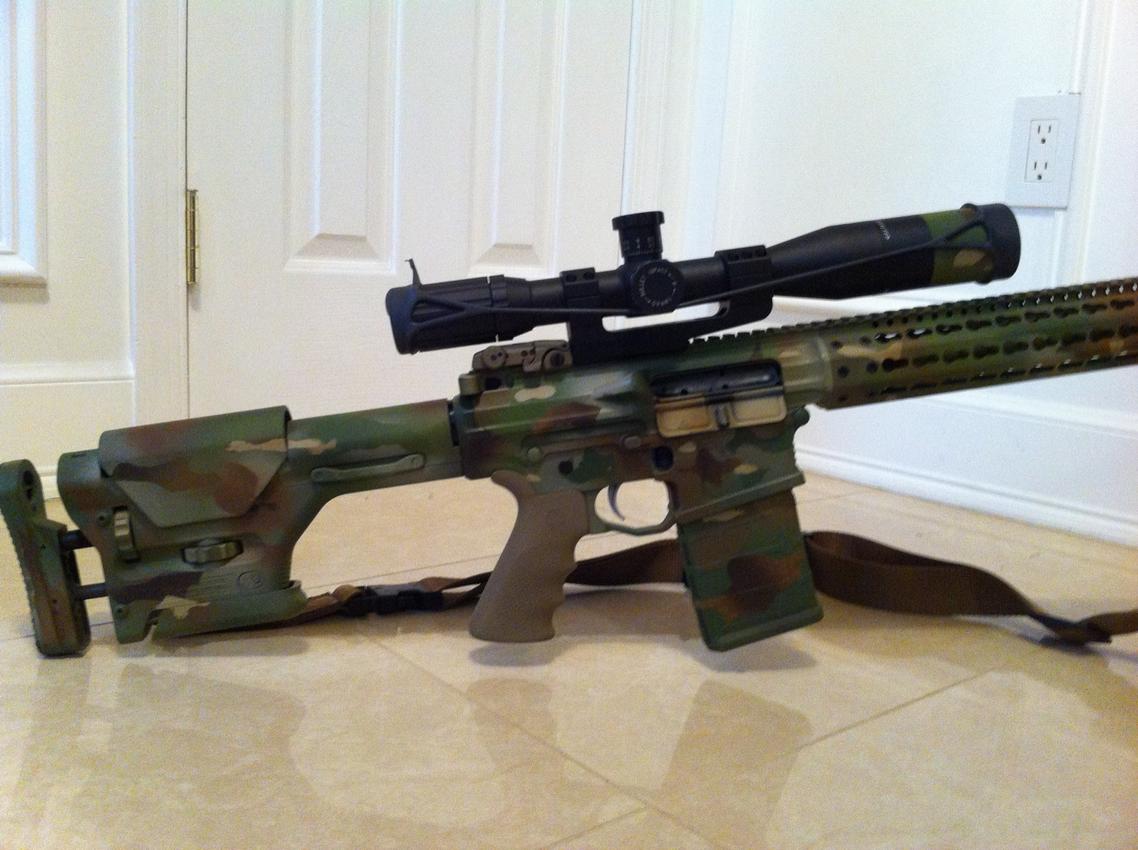

I always wanted an AR10 style rifle. Almost this time last year, Dave Branson from BB Shooting hosted a group buy and jumped on the opportunity. This isn't my first AR as I built my own .223 and have been shooting that non-stop (I reload), but wanted something "heavier". Dave guided me through component selection and he's an aboslute pleasure. I will refer others and purchase from again. Thank you again Dave.
Attached are a few pics. I just mounted the scope and will spray paint it, of course. This rifle will not be a safe queen and my good friend was nice enough to already drop it on gravel, twice, in the same day. Did I need to paint the rifle? Nope, but didnt' want a black rifle and since it was all in parts, good time to hit it with a rattle can. I'm just a simple guy who really enjoys shooting and eager to learn the fine art of precision rifle.
Build:
Mega MKM Maten platform
ALG trigger
PRS stock
Atlas bipod (got it because it was available on the Sample list or it was going to be a Harris)
Aadmount
SWFA 3-15x42 scope (had a fixed 10x on the rifle, but treated myself, hence the reason it's not painted)
All JP internals (22" 1/10 barrel, brake, bolt, bolt carrier, buffer, trigger spring, etc....)
Tab Gear RAS sling (Cascadia mount for the stock, Noveske mount on the keymod)
Thank you again for those I privately PM'ed to ask for advice.

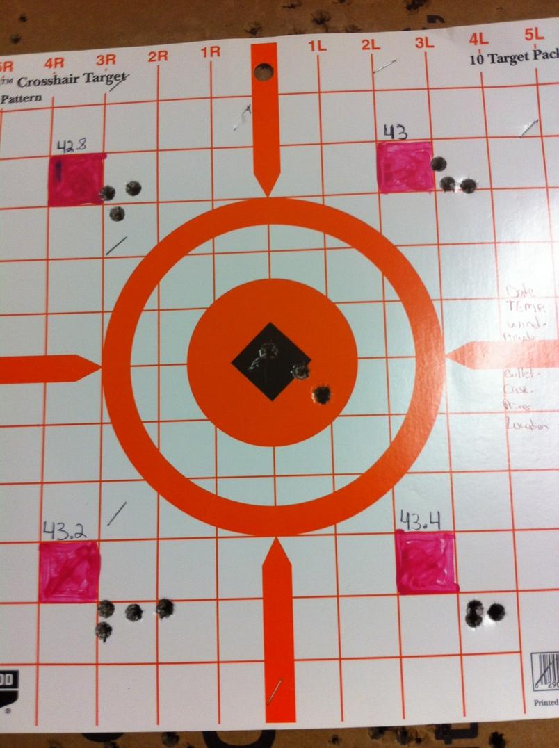

Tradition states that a new rifle has to post a range report. Attached is mine with a few notes :)
I'm performing an OCW test and the load needs tweaking. All squares are 1", shot at 100 yards, prone with a bag rest under the butt stock, shot via bipod on cement. The load in progress:
- 175g Sierra HPBT kings
- Varget powder (charges listed above squares)
- CCI 200 primer
- Virgin Winchester brass
- 2.800 OAL
- Loaded and prepped with Lee equipment, dies, and turret press (used as a single stage loader)
- I pulled the third 43.2 shot so that's why there's 4 for that group.
I have consulted with Dan Newberry on the load data and will be tweaking OAL for the next test round. I know I can shrink those groups and just have to practice more. I can't wait to drive down to Bang Steel to learn and collect data!
