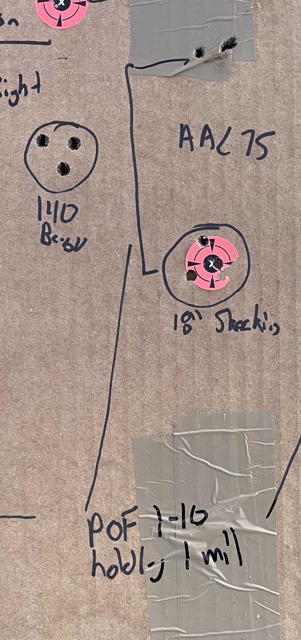

Aac 75 black tip did .6” and .7” out of 16” Pof and 18” seekins. I may buy a bunch more , I’m shooting terrible today that 140 group should be one hole. And half hungover. So that Aac stuff definitely is good for the price
View attachment 8342051The
Did you get drunk and have sex with fresh roadkill… again?!

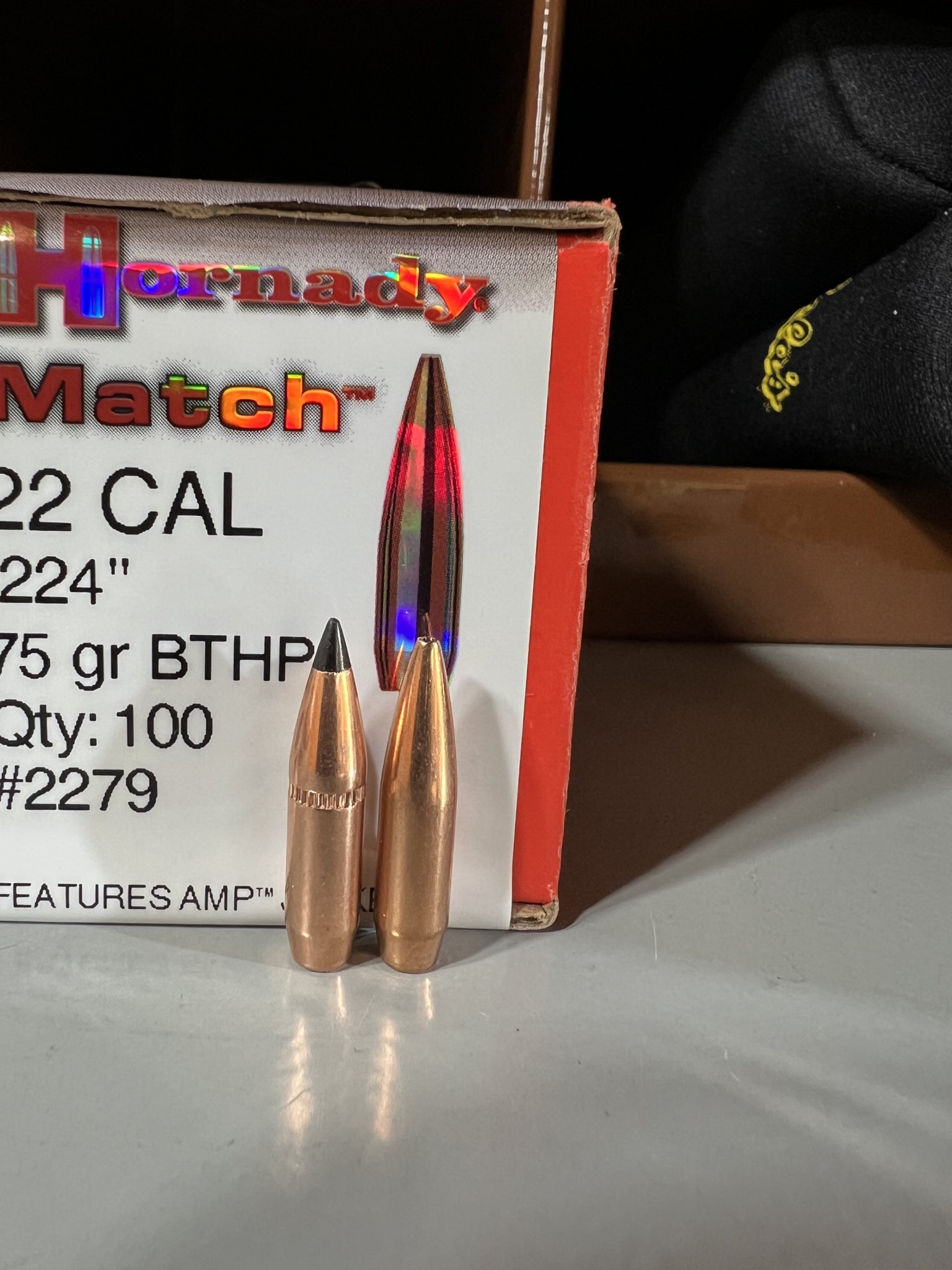

These bullets are available as a component now and I ordered enough of the 75gr to kill many deer for 100s of years. Here is one next to a H 75gr hpbt.
Hpbt is .991” SBBT is 1.041” according to my Starret caliper
