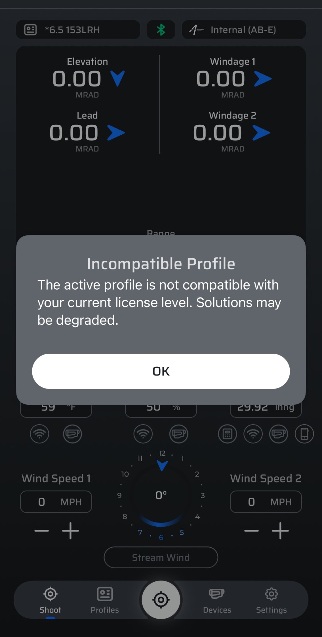

Once I connect my Kestrel Elite with AB I am able to use the Elite features. When I click on Upgrade Subscription (which still says Ultralight subscription level) I only see the options for the professional Subscription.
However, when I don't have my Kestrel actively connected, I'm unable to use any of the Elite features and I'm prompted to upgrade my subscription, which still says Ultralight but now also shows the Elite level subscription options.
This is what I see when I first open the app if I don't have my weather meter connected:
I’m having the same problem.
AB Quantum iOS v3.2.3
Kestrel 5700 Elite (“5700AL”)
The Kestrel started life as a “5700 Sportsman” version and I paid to upgrade it to 5700 Elite, mentioning that in the off chance it could be related.

Pairing to a wez model kestrel will upgrade to pro license and unlocks WEZ, CDF cal, and graphing?... or just the wez function?
With the upgrade being an option is there anything additional gained by by paying whatever the pro subscription is vs just upgrading or buying a wez model kestrel?
I can confirm you get all the pro features AFTER you upgrade your kestrel to wez software. I did it yesterday and I can access WEZ, CDF and graphing inside the AB software. In the HUD, top right corner you will now see "Internal (PRO)". Under settings, subscription level, you will still see "Ultralight" despite having the pro features enabled. I'd imagine the AB folks are distinguishing between those who have the pro features via kestrel and those via AB software.
Correct, and we are updating the app to reduce confusion.
We are also going to move the CDF stuff down to Elite since it is going to be implemented into multiple devices (and already is in some upcoming ones).

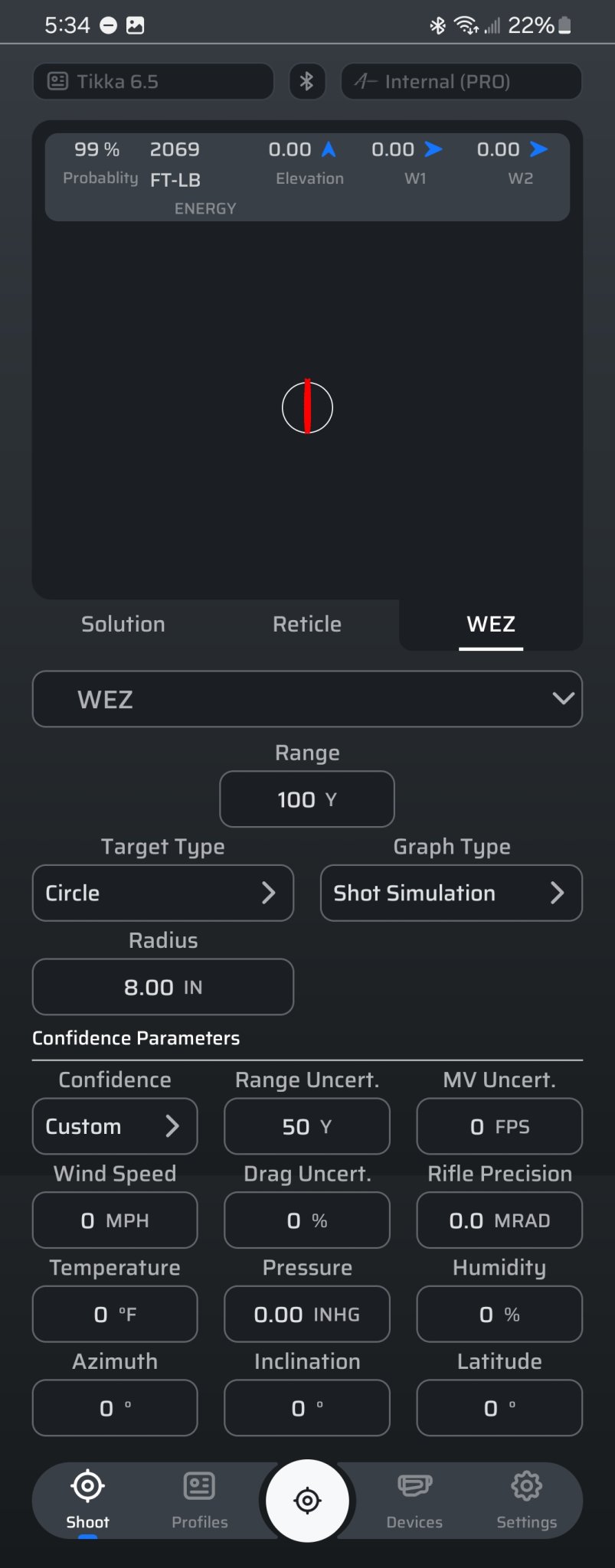

So to be transparent and hopefully help anyone else out who was viewing this the same way that I was....
If you were to zero out all wez inputs except yardage. And set a 50yd uncertainty on a 100yd target...
I was under the impression this meant you were somewhere between 50-150 yards.

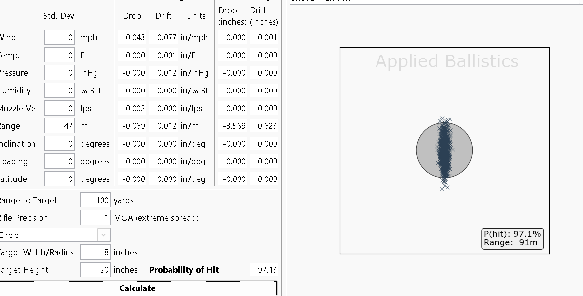

When I got a reply today they had done a mimicry of my analysis on the full software and attached a screen shot
It's at this point I'm seeing that all the inputs listed top left appear to possibly be a standard deviation... so a 50 yd uncertainty doesn't mean 50-150 it means more like 0-350. This tends to explain why I was expecting something like 1" of vertical and not 16" like the examples show.
Now I did end up with additional questions that I sent back after realizing these inputs are SD...
Mainly I'm possibly also confused how the software and app populate the results that end up looking so evenly distributed both upward and down... because in this scenario I'm thinking all my error would be from the center of the plate downward as I'm assuming 100 yards and the target could apparently be something from 0-350 so all my error would show up below the point of aim.
I might be the only one that was viewing the input this way, but if not maybe that will help someone else.
If anyone is able to dumb down the answer for how the vertical populated upward and downward in this scenario I'll come back and share that as well.

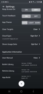

@DocUSMCRetired I used the AB Quantum app for the first time in a class this weekend. Worked fine until I paired my kestrel and it screwed with every profile on my kestrel. Changed bc's to g1, changed bullet diameters, grain weights, barrel twists, muzzle velocities etc.
I deleted the app, and resinstalled multiple times since Saturday, and it still messes with my profiles. I'm going to have to re-true everything I own now..
And now the app wont even let me keep settings in the profiles, it will change values after I hit save.
Kestrel is a 5700 sportsman upgraded to an Elite
The app version is 3.2.11 which sone how is older than what you have been referencing in this thread, but its what is on the google app store as of today?

3.2.11 is the most up to date version of the app.
DSF doesn't touch Muzzle Velocity, only MV Cal does this. When you attempted to do an MV Cal did you input the corrected drop or the total drop?
