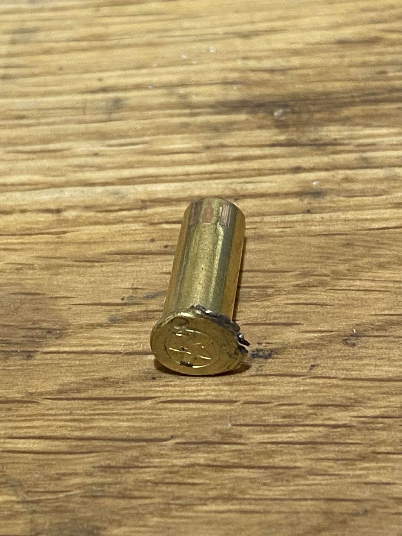

As for running double the pressure as Saami spec, that’s not currently going to happen with the brass that’s being made. The brass is the weak link in this whole idea. I’ve blown quite a few cases in testing already.

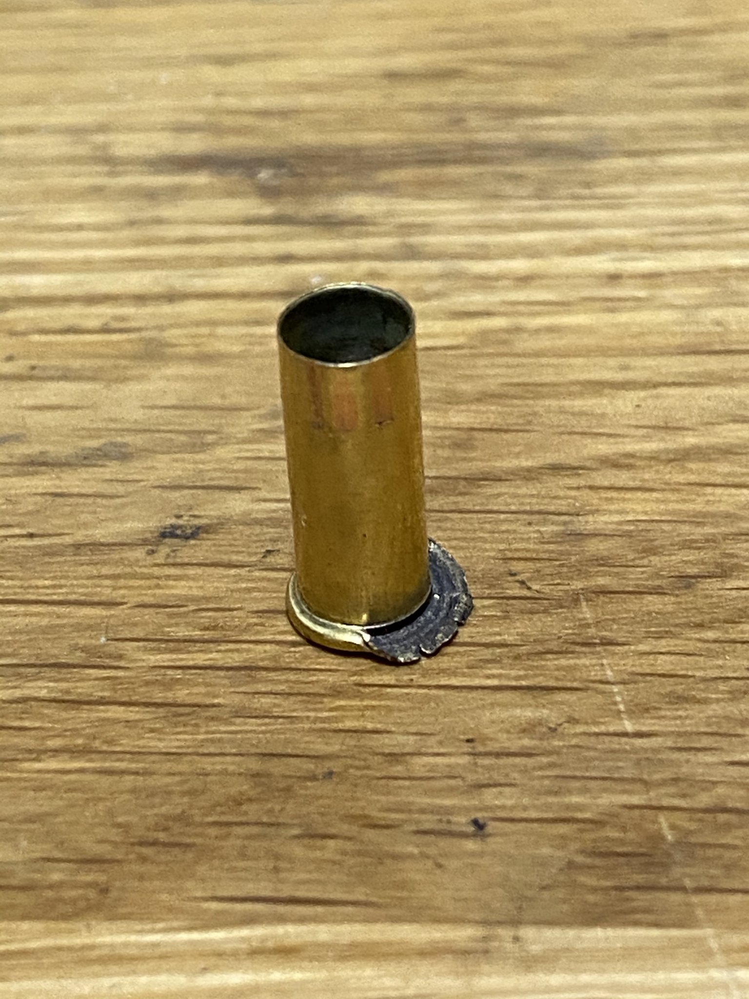

Would you mind posting a picture of a blown case?
I only have one with the base still attached, I’ll find what bag it’s in and snap a pic. The case fails exactly where it would be expected, at the sharp angle coming from the rim to the body. Making that angle with metal forms a weak spot

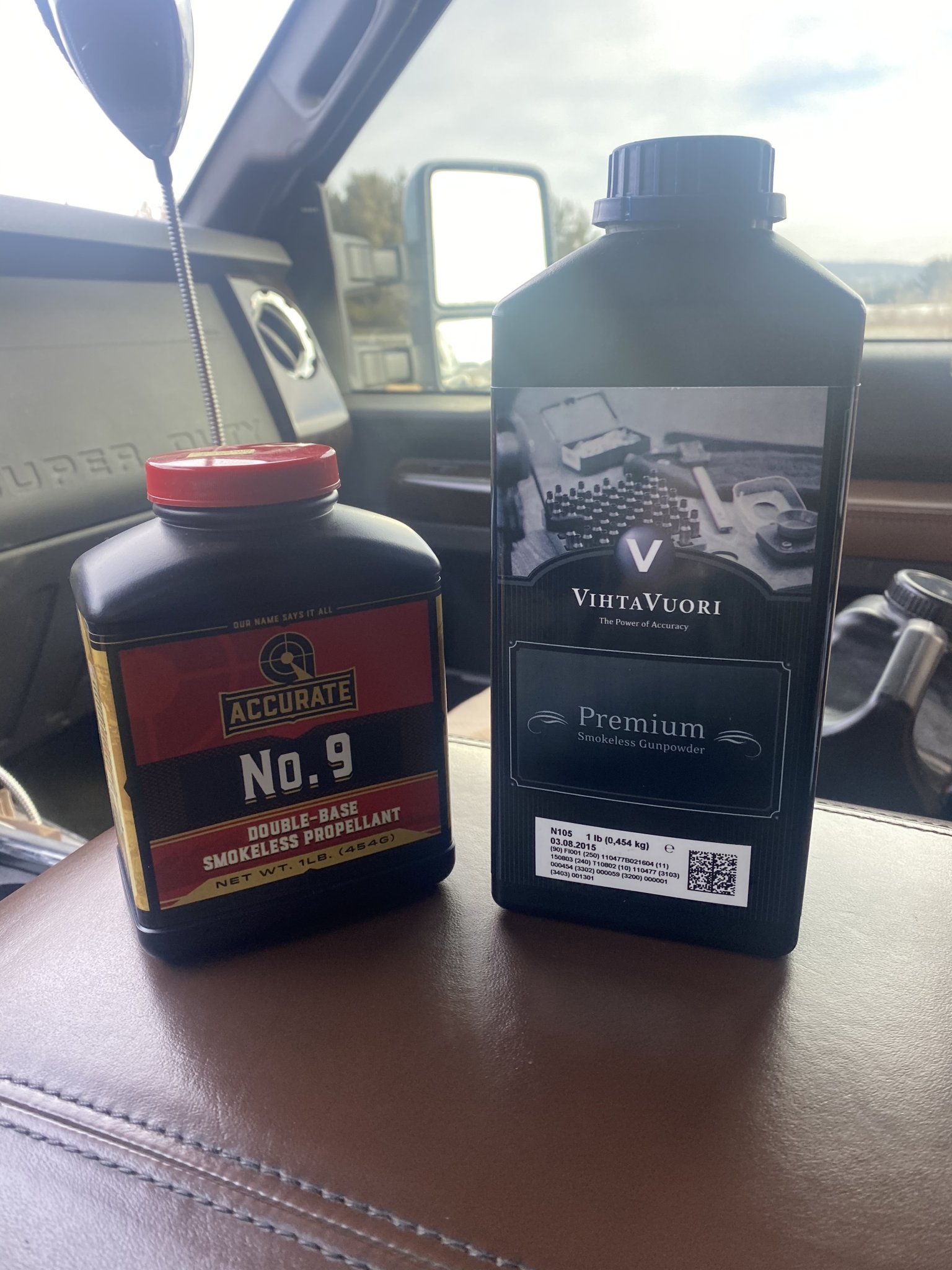

Wondering why AA9 is on the list for testing. Would think it’s too slow for .22lr case sizes, but looking forward to results.

For my particular bullet, a case full of LilGun isn’t enough to blow a case; Longshot will. A9 and N105 are right between those 2. With the newer bullet it’s going to drop pressure so it might turn out that I have to go faster than Longshot. Time will tell for that.

Both LilGun and longshot are already workable. I’m testing these 2 other powders now to see what can be gained, if anything, from them. I like the safety margin that LilGun offers to someone that doesn’t want to wish blowing a case, but a little more speed would be a bonus

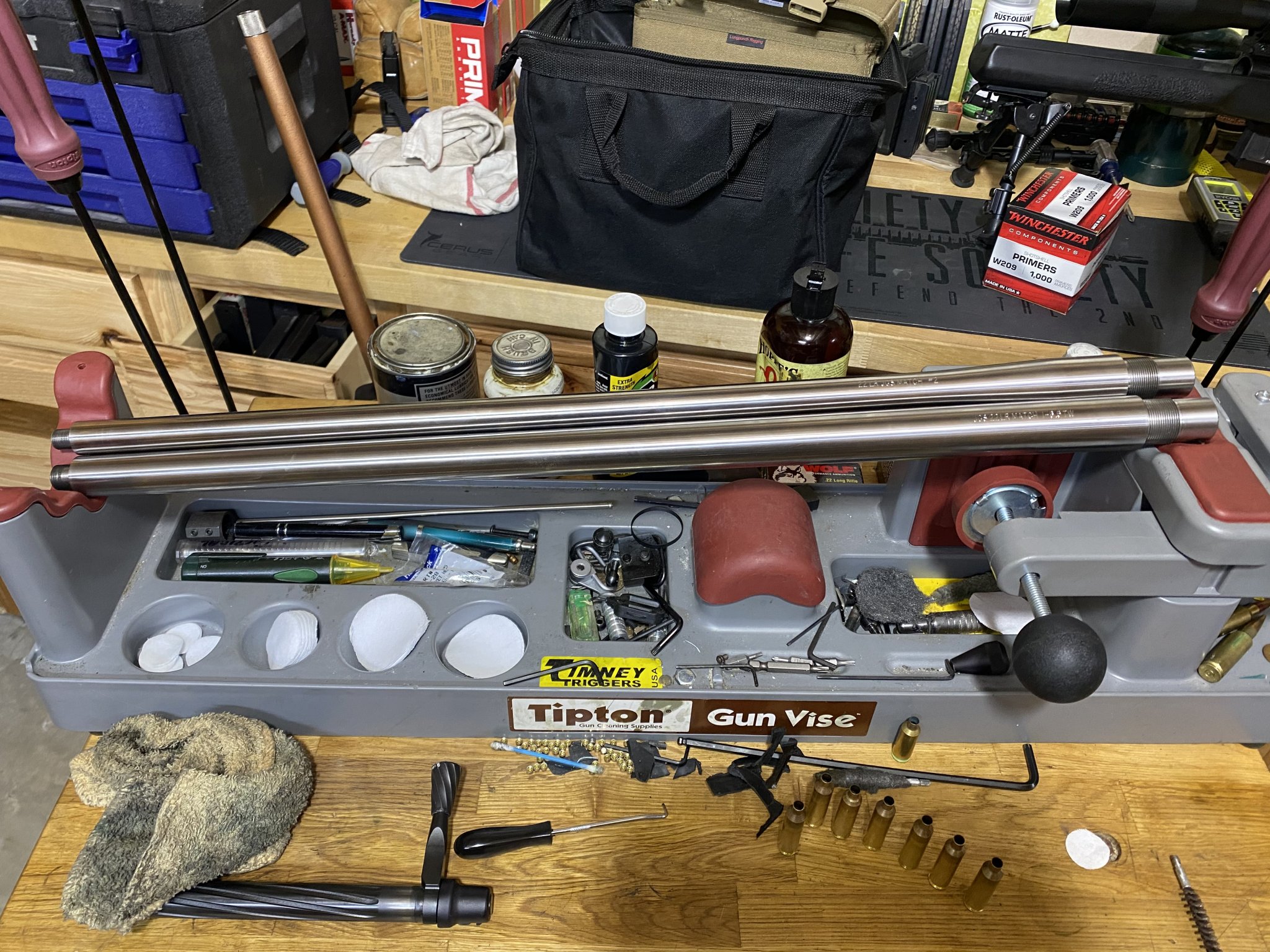

Gonna chop and re thread every inch or just chop and speed test?
28” Bartlein on top for the fist gen bullet. Thanks to @Frank Green and crew
28” K&P on the bottom for the 2nd gen. Thanks to Ken Johnson.
Going to be chopping an inch at a time to find we’re peak speed is achieved. Sacrifice for science.View attachment 7612443
