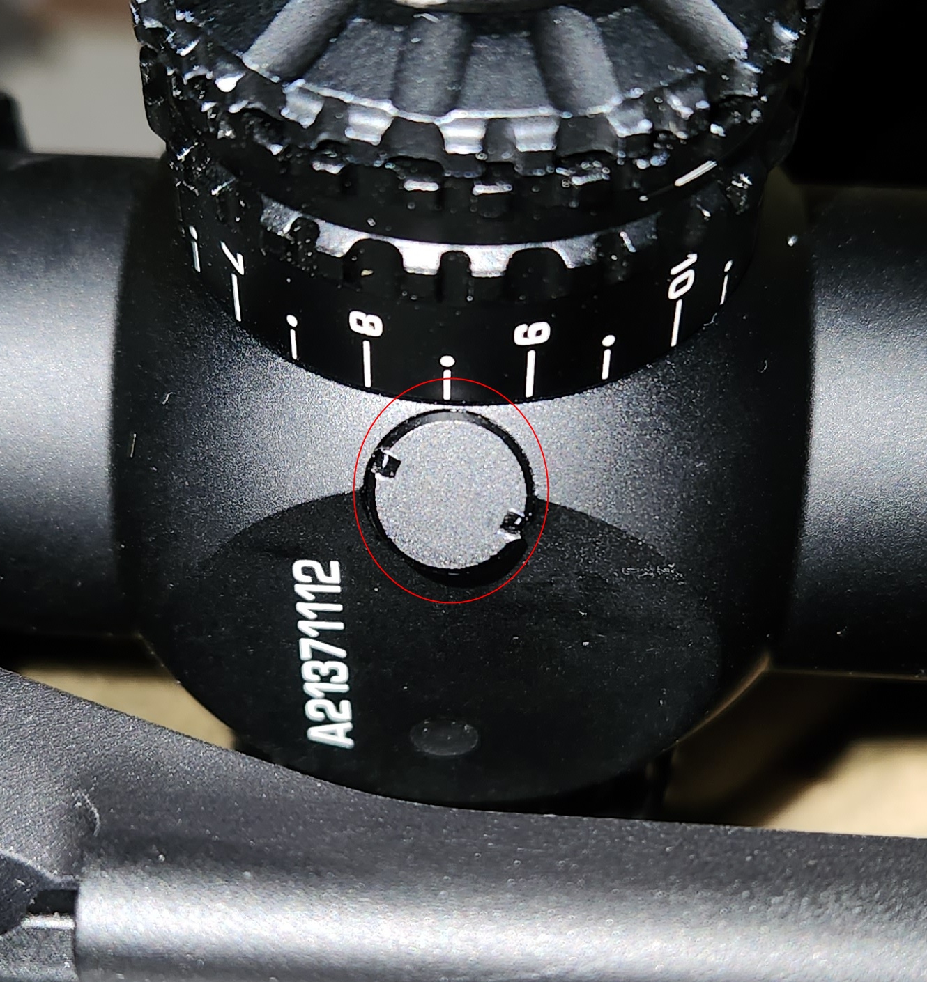

Ok, now you guys can beat me up. I finally got the parts with the holiday sales for another build. A budget build.
I also needed another optic so I got a Swampfox (covers head) Arrowhead 1-8, put it on my Aero build and put the Bushnell on the new one. Hopefully tomorrow I'll get them both sighted in.
All that aside for a second, I haven't been able to find a definitive answer to this question:
What is this on the bottom of these LPVOs?
My guess is that it has something to do with sealing up the internal environment of the piece, but I have certainly guessed wrong before.
Thanks.
Is the nitrogen port, don't mess with it.

Don't touch that. There is usually a spring there that pushes on the erector tube against the turrets. If you mess it up, the scope will not hold zero and not adjust properly.

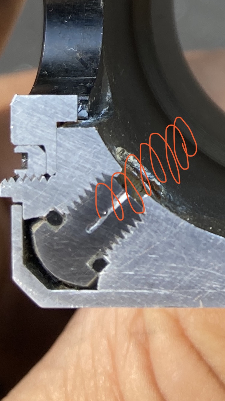

There is a spring under that.
See the red spring? Different model but a similar idea. 😀

Pretty sure it’s the “seat” for the spring that keeps the reticle cell in contact with the adjustment pads.
Thanks again for the replies. I had no inclination to do anything with it, especially without knowing for certain what it is and no reference to it in the manuals. I was just curious and would consider it an unacceptable gap in my knowledge to have it remain forever a mystery to me. :unsure:
