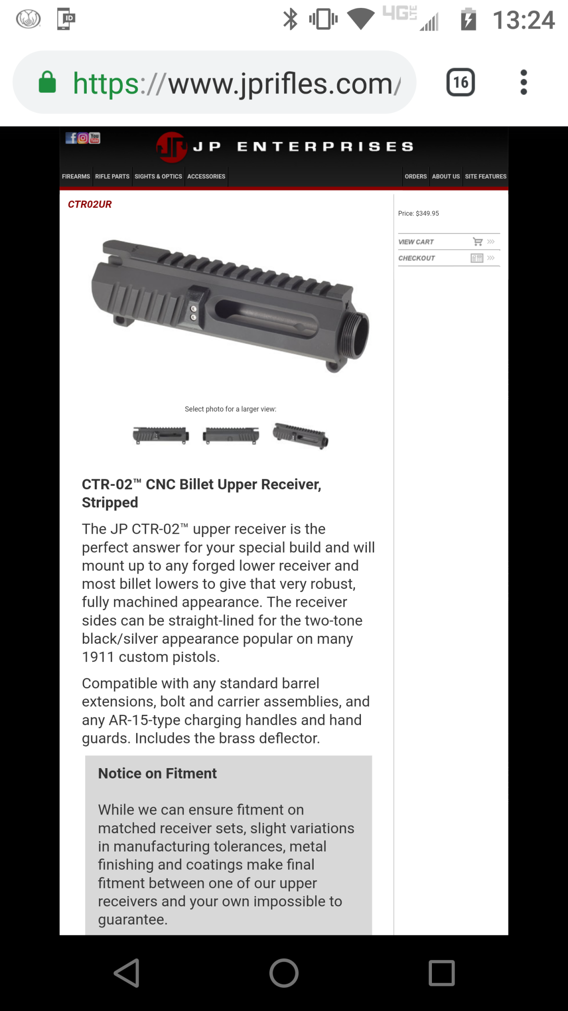

I just put my 20" Keystone Kreiger 1:7 .223 Wylde in a MEGA SBU Billet upper and lower with a YHM 15" TJ Competition handguard. Talk about a tight fitting upper/lower and a beefy upper. Thats an understatement. I honestly though the upper/lower didnt fit together till I got it perfectly straight up and down and pressed it into the lower. Ive built a lot of AR's from all kinds of forged and billet receivers but this is by far the tightest set EVER.
On sale at JSE Surplus right now. Hard to beat this price for one beefy, tight fitting setup.
Regular MEGA SBU Upper
http://www.jsesurplus.com/AR-15SBUBilletUpperwithoutSideChargingHandleSlotJSEEXCLUSIVE.aspx
Side Charging MEGA SBU Upper
http://www.jsesurplus.com/AR-15SBUBilletUpperwithSideChargingHandleSlotM0300JSEEXCLUSIVE.aspx
MEGA Billet Lower
http://www.jsesurplus.com/megaarms-4-1-1.aspx

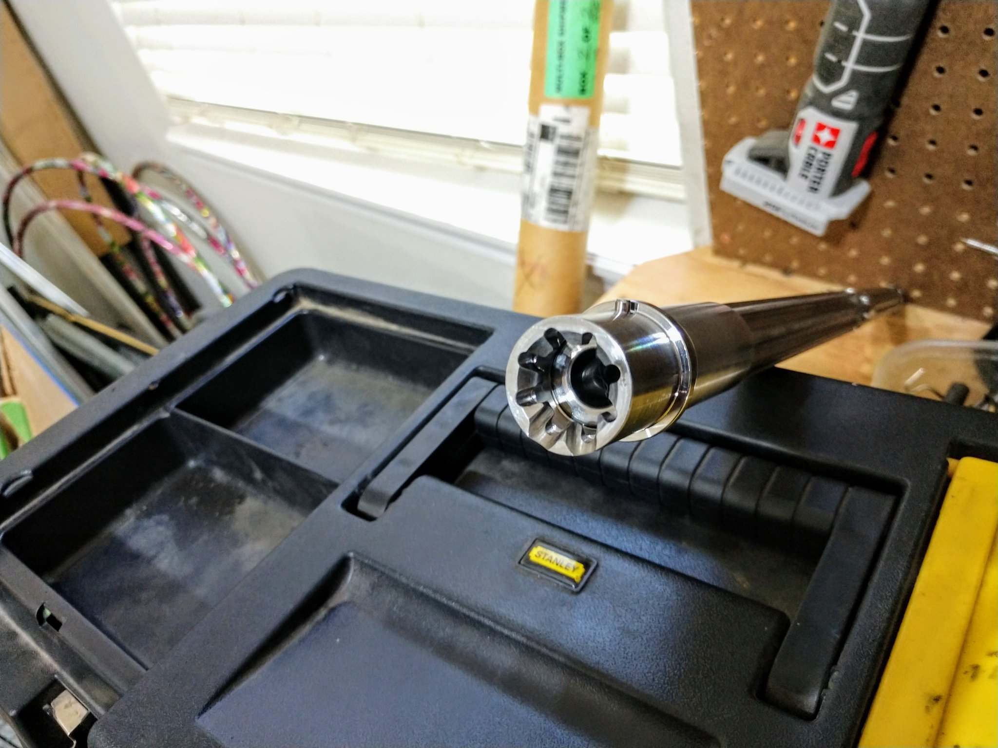

Ordering John Holliger's 20TPI extension a few weeks before the barrel blank arrives, I, uh "work on it" to deburr and polish everything I see that needs it, with the obvious exception of load bearing surfaces, threads, etc.
It also gives me a chance to test fit in the upper, and to hand-fit the M4 extensions to the receiver to create one 'seamless' polished ramp.
Works.
My most recent one is on my 1,000 yard upper, and that brass needs all the integrity-help it can get!

A little behind on this thread but still hopefully relevant to a current build I'm involved in. The thicker walled upper receiver makes a lot of sense but what are you guys thinking on something like a Lantac Enhanced BCG? This is for a 6.5 Grendel build and I have come across several sources that make mention of larger group sizes from rounds that feed from opposite sides of the magazine due to some BCG's that are not as tight fitting in the upper receiver, and a supported BCG like the Lantac fixing this because it is a tighter fit and does not wobble.
