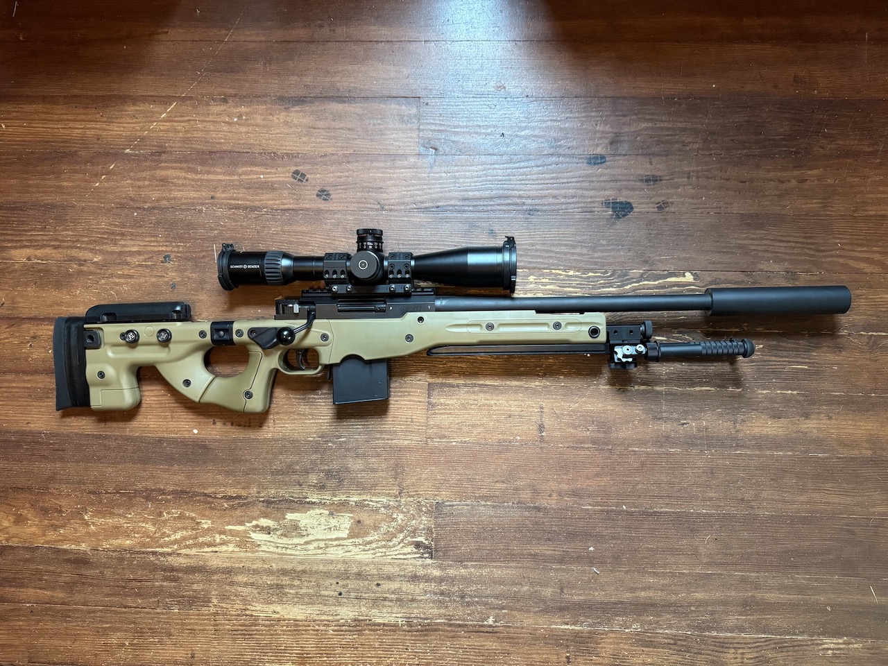

This is a dumb question. I assume the 223 conversion is reversible (by the user) back to the 308 bolt head…but since I’ve never had my post-14 AT bolt apart, I figured I’d ask. I do have an extra bolt.
It is completely reversible. Remove the SFP fire control and punch (3) roll pins to change the bolt head. Removal and reinstallation of the pins is straightforward but it has its pitfalls. You can get a pin cross-stuck in the bore of the bolt, and the pins need to be re-installed at a very specific depth. Too shallow and the bolt wont go in the action, too deep and features on the firing pin can strike or drag the cross pins. they are metric roll pins and can be removed/reinstalled 2 or 3 times before they need to be replaced

Are the bolt heads also epoxied in?
