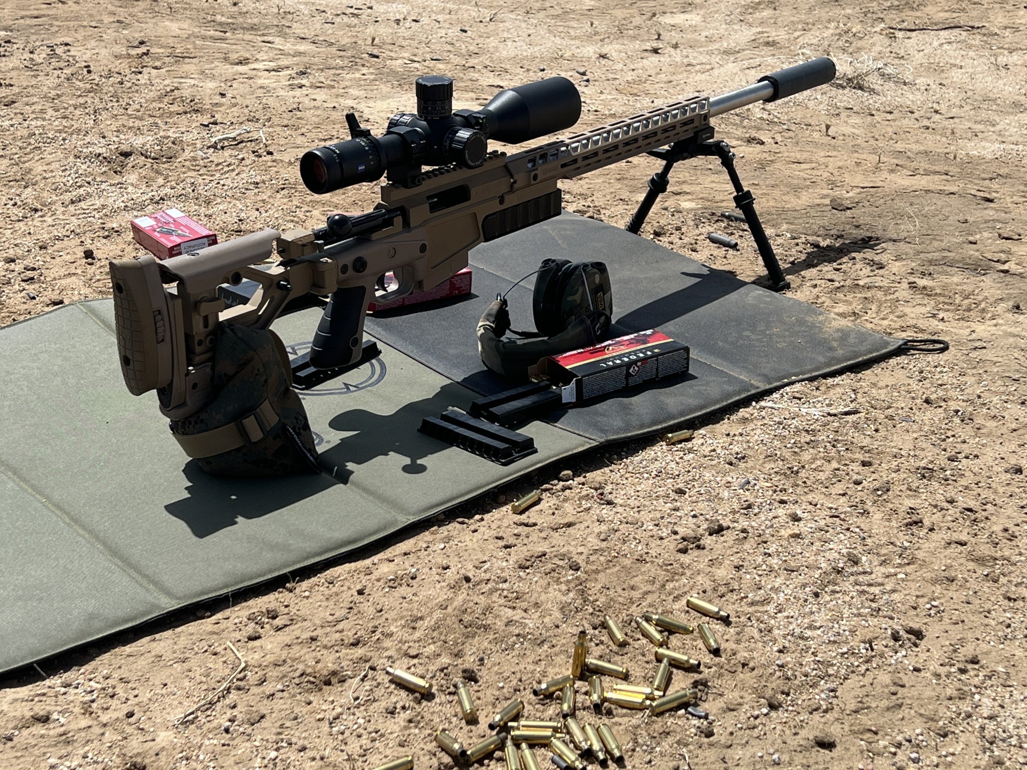

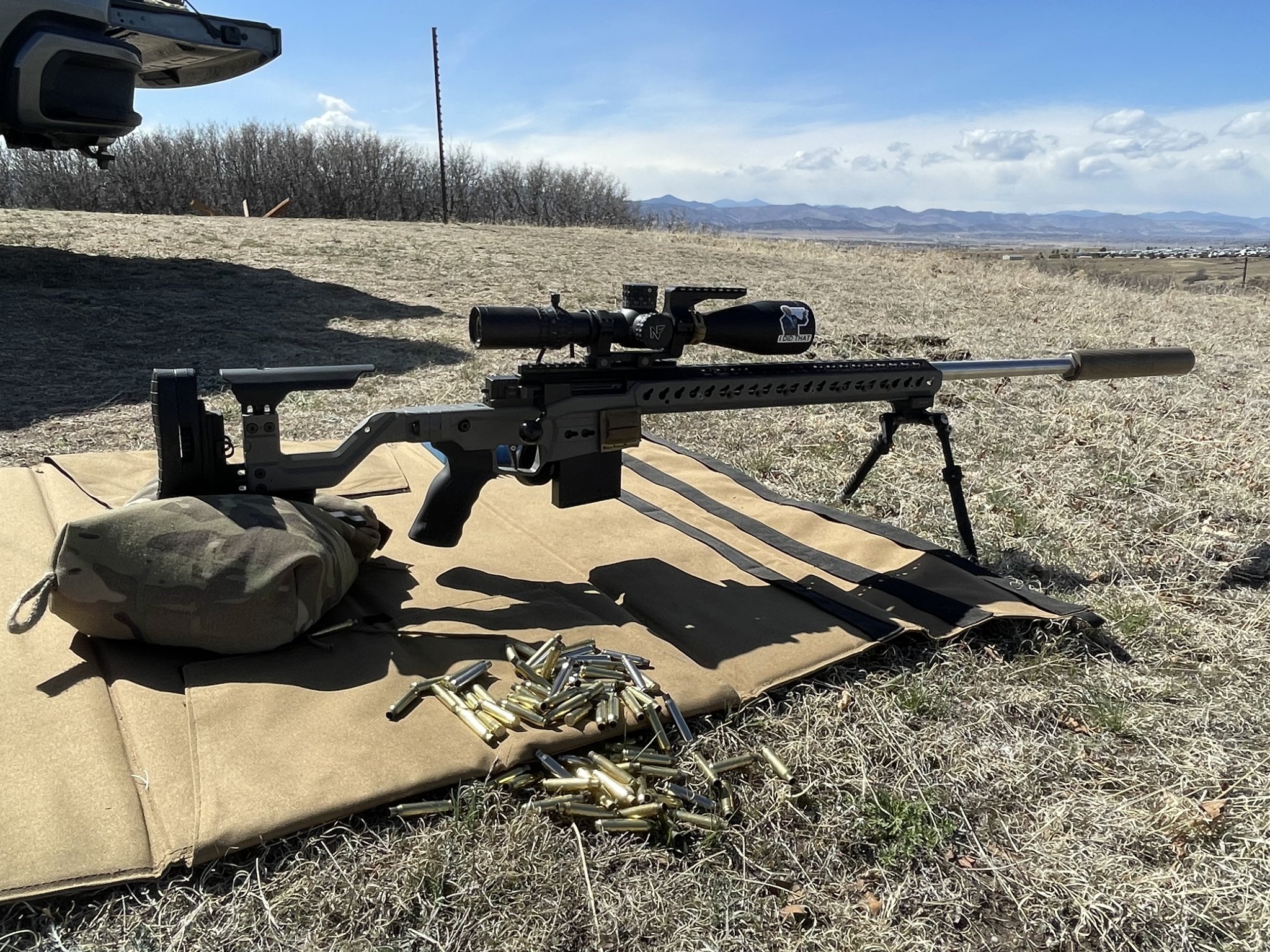

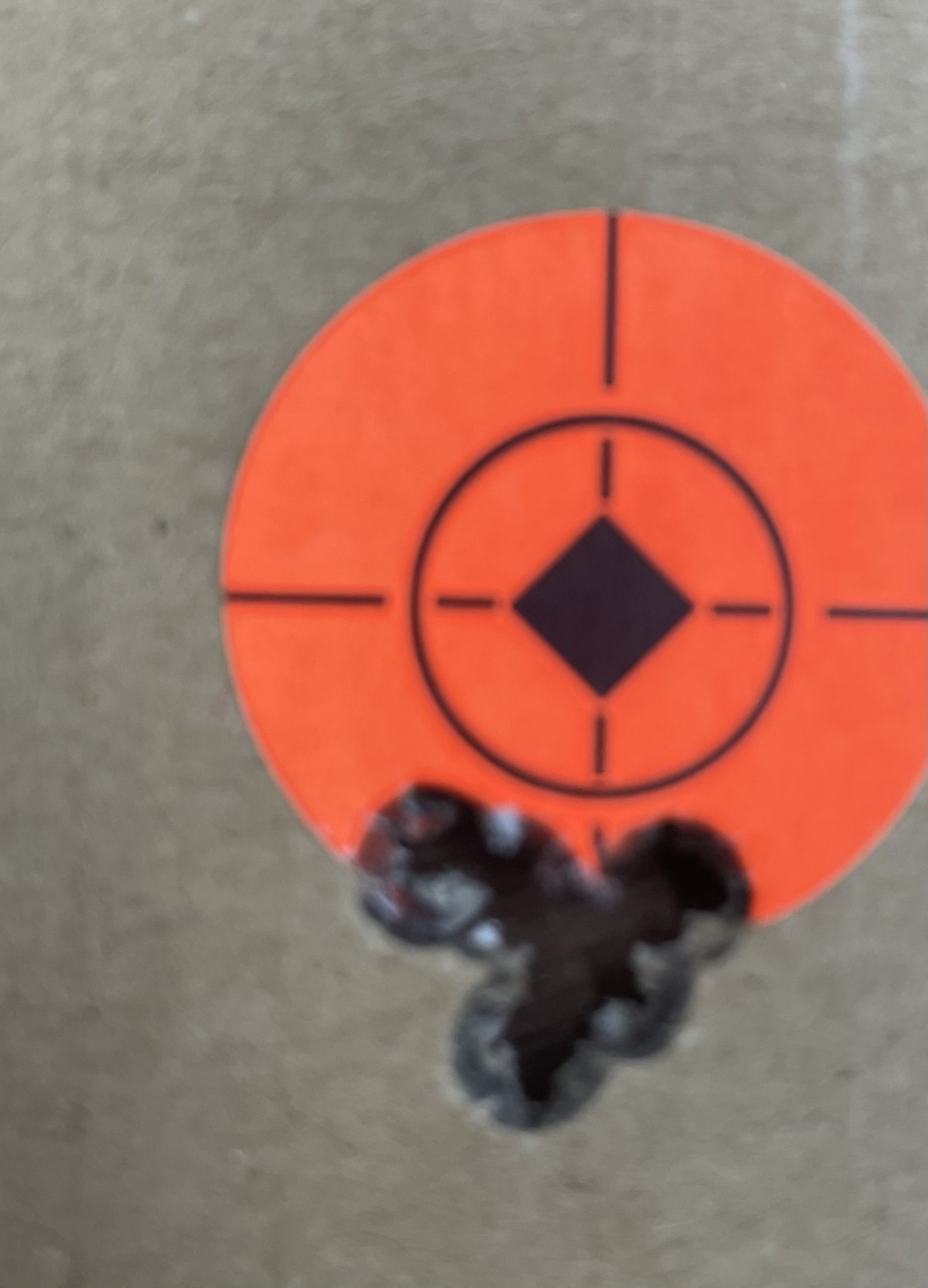

Shot a pile of old 223 ammo loaded for a different rifle. Breaking in the barrel, fed 100%
I put 500 rounds though mine last week on a ground squirrel blasting trip. Ran perfect all 5 days, zero feeding or ejection issues. No complaints-- it just works.

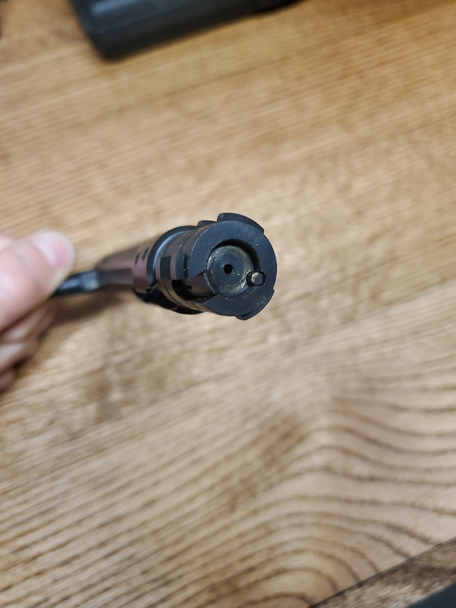

There were quite a few kits out and running before Greg picked up the project from Enrique and Gilbert.
I bought my kit around January of 2021. I got the last 223 bolt from Enrique, and the barrel from Greg showed up a couple months later.
It's worth the wait.

Ahhh, gotcha... I think I purchased mine the morning of the first day Greg went live, got my complete bolt & mag sitting here, but no tube yet... Which is fine, just wondering (not enough to bug him though).
Depending on what you ordered I got my tube last week (In stock barrel blank so no extra wait time). Ordered the same time as you.
