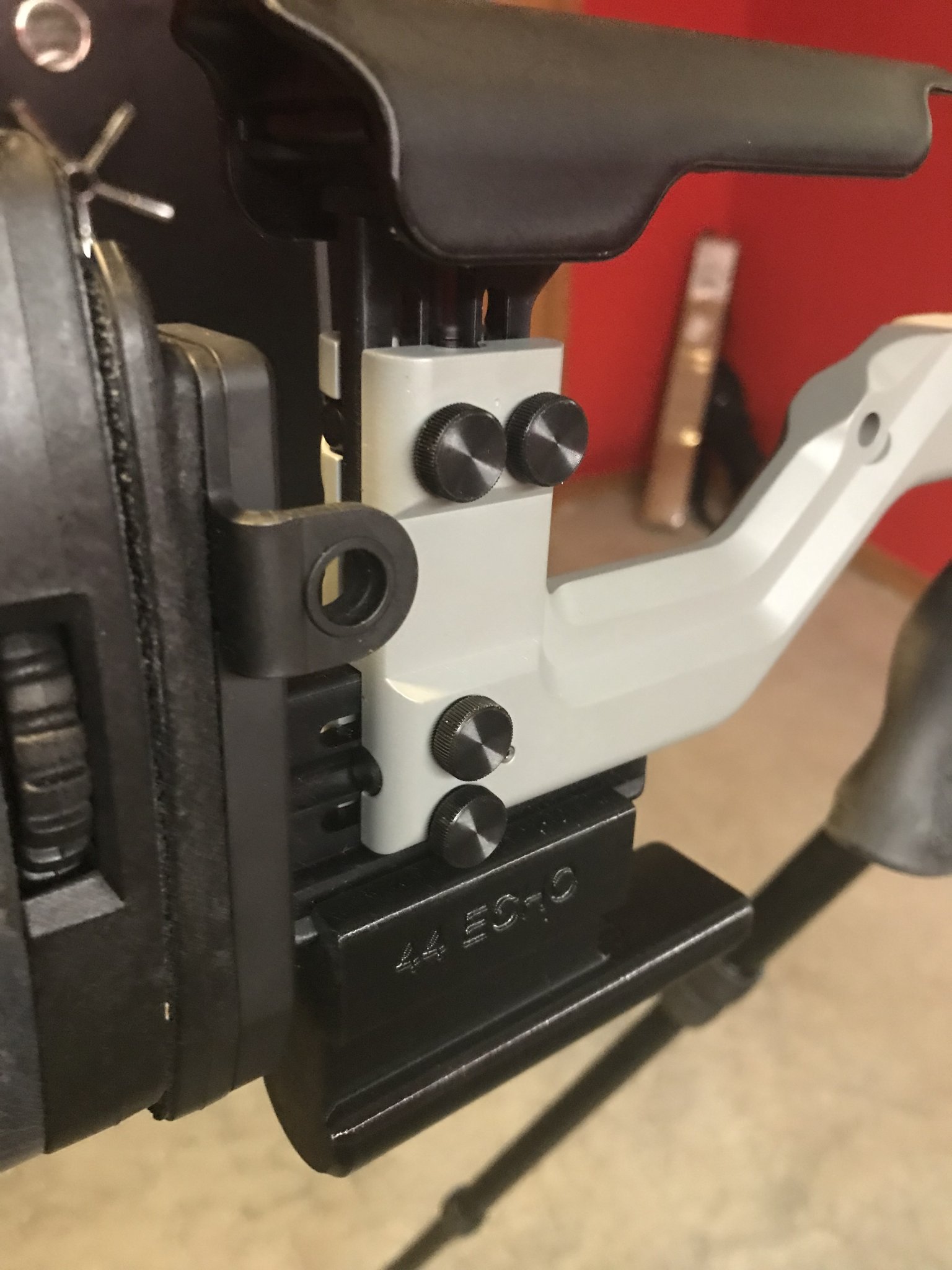

Found some stainless with black plastic heads using your measurement dude. Thanks
I don't recommend these, Plastic-Head Thumb Screws, Knurled, M4 x 0.7mm Thread Size, 20mm Long, Packs of 10.
The chassis is countersunk so it will pop the plastic heads off - leading you back to beginning where you need a tool anyways.
Are you sure your cheek rest and LOP is secured? The plastic bodies popped off when attempting to torque down just enough to remove play from the cheek rest/LOP.
Yeah so it’s seems you’re in to something. I didn’t really notice at first cause they were both all the way collapsed but there is a little bit of play in both the cheek riser and but pad no matter which thumb screws I use. They’re both staying well secured but a little slop on both so looks like it’s best to just stick with the factory screws. 😞
This was also my experience today with these.
Reactions: Tritiumdials
Hmm ok so we need to revert back to finding a black finish all stainless option to replace screws?...
Or you guys saying that none of them can be used?
None of the ones I bought worked. They cheek riser has some play in it either way. 😞
The original nickel plated screws I posted in my original post above I thought would work but they don’t seem to get tight enough to take out that play. The head diameter on the factory screw is 7mm and the counter sink on those screws are 8. I have 1 more set of different screws coming tomorrow that I’m gonna try and if they don’t work I’m just gonna chalk the idea. Nice thing about screws is they’re cheap but I’m running out of odor as and options.

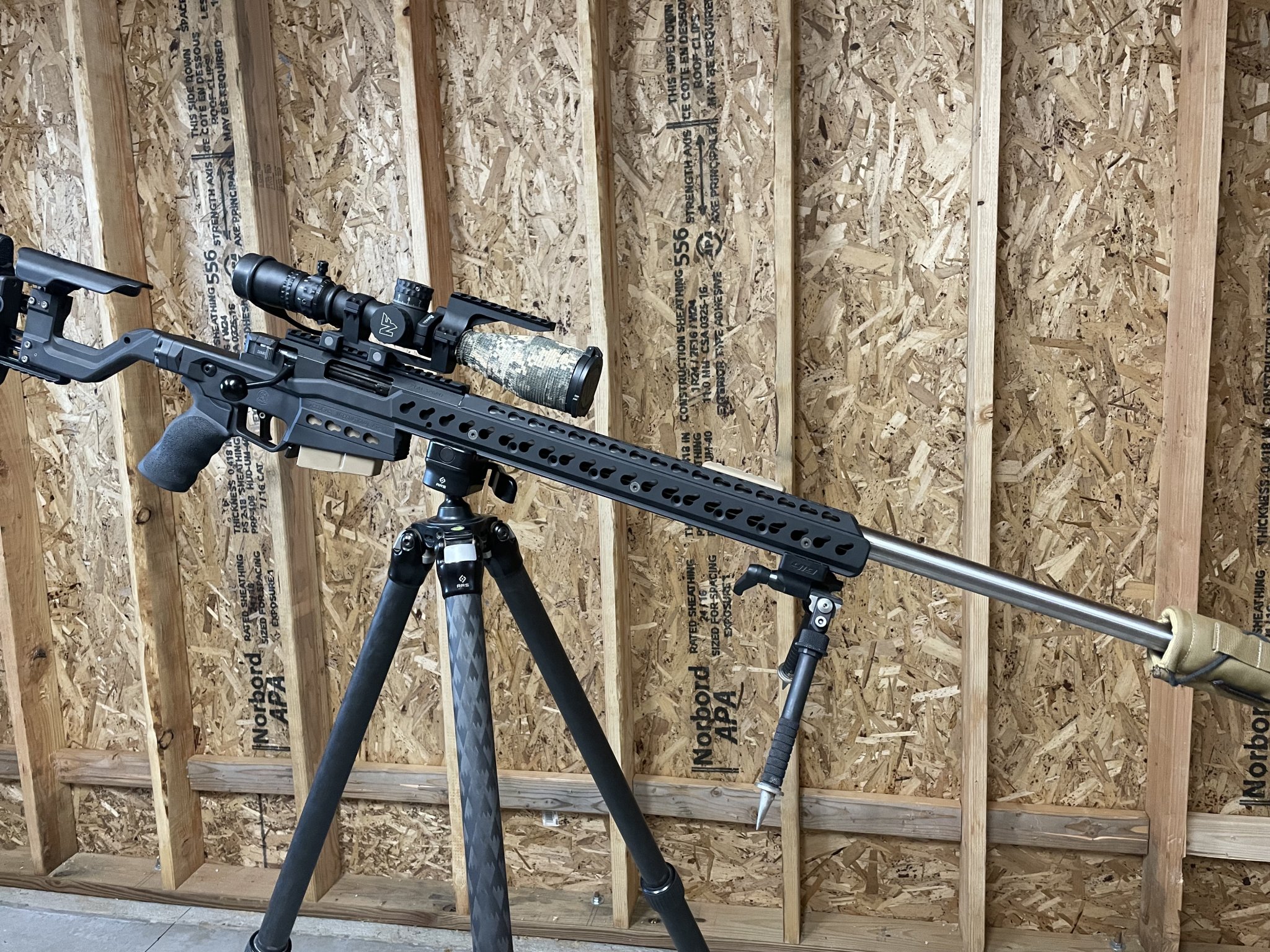

Just waiting on external weights and the RAPTAR mount now. Went with the black bridge instead of ES, but I think it’s going off to cerakote once I have everything anyway.
Taking it apart is not the most intuitive thing. Actually it’s really pretty tedious compared to 700 footprints. I guess they don’t call us elitists for nothing.
What suppressor is that?

I ordered these ss M4 threaded standoffs in 3 and 4 mm lengths to try with the black thumb scews from McMaster-Carr.
Reactions: Darkside-Six

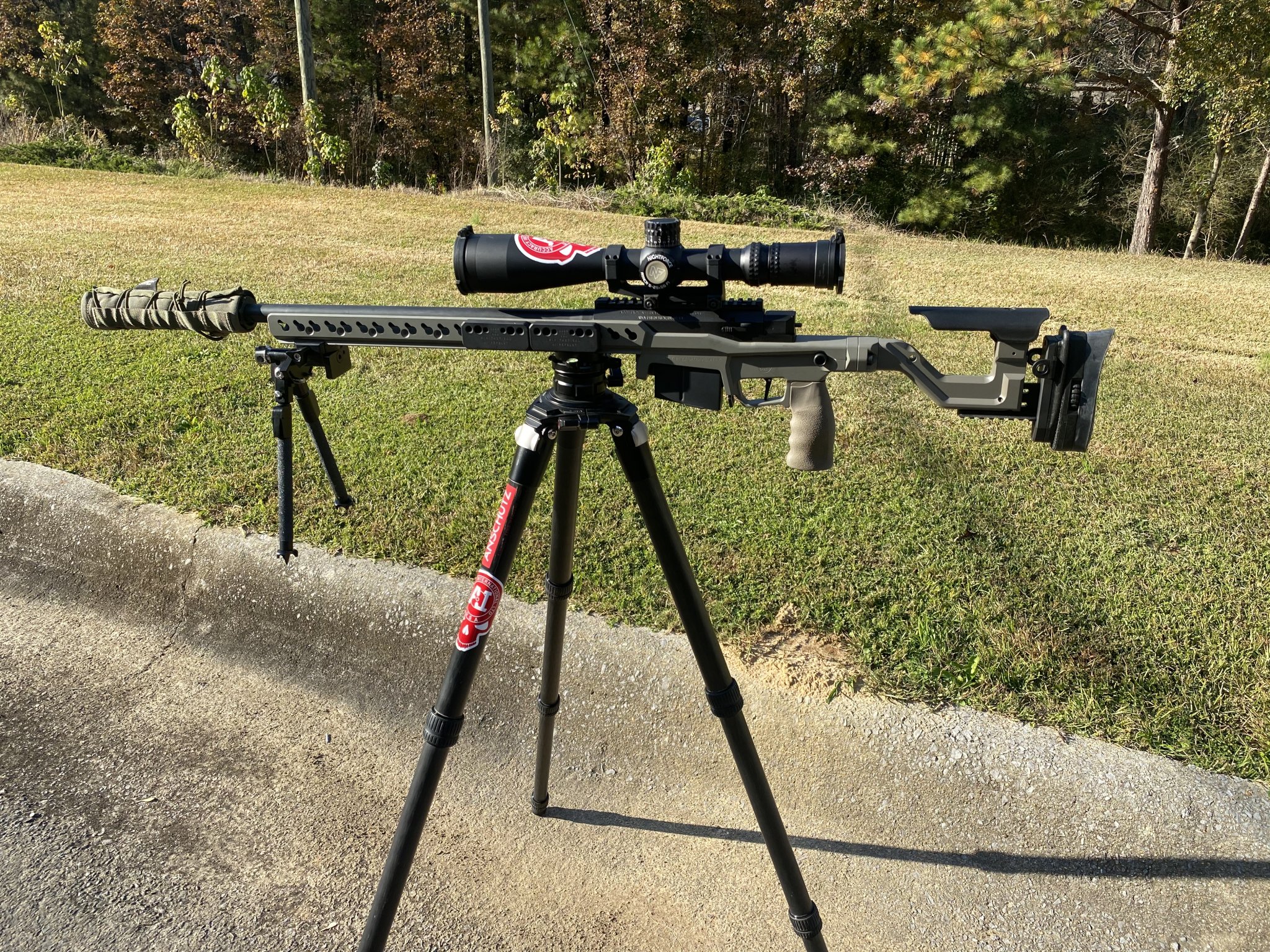

Looks like with the 20moa full length top rail we do need the high at action rail?
To match you do need the high action rail
I’m using the stock one for a variety of reasons. Also When the short bridges come out I’m just gonna use the short rail placed in the right place for my NVD
Reactions: 96C
I suppose it would work good with 1.5" rings and a 1.35" thermal the way it sits now.
