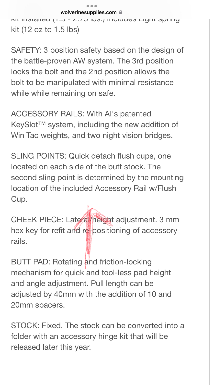

Just reading the description on the Canadian importers site, looks like we will get a piece of pic rail with the rifles in Canada.
anyone received there’s yet to confirm?
Thanks
I’ll receive mine next week and post what is included with the rifle here in Canada.
The accessory rail with flush cup is not included with the AT-X and the butt spacers are also not included.

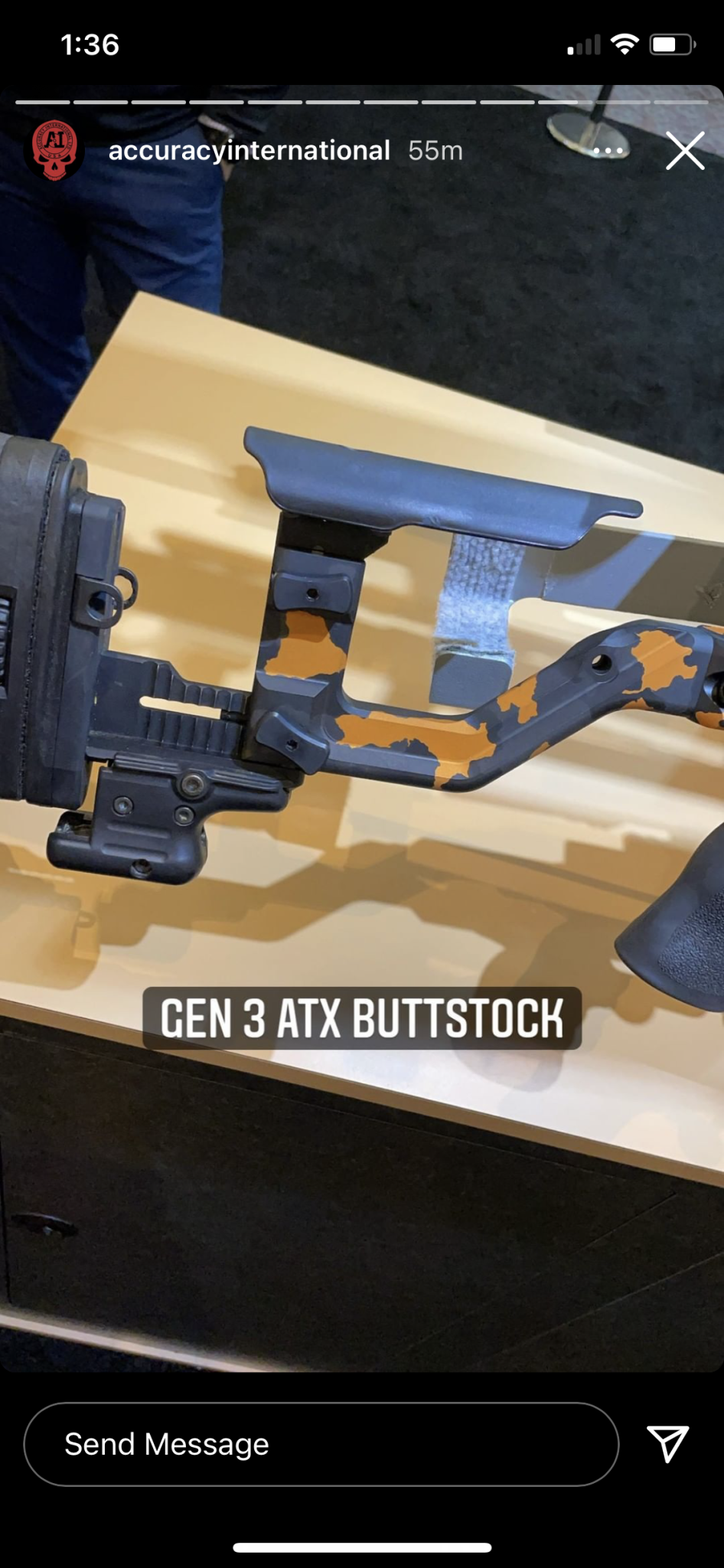

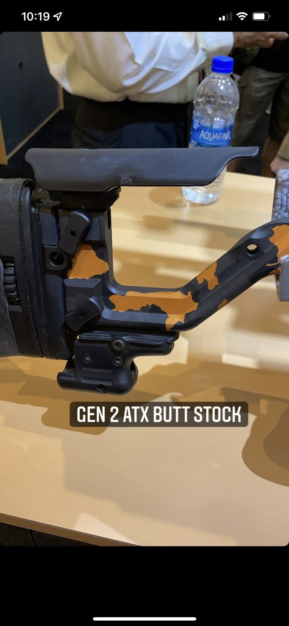

Ummm..the Gen 1 extends. Like a dumbass, I added spacers to the rifle (had extra ones from my AI-AT) without even thinking about it, and then put it up in the gun rack. As I was sitting at my desk in my office, I looked over at the rack, and saw the two screws on the buttstock. Well shit. Got out a wrench, and sure enough, it extends. So, took the spacers back off.
Ummm..the Gen 1 extends. Like a dumbass, I added spacers to the rifle (had extra ones from my AI-AT), and then put it up in the gun rack. As I was sitting at my desk in my office, I looked over, and saw the two screws on the buttstock. Well shit. Got out a wrench, and sure enough, it extends. So, took the spacers back off.
We’re joking around at AI’s expense since we’ve been waiting for the guns and accessories. To be fair, they did estimate EOY 2021 when they did their livestream—but it looks they had the hinges and asr stocks done for a while.
That’s not the hinge. That’s an actual ASR stock on it. Gonna be a lot of pissed off people if that comes with he chassis but not the actual rifle. 😂😂😂😂
It’s a prototype and we used whichever parts we had in order to test it. The Tikka AICS versions are not yet ready for sale but will be after we complete testing. This is only a month away.
The Tikka, REM 700 and AT-X Gen 3 rears will all have a thumbscrew adjustment for cheek piece and LOP. An example is on show.
Tom Irwin
Accuracy International
Reactions: Darkside-Six
Will all of us waiting for a rifle in “Batch 2” get the thumbscrews? The suspense is killing me…. 🤦‍♂️
The second production AT-X in the USA will have the same rear as the first production.
It will be the third production run which has the thumbscrews. That is not the only change. It is a completely new rear end and is also compatible with the AICS versions just being released or about to be released.

The new thumbscrew adjustable rear is compatible with the first two production standards. We wanted to get the AT-X into production as early as possible and the first designs had the rear with two screws for cheek piece and LOP.
All AT-X rifles and AICS is easily fitted with a hinge which can be ordered now as an aftermarket accessory.
