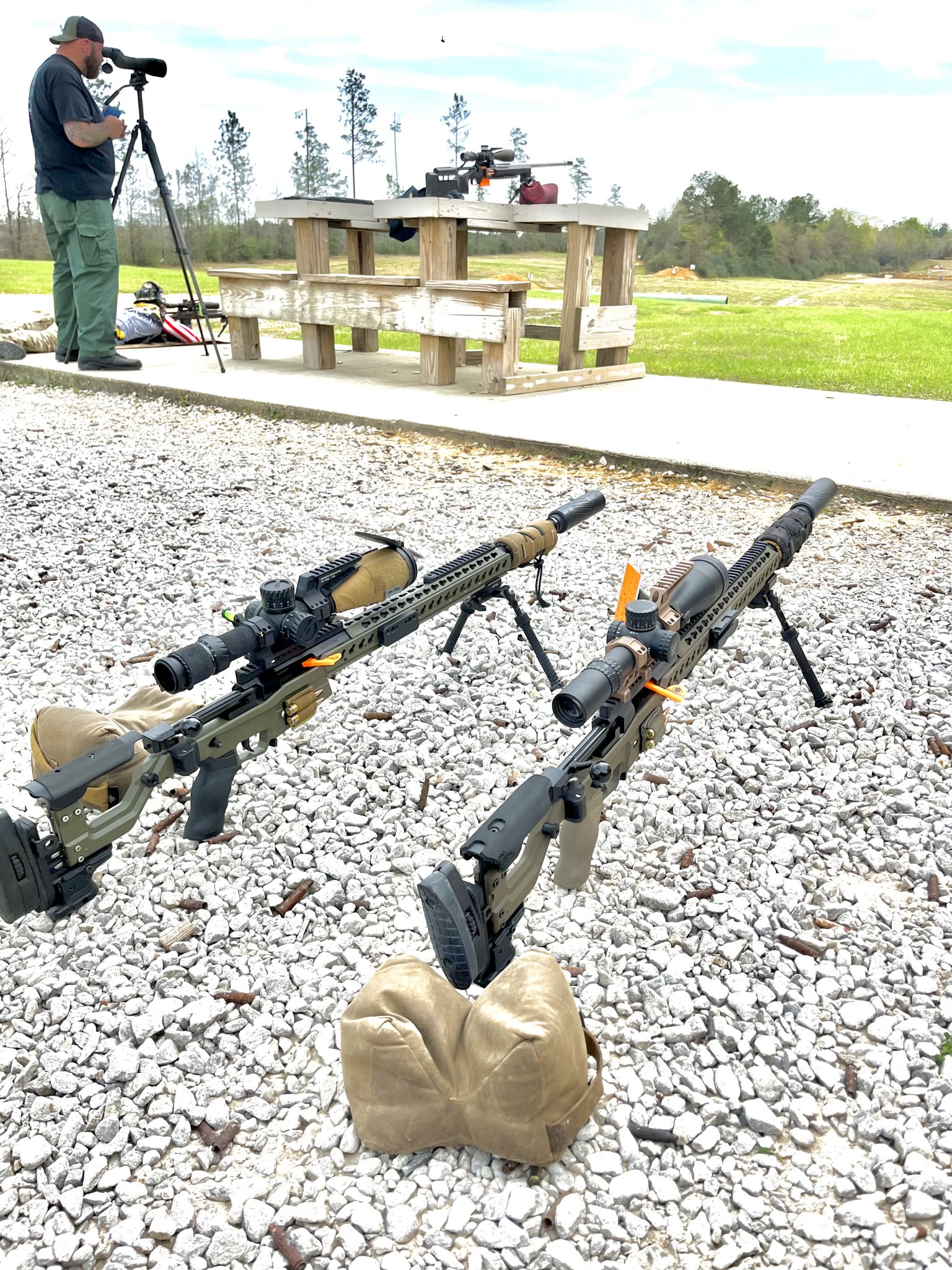

22GT hammered this weekend. Fed and performed flawlessly, any misses were solely on me. Love this thing more and more every time I shoot it.
28” Brux, 6.5” twist, running Berger 85.5s right at 3100.
What weights do you have in that (other than the obviously visible forend ones?
Im guessing you have one of the steel but spacers to balance it out.
Do you have any barrel channel weights?
Yes, 4 sawtooth weights per side and all 3 internal AI weights. No weight in the rear except a more recently added sawtooth bagrider.
It’s a tad front heavy at 28” + suppressor but that’s my preference. Total weight configured like that is like 28.5-29lbs.
A little overkill for most and realistically could probably get away with 4 external weights total without much difference in feel or recoil.
It looks like it'd be very front heavy, I guess it still balance under the row of weights so not too bad.

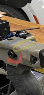

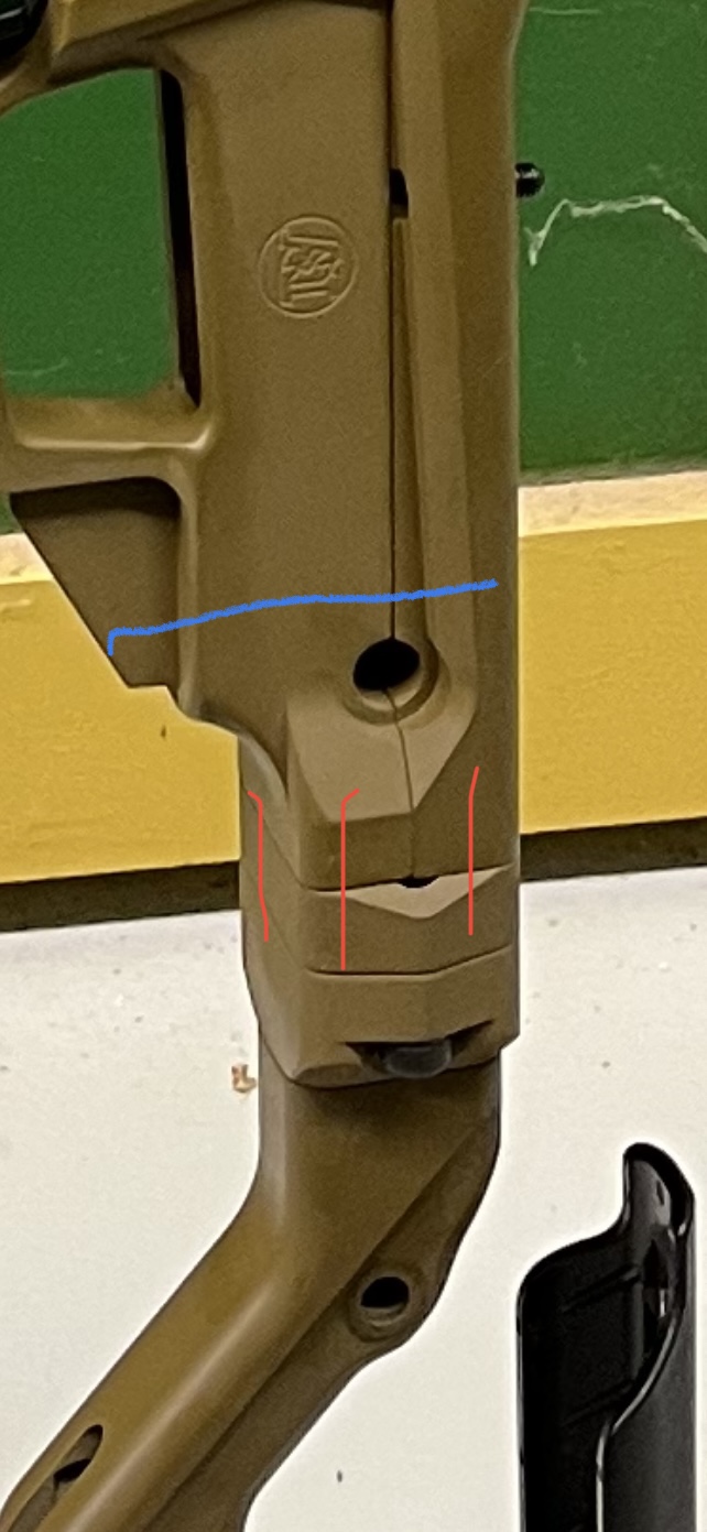

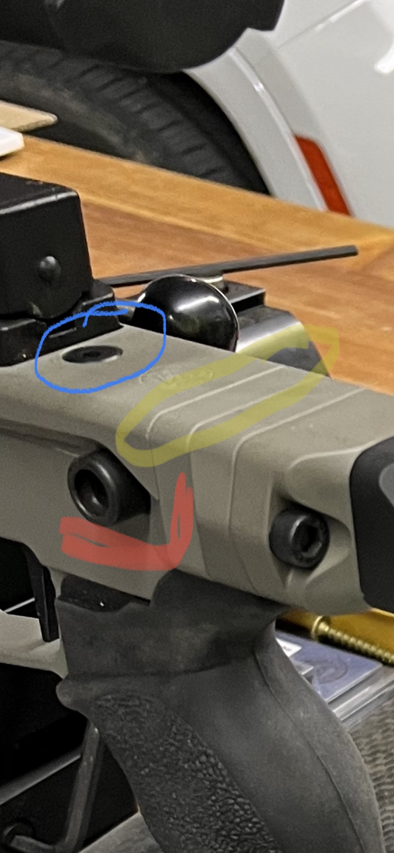

Anyone have a diagram or can tell me how to take apart an early gen 1 ATX? I don’t have the screw by the rear tang.
I just need to get the trigger out. Just shot a 2 day and it’s starting to feel like it’s losing some adjustment on the 2nd stage.
5 min with the 7 axis Dremel... Have it turned into a gen 4 in no time
Pull the buttstock off first. The two 5mm hex fasteners, then the 4 4mm hex behind it. Then pull the grip, under the grip is access to the rear screw. Front screw is through the mag well. Have to pull the QD cup as well iirc

The early ones require more work to take apart to access something simple like the trigger. Makes no sense. These are things that should’ve all been checked with shooters before release 🤦‍♂️ makes me more inclined to use my AI AO instead.
So there are more changes to the screw layout on the different versions as well?
I was only under the impression the butt stock was different....
What all is different if you order one today vs being one of the folks that waited a year for one in the beginning?
Gen 1.5 and 3 only require 2 fasteners to be removed to say work on a trigger and they are easily accessed. The gen 1 requires 8 fasteners to be removed. 6 if you have a hinnge installed.

Anyone got a side by side comparison on the screw set up?
Or a parts explosion?
I'm genuinely curious
Only pictures I have on my phone at the moment.
the original early model (DE chassis)
Fastener location in red. These four need removed and then grip is removed to access rear chassis screw marked in blue
Fasteners marked in red are accessed by removing the two fasteners holding the buttstock adapter together (fixed models).
Folder you just fold it and the four screws are accessible.
Four total screws, two go into the upper part of chassis, two into the lower.
Gen 3 (ES chassis picture) you just remove the fastener marked in blue. Red indicates lower chassis, yellow shows where the upper and lower separate after removing fastener marked in blue.
Both chassis have the same fastener location up front on the front of the magwell
