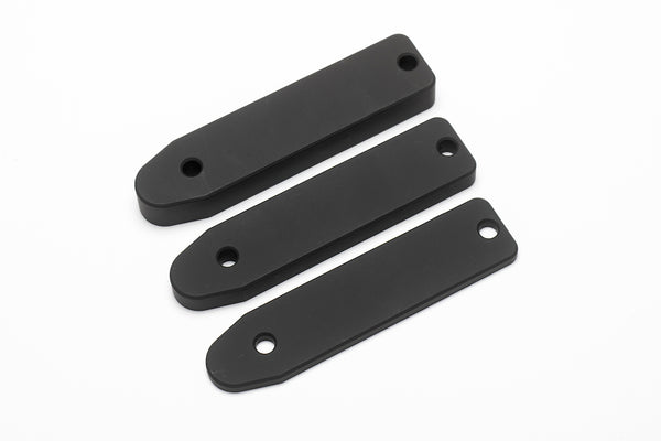

What weights do you have in that (other than the obviously visible forend ones?
Im guessing you have one of the steel but spacers to balance it out.
Do you have any barrel channel weights?
Yes, 4 sawtooth weights per side and all 3 internal AI weights. No weight in the rear except a more recently added sawtooth bagrider.
It’s a tad front heavy at 28” + suppressor but that’s my preference. Total weight configured like that is like 28.5-29lbs.
A little overkill for most and realistically could probably get away with 4 external weights total without much difference in feel or recoil.
It looks like it'd be very front heavy, I guess it still balance under the row of weights so not too bad.
