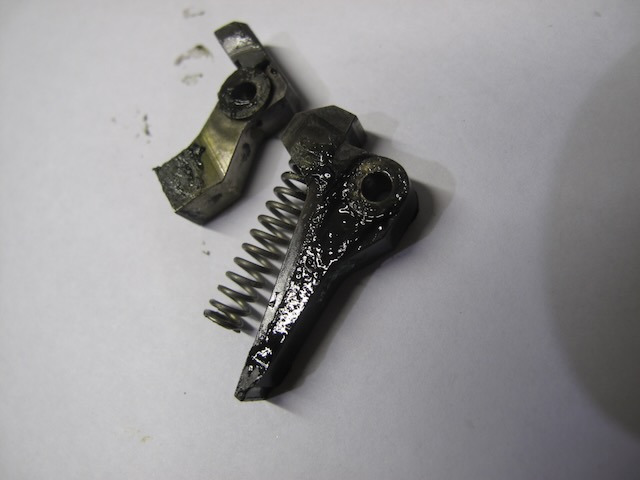

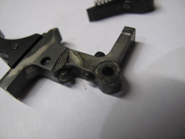

AI trigger parts out of a police rifle.
View attachment 8108769View attachment 8108770

Now, don’t go thinking you can take the trigger apart as shown in the pics by Scott. Only Mile High/ AINA has the tools for that type of job.

  • A radius was added to the tip of the upper sear similar to that recommended by ADG. This further reduced friction and aided reset reliability.
  • Parts exhibiting poor machining were lapped to remove burrs and improve surface finishes.
  • Reset springs were replaced with higher force springs.
During the latter half or 2022 these measures were implemented in the production triggers, and everything was great except for one thing. In a small number of AT-X rifles the larger .024" reset spring (much higher force vs the .020" spring) would stop the firing pin from releasing. The firing pin spring on the AT-X is a lower force spring vs the AXSR and in instances where tolerances all line up this can result in failure to fire. We have settled on a .022" reset spring and this has provided complete reliability.
To recap, in the past five years we have shipped either as replacements or as standard equipment in the AT-X several thousand comp triggers.
Including Chris Way's trigger we have had 38 comp triggers returned for all reasons. This represents less than 1% of production, but we want that percentage reduced as close to zero as possible.
In the same time period we have had 10 AI triggers returned, and 3 AXSR triggers for all reasons.

Thanks for the response Scott and I can tell the community that I do have a tracking number on a return trigger. Not sure if it's a new trigger or the same one I sent in but regardless it should be here tomorrow. I never intended to start a shit storm and I don't know if that's why AI responded early Monday morning or if it was just how things worked out. I can tell you mine might have been one that showed up dirty and oily because Oklahoma is dirty when it's dry and the wind is blowing. My trigger was the only one to fail in my squad and the only AI rifle in the squad. Another squad member and myself tried everything to bring it back to life mid match without tearing it down. I'm not sure that I believe your failure numbers but I really hope that I was just one of the unlucky ones. Again thanks for taking the time to address this publicly.
And this would be Charles? If so, the comments on your trigger in the RGA log are as follows:
"Failed to reset. Excessive oil, dirt, and grit inside the trigger housing. 2nd stage force screw was bottomed out."
With the 2nd stage screw at max force, I'm not surprised it would not operate with the material accumulated inside. This trigger was completely disassembled, cleaned, reset spring replaced, lapped, and assembled completely dry. It's set at 1.5lbs total pull weight. I went full house on that one and I don't think you have any more problems with it if you leave the adjustments alone.
