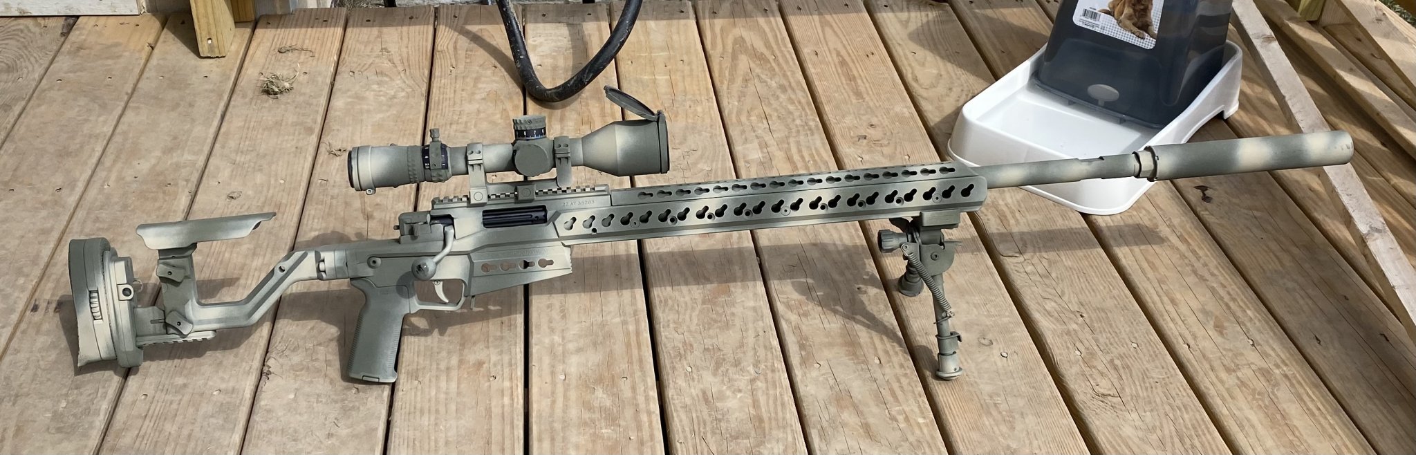

Thumb rest made out of bent aluminum. Covered with a layer of gorilla tape. Fastened to rifle with double stick foam tape and has a hole drilled to fit under the adjacent bolt. Cheap and effective. I like the thumb rest higher than one attached to the grip. I went back to the factory ergo grip.
When I hit the frank and Marc class, one of the comments was all shooters are also machinists. Nicely done, I wondered myself about using that back bolt or 3d printing something

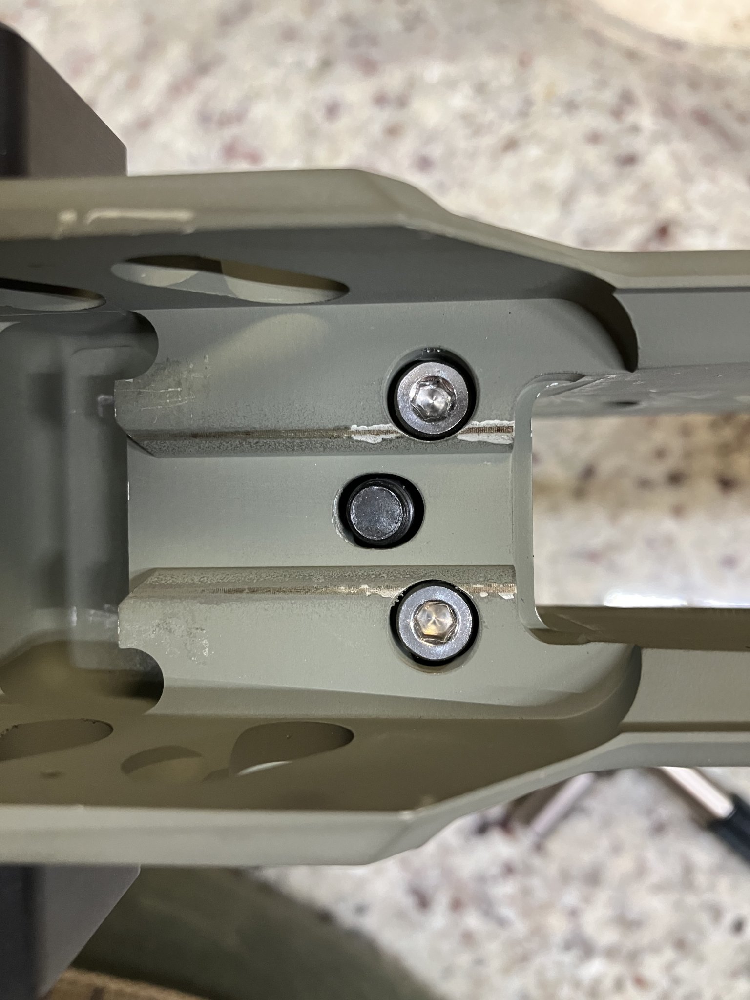

Anyone running the R700 version of the AT-X chassis have issues with the action screws coming loose? I followed the torqued spec and tightening procedure specified in the manual, but my screws seem to starting coming loose after 40-50 rounds. I have almost 200 rounds on the chassis and would like to avoid skim bedding it, but I can’t think of any other solutions.
Just finished 3 matches 500ish rounds and still tight. Origin action with the supplied action screws.
Check your actions screws as they were flip in one of my chassis. The longer one should be in the rear for the tang. Mine was in the front which prevented bolt close and rear was barely engaged with the threads.
Reactions: Overclok79

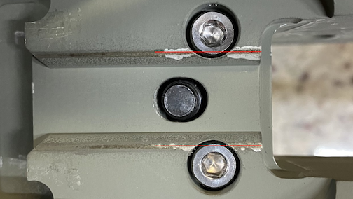

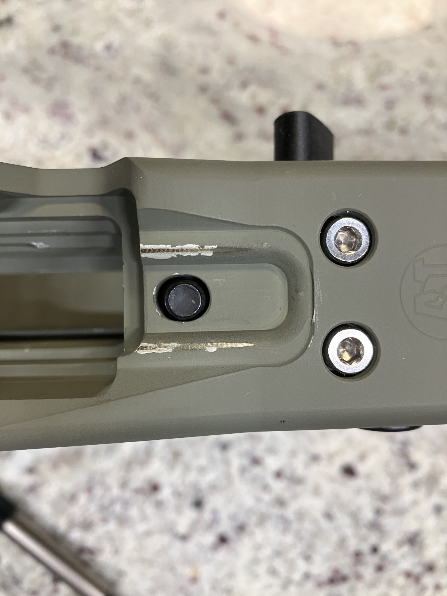

My screws look to be the same length. Front screw sticks up .20”, rear screw sticks up .21”. I would expect +\-.01” to be well within tolerance for screw length. Id have to pull the barrel to check the front screws thread engagement, but the rear screw looks good. If I went to a custom sized bolt I could get maybe 1 extra thread, but I don’t think that would save it. The wear pattern on the engagement surfaces of the chassis looks fine, if anything the right side is slightly more worn than the left. However the contact patch is the same length. I’m baffled, so I guess it’s time to send Mile High an email

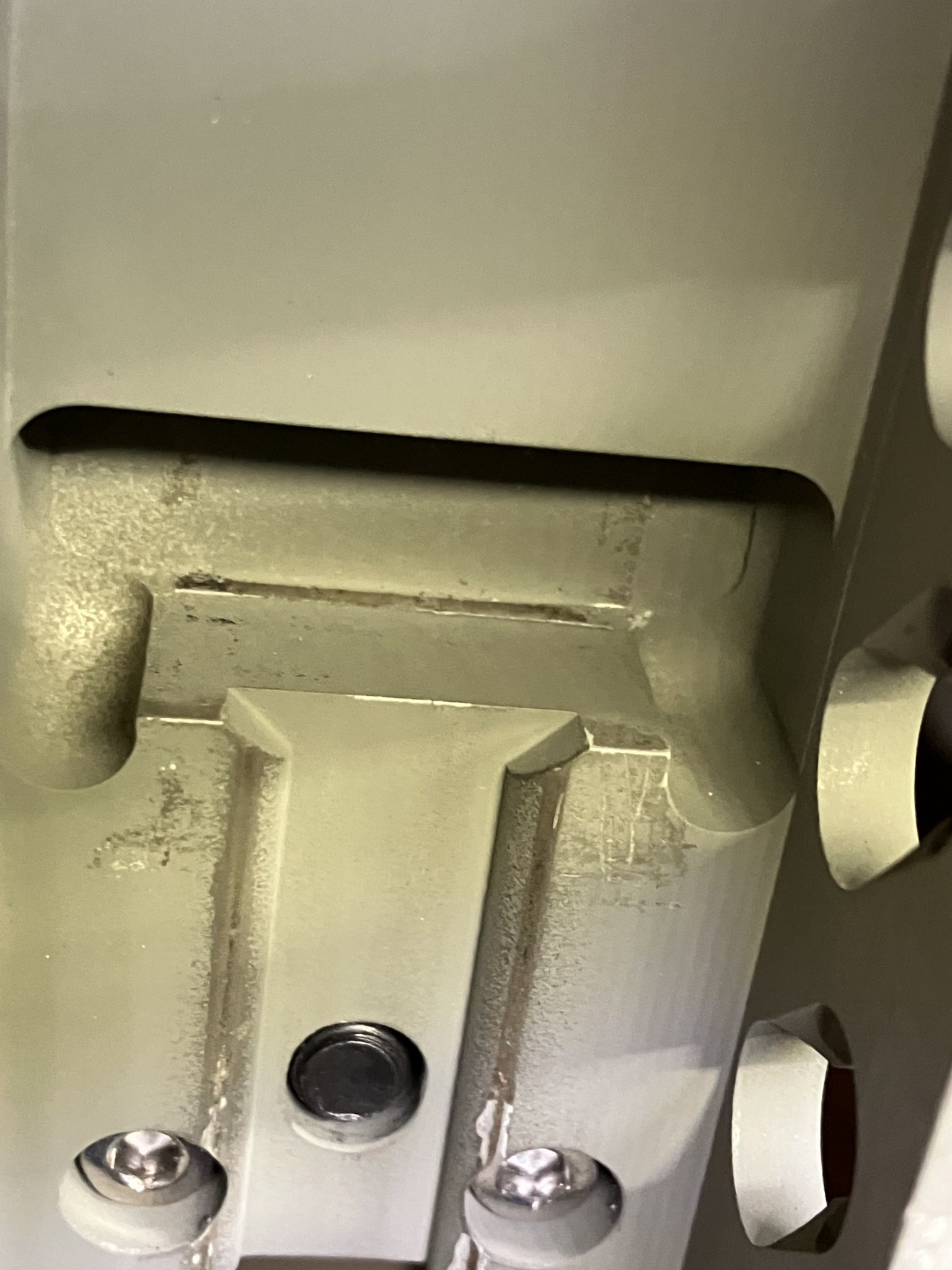

I think I found my problem. There is a step in the recoil lug pocket so only the bottom tip of the recoil lug is contacting the chassis. You can feel it when you insert the barreled action. Using a piece of paper as a feeler gauge, I was able to confirm the recoil lug does not bottom out in the pocket, so I think this step is the source of my problems.
Reactions: MxTexas

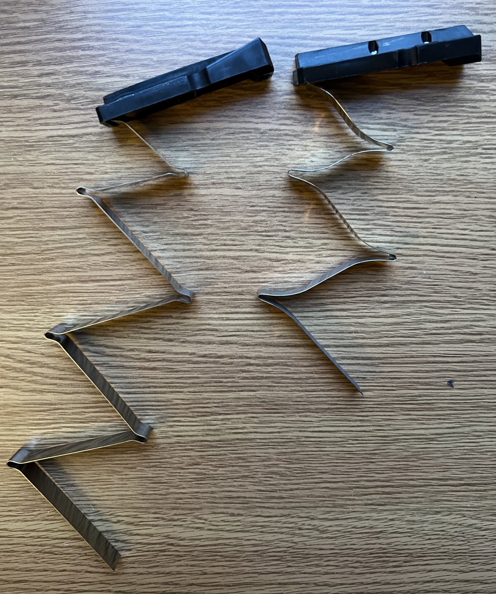

Not sure about AW mags - I sent in AX mags and they adjusted the feed lip geometry. Didn’t say that it was specifically done for the AT-X or anything, just that mine were “significantly” out of spec.
They did also replace the springs/followers, but I have no way of knowing if they were the “new” style or if they just replaced them. They do seem to have a little more tension on them, but that could just be me justifying why they seem to feed better now.
As I’ve said in previous posts, sending mags in to have them checked is reasonably quick and painless… seems like an obvious thing to do if you’re having any issues whatsoever.

This is the new updated spring/follower on the left.

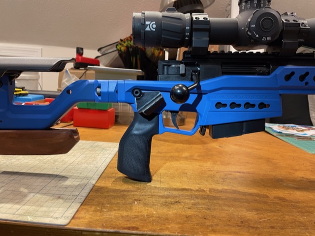

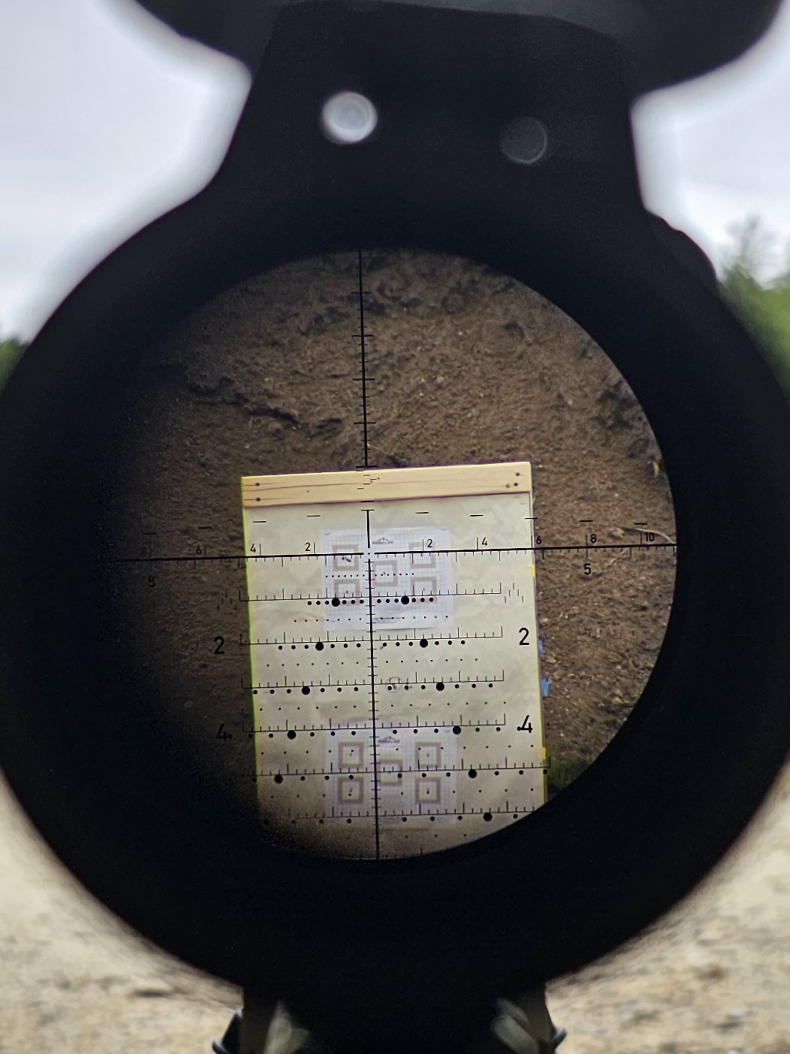

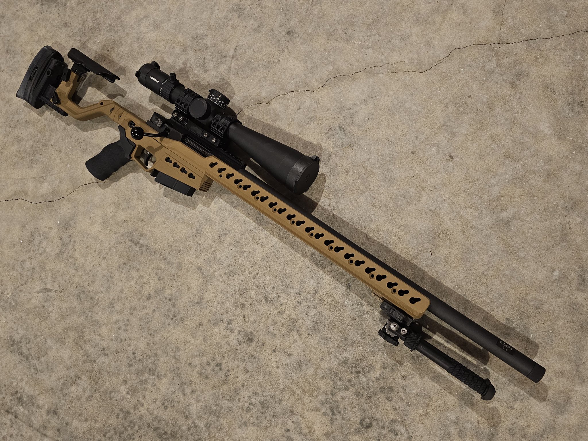

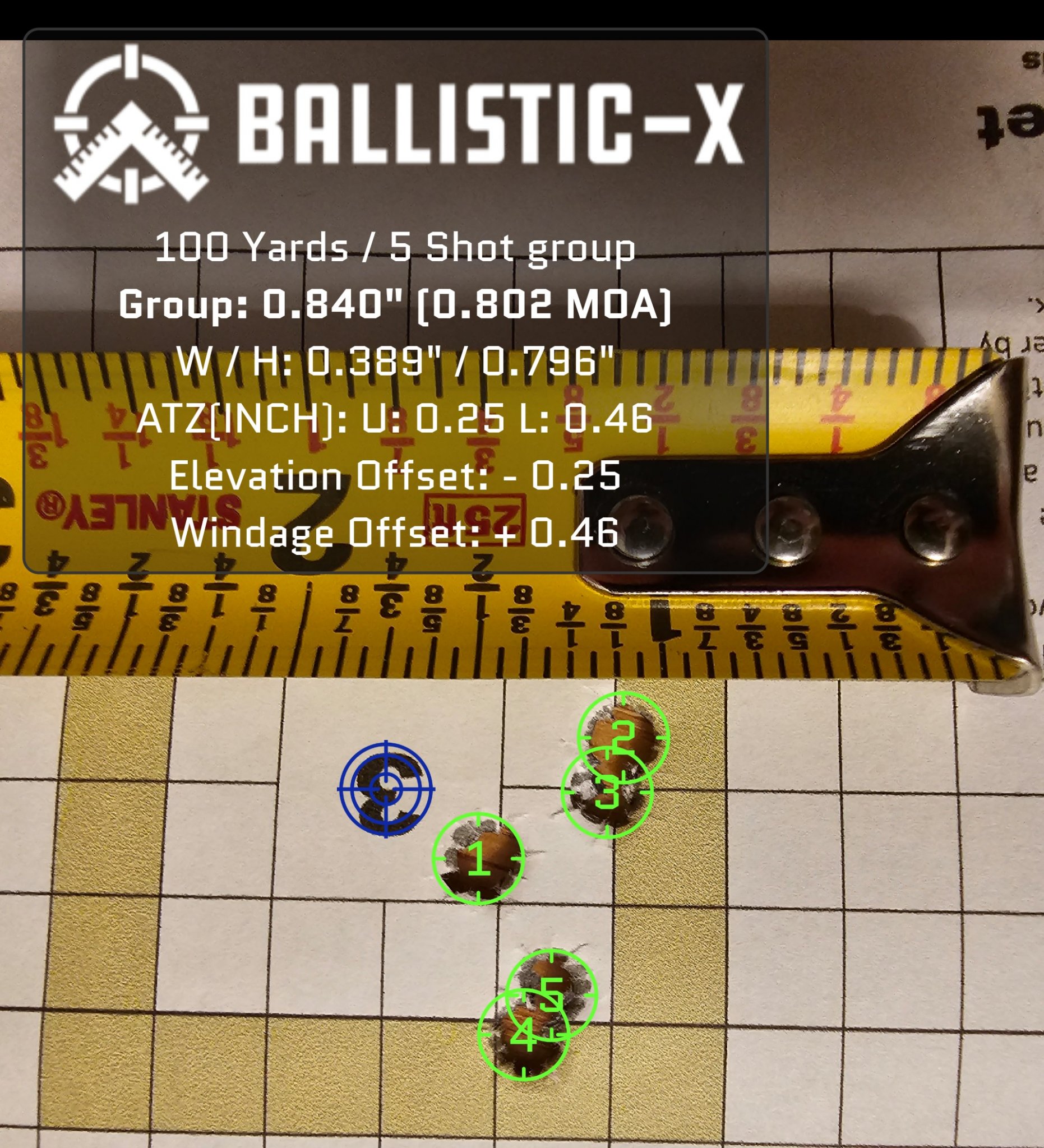

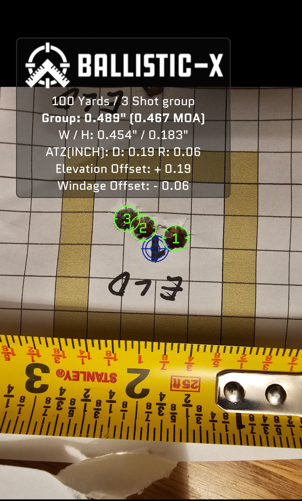

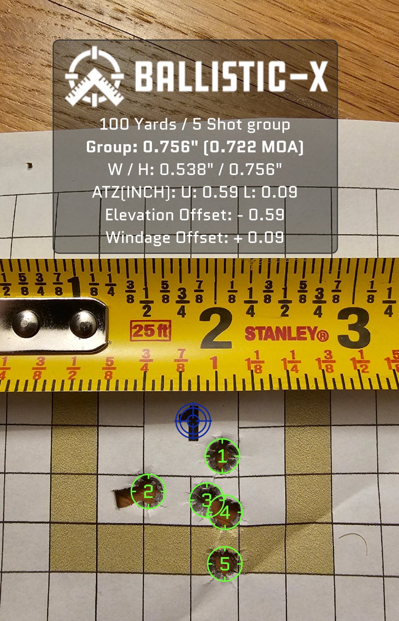

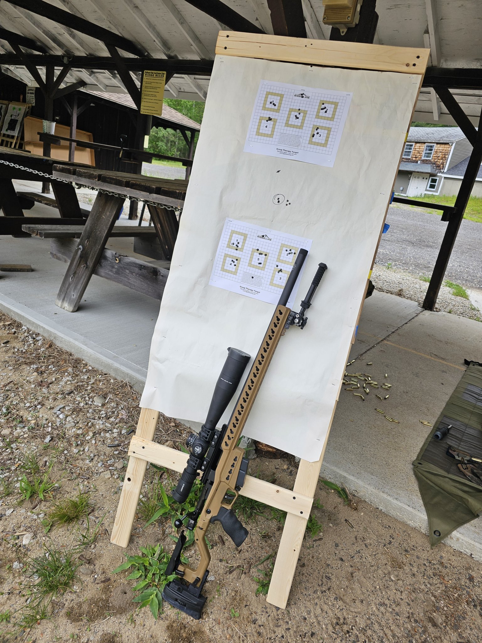

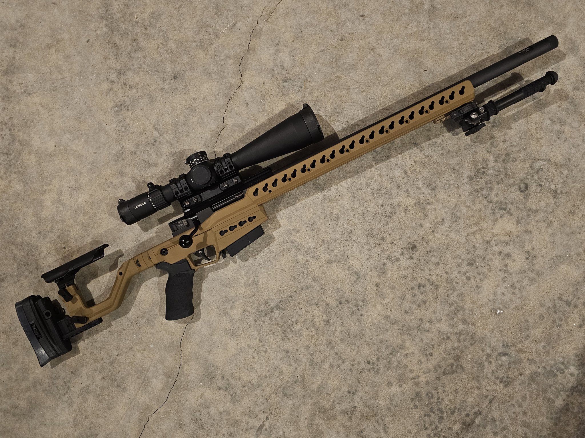

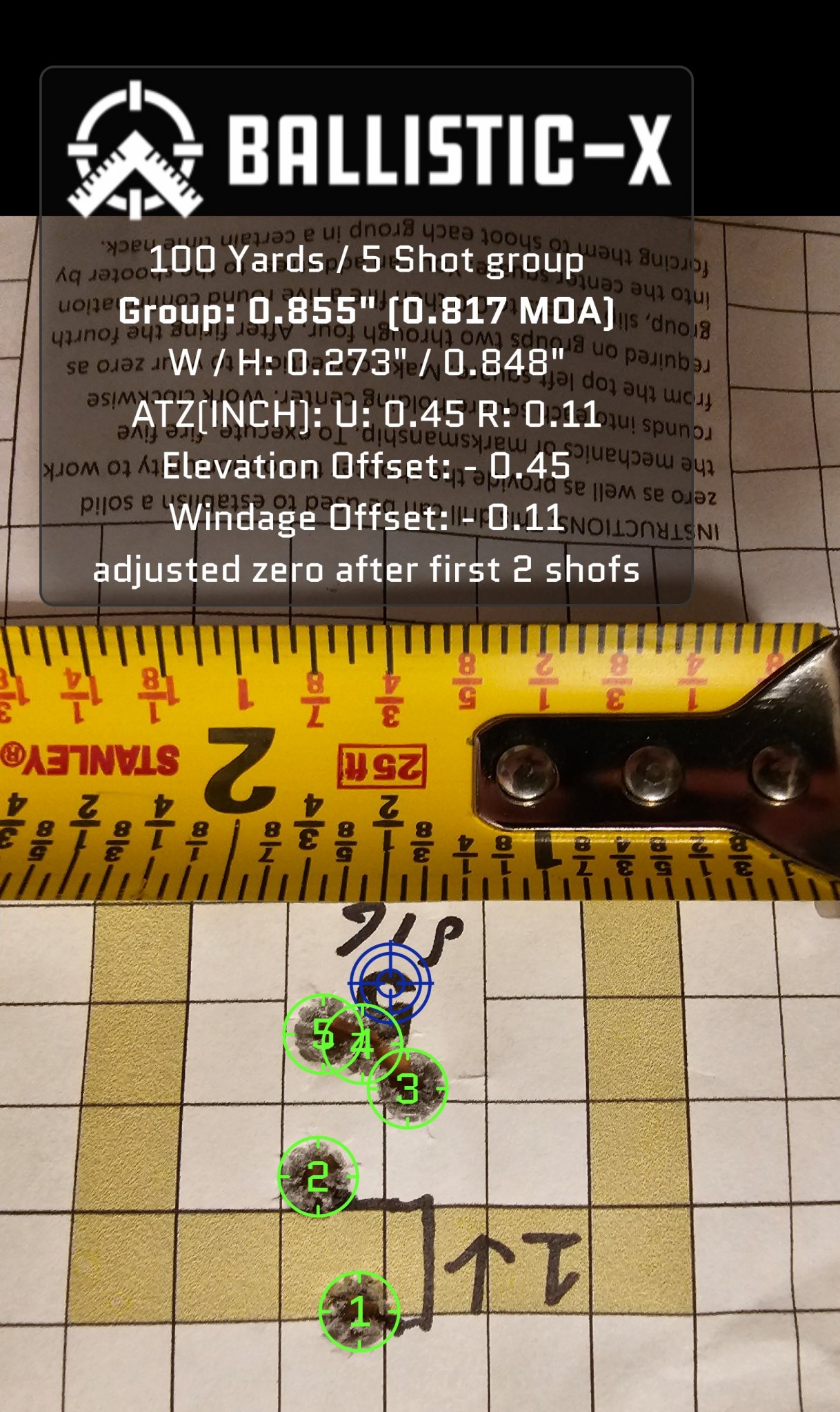

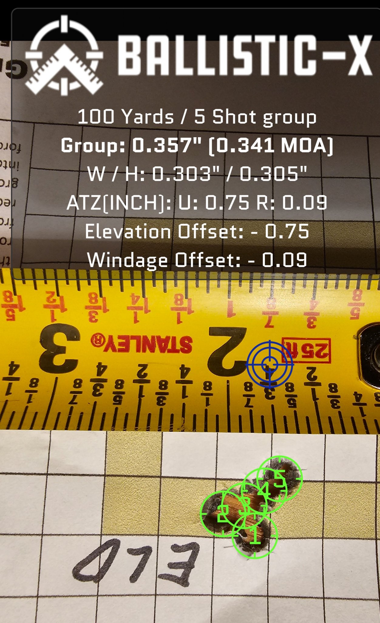

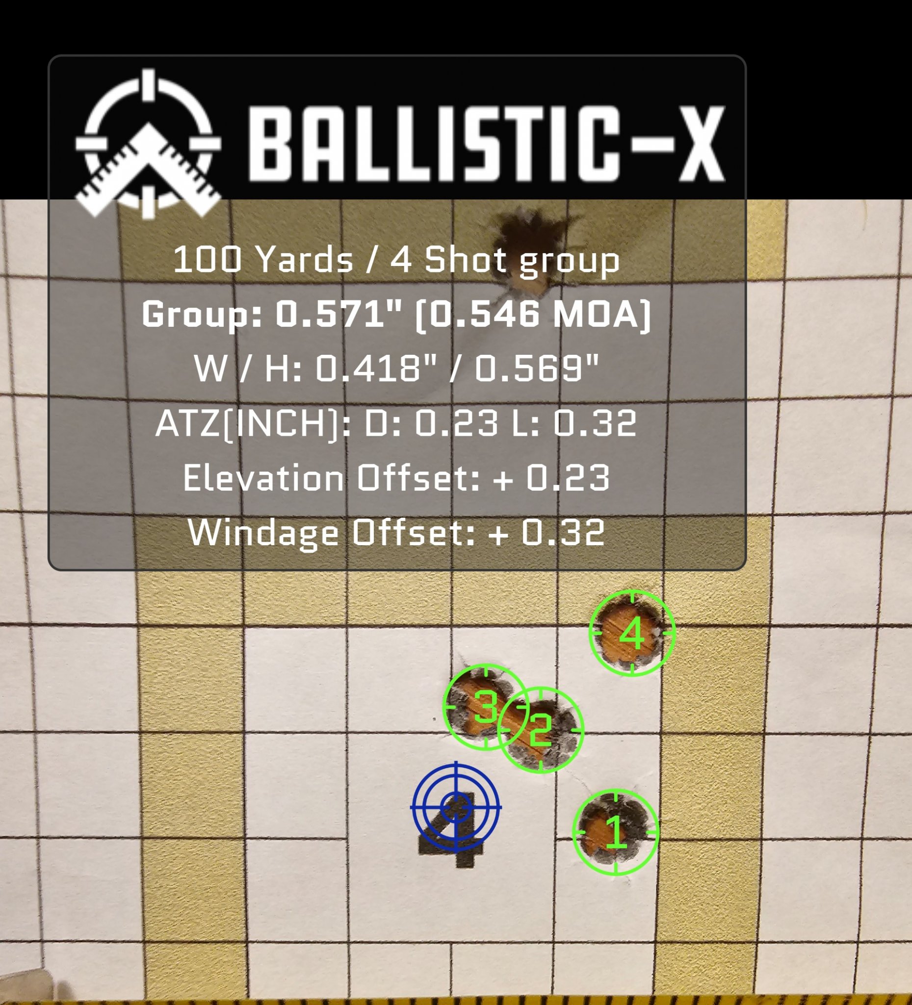

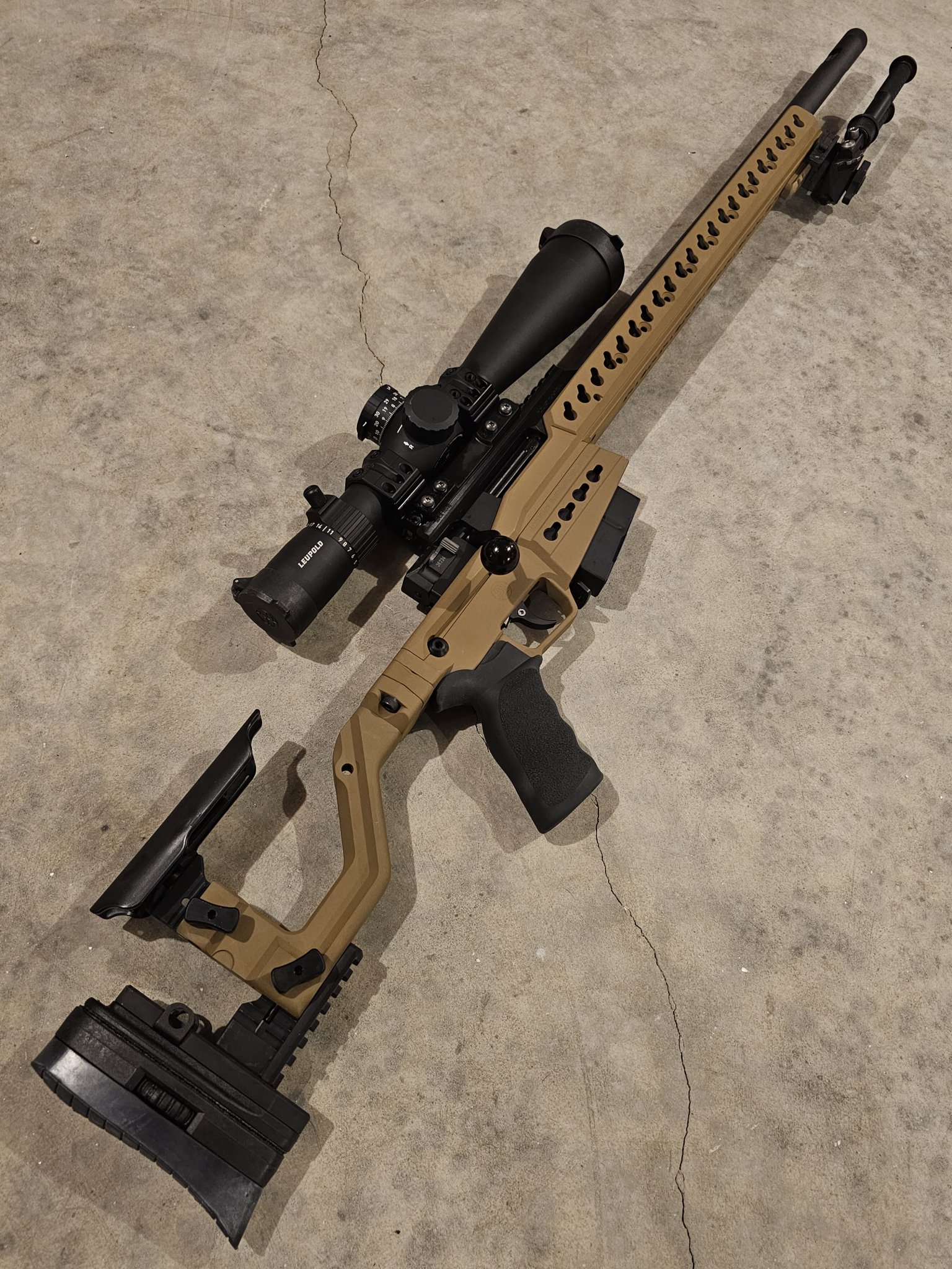

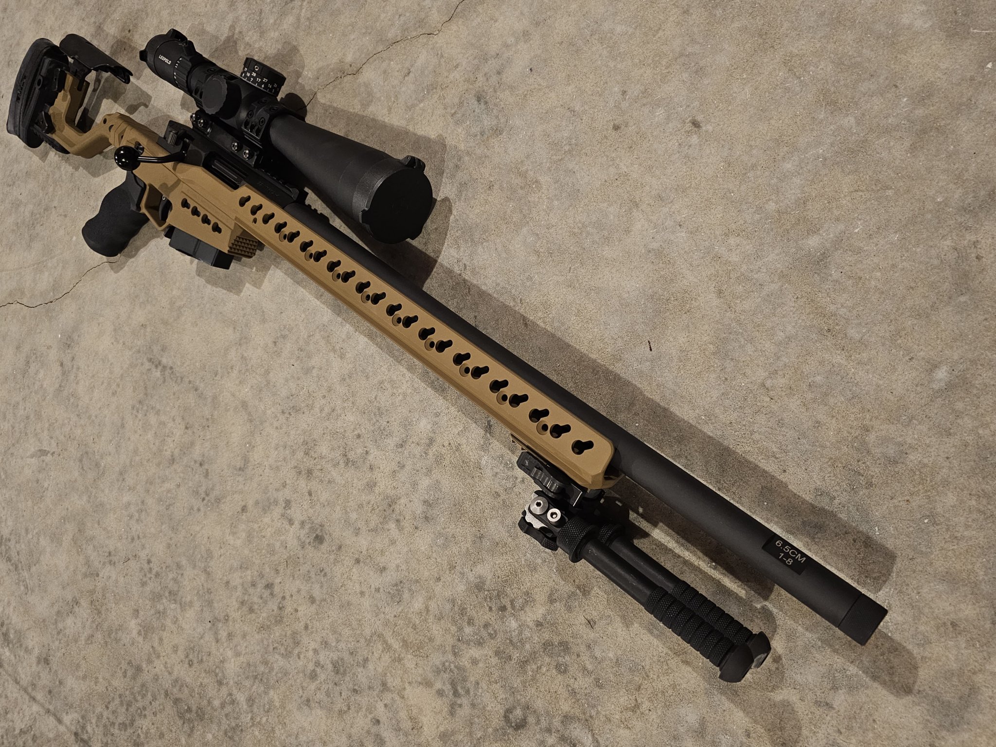

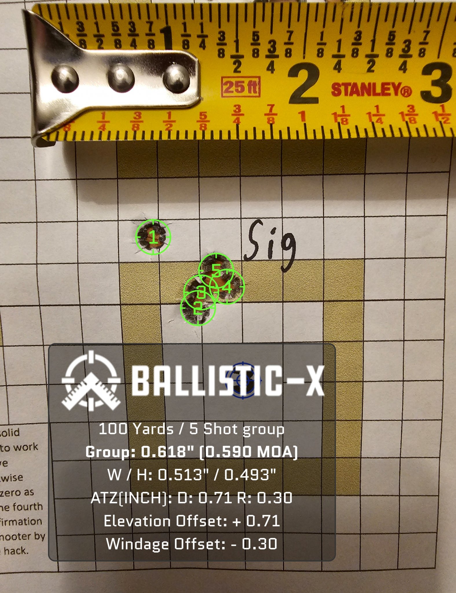

Had my first outting with the AT-X getting zeroed. This gun is a cheat code. When I'm doing my part is lays down some serious groups. Even when I'm not doing my part is still groups incredibly well.
Used 140 grain Hornady ELD and Sig 140 grain match ammo.
Looking forward to stretching it out!

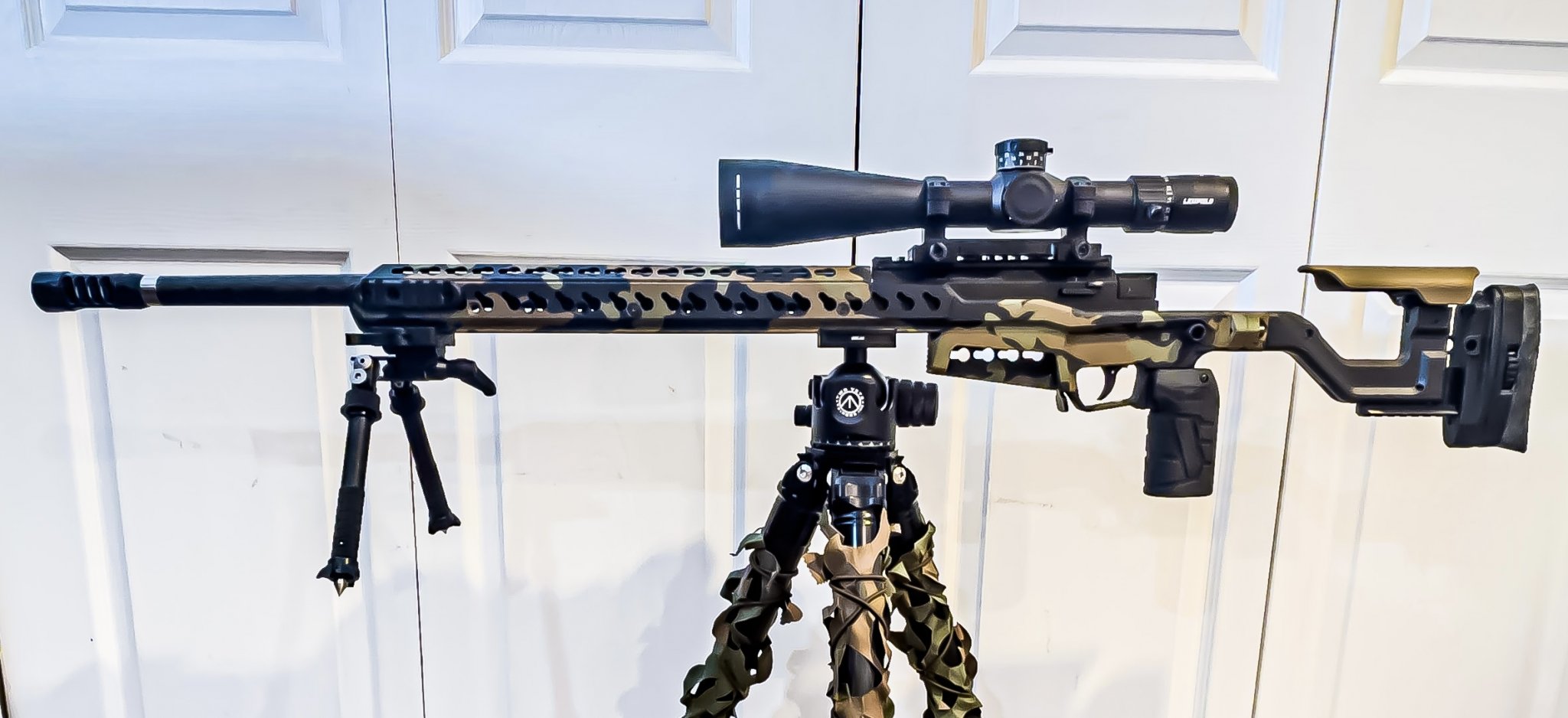

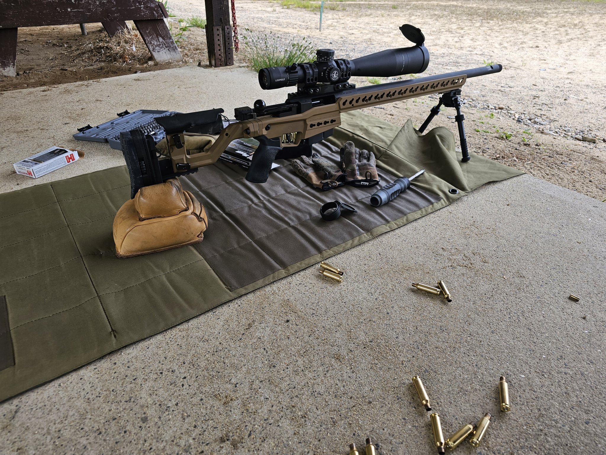

Ran PRS today in the dust and heat and the only issue was the idiot firing the gun.
Getting good MOA groups prone at 1k. My positional shooting might require AI to confiscate the rifle.....
