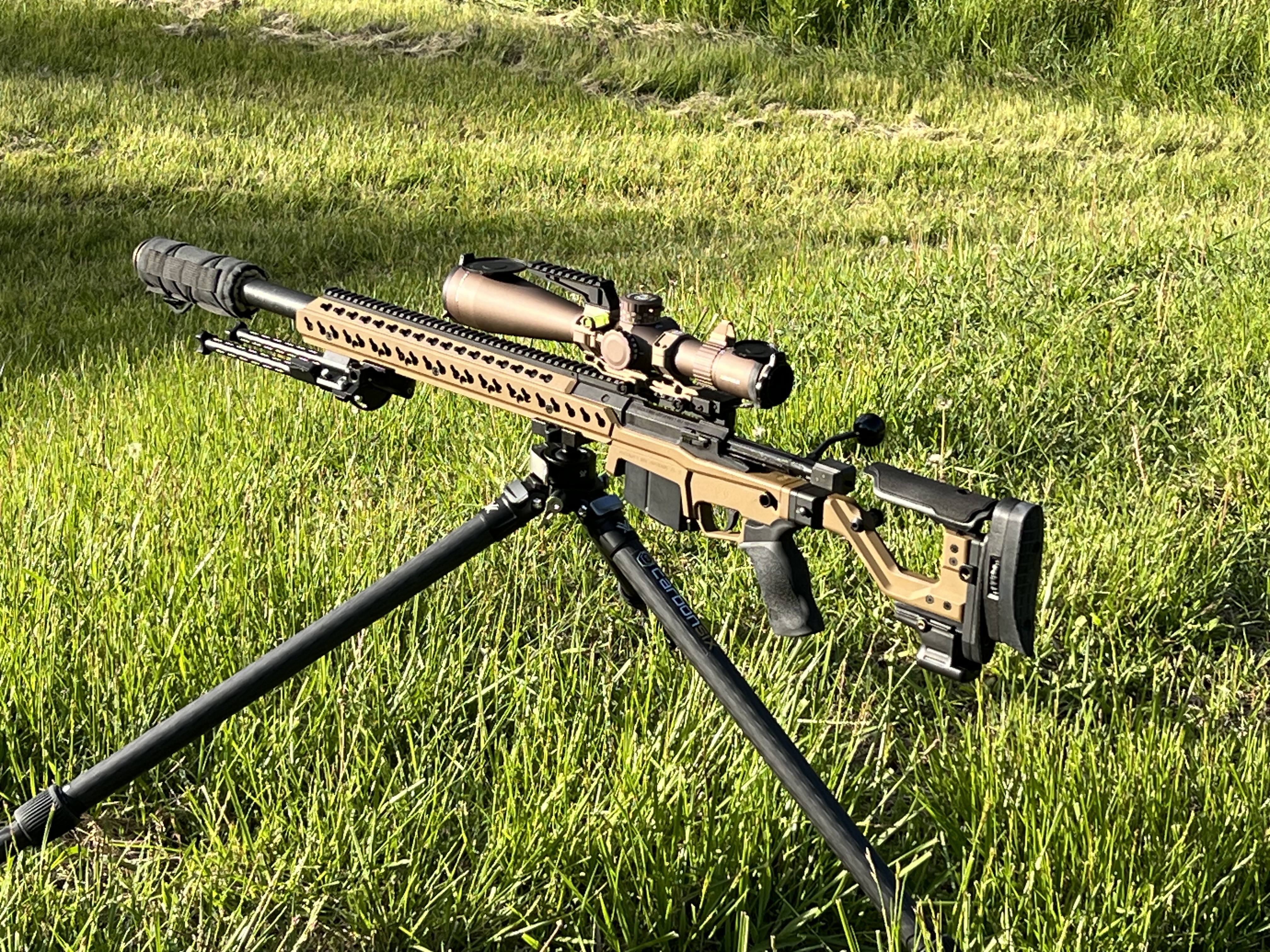

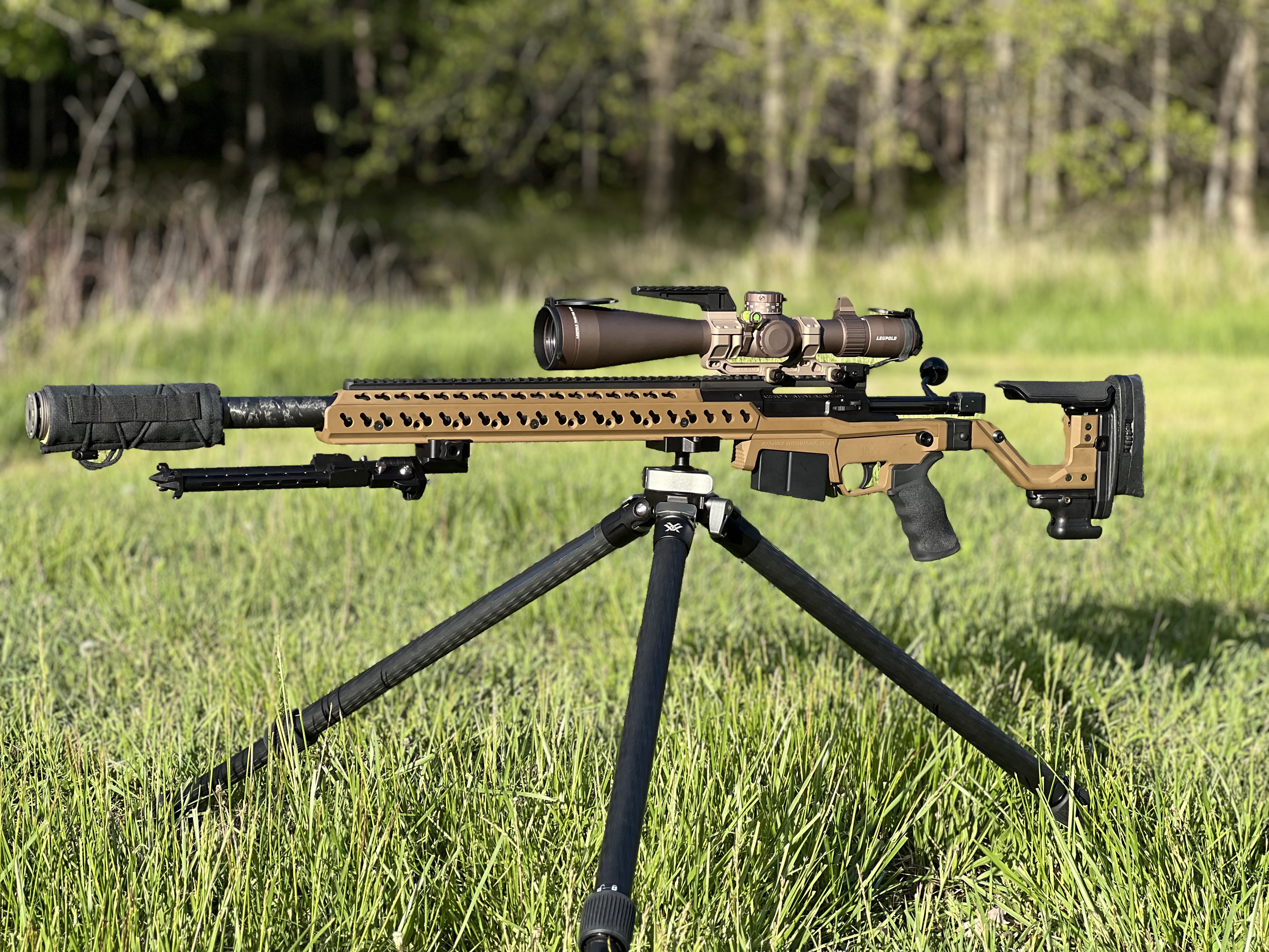

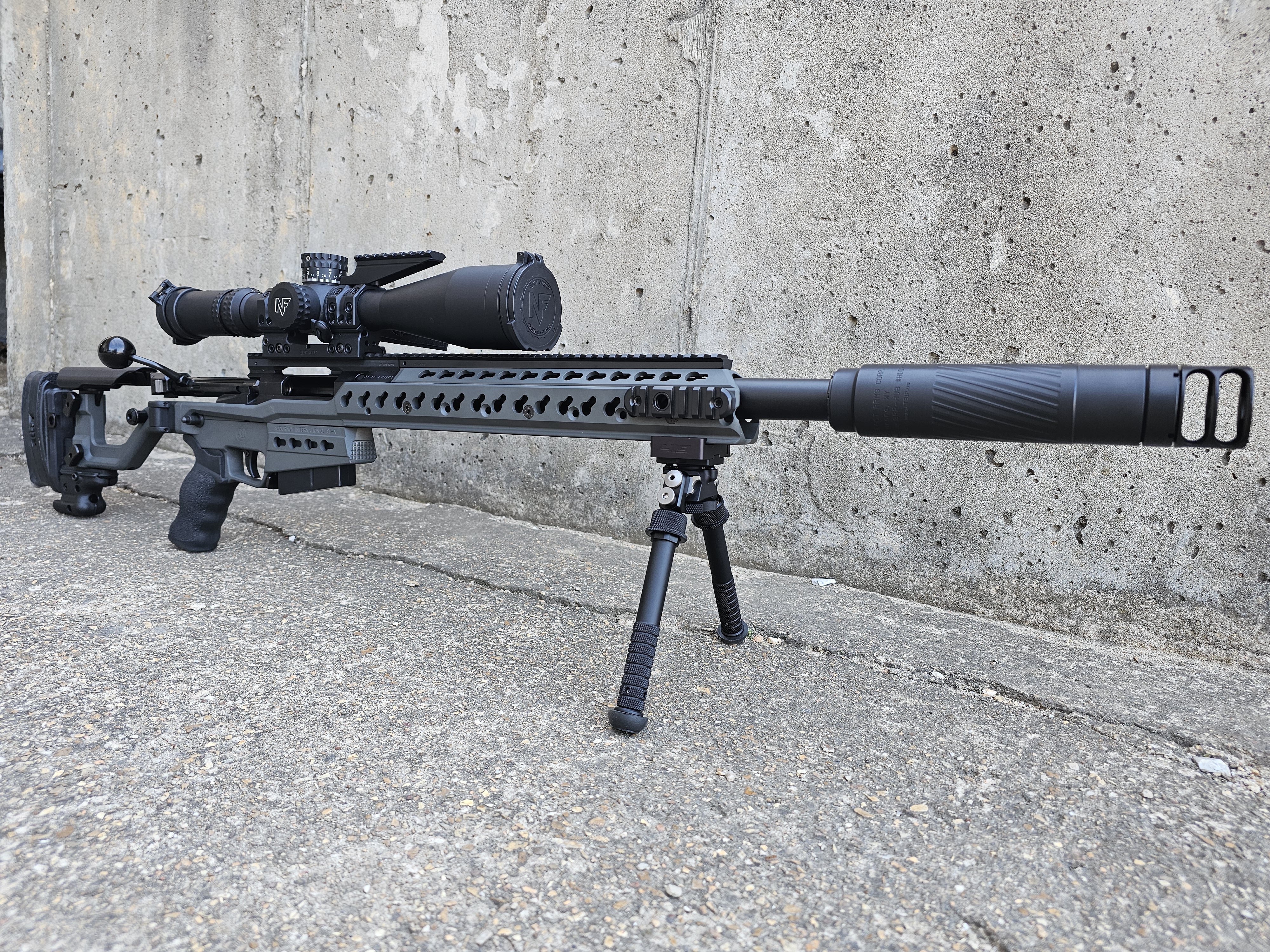

Hunts Long Range just spun up this 16.5 6.5 Creed for me. Shoots lights out with factory ammo I'm using to break it in.

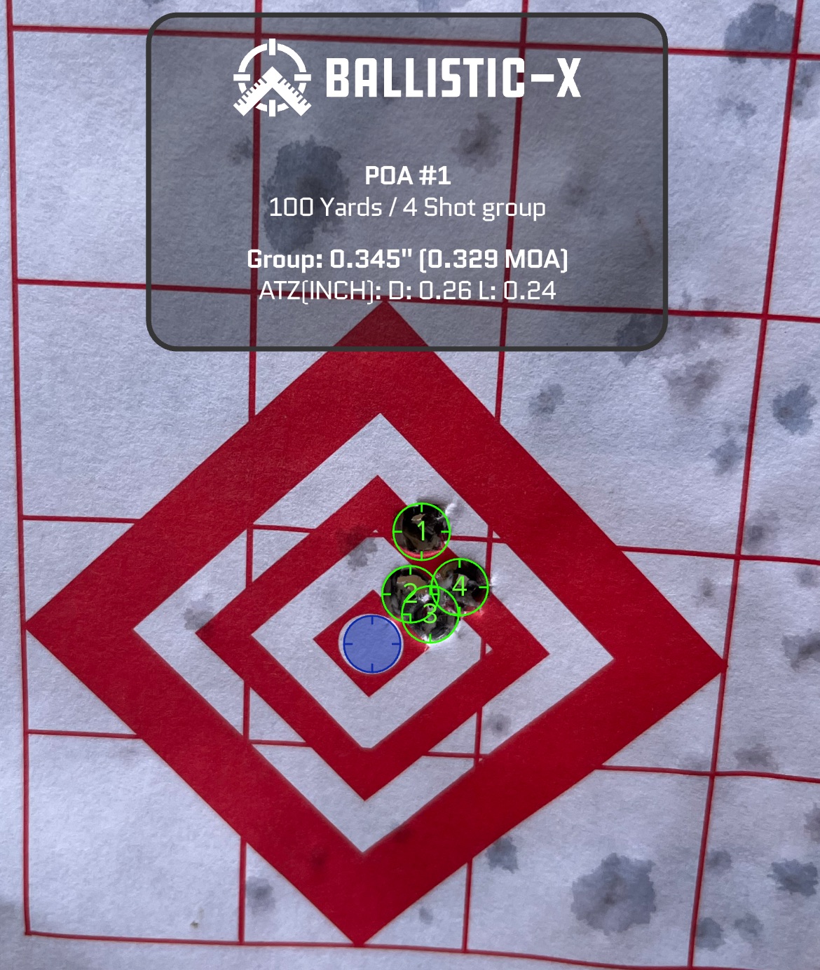

Finally got around to shooting the xc. Those are rounds 7-10 down the barrel shooting Berger factory 105 hybrid ammo. Looks like it’s going to out shoot me, which seems to always be the case.
