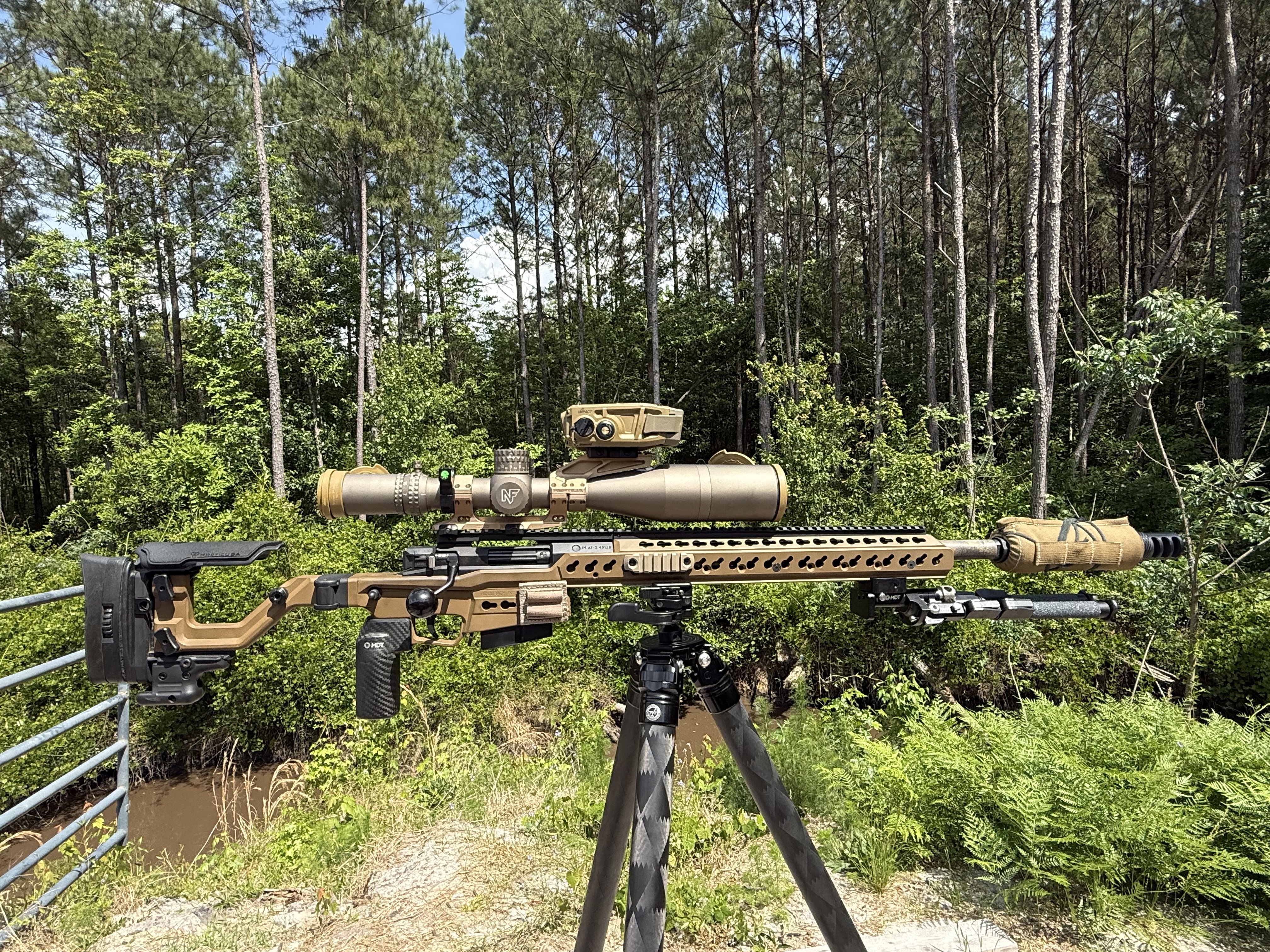

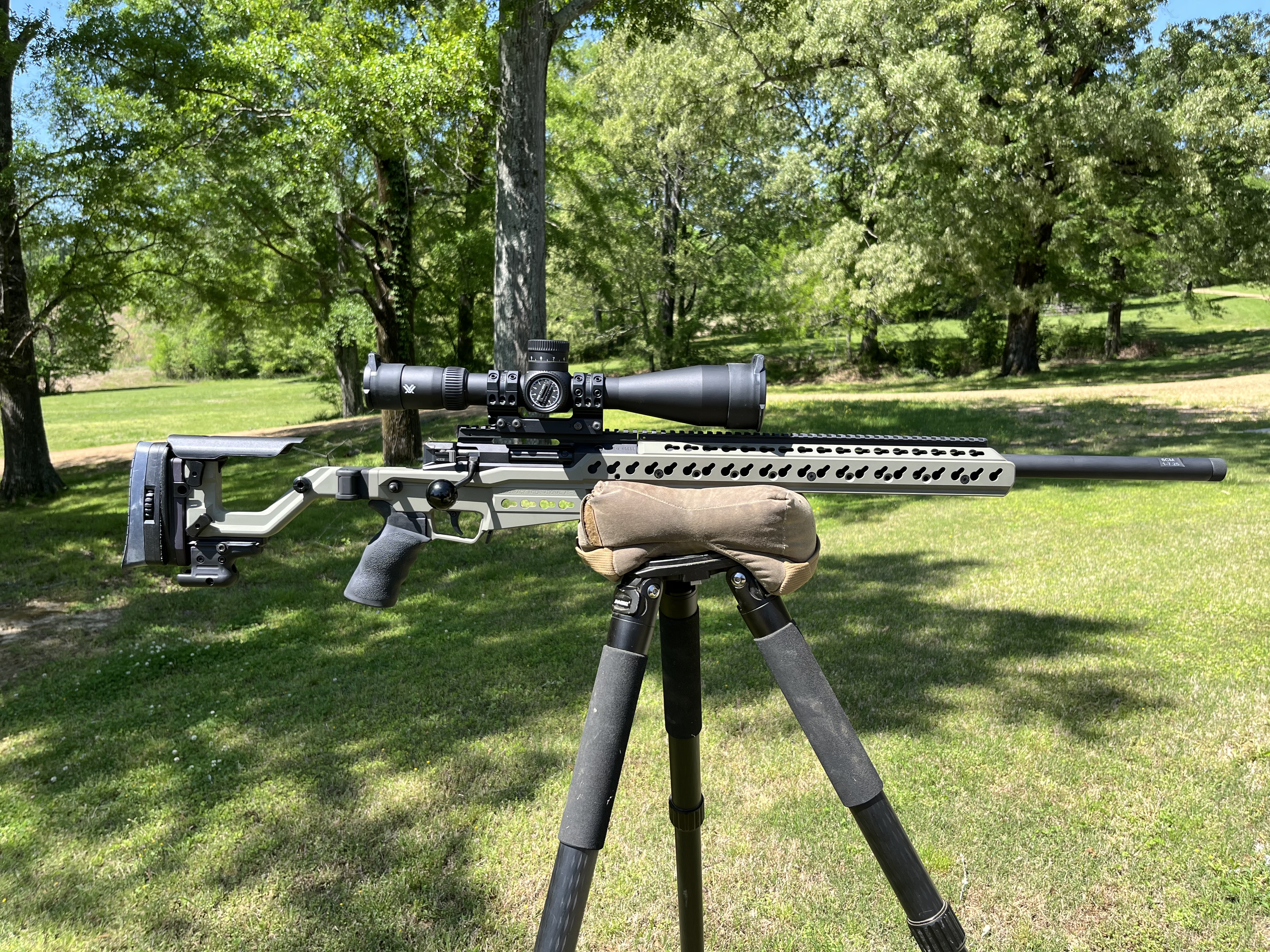

Does anybody have the weight of the atx or Atxc without a barrel? Or ideally without a barrel,bridge and bag rider? Trying to spec out a a build to ride just under 16 lbs. ThanksView attachment 8711659
The AT-XC without a barrel is 8.2 lbs, that’s with the bridge (11.6 oz) removed and the factory bag rider replaced with the Bug Hole version. I just set one up for NRL Hunter open heavy with a 7 SAW carbon fiber barrel (3.4 lbs), Vortex LHT, and Cyke double pull and its right at 15.2 lbs.

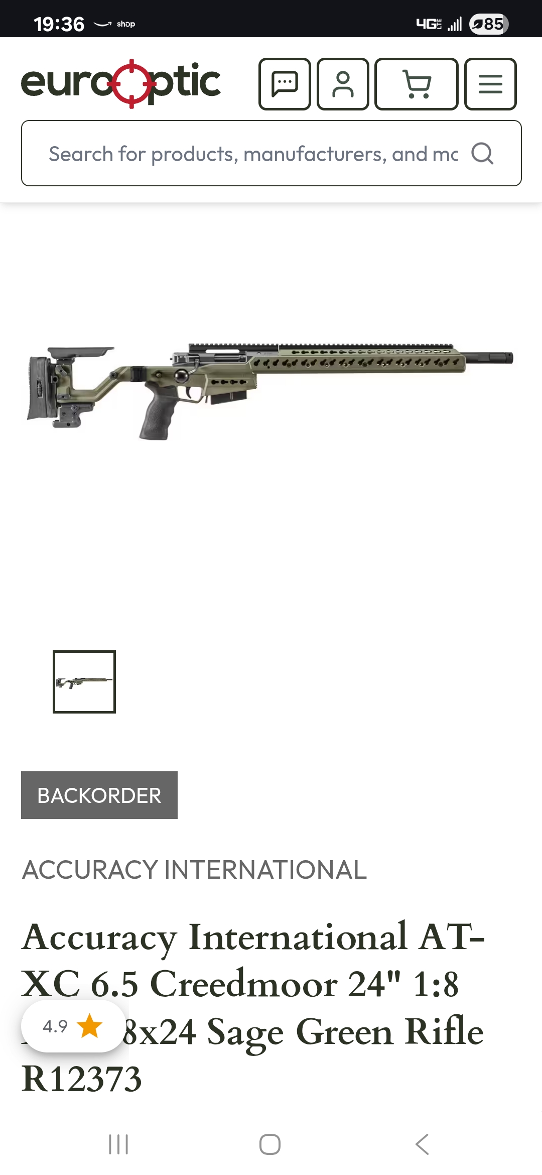

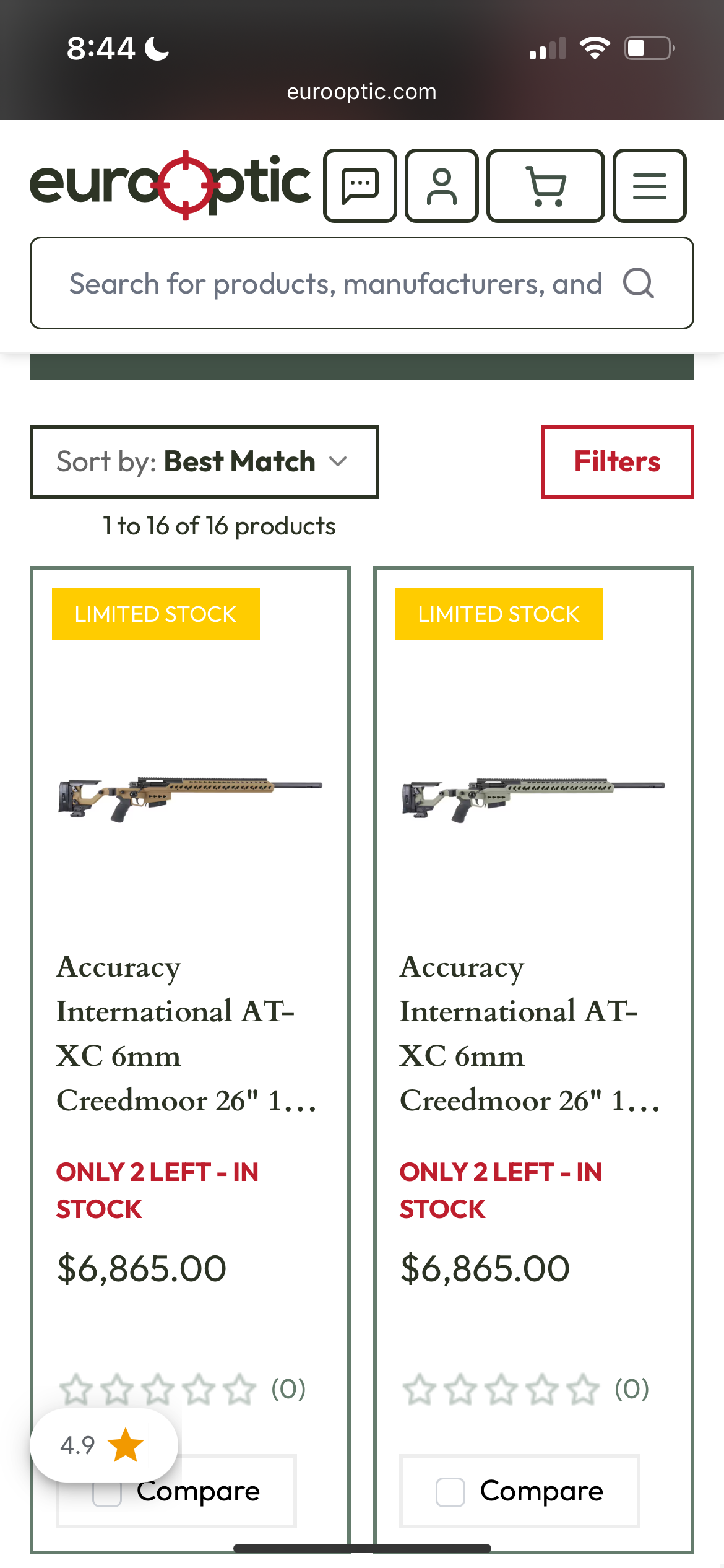

Fellas in case you don’t want to wait for your preorders in a different caliber go to eurooptic now! Strike a deal with them!
They have 6 creedmoors in stock! I was going to buy one and cancel my 6.5 order but I actually want that 6.5 24” barrel.
