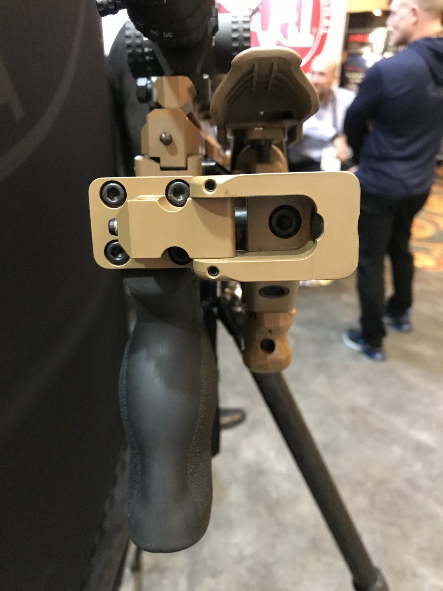

Does anyone have a pic of the AXSR/ASR stock interface (where it interfaces with the chassis) next to the standard AX stock?

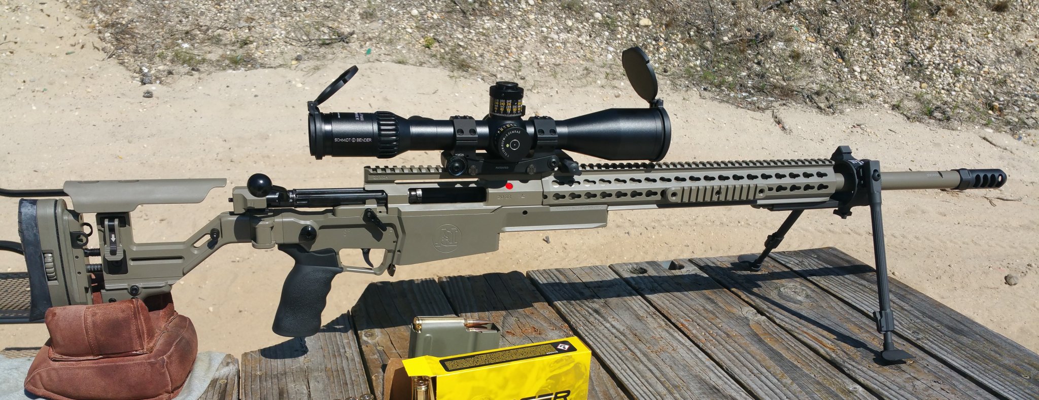

Hey man, I have this photo that popped up around shot show... It's a very different back end between the AXMC and AXSR.
I don't have the AXSR in person yet so I can't measure anything up for you unfortunately.
Reactions: M8541Reaper
Thanks for the pic man.
Yea I remember seeing a side by side somewhere on here of the stem portion (that goes into the chassis) but can’t find it now that I’m curious lol.
They are definitely shaped differently but I forgot if it is larger with enough meat to trim down in order to be fitted into an AXSA/AXMC recess.

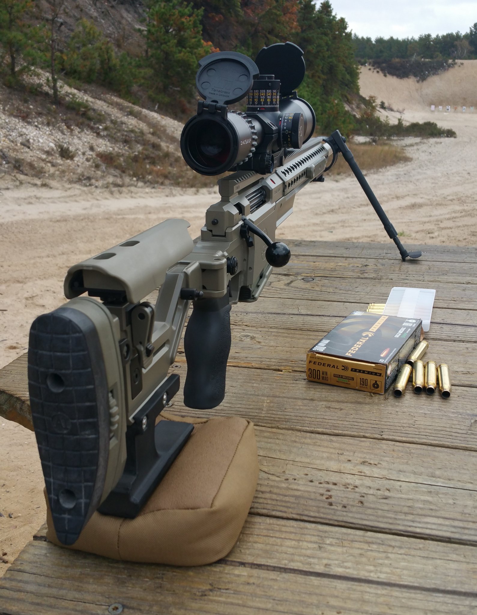

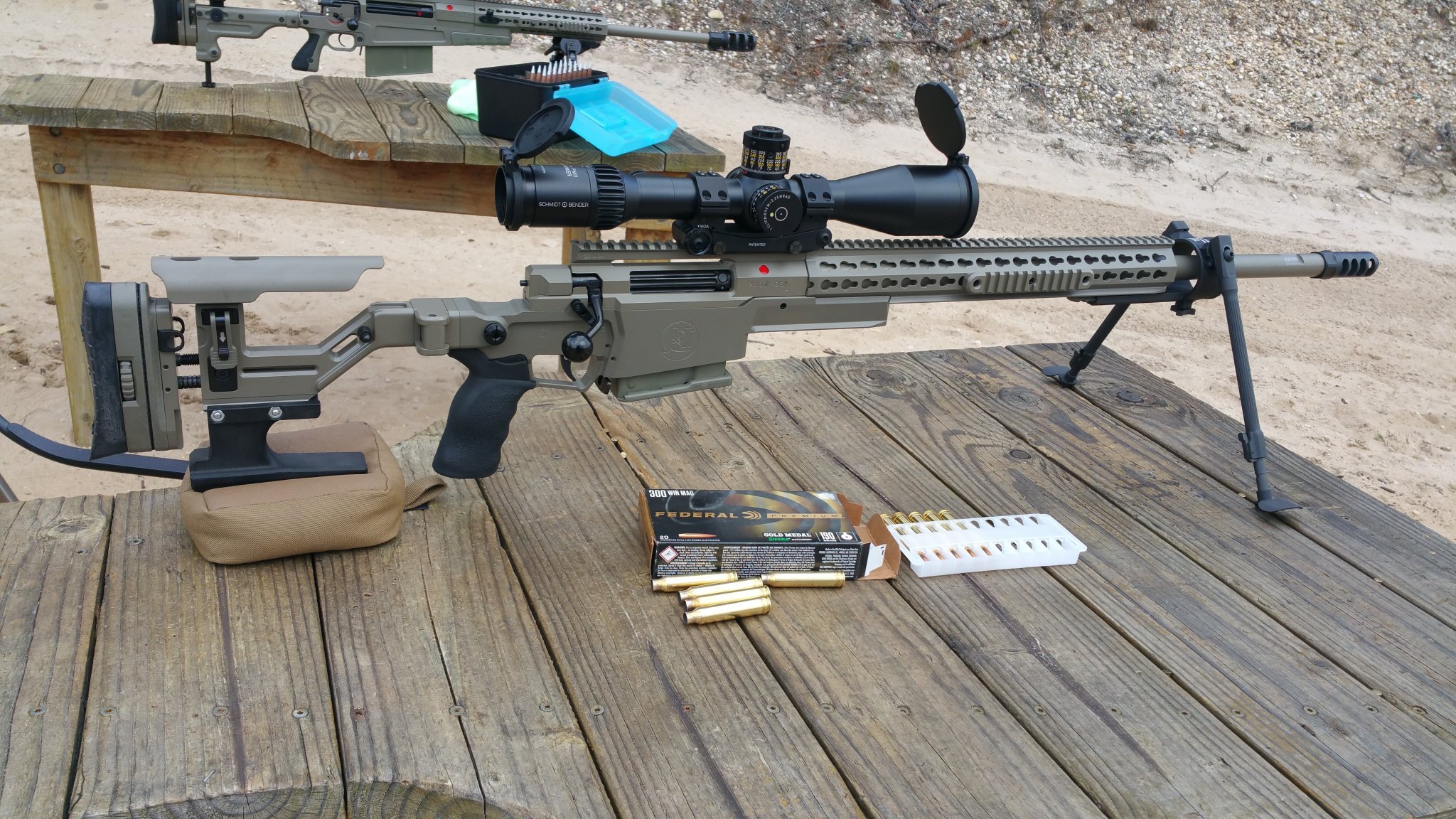

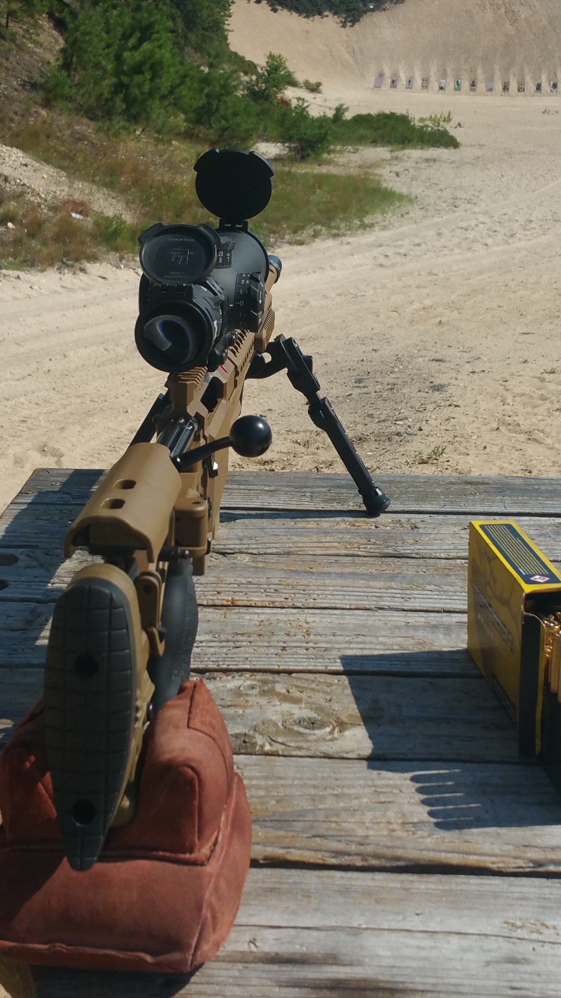

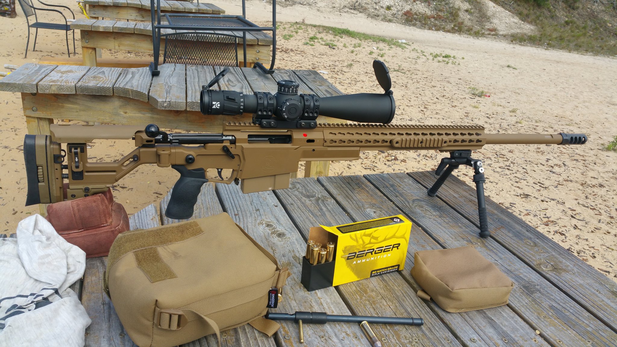

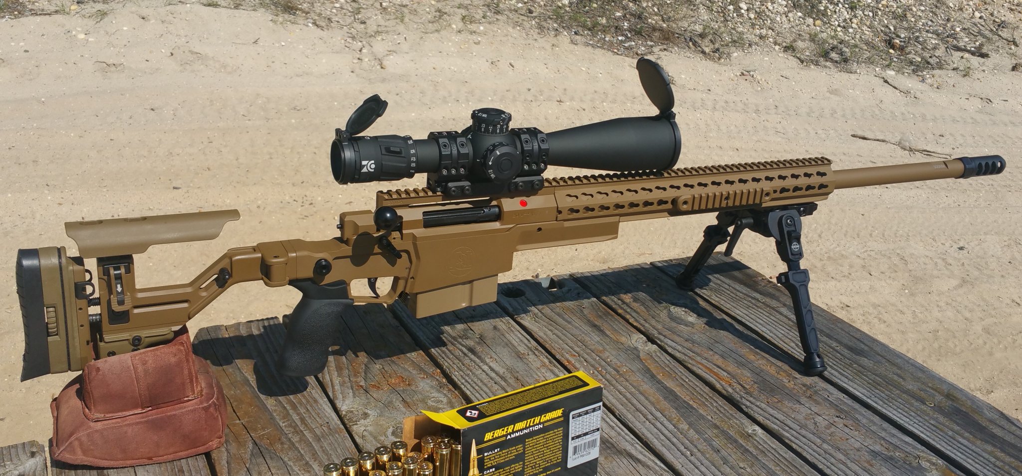

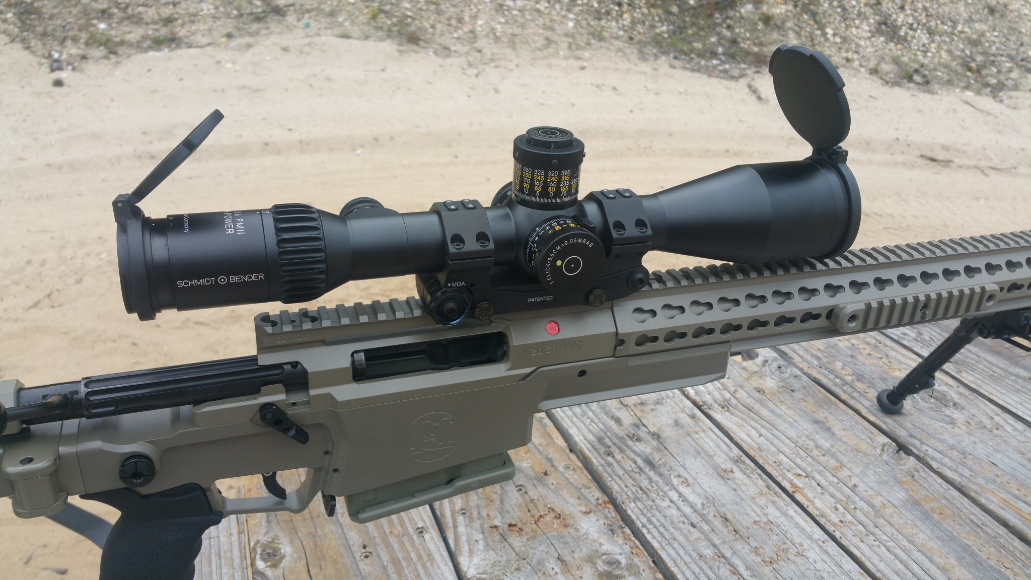

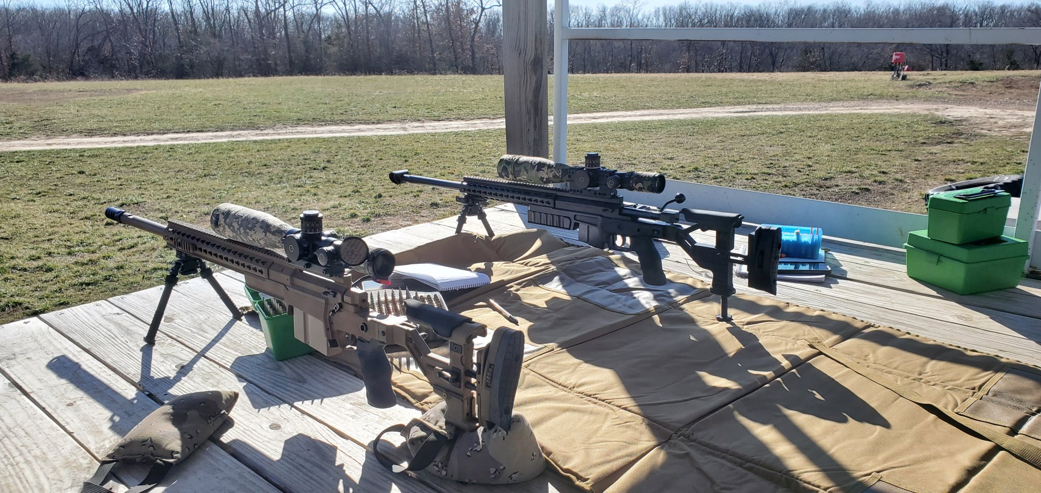

Here are a couple of pictures of my FDE AXSR in 300NM and my AXSA in 6CM.
We were shooting steel from 400 to 1000 that day.
Load Data:
Lapua
LRP-M
230 A-tips or 230 Berger (moly)
86g H1000
Avg 3075
Es 11.3
SD 7

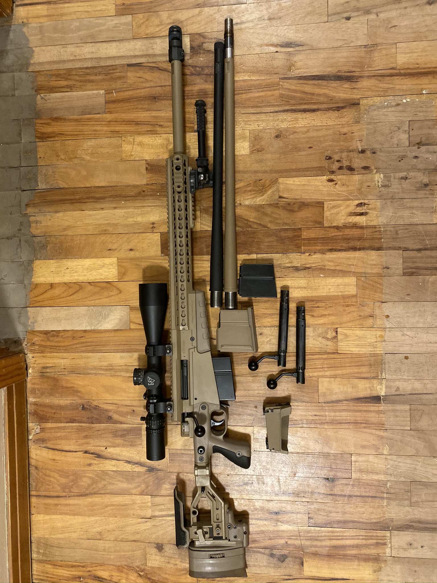

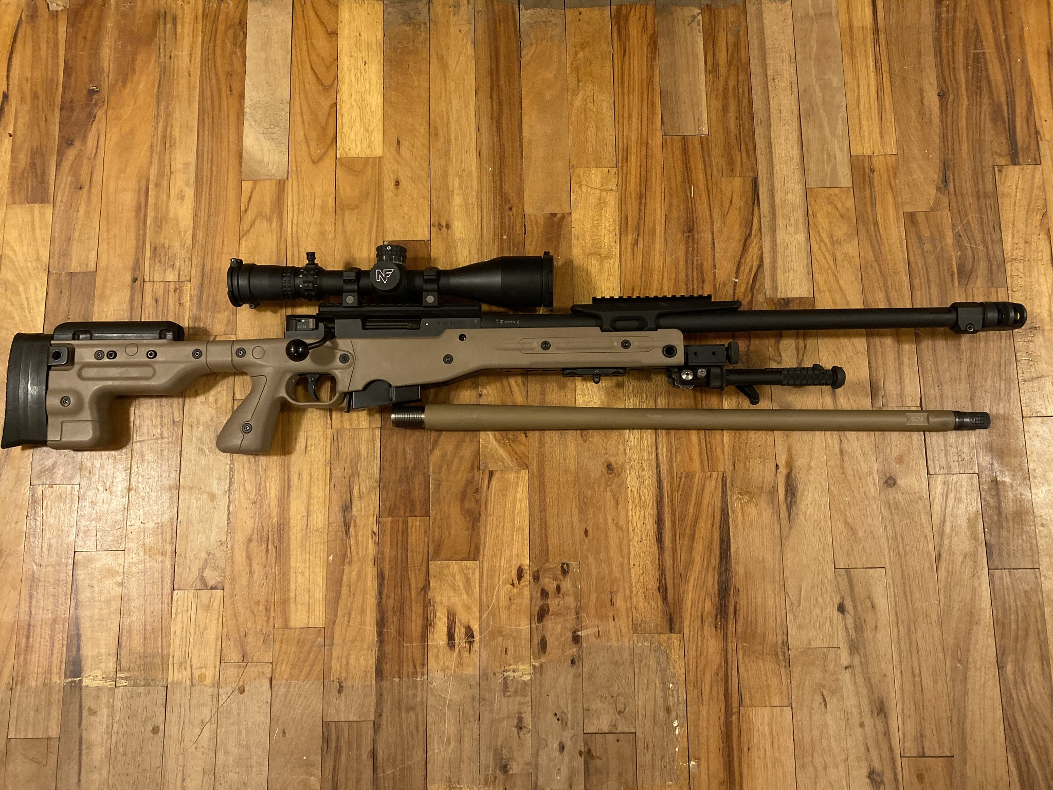

Does anyone have plans to run their AXSR with a 308 bolt (chambered in 6mm Creed / 6.5mm Creed etc.) for PRS matches?
I have an elite sand AXSR in 300NM on order currently. I like the idea of getting a 308 bolt for a 6 or 6.5mm Creed barrel when they become available next year... Might keep the AX308 or to sell it off if it becomes redundant.
Keen to hear your thoughts on how practical the AXSR is for that type of shooting.
This is exactly what I plan to do. I wish the bolt body’s were available already for the axsr.
Reactions: gamewarden and 96C
I’ve got the same rig now, and have the.308 parts on bo too. I’ve got a nice prs setup, but would be interested in hearing from others who do this with the axmc.
That’s what i did with my axmc it works great but the axmc to me doesn’t feel as good as the AT I have the 308 and 6mm creedmoor best group I shot with it is 1.5 something inches at 600 but I will say getting behind the axsr feels better then the AT to me so I’m sooo pumped for the bolts to be available. Then again I’m also an AI fan boy.

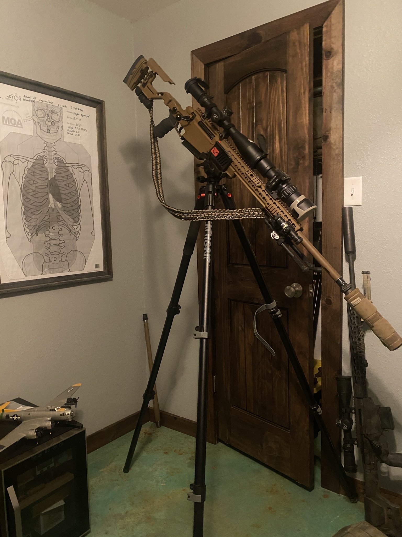

Wanting to take advantage of the ARCA Swiss dovetail on my AXSR, I finally received the ARCA Swiss mount from Dale Poling for his Elite Iron Bipod. The mount is designed to interface with AREA 419 ARCA Swiss Clamp. The adapter has the same interface as BT Atlas Bipod no clamp version. Having tested the bipod/clamp results have been excellent as can be expected from a solid bipod design. The bipod places the apex well above the barrel which provides rock steady stability.
Here's how it looks on my rifle.
I need that. Is it an orderable item or just a one off for you?

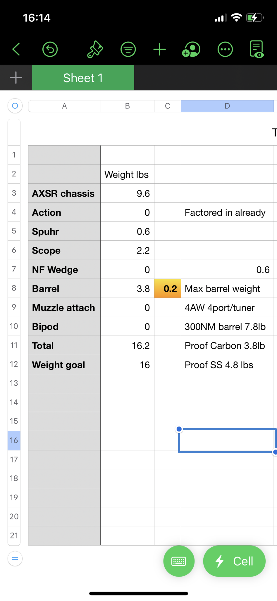

Curious if anyone has tried a 24" or shorter carbon fiber barrel in their AXSR and what the weight was (assuming a ~35oz scope). Seeing if it's possible to hit 16lbs. My AXSR with 27" steel barrel, with ZCO in Spuhr mount is 18.5lbs...
You can get close. Depending on muzzle attachment.
I have the BugHoles bag rider factored in the chassis weight. So minus that if you don’t have one.

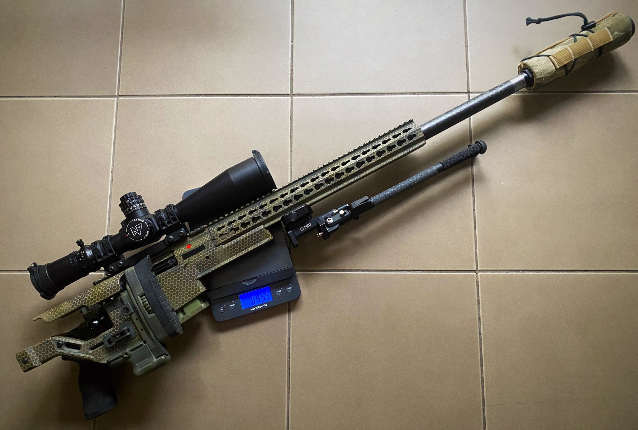

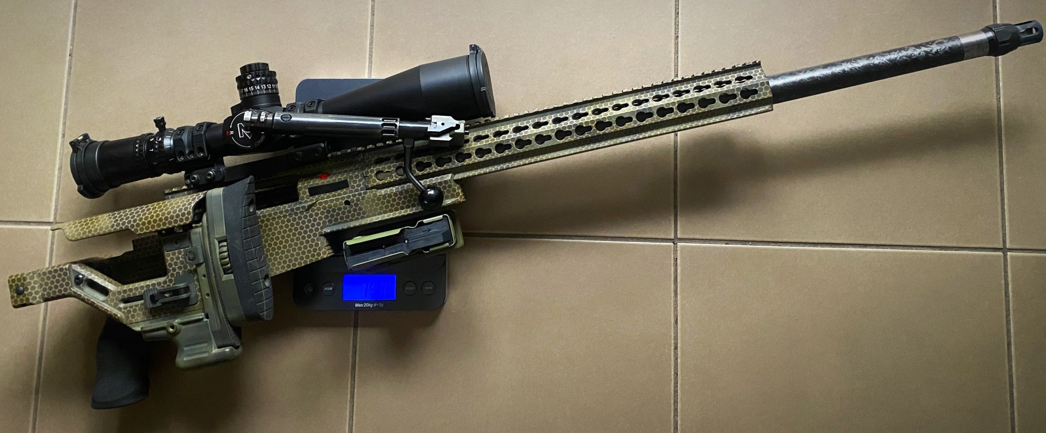

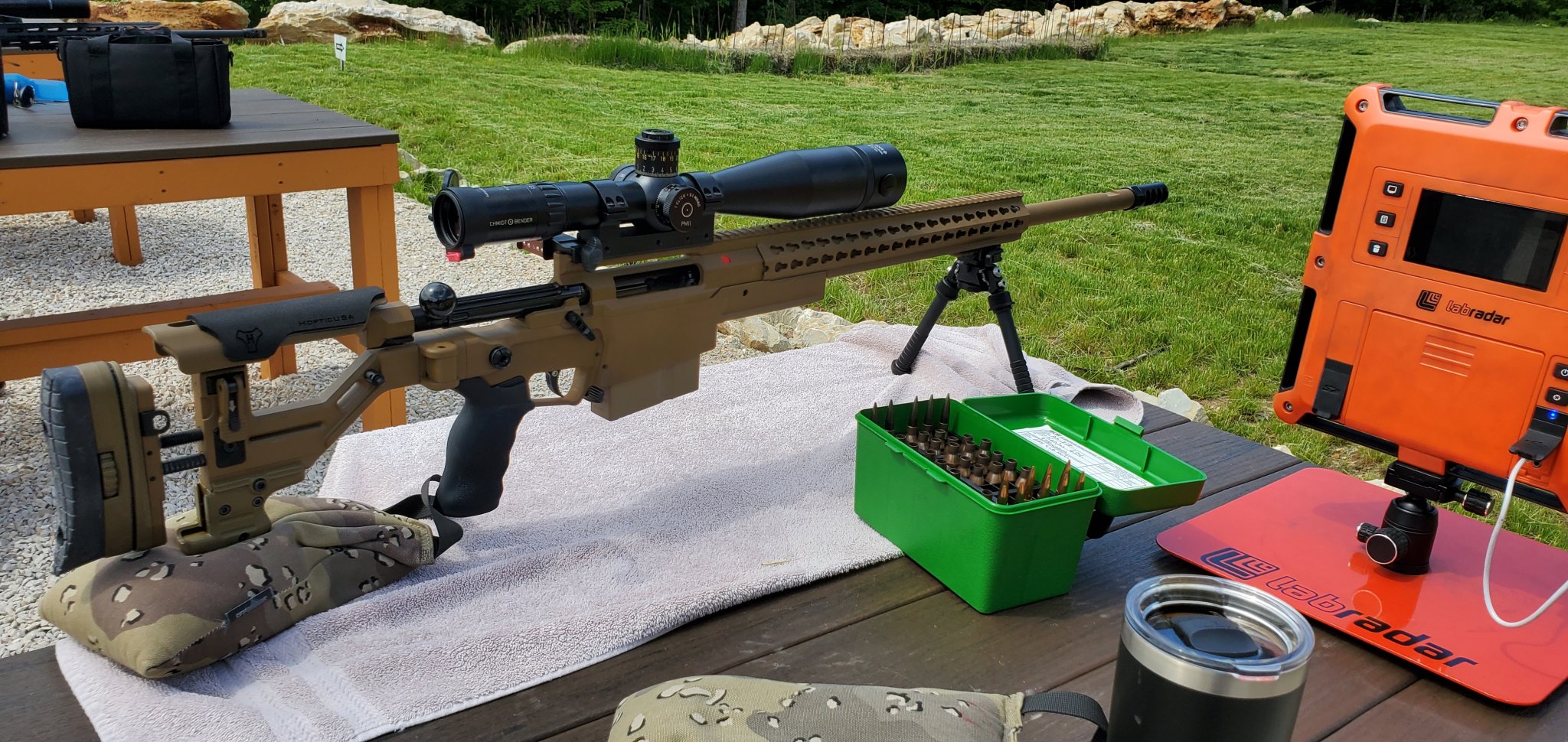

AXSR 300PRC
WM bolt
Proof 26” carbon barrel
NF BEAST with caps
Spuhr 4603B
Muzzle brake for can (no can fitted)
On short pic rail for sling QD
Empty magazine
7.41kg = 16.3lbs
NO Bipod / Sling / can.
How it is normally configured, titanium can with cover, CkyePod standard length with RRS adapter and B&T leg extensions. (Unloaded)… 8.45kg = 18.6lbs
Got a 308 bolt & mags in customs at the moment, have a 24” 6.5Creed carbon proof barrel for that so when it’s been slapped together I’ll let you know man.
AXSR 300PRC
WM bolt
NF BEAST with caps
Spuhr 4603B
Empty magazine
7.41kg = 16.3lbs
How it is normally configured, titanium can with cover, CkyePod standard length with RRS adapter, B&T legs & spikes. (Unloaded)… 8.45kg = 18.6lbs
Nice. I was going to post a similar question the other day asking about if it can get to 16#. That .3 could probably be found with a 24” barrel, removing the butt knob, replacing the pic rail sling point with the anarchy outdoors AI sling mount, and hacking two or four inches off of the forend. Probably placing him at 16#.
You ever get your 308 bolt for your rifle man?
Reactions: 96C
AXSR 300PRC
WM bolt
NF BEAST with caps
Spuhr 4603B
Empty magazine
7.41kg = 16.3lbs
Thanks for posting weights of your setup. I think I'm going to give it a go.
  • Love
Reactions: 96C
Nightforce BEAST weight: 1134gm (40oz)
Spuhr 4603B weight: 268gm (9.5oz)
Proof AI Prefit 300PRC 26" carbon weight: 1729gm (3lb 13oz)
Proof AI Prefit 6.5Creed 24" carbon weight: 1700gm (3lb 12oz) (SAVES ONLY "29grams". Doesn't seem right).
Remove plastic rear bag rider / hand grip: 50gm??? Not much.
Short side pic rail: Not much.
Remove tenabrex flip covers: Not much.
Add 308 short action magazine, with twin metal insert spacers: Slight weight addition, not much.
Clearly the easiest weight savings could be gained by changing scopes...
* Nightforce NX8 2.5-20x50F1 is 802gm (28.3oz)
332gm (11.7oz) saving.
* Badger Ordnance Condition One 30mm scope rings, 1.54" NV uni mount are 143gm (5.0oz)
125gm (4.5oz) saving.
* Atlas V8 BT10 rail clamp bipod, additional 312gm (11oz 'approx')
By slapping on a NX8 2.5-20x50 in a set of Badger rings and ADDING a BT10 bipod, you might be able to SAVE 145gm (.3LB) which is what it is sitting over... :ROFLMAO:
Not sure man, might squeeeeeeeze in by a bees dick, but it'll cost $$$$$ and this is all going purely off website weights.

Alright, I really just need someone to say yes and to answer a few questions. I apologize for resurrecting this thread, seemed unreasonable to start a new conversation.
I am considering on selling my entire DT SRSA1, including a 26" Proof CF 6.5CM, 28" 6.5 CM SS, 26" 308 Win from SAC, and a 28" 300 Norma from SAC to fund an AXSR from Euro Optic with a Proof CF 18.5" 308 Win, 24" 6.5 PRC and the stock 27" 300 Norma.
Don't get me wrong, the DT is great, but not perfect. I cannot run the bolt nearly as fast or smooth as I could with a Rem 700 or the Defiance action I got to shoot about 20 rounds with. Barrel support has already surpassed the DT market in parts and support, which is another reason I am considering the switch.
However, having a hard time locating the 308 bolt body (typical), but are the AXMC 300 WM magazines compatible with the AXSR? I noticed on Mile High, they have a 12 rounder for the AXMC, is this compatible as well?
From what I've read the 300wm, NM and Lapua mags are compatible. The 308 mags are backwards compatible. The axsr mags work in the axmc not the other way though.
The bolts have been in stock a few times and generally don't sell out very fast. So it isn't too hard to get one. You are just stuck waiting for AI to make a run of them. Which isn't always the quickest.
