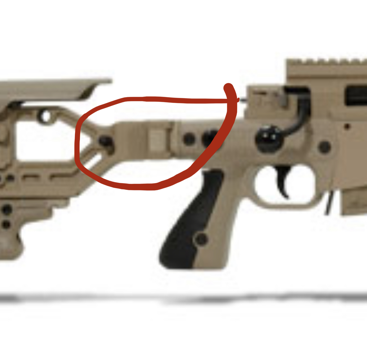

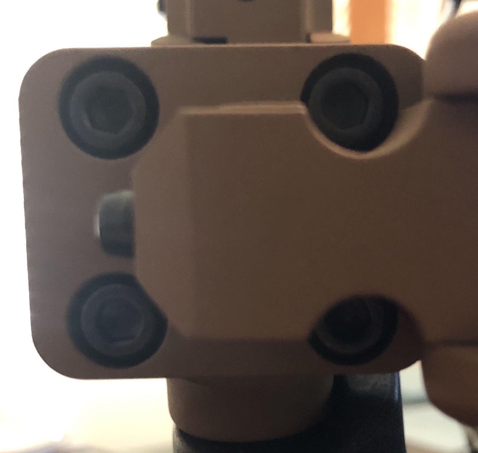

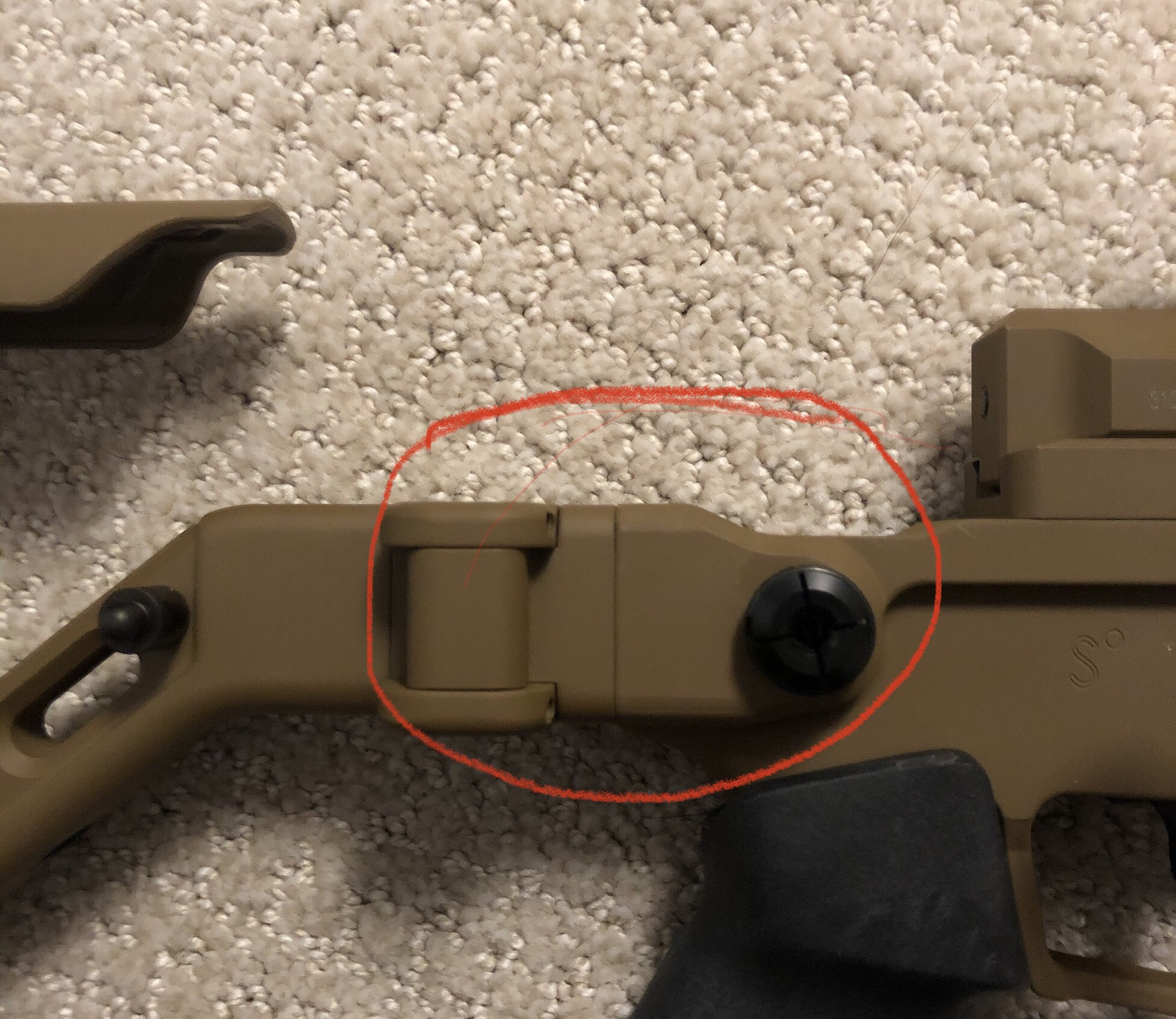

MY understanding is, from photos I've seen, that there are 4 screws on the hinge system of the ASR, so it's a very different design to the AXMC / AX etc.... I don't think it will be backwards compatible.
Correct, AXSR pic attached. It appears that the part right where the screws go into the lower now dips down vs the axmc being flat, not the designer but assuming this would cause compatibility issues as well.

They aren't compatible. The AX/AXMC buttstock is bonded and uses two flat head screws top and bottom. The AXSR buttstock is not bonded, and uses the 4 cap screws attached from the rear. The AXSR buttstock is also ambidextrous; the hinge mechanism can be easily flipped, and the adjustment levers on the butt and cheekpiece can be changed to the other side as well. The AX/AXMC buttstock cannot do that.
From what I can see, different forend, different machining around the ARCA rail on the chassis, 3 position safety, trigger guard is rounded and that section of the chassis is thinner which is apparent when looking at the safety and the way the bottom of the tang is cut. They say the bolt is improved over the AXSR but I'm not sure what's different there. I think I read somewhere that the cheek rest is spring loaded too for adjustment....could be wrong. Butt stock also has differences. The AXSR is more appealing to my eye, but I really like the forend on the Mk3.
Also, 30 MOA rail, and no comp trigger.

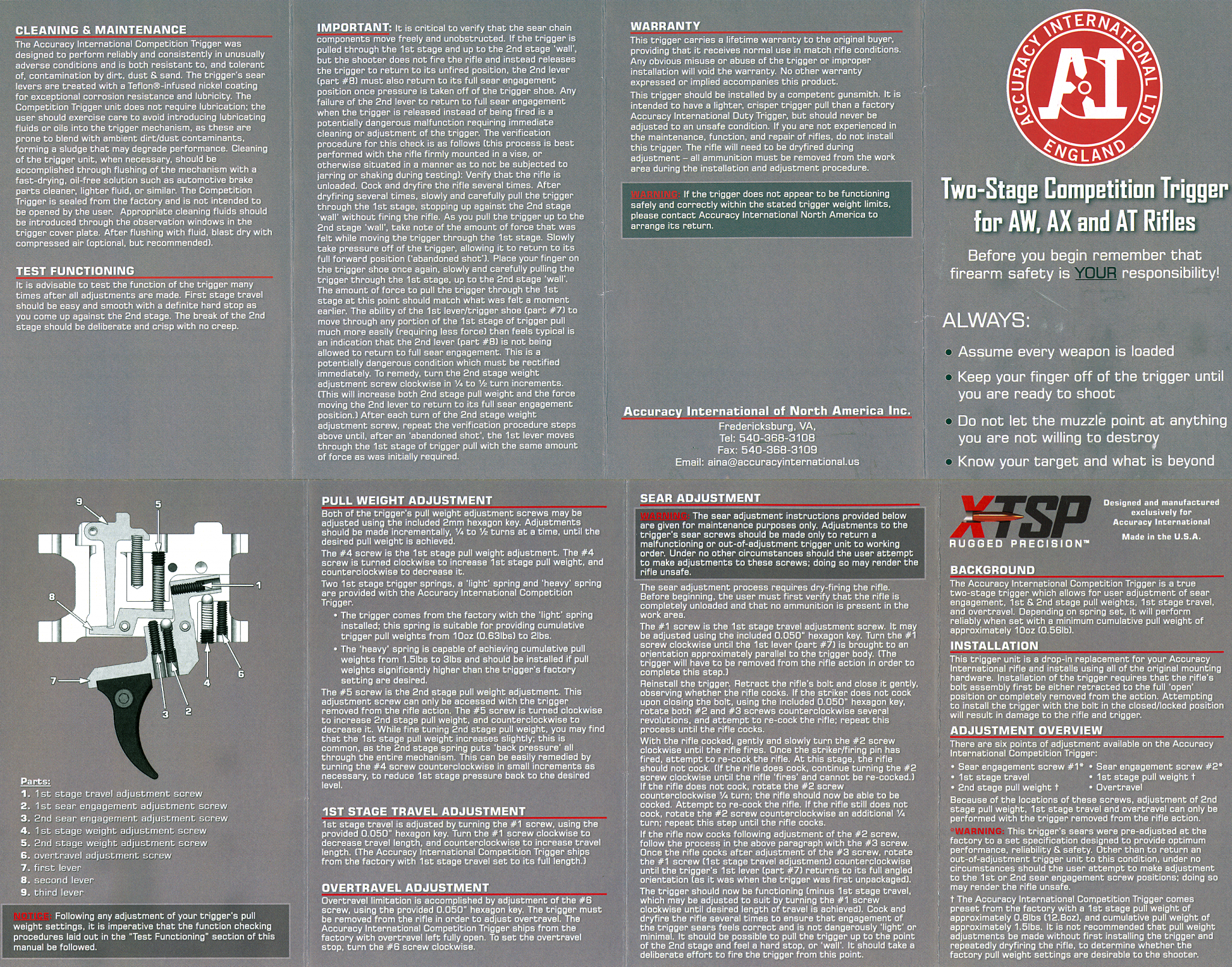

Can anyone help me on adjusting the trigger pull weight and more on the axsr? Can’t find any info on this thing online
I have asked that very same question here and to AINA. The best I got was you need to remove the action to get access to the trigger and adjustments are the same as the comp trigger. There is one screw that is under the mag release latch that looks like it will be a pain in the ass to remove so I have not attempted to remove the action.
So I finally took the dive and adjusted the trigger. What a pain in the ass.
You first need to remove the forend, 2 screws.
Remove the action, 5 screws. One of them is under the mag release which will require a ball end allen wrench, which is a pain to remove.
Once the action is remove you can access the bottom adjustment screws, but to adjust the 2nd stage weight you will need to remove the trigger.
To remove the trigger you will need to remove the bolt, punch out the pin (next to the safety) and remove the 2 screws. You don't need to punch the pin all the way out. Go about half way and you can tilt the trigger and slide it out. Made sure you push the pin from the bolt handle side so you can insert and close the bolt.
Make your adjustments to the trigger, install the trigger back in temporarily, install the bolt and test the trigger pull. Continue to do this until you are happy with the adjustments. Make sure you open the bolt before you remove the trigger.
As always, make sure your rifle is clear and safe before working on it.
Attached is the trigger adjustment manual.
Reactions: Zane777
Did you notice any differences from the Comp Trigger instructions? Scott mentioned the AXSR trigger is its own trigger, but didn't elaborate. Sounds very comp trigger-esque.
How light did you go?
He posted the exact instructions for the comp trigger which is interesting
AINA stated the ASXR adjustments are the same as the Comp trigger. However you can't swap them. I am assuming the guts are the same and the external case is different.
Posted the Comp trigger manual since the manual for the ASXR is worthless.
