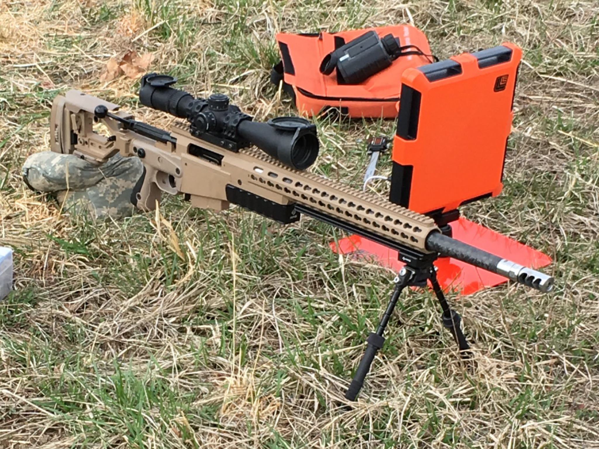

I’ve always wondered about the fluting. Both my AXMC bolts are fluted. I think some AT and axmc308 bolts are as well but not all?
One of my AXMC308s has a fluted bolt (2015 manufacture date) my other one (2014 manufacture date) does not. The 2015 dated one also has a small firing pin.

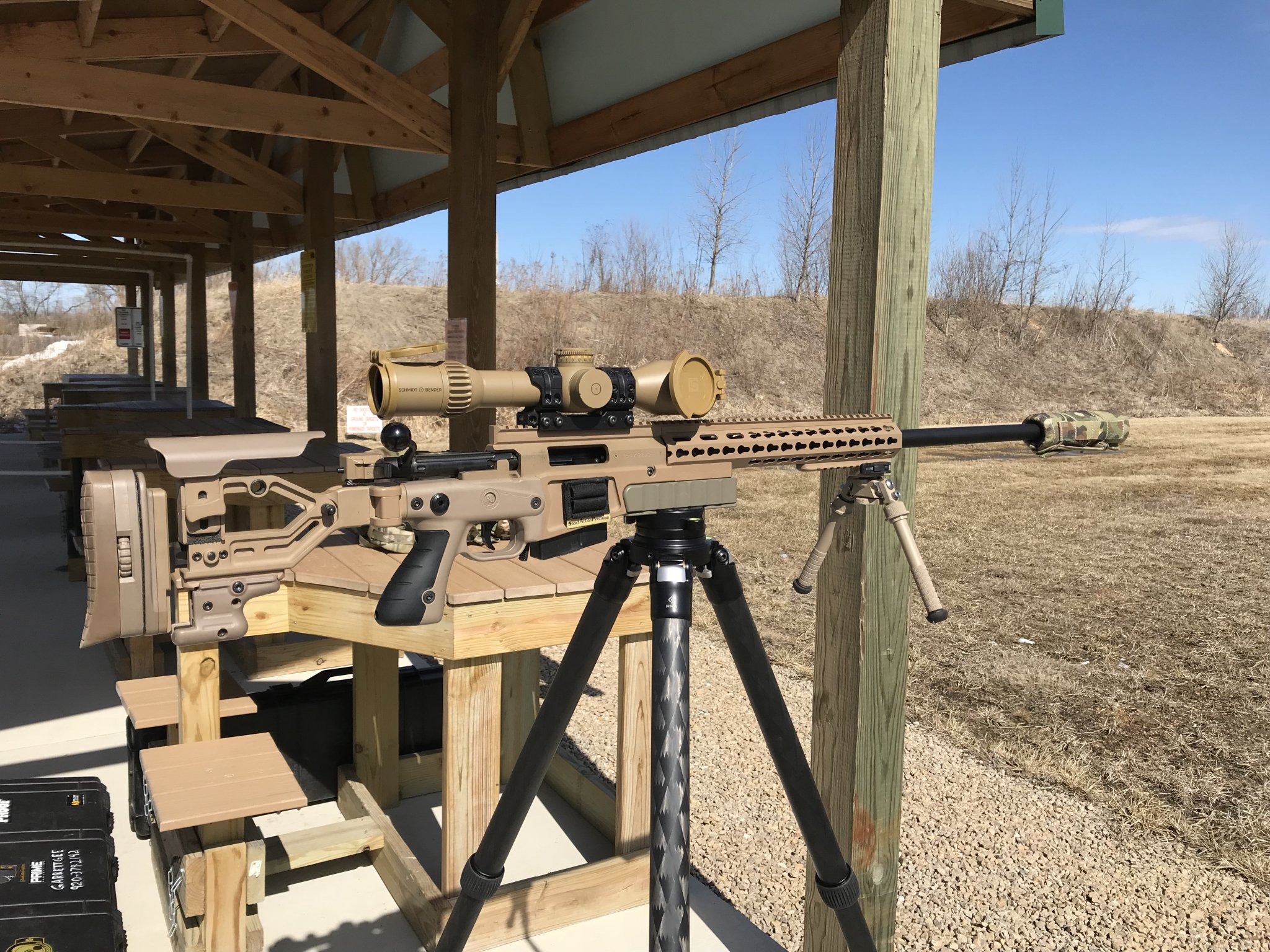

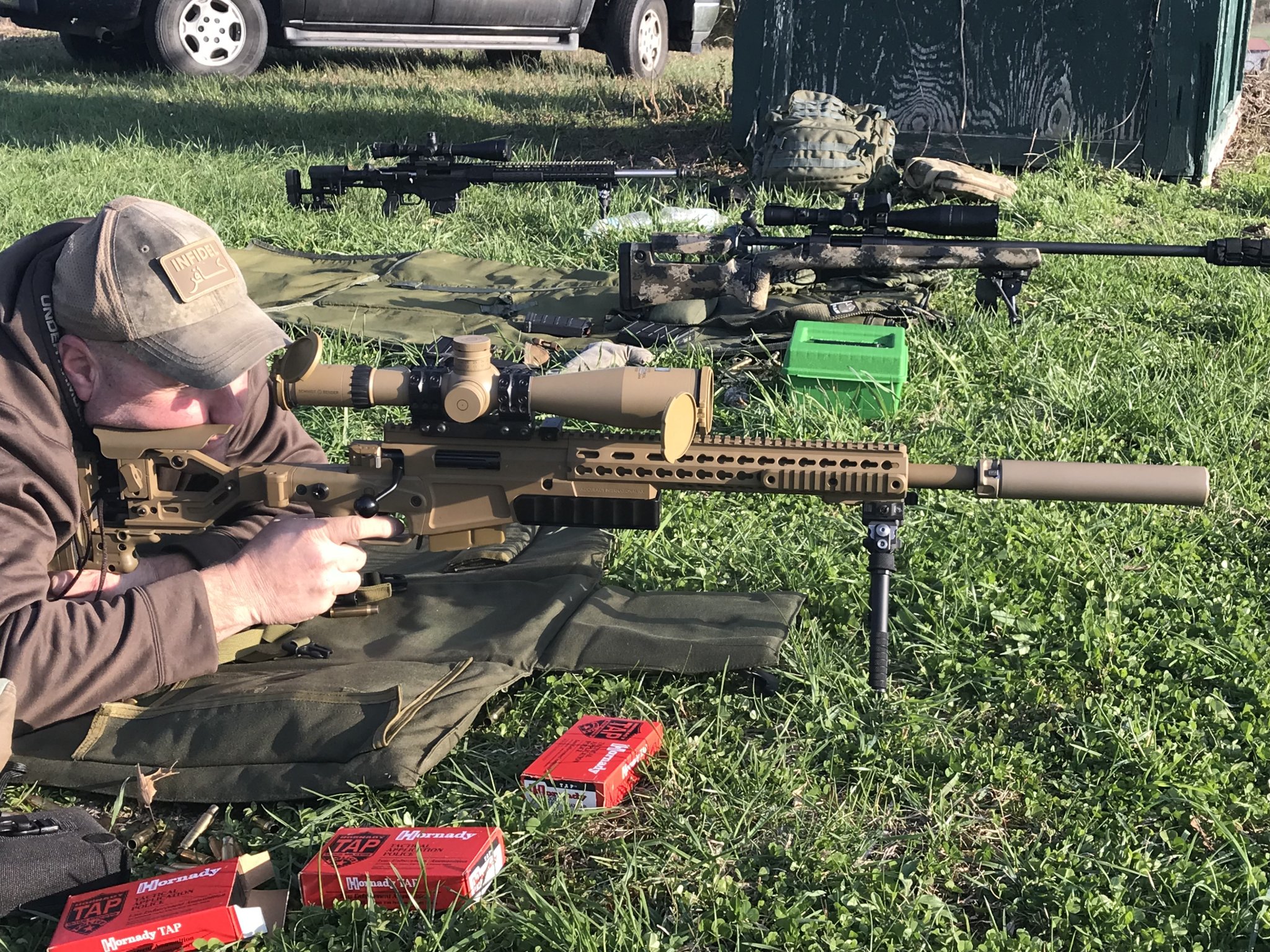

Here is my AXMC treating me well in a local PRS match.

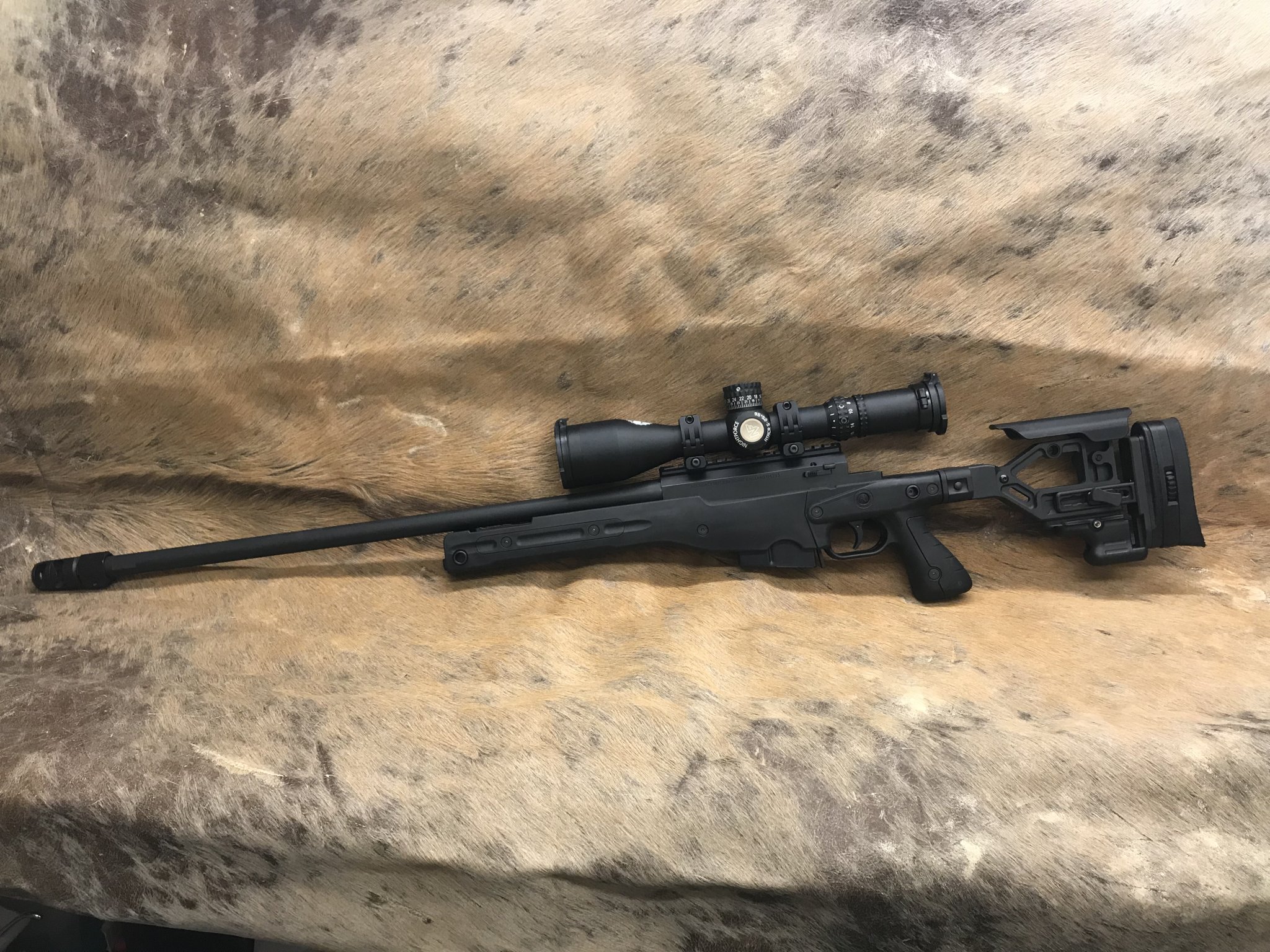

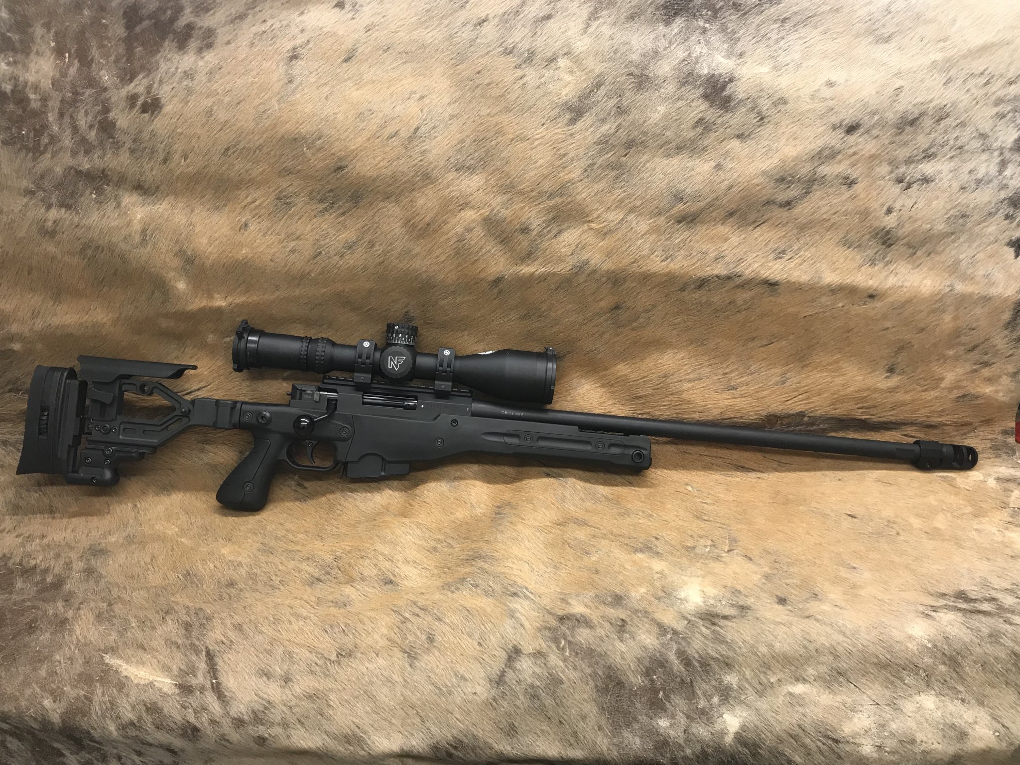

Well now mag issue sorted , scopes mounted . Starting to think a s&b ultra short is more in keeping with the plan of a light weight at if thats not a contradiction. I have a hardy barrel in 16” 7mm about to go on and a short proof 6.5 on order. Decisions !
View attachment 6884424View attachment 6884425
WOW! You did the AX butt stock conversion. That is awesome! Did you get the parts from one of the US distributors?
Thanks for sharing.
Nice taste I see a Surefire SOCOM 2 some RRS a S&B , atlas and a Sphur mount!

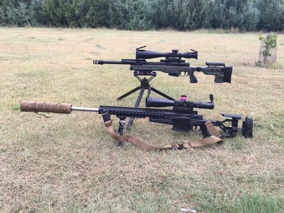

Thanks. It was time to re-barrel the rifle I use for work, and I had been saving my pennies for quite a while, so I bought the AX and moved the suppressor, optic, and bipod from my old rifle to the new. The AX is a little out of my league, financially. On a deputy sheriff's salary, it took my savings and my entire tax refund, but from what I've seen so far, it was worth the sacrifice.

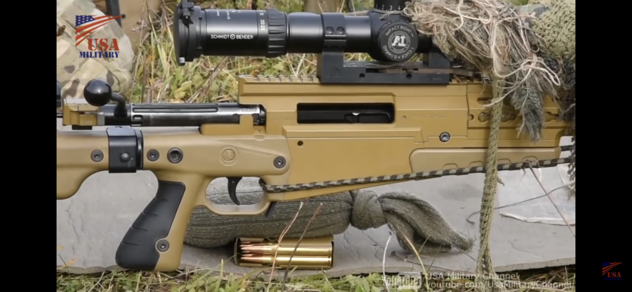

Saw this and thought it was interesting, looks like it’s an AXMC long action post 14, but with the pre 14 buttstock? I’m a sucker for thumbhole stocks and if I could get a thumbhole on my AXMC I would be in love all over again.
Reactions: PBWalsh
How big a diff in feel/usability/adjustability of the post 2014 stock vs the clubfoot?
Other than folding right, the only other perk for me is that it doesn’t look like an Ugg boot.

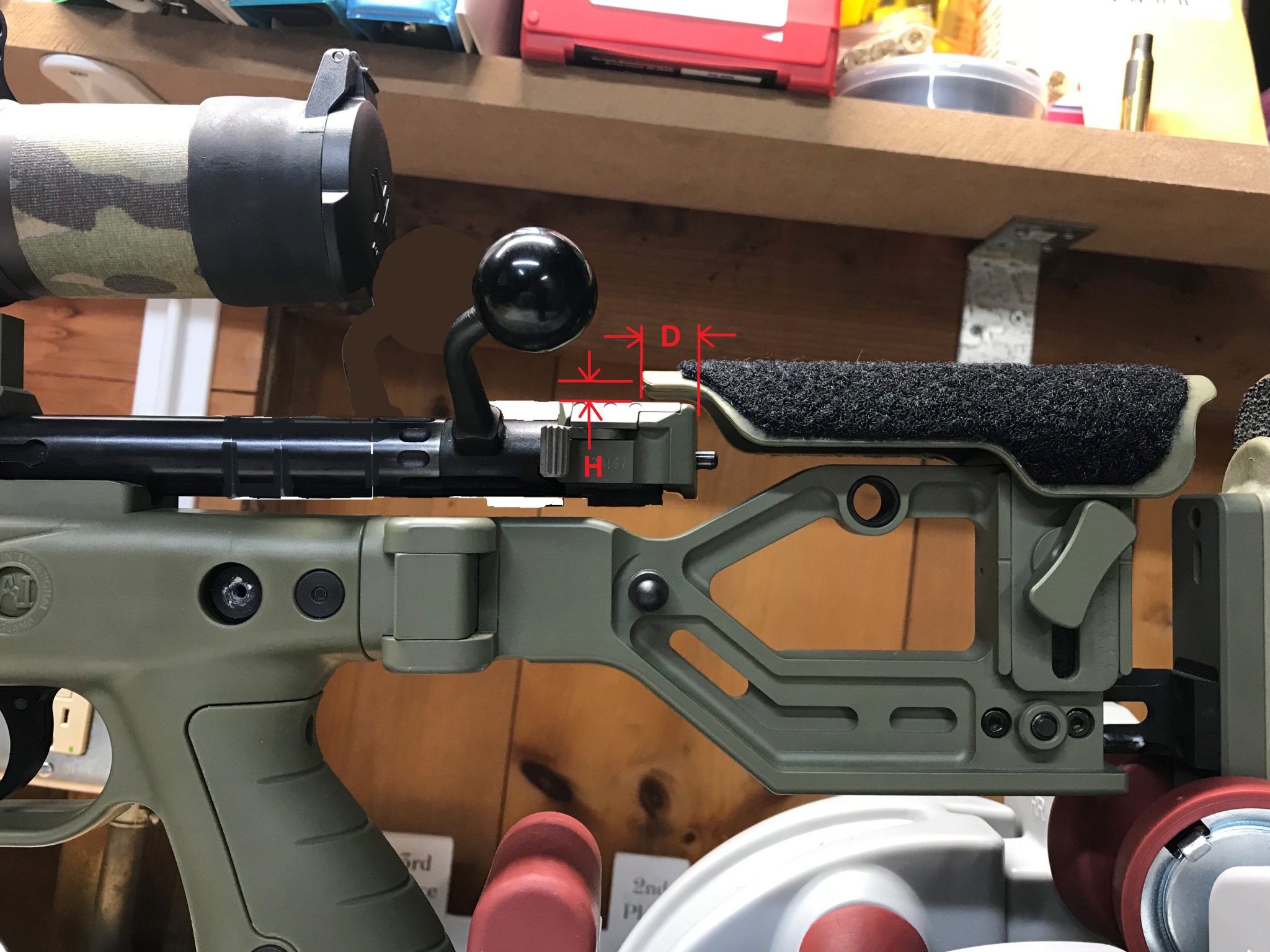

Can someone with an AXMC do me a favor? I'm looking for a couple dimensions related to the factory cheek piece at its lowest position when the long action bolt is all the way to the rear. There is a ton of clearance with my short action AX, so I don't know how far back the LA bolt goes.
I'm working on a custom cheek piece that can go lower than the factory one, to better facilitate optics mounted in low rings. I have removed the front NV rail from my AX so I can go lower than the normal 1.5" tall rings, but I can't get the cheek piece to go any lower and still use the Wiebad cheek pad that I love. If I go through the trouble of making some replacement cheekpieces, I'd like to make sure they will work for both short action and long action AX's.
These would also be extremely useful if/when people start putting AX buttstocks on their AT's, since the AX buttstock really is designed for the tall action rail + 1.5" rings. I think many will struggle to mount their normal 1" height rings on their AT once the buttstock is swapped.
Here's a crudely photoshopped picture of what I'm looking for:
- The amount the back of the bolt protrudes beyond the front edge of the cheek piece "D"
- The amount of clearance the bolt underneath the cheekpiece "H"

Hard to measure accurately but I get
D = .260
H = .085

Awesome, thanks! If anyone else wants to measure and see if they get similar numbers, that would be cool.
I'm thinking as the cheekpiece goes lower than the factory one, it will need the front end shortened a bit (something like 0.300" based on your measurement). There's really no way to lower it AND create enough clearance for the bolt to go under it.
From my experience, and from searching around for pics and videos, that front 1/2" or so of the cheekpiece is never used. With the adjustability of the AX chassis, you don't need your cheek to be that far forward on the cheekpiece. So if it gets chopped off, no harm no foul, even on the short action AX where there is about 0.300" of clearance already.
