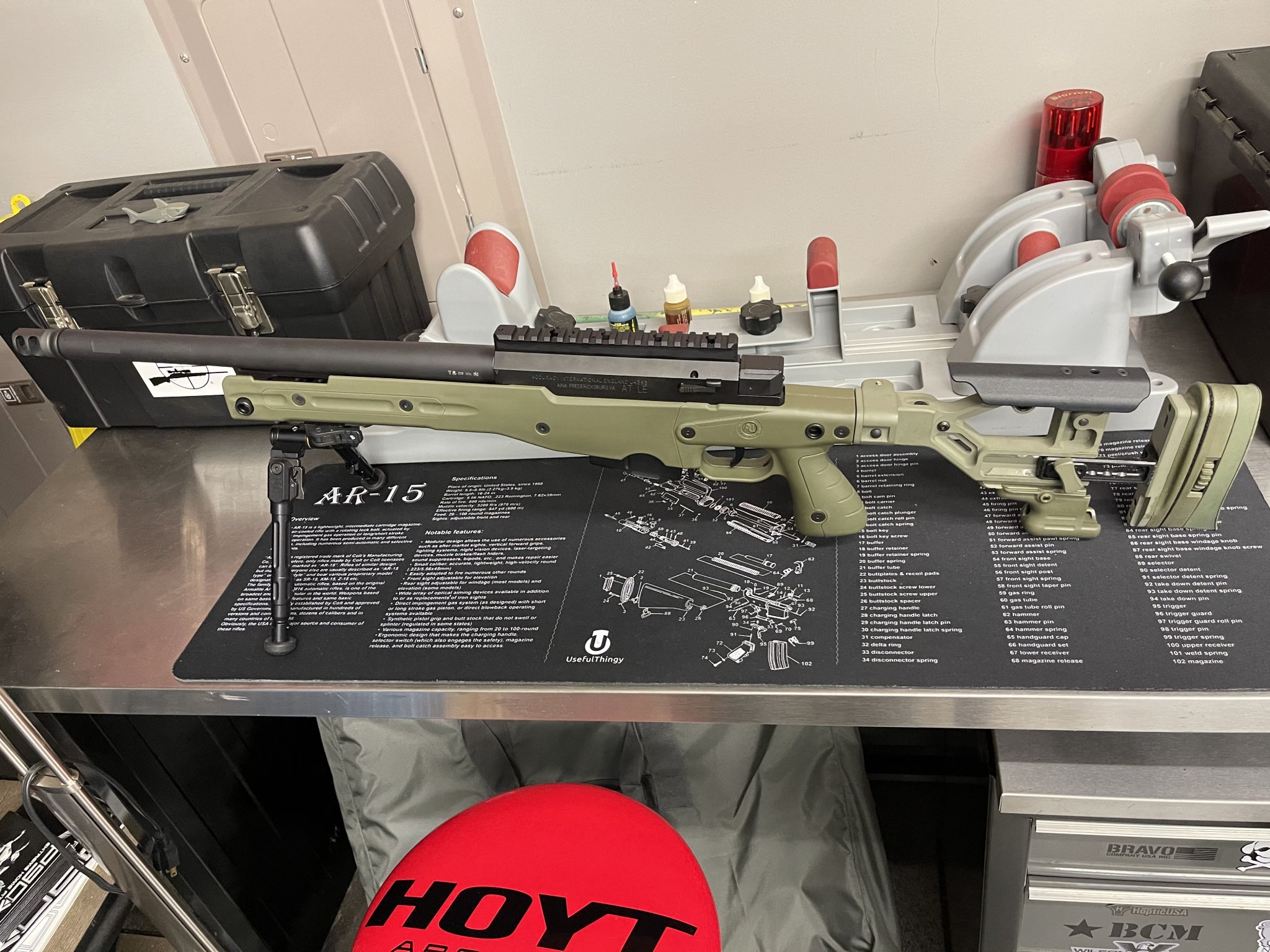

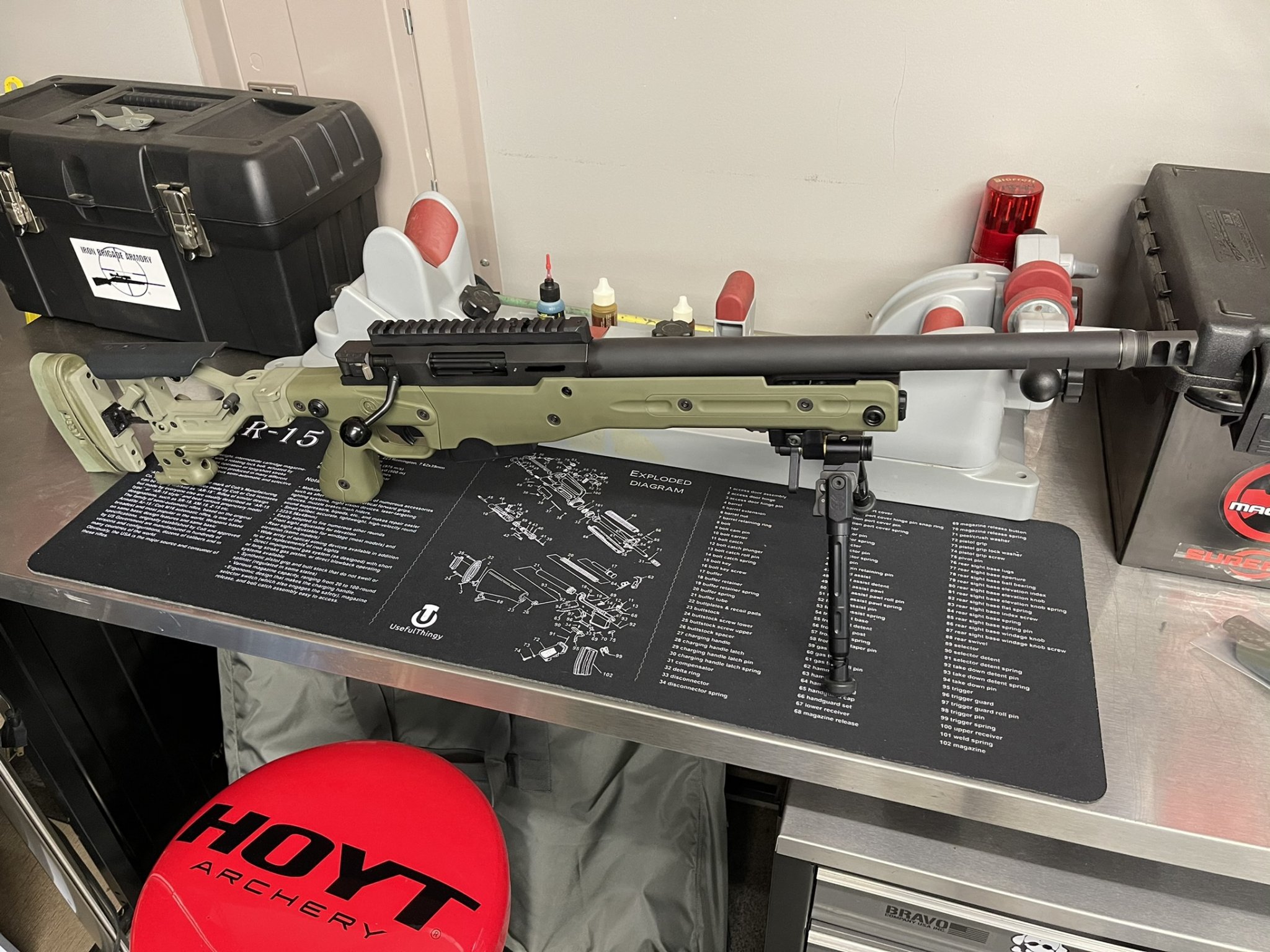

Having played around with both, the only real advantage I can think of for some people is the ax stock folds the stock to the right capturing the bolt. Versus the left for the at

The AX stock has some advantages, whether or not it's worth $800 is up to you
1) It folds over the bolt, making the profile thinner for packing/transit
2) Can quickly adjust cheek piece height and LOP without tools. Mainly useful if other people shoot it or if you go from warm weather to cold weather and need to adjust for bulky clothes
3) Buttpad is much more adjustable for up/down and more importantly cant. AT buttpad can adjust like this but needs an add-on accessory.
4) Picatinny rail on bottom of buttstock for a bag rider attachment
5) Cheekpiece is easier/faster to adjust laterally than the AT cheek piece

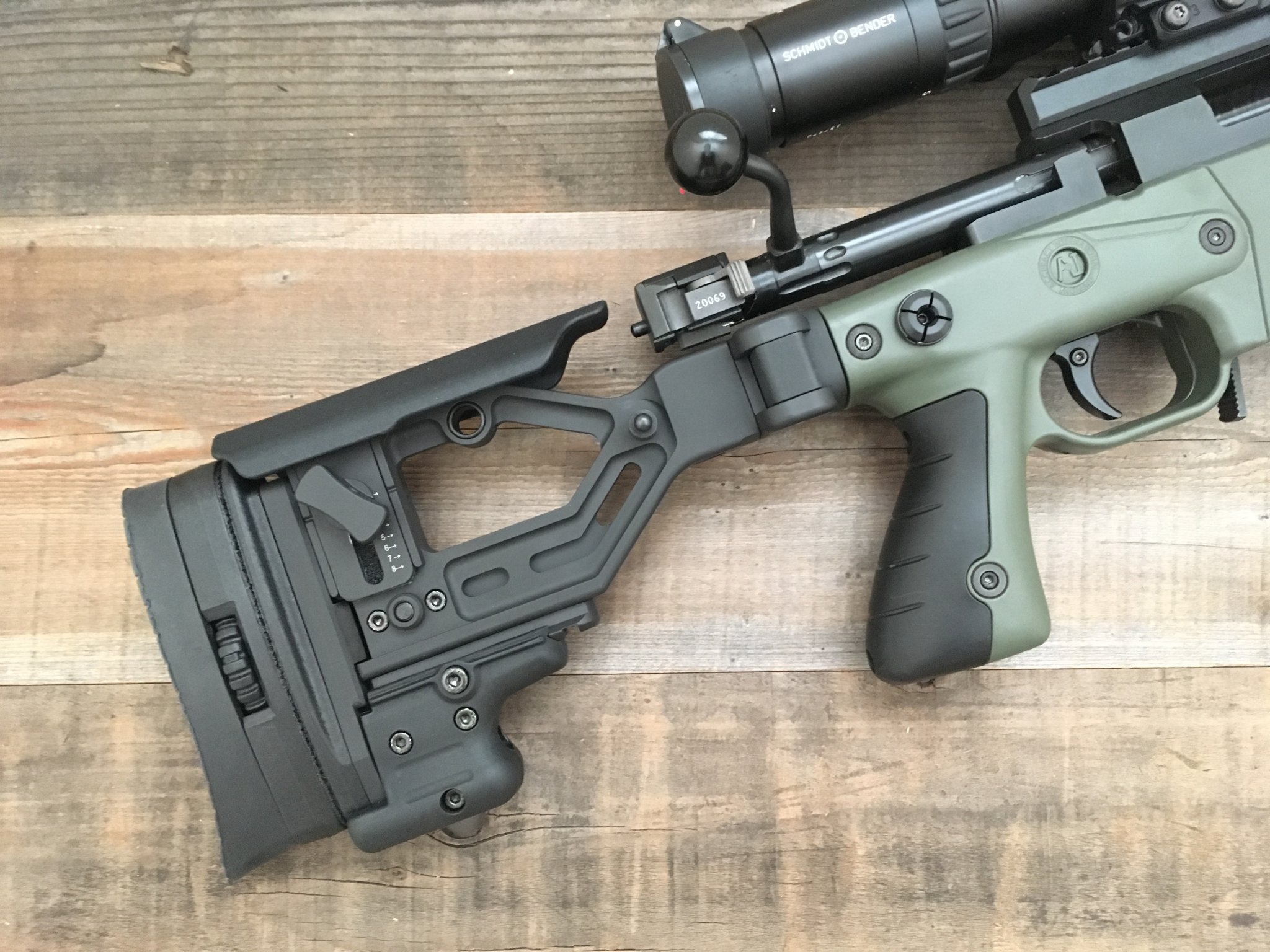

The cheek piece from samb300 is def nice it def cuts some height off ...I’ll let ya know when the 1.35 S&B Spuhr arrives with S&B 3-20 US for height. That’s a 20 moa high action rail on an AT LE with AX butt stock

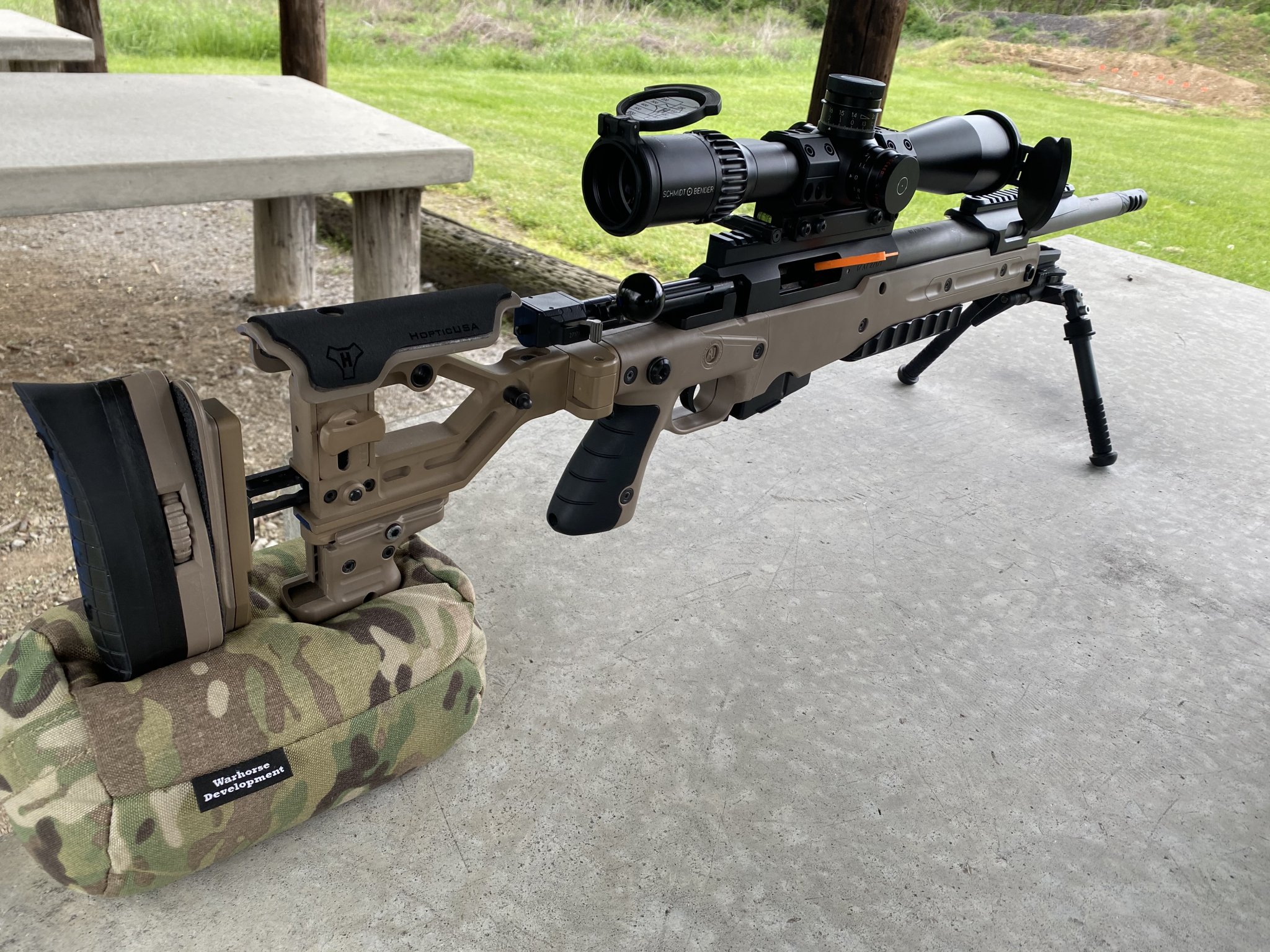

A few things to consider on the AX/AT stock conversion.
1. The cheek piece sits about 1/2 inch higher on the AX compared to the AT. If you have the high scope rail (like the one pictured) its works fine. If you have the low scope rail @samb300 makes a low cheek piece for the AX stock . The cheek piece in the pic is the @samb300 cheek piece.

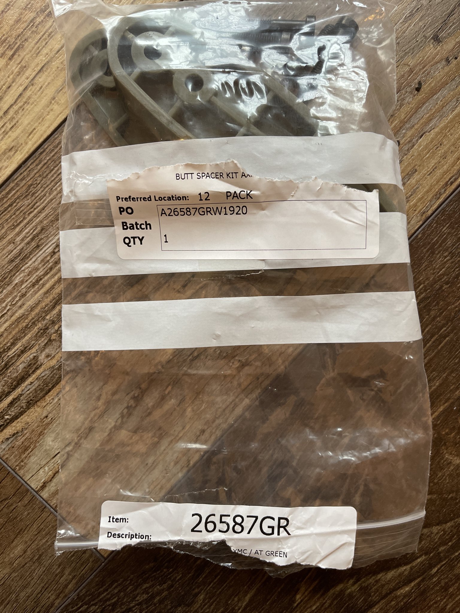

2. The AX stock is about 1/2 inch shorter on LOP. If your tall you may need a few spacers for the AX stock. Doesn't come with any.
3. The AX stock fits me better than the AT stock. It was worth the 800 dollars to me.
4. Most important it looks AWSOME!

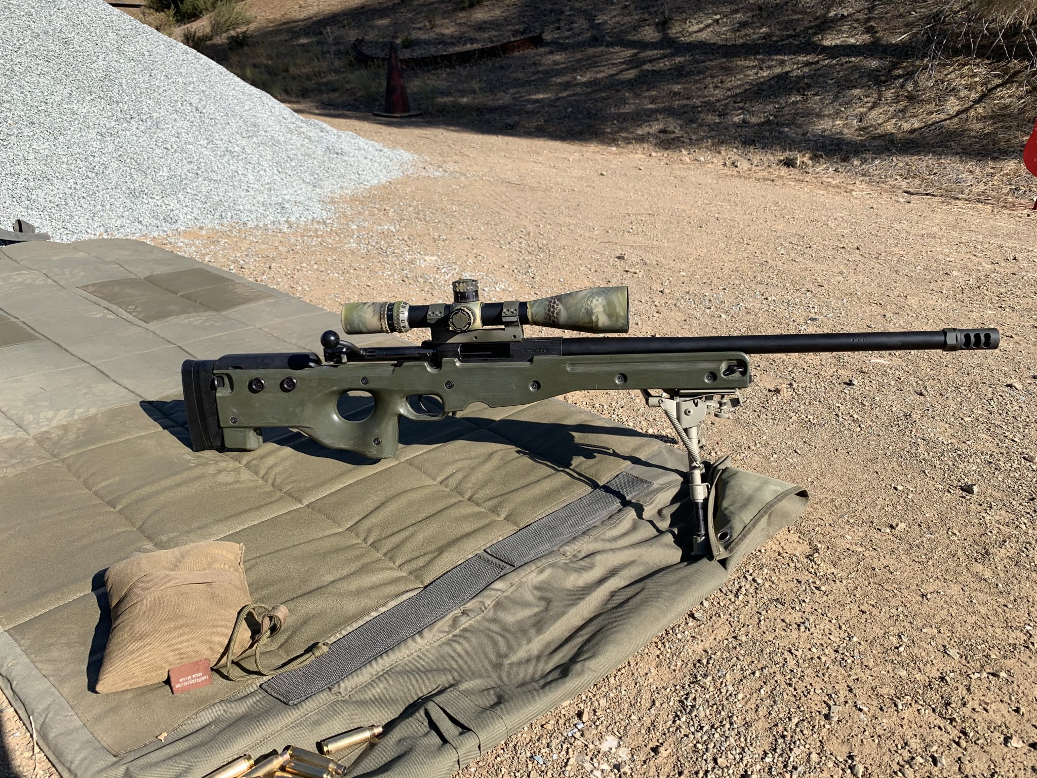

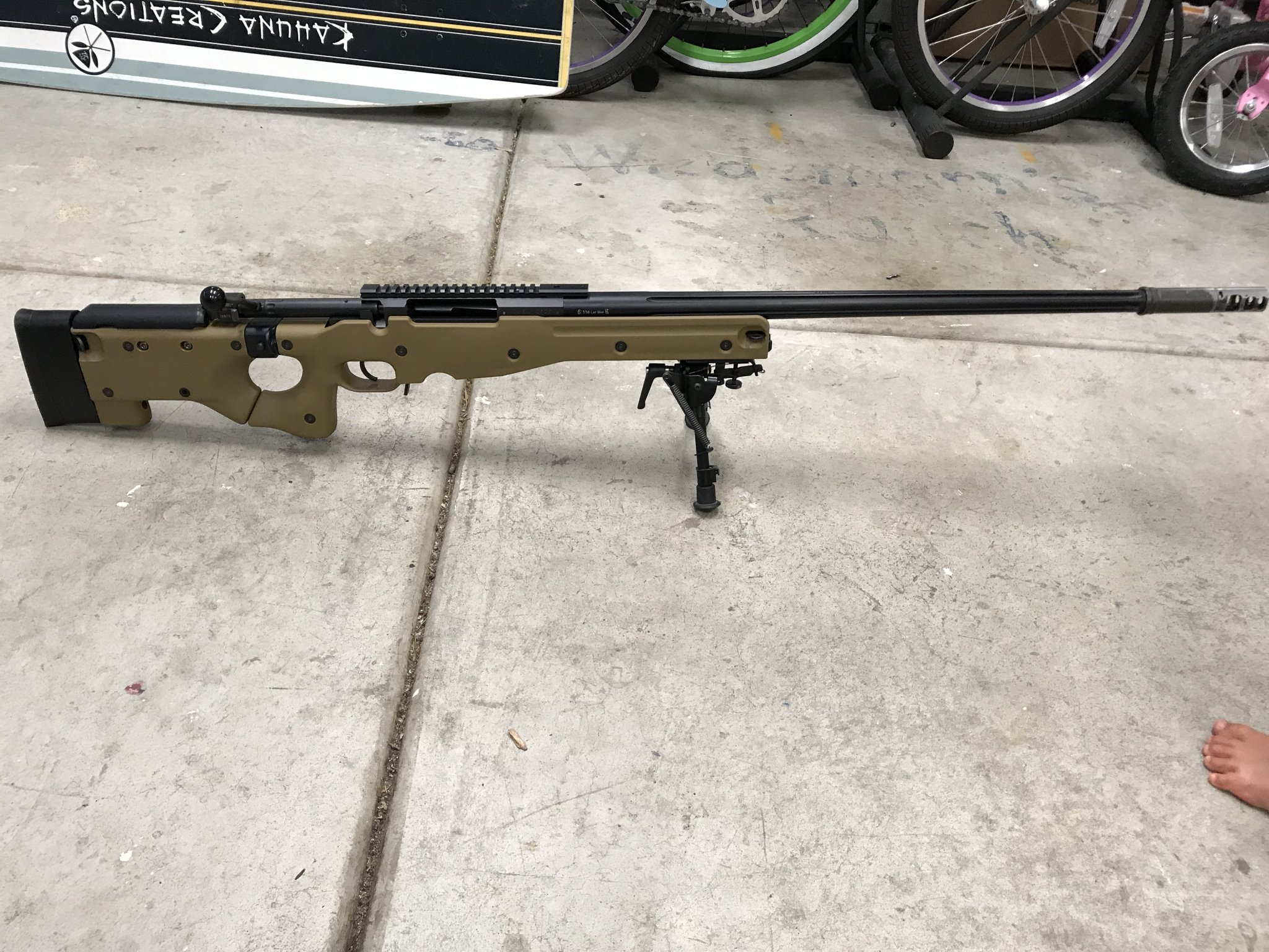

And some old school AI thumb hole Stocks :)
One GAP snuck in with a Badger break on it, smith installed. In the middle.

Completely depends on you. I don't like my ax stock fully adjusted open so I have it about halfway then use a spacer or two to finish getting the correct lop. I think I use 1 large spacer and 1 thin
