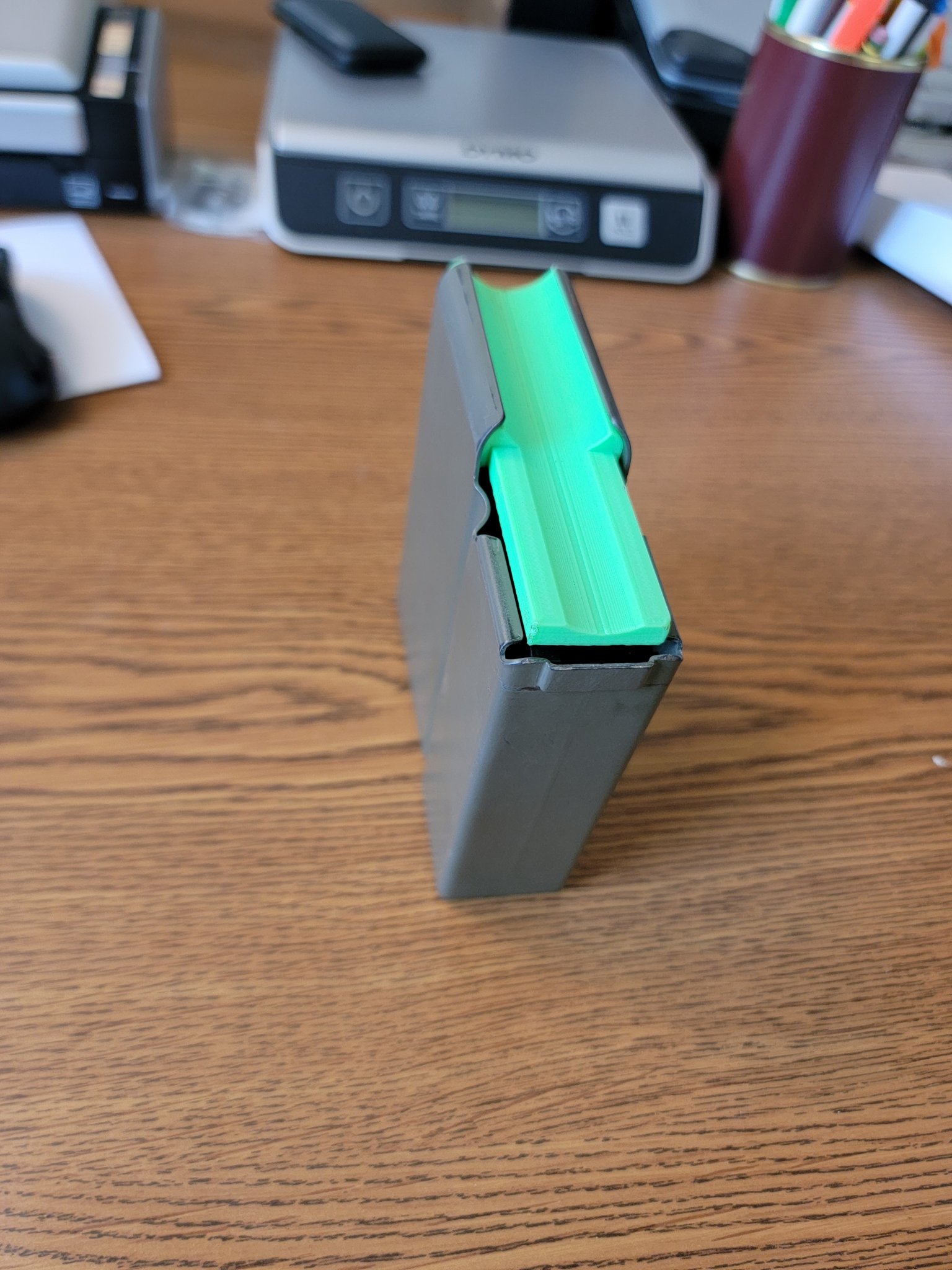

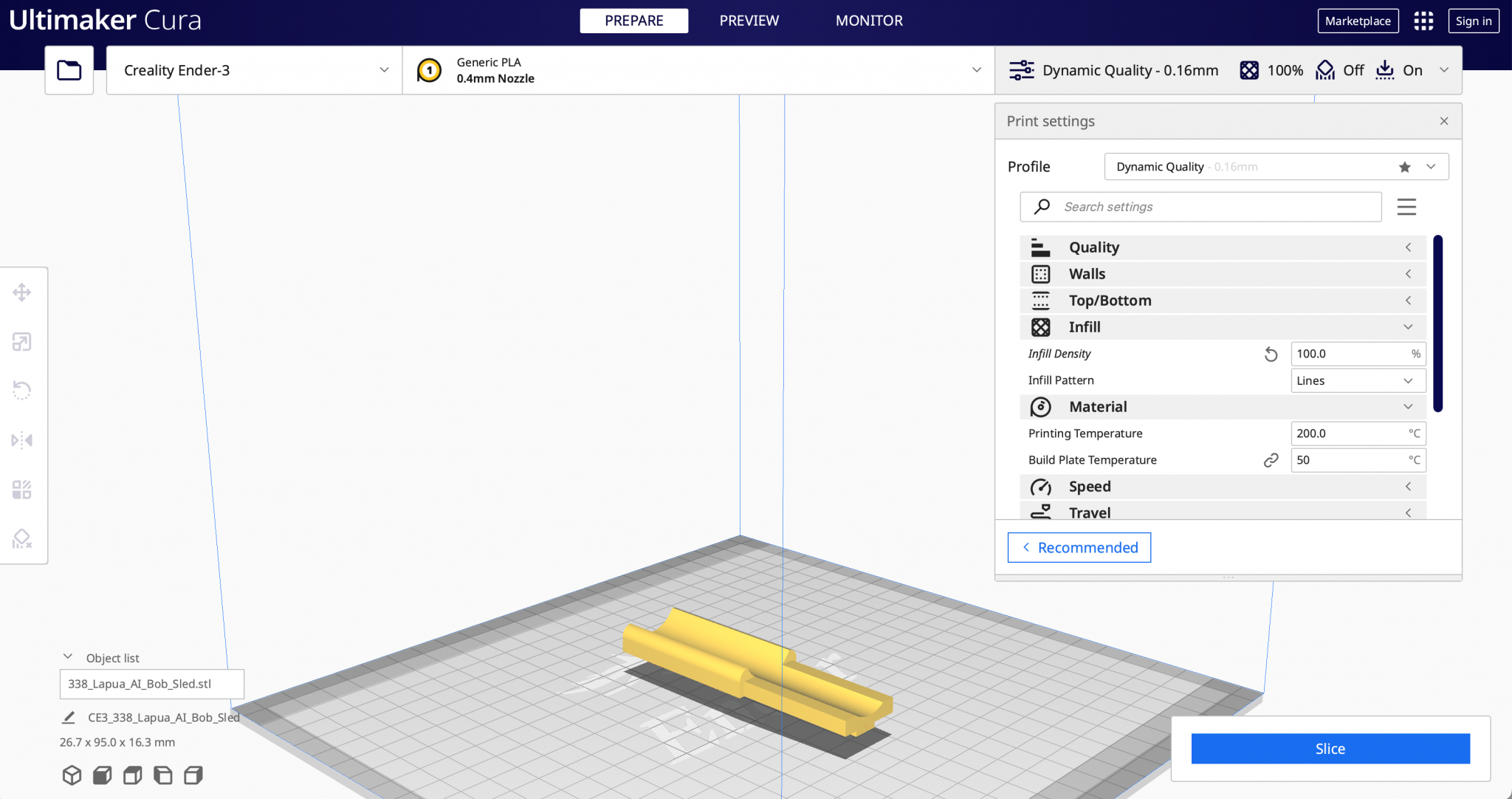

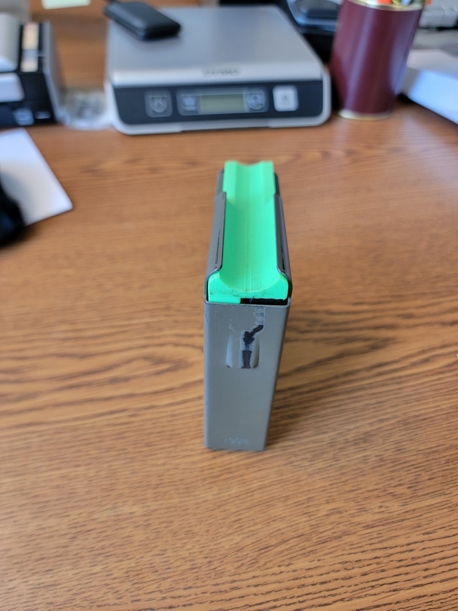

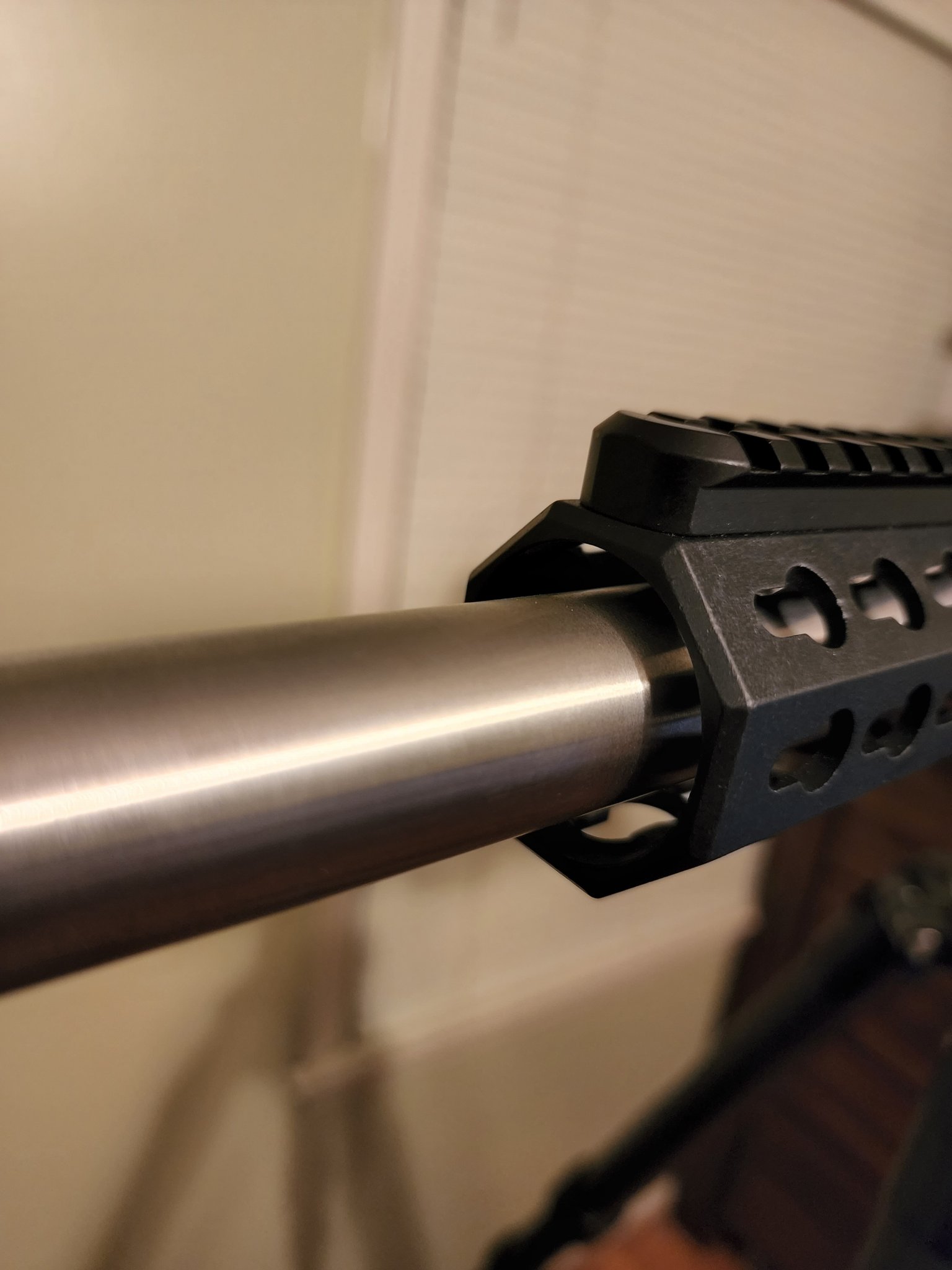

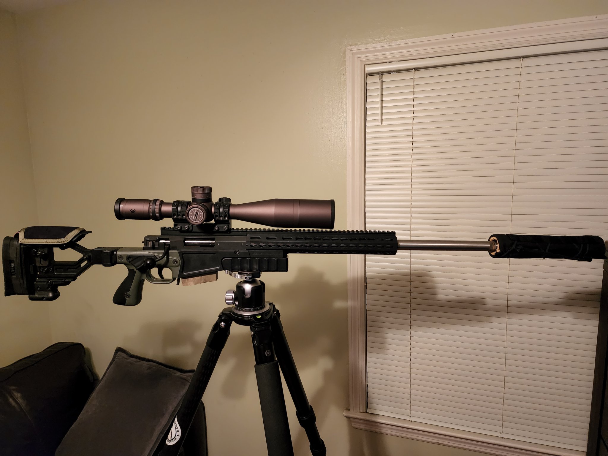

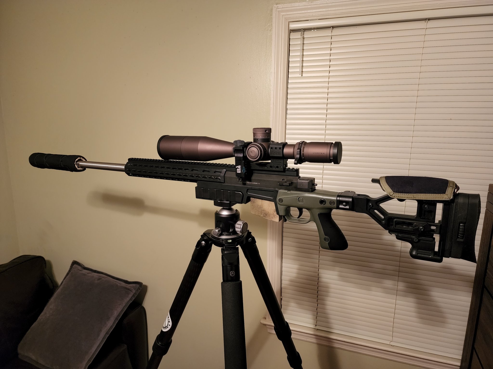

Spun the 33xc barrel on and realized I never purchased a single shot sled 🤣. View attachment 7929562
I'm not familiar with that cartridge, but if that rifle uses a standard AXMC 338LM mag you could print one. If you don't have the capability I could print one for you.
I'm not familiar with that cartridge, but if the rifle uses a standard AXMC 338LM mag, and you have the capability you could print an insert. I can send you an STI file.

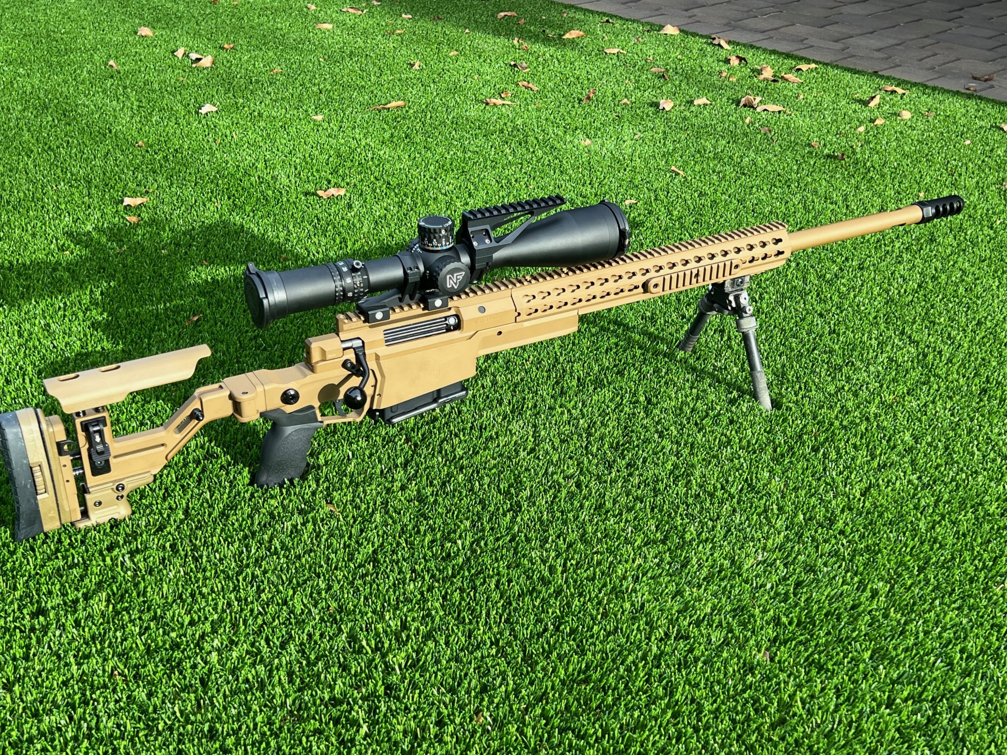

Sounds like he doesn't have to mow then, just blow the leaves into his neighbor's yard, leaving more time for shooting, reloading or general fucking about... Seems like a no-brainer to me!
It's 100% turf and worth every penny. No more mowing, fertilizing and irrigating, more time for bourbon and putzing around.
