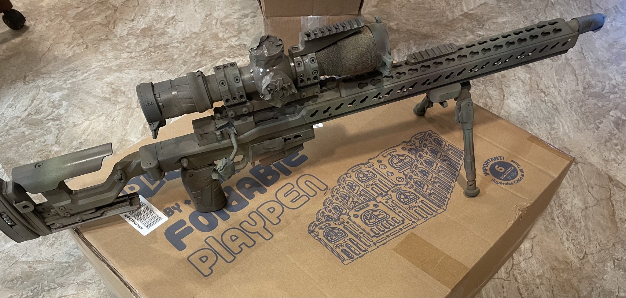

Finally got an AIAT I’ve been wanting for awhile. Just waiting on a set of scope rings. I took the skins off and took the barrel off to make sure everything was clean and put some anti seize on the barrel threads. I removed the quick change screw completely unintentionally but I minded the smaller wash as not to lose it and reinstalled it, the barrel and torque it to 49in/lb. I then noticed in the manual that it says not to completely remove the quick change screw… oops. I assume this is so you don’t lose the screw and/or washer. Correct?

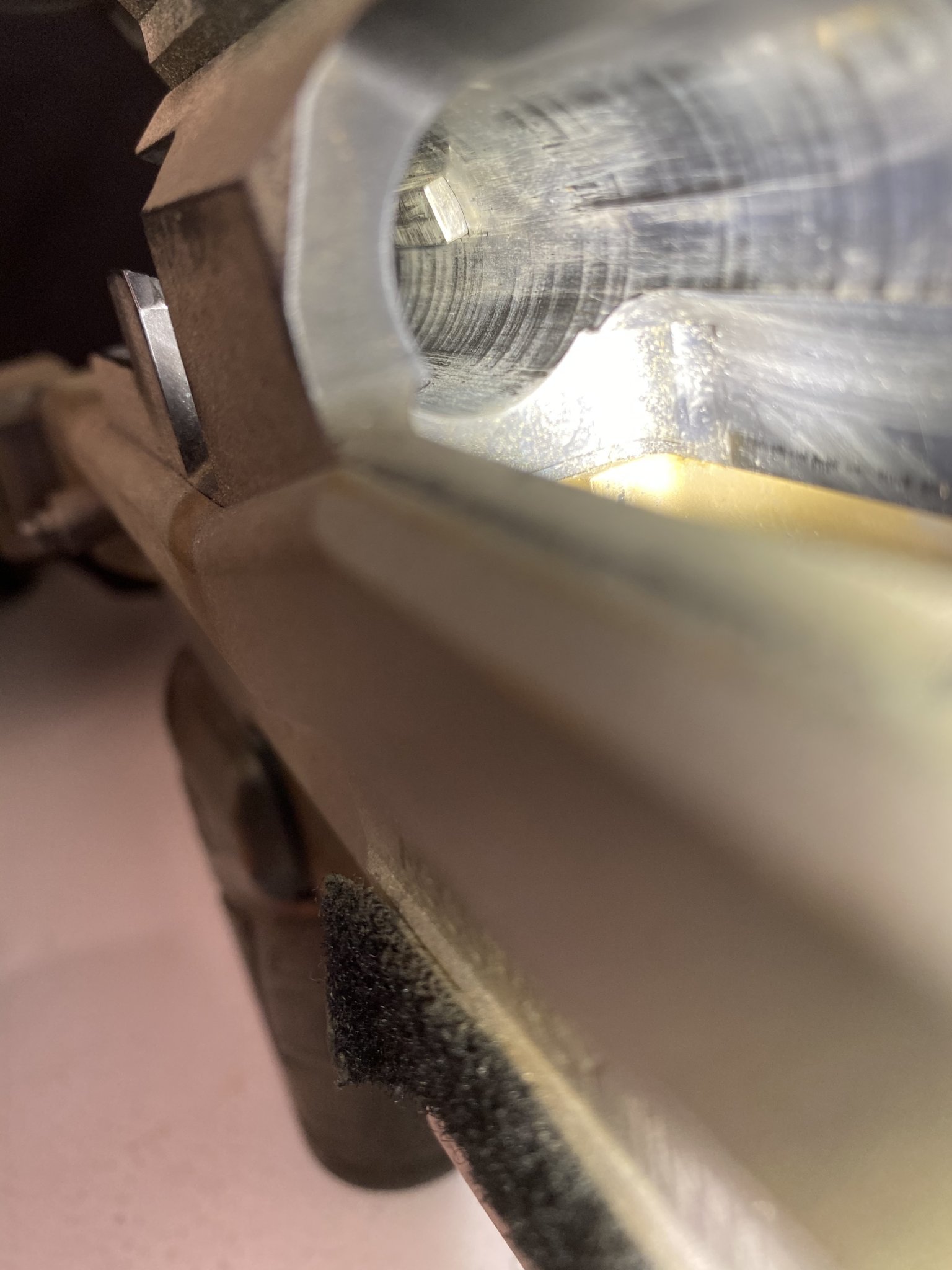

Anyone else get a sticky bolt ? What fixed it. Dry or wet it still does it. Binds during forward travel. Maybe I need to soak the action in CLR cause gun scrubber ain’t cutting it.

I guess the brass is a separate issue. Thinking back it binds up empty no mag etc

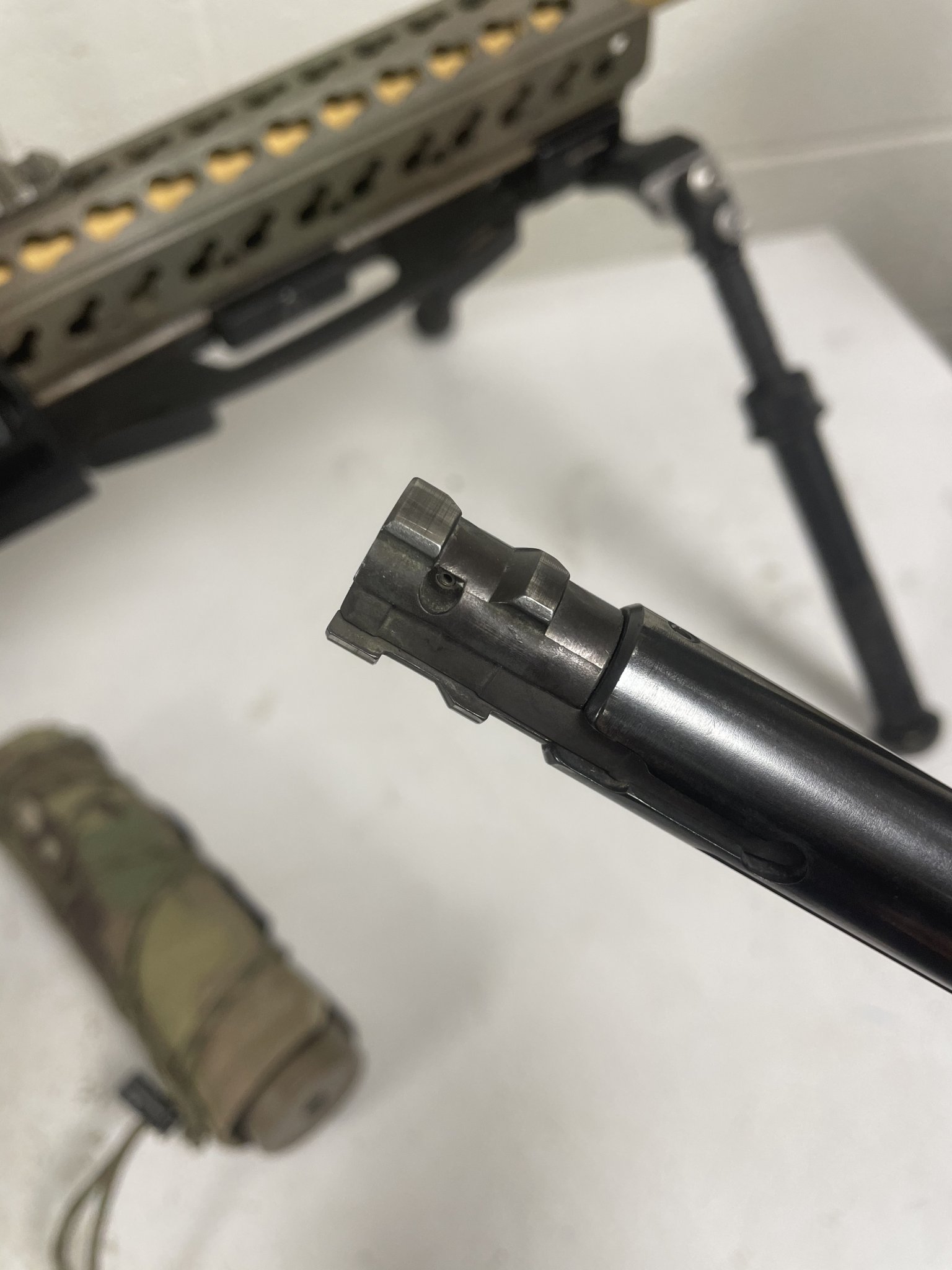

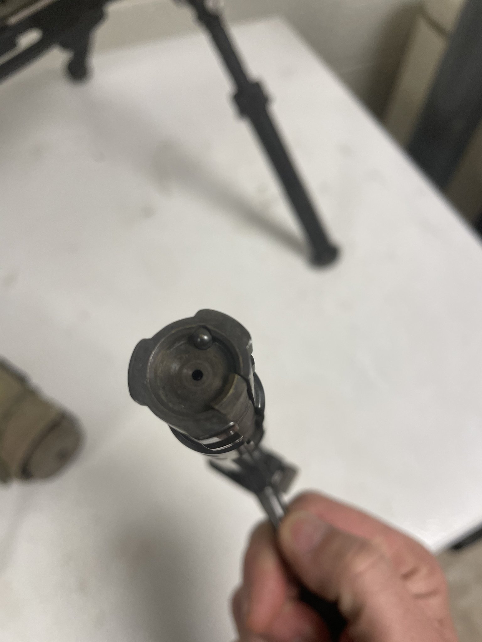

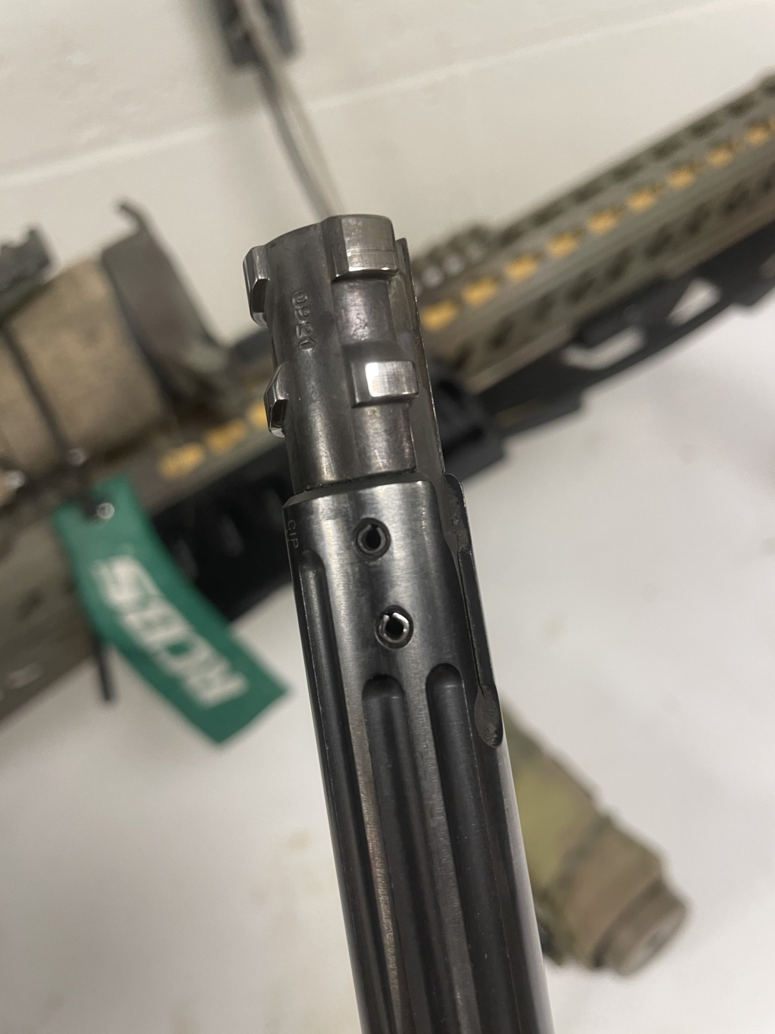

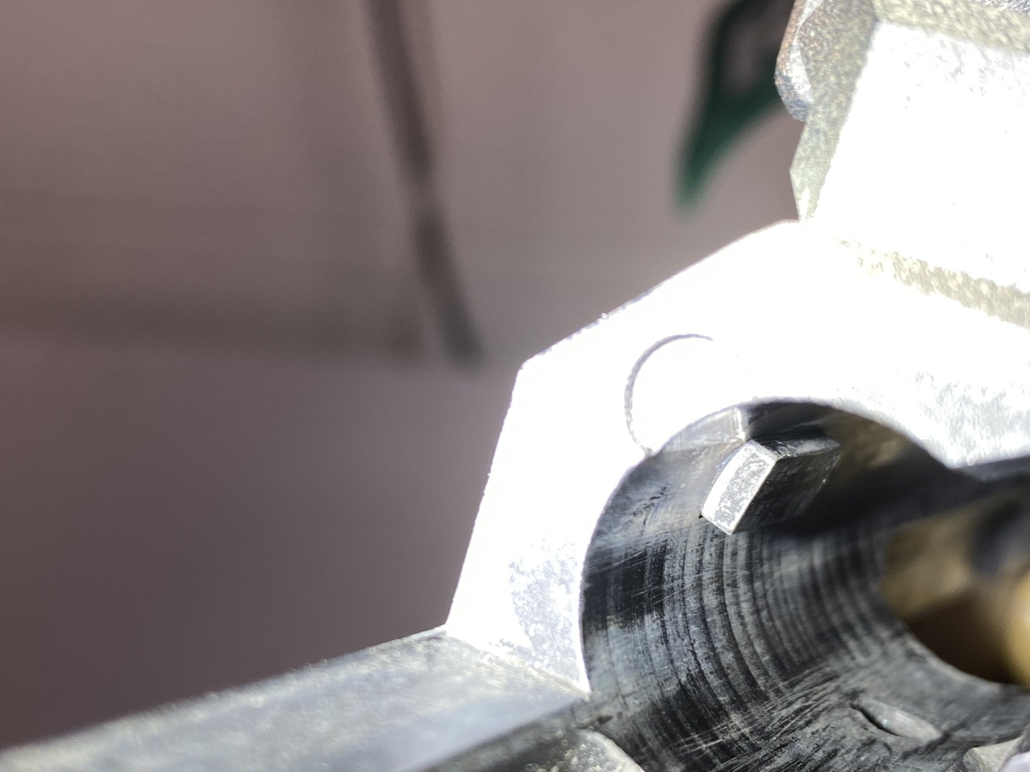

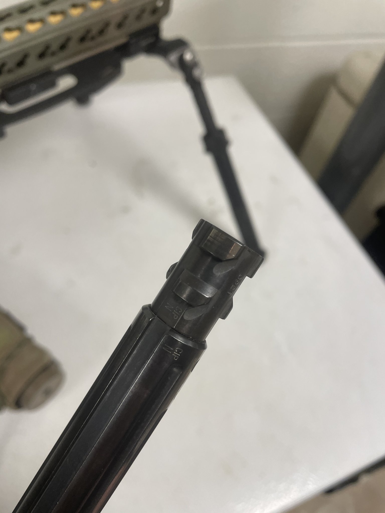

Can you send pic of the front of bolt?
Can you feel any of the roll pins on the bolt head?
If one is protruding just a bit it’ll cause all kind of issues

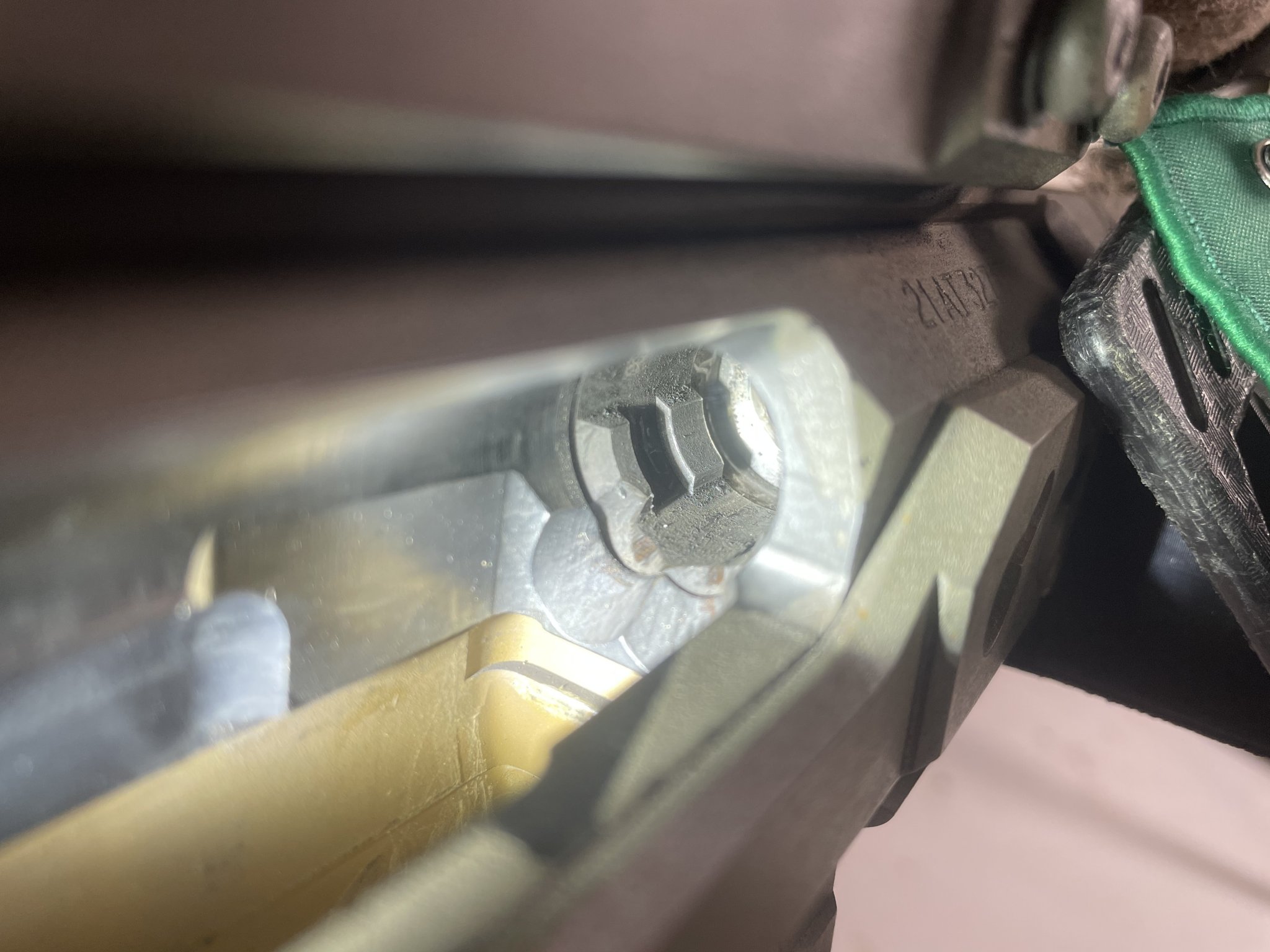

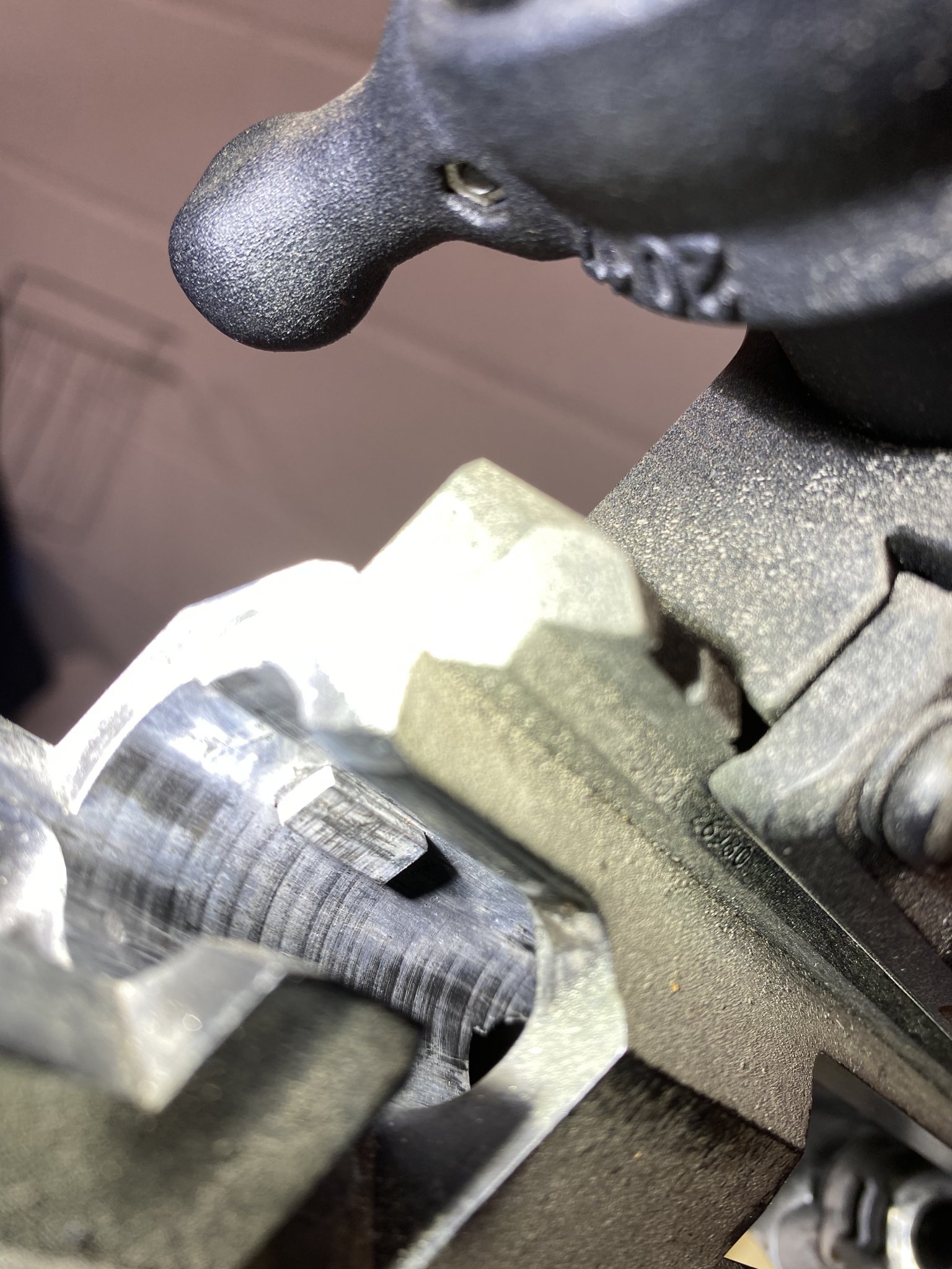

2 looked like they were out a little. I drove them down don’t think that’s it. Think it’s the bolt stop/guide. I depress it it gets a lot smoother
If you pull the bolt stop and mic the front vs the back id almost bet you mushroomed the front causing drag. That's if it got better when depressed.
Reactions: BurtG
That bottom roll pin in the last picture sure looks polished. Unless it's the flash.
But on the plus side. I should be getting my stock back soon so I can shoot my AT-X again soon. So their warranty department was able to turn it around pretty fast.
Any scratches in the receiver? Trophyhunter should be able to answer. But I would think if they already slid once then I would replace them all together with new pins.

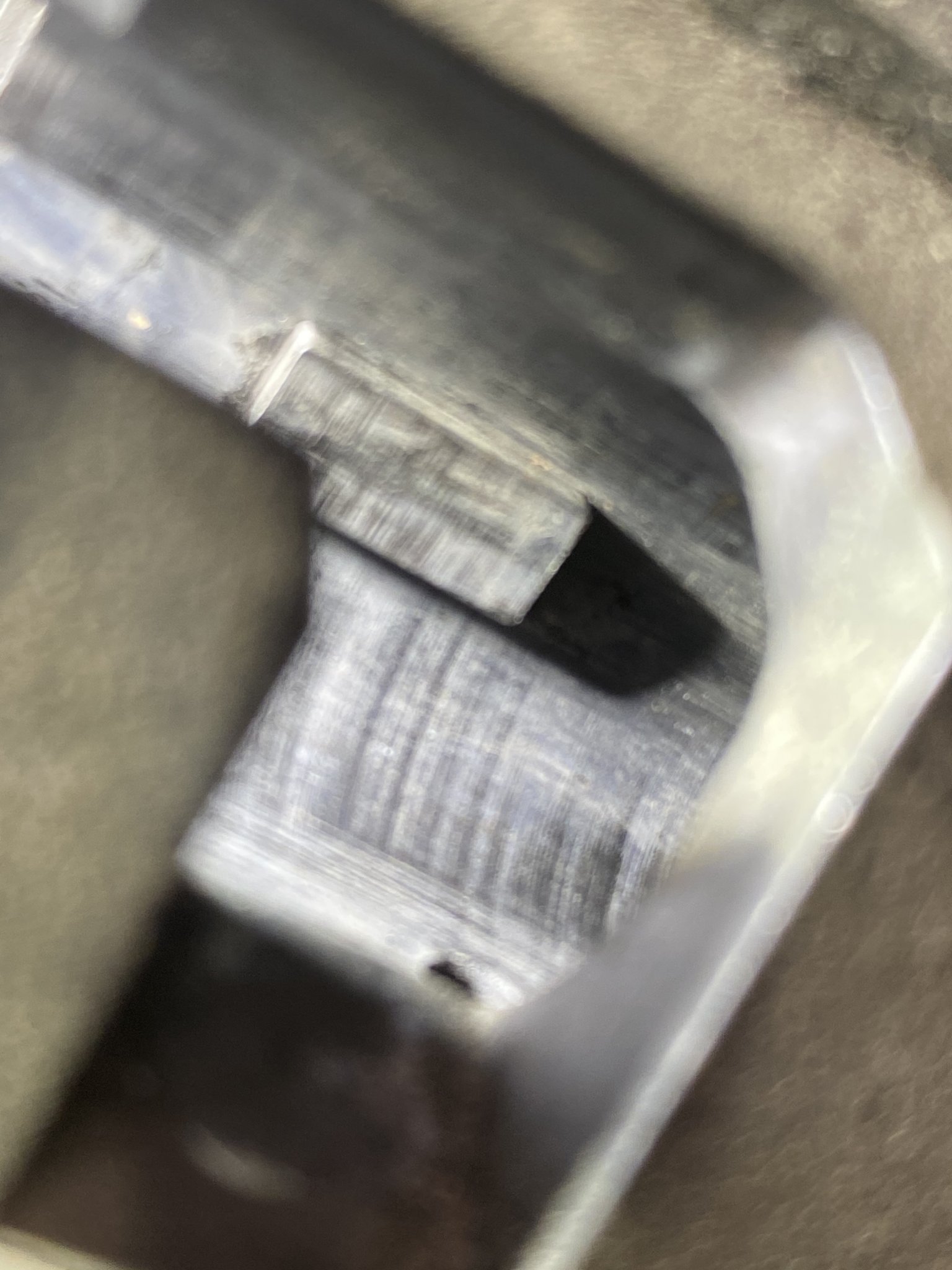

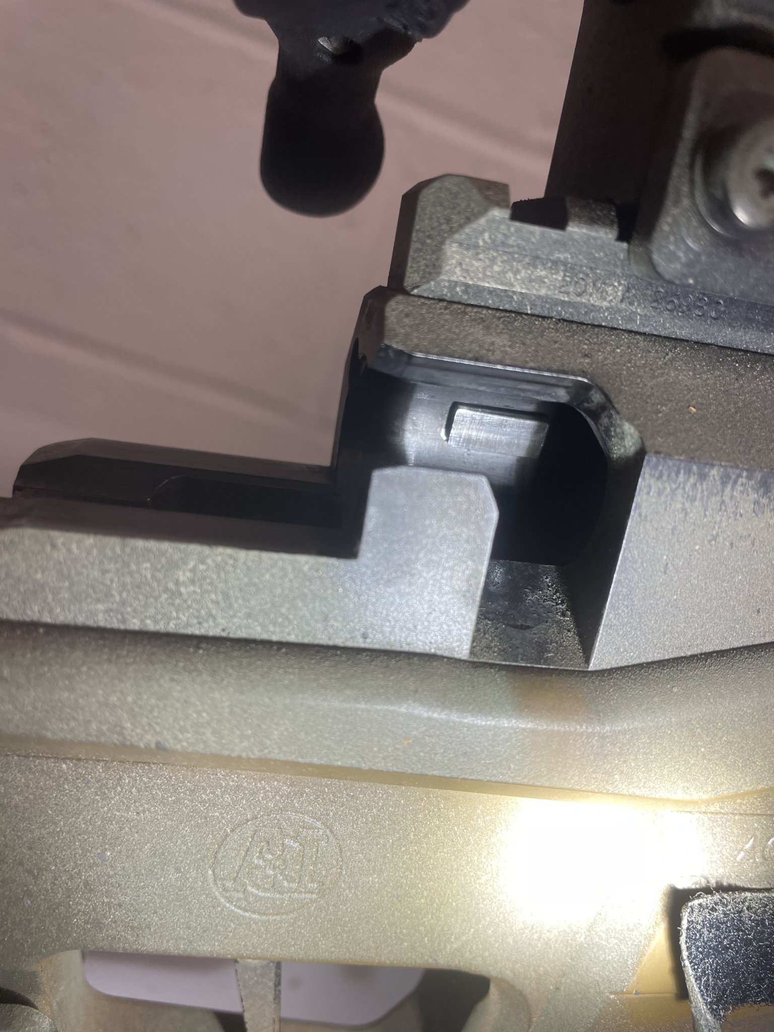

Did you rattle can inside the action and barrel extension ? Sure looks like it
I am a professional
As I stated this ran great after paint fir a bunch of matches and other activities. This problem reared its head at the mkm snow match a couple weeks ago
Oh the inside of the action is just dirty af from last 2 matches and practice. This berger ammo is dogshit

We know you don't HAVE TO... However, have you considered cleaning all the shit out of your action, and sorting out the feed ramp???
Everything looks dry and manky in there, that wouldn't be helping anything.
The easiest way to a smooth bolt on my AI's has always been lubing up the bolt catch channel on the left side of the bolt, and cleaning the actual stop inside the action. Light oil on the back of the lugs.

That bottom roll pin looks like it’s a tad above. The way I check them, I run a straight edge length wise of bolt. If any snag, it’ll definitely cause issues.
Also if you have any paint in the bolt stop, it’ll create a friction on bolt.
Hit that w some brake clean non chlorinated and a 12 ga nylon brush. Than some Hornady one shot. Should clear up your neglected AI ;)

So. @Nik H was somewhat right about lube I guess. I used grease lightly on the bolt guide. Seemed to help a lot. But worried this general purpose grease will gum up again when it gets cold wet frozen etc.
Looks like bolt guide is bare steel? Seems it should have been coated with Teflon or something. ?
