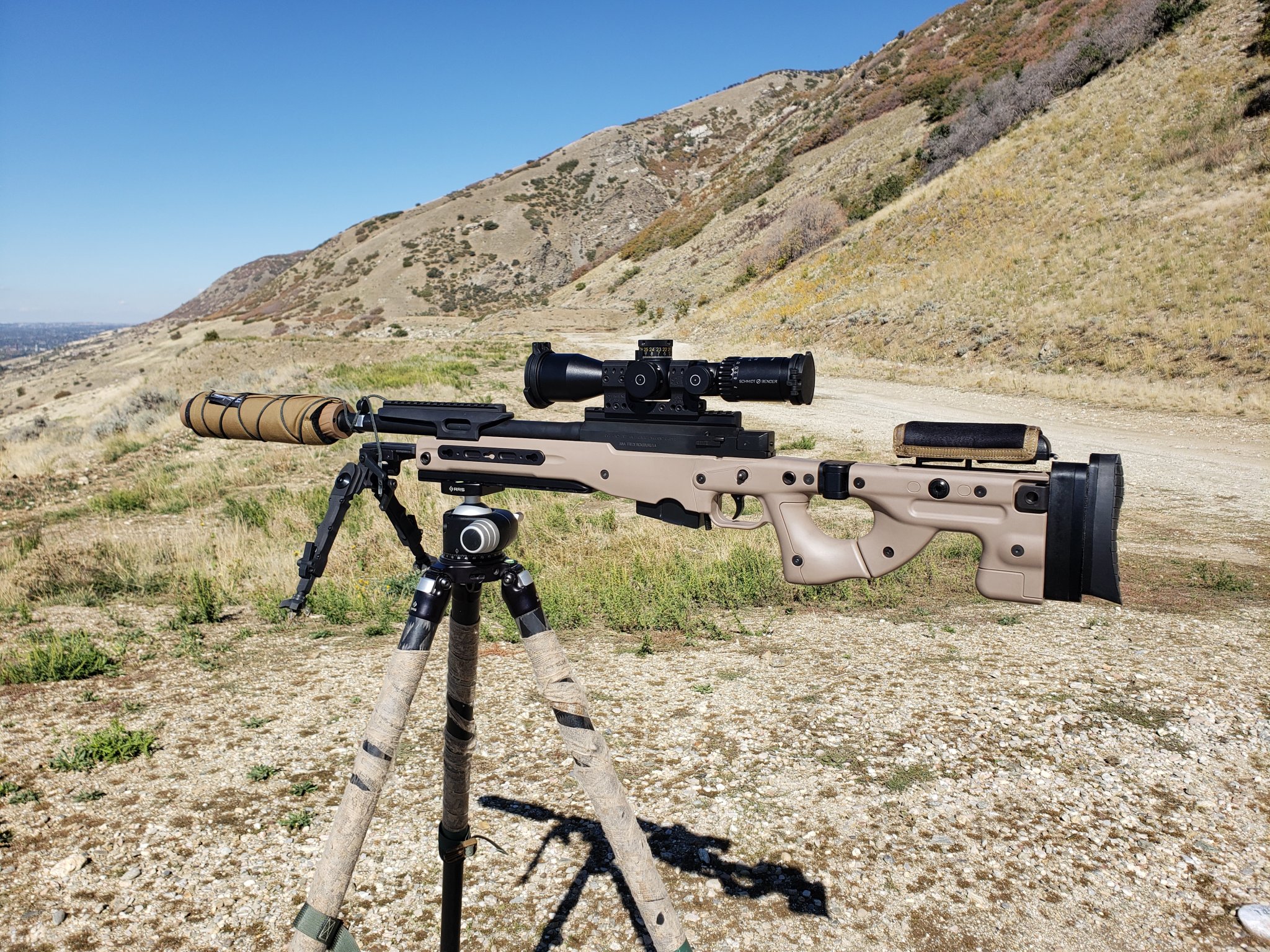

What cartridge is that, 338LM?
And what DA (approx)?

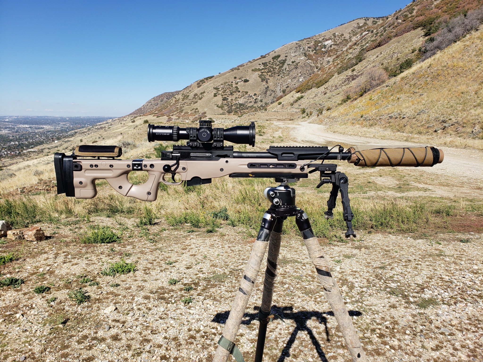

He’s moving to an AIAT thumbhole. The true OGYou outta the AI game now or new ones cooking?

Looks like a TBAC SR can so that’s a witness hole for the lock indicator.First post since 2020?
Who ate a hole in your suppressor cover?
Good id on the can, however it’s a liberty with a hole that has no where to goa heated dialogue regarding a flat pallet of colors may have given me pause.
I thought it was a Liberty but he told me doesn’t make them with the hole?Good id on the can, however it’s a liberty with a hole that has no where to go![]()

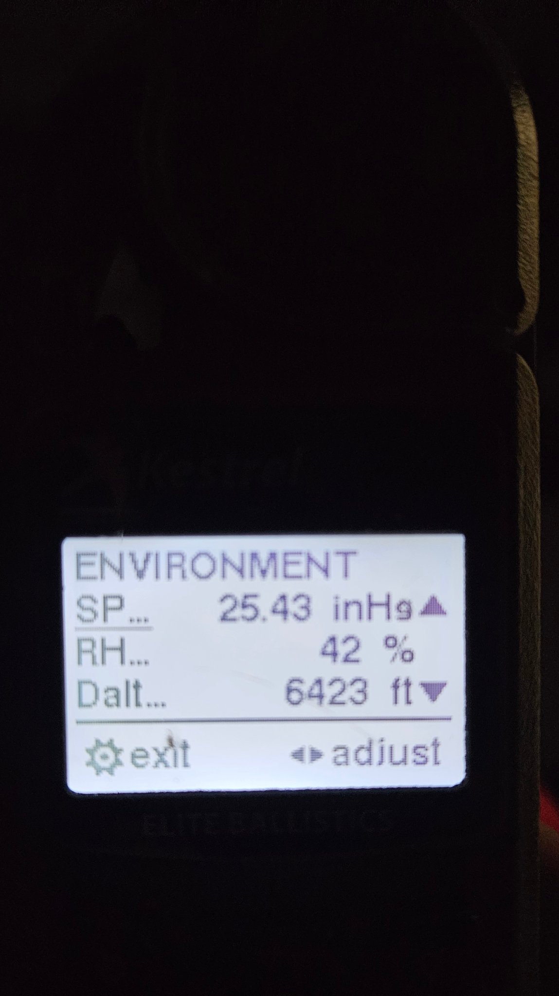

Thanks. I shoot 300PRC, 300NM, and 338NM, all out of 27" suppressed AI factory barrels. None of them will do 947 yds with only 5.4 mils E! But the highest DA we ever see is about 2500.300prc 4800ft usually
To your point, the cover was intended for a latched can.I thought it was a Liberty but he told me doesn’t make them with the hole?

Ah that makes sense.To your point, the cover was intended for a latched can.
if the mk5 wasn’t indication enough, I’m a poor boy with a hot can that needed a wrap.

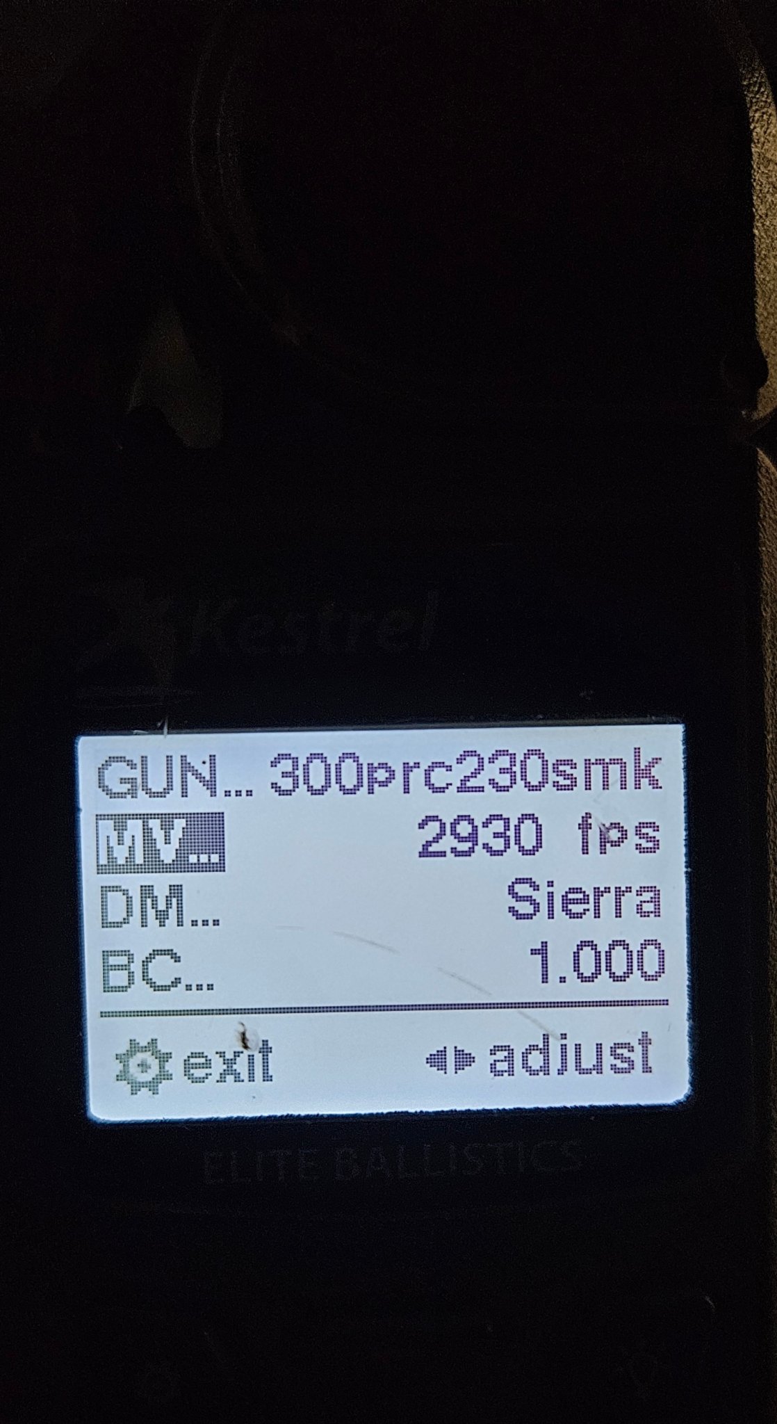

All good. Makes even more sense. I'm running 230 LRHTs right at 2900 in the PRC, but the DA is the big difference. I'm at 200ft MSL.2930fps with the new 230smks sorry I lied 6400ft... Actual altitude at that spot 4800ft
What powder and charge are you using?

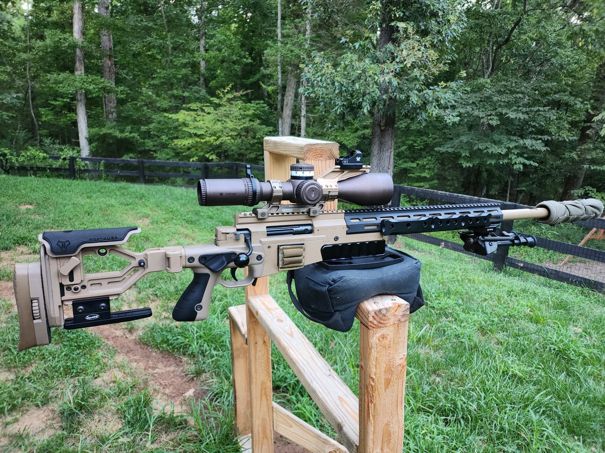

Oops, this is a pic thread, so it’s the one in the middle:
Interesting! I'm running 79.0 Retumbo.78.5 gr of retumbo acclimated to 35ish % rh for 2 weeks+ prior to loading
79 puts me basically right at 2980-3k.. I start to crunch at 78.7 tho even with the drop tube in order to mag feedInteresting! I'm running 79.0 Retumbo.
I saw first signs of pressure at 80.0 (Lapua brass, Fed 215M primer, can't remember the MV). I tried 79.5 and was close to your MV, but ES/SD was worse. I have not tried controlling the humidity other than keeping it tightly sealed and stored inside the house. What kind of ES/SD are you getting, and how are you controlling humidity? I'd guess mine is probably around 45-50% RH inside (in AL).

Nice. ThanksI don't control it per say after trial and error. I just open it up a couple weeks before I'm ready to load for a match and let it sit out.
I found after 12 days being left open it stops speeding up until I assume it's fully in homeostasis with the Utah 30-35% all year long avg rh. If I was living in a more humid climate I would prolly run something to dehumidify it but it's so dry here I don't see the need with the type of competitive shooting I do.
Would have to look back at some chrono data but I have put 40 rounds of this lot over a Garmin it's like 9sd and less than 30 es

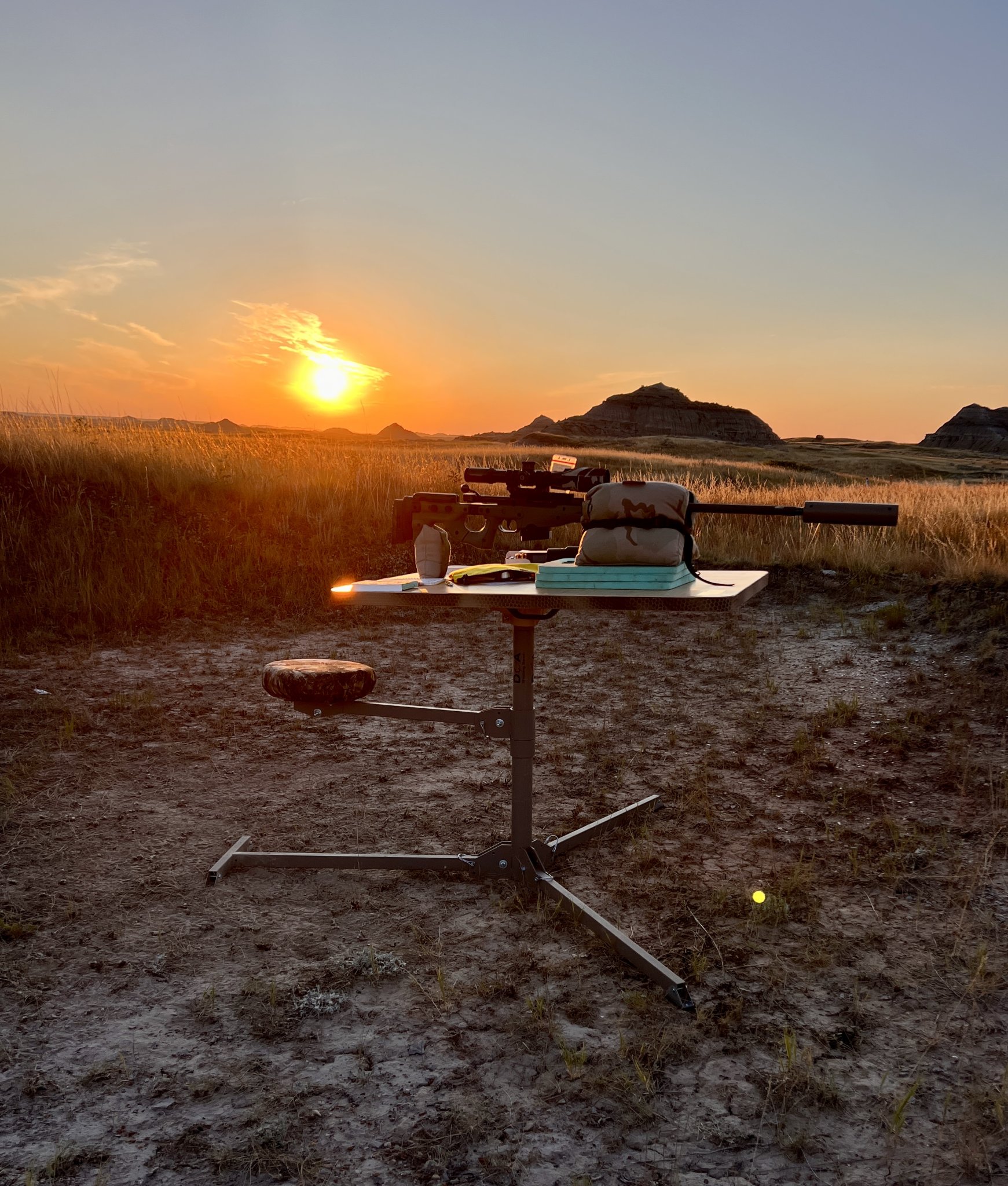

Dude thats a great looking picture and that land….View attachment 8476832
AIAT vs. prairie dogs
There’s a little weird green golf ball sun flare near the table’s base.

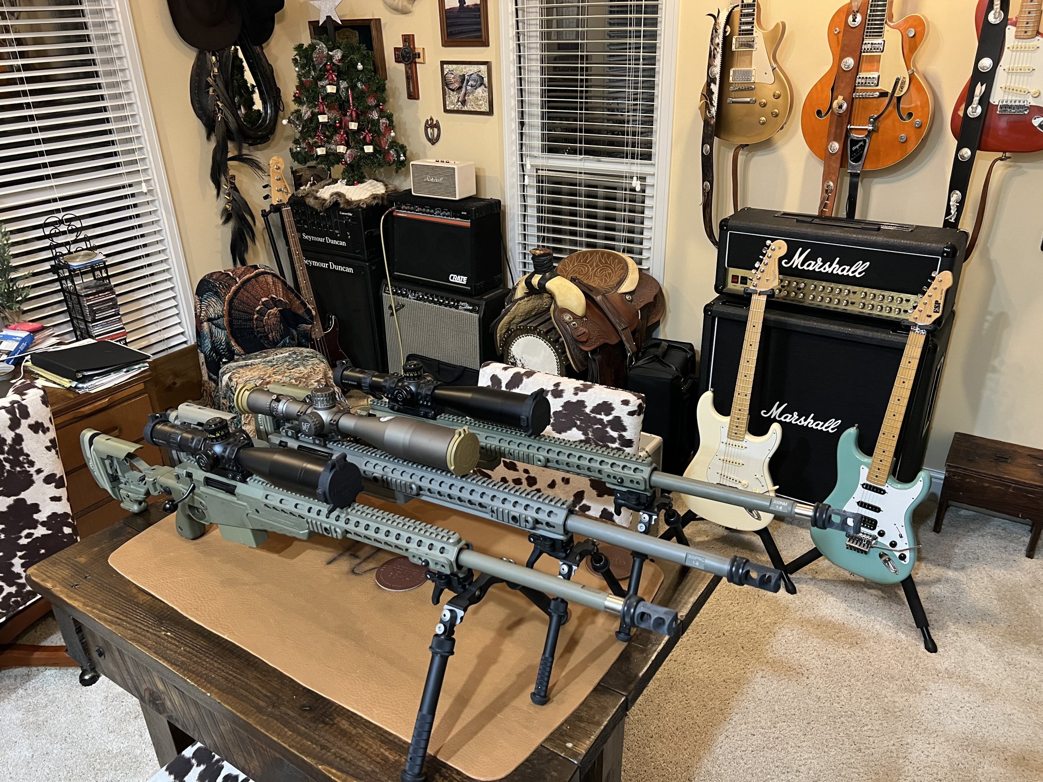

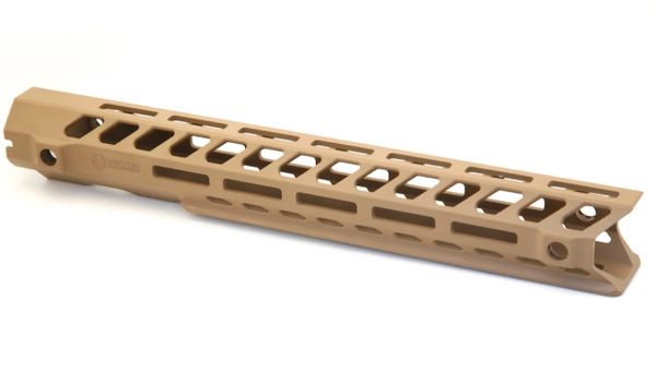

Is that an AXSR hand guard with the integrated arca? If so l, is it as easy as ordering an AXSR hand guard and installing it on an AXMC? Interested in doing this myself.My current AXMC setup. Yes, it is for PRS. I used a dremel to fit the Reptilia diving board on the Vortex Gen II. Currently I have a 6.5CM barrel and will soon have a 25x47 Lapua barrel as well.
Hey, it was this forend for the AXMC, not the AXSR forend:Is that an AXSR hand guard with the integrated arca? If so l, is it as easy as ordering an AXSR hand guard and installing it on an AXMC? Interested in doing this myself.
I can’t speak specifically for the MC but I did it on the SA and it was plug and play. You’ll find it specifically labeled on mile high or euro for the AX SA/ MC line. So long as you are running a 20moa action rail everything should line up.Is that an AXSR hand guard with the integrated arca? If so l, is it as easy as ordering an AXSR hand guard and installing it on an AXMC? Interested in doing this myself.
It didn't matter to me, but for everyone's awareness the action rail on my long action AXMC is 30 MOA and the forend rail is 20 MOA. You might not be able to see in the picture, but there is a slight height difference in the top rails lining upI can’t speak specifically for the MC but I did it on the SA and it was plug and play. You’ll find it specifically labeled on mile high or euro for the AX SA/ MC line. So long as you are running a 20moa action rail everything should line up.
Looks likes that’s what he did.

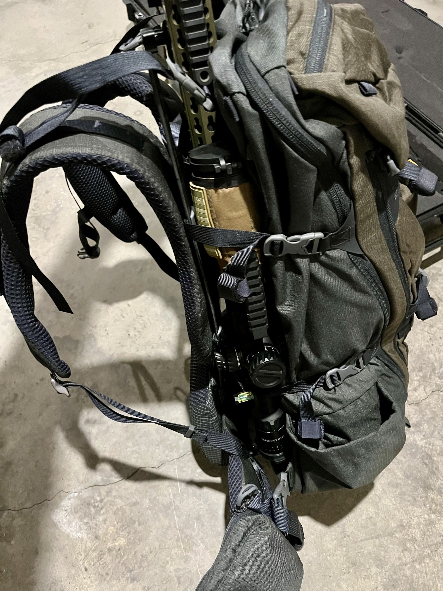

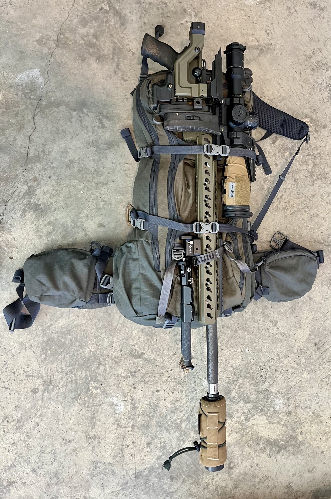

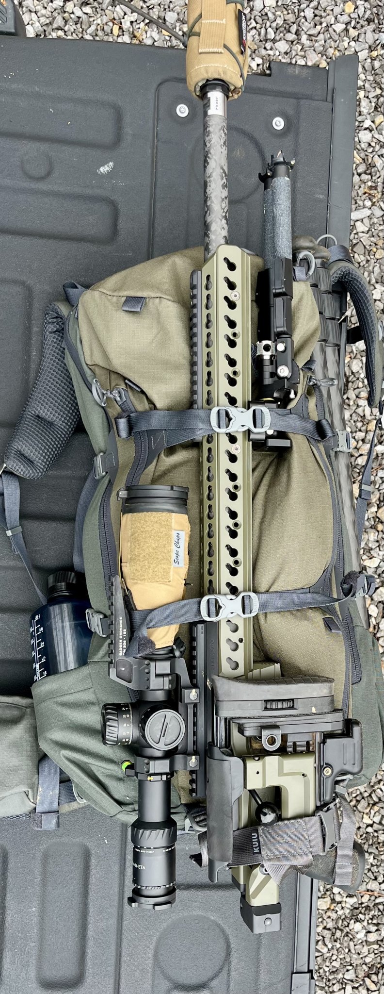

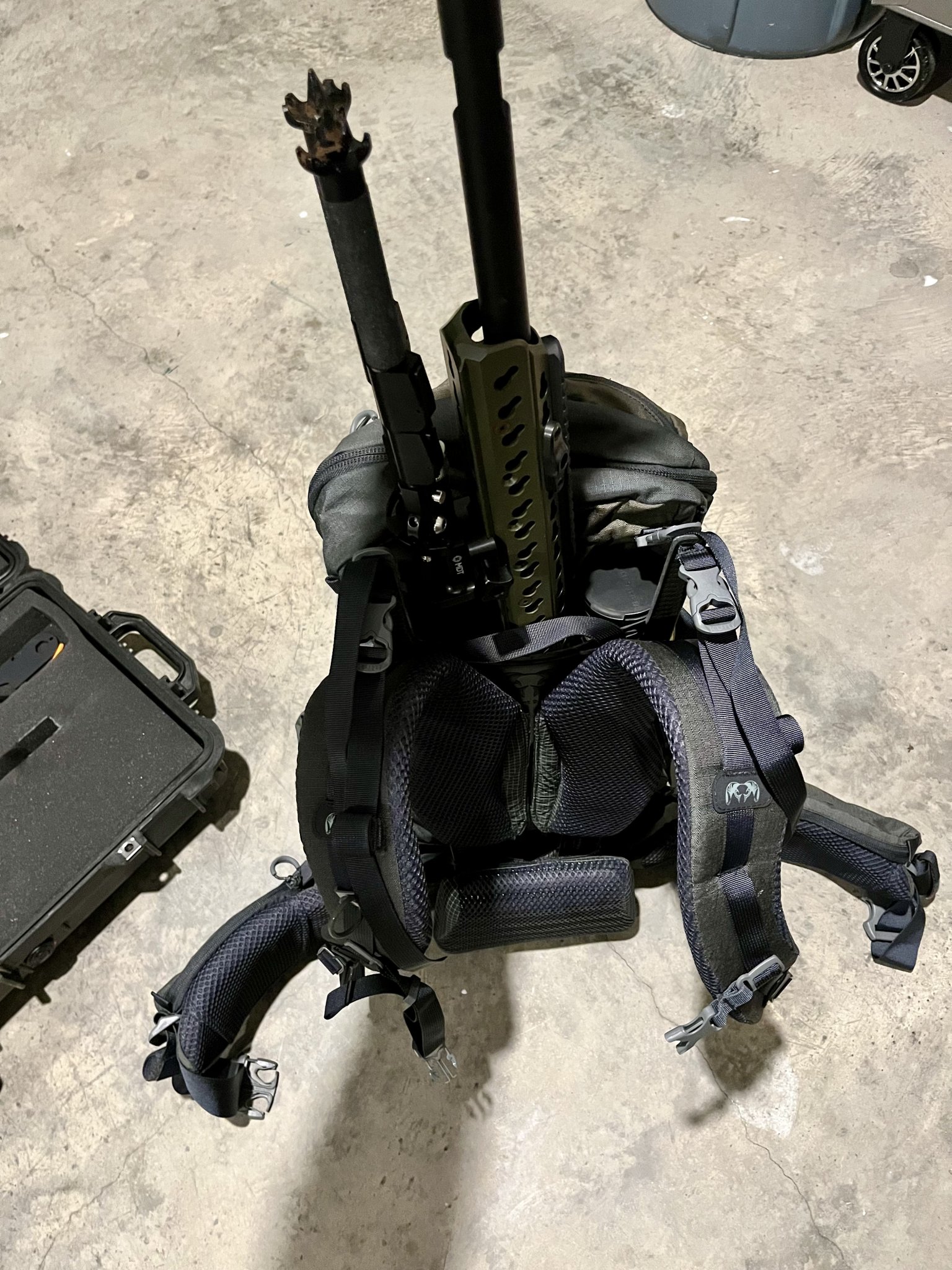

Anyone here running their AI in a pack folded & muzzle up? If so, what pack and how are you running it?
My AXSR with a 1.5” mount won’t fit in the GS2 scabbard folded & muzzle up. So looking for ideas. I snagged the new mission emod system from eberle so I was going to give that a whirl once the scope is back….but figured I’d ask around.

This one is for left-folding stocks (they make one for right folders too).Anyone here running their AI in a pack folded & muzzle up? If so, what pack and how are you running it?
