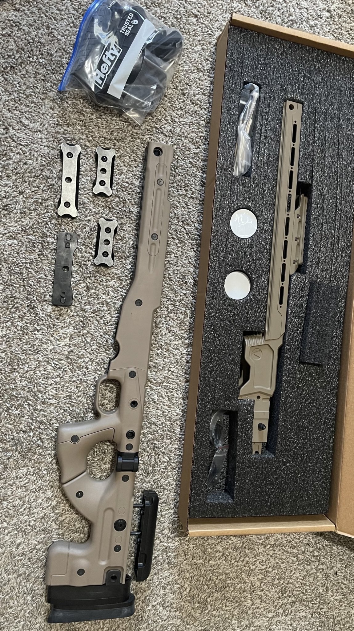

So you have an atx in an at chassis
Yup! I loved my at-x so much i decided to get an at-xc. Always liked the AT with thumbhole stocks so traded the atx chassis for this setup since i dont want an atx and a xc. My plan was to sell the vision forend and just have a complete AT but now i have it in hand the vision setup is nicer than i expected.

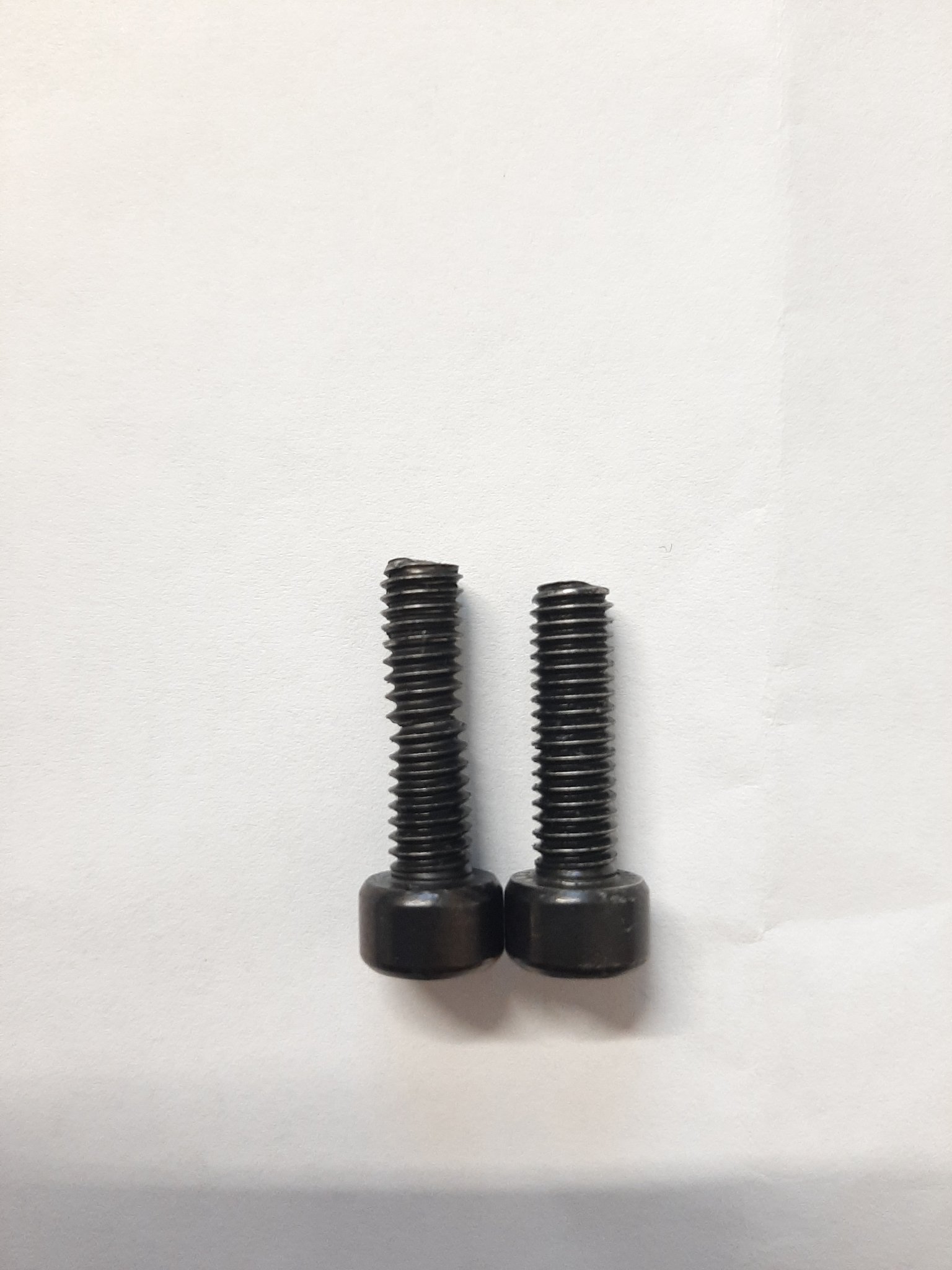

my AXSR forearm just came loose after a short ride in the sxs and 5 rounds of 300nm. oddly enough, 4 of 5 rounds were clustered in a sub 1/4MOA knot and the other was 1/2" away. i didn't notice til i was trying to get this 338U SR unstuck.
per manual, i tightened the two hex screws to 45 in/lbs. feels solid again, but how long til it comes loose again? are there more than just these 2?
are you guys putting loctite or something on these screws?

This is the kind of thing that makes me want to just stick with my AT’s. There’s just too many screws on these newer chassis for my liking.

Loctite on every screw would be my suggestion

Never had an issue with my forend loosening, and I put em to 35in/lb. The only bolt on mine that has come loose is the fuckin cheek riser bolt. Torqued down and witness marked. Still loose. Put a drop of blue loctite like 3,000rds ago (guesstimated without looking in the maintenance book) and zero issues with slippage.
Maybe a full clean/degreasing of the threads and bolts is needed? Try that. If still loosening, just pop a drop of blue loctite, pop some witness marks, and send it.

Just put more tq on it.
45in might work.
Rail came off once at a match, i just cranked till they stoped. Done

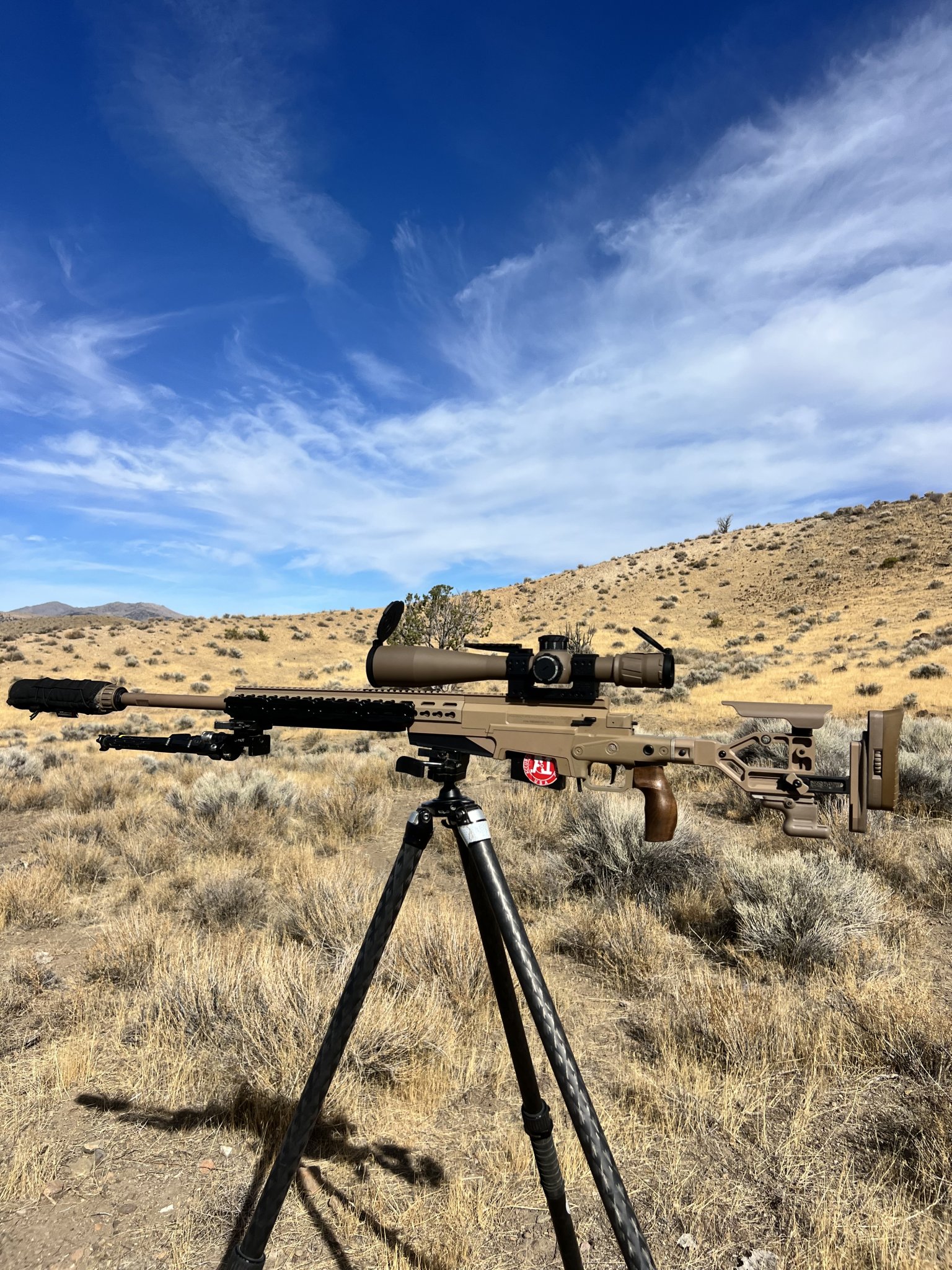

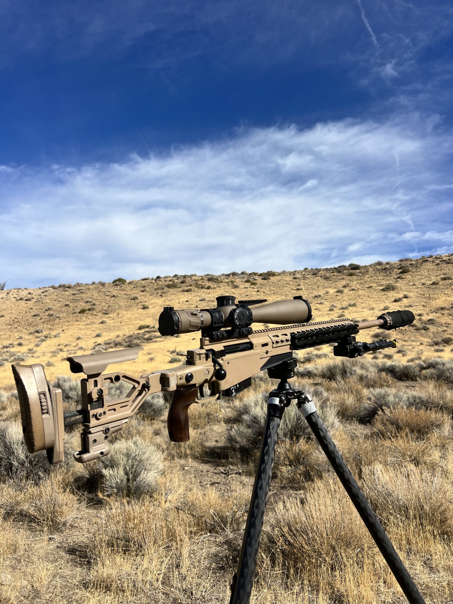

The AX is back to her original self. Spent a short stint in an atx chassis but I missed the old school classic look. Shooting tiny groups like always with the only 6.5 worth owning, 6.5x47L

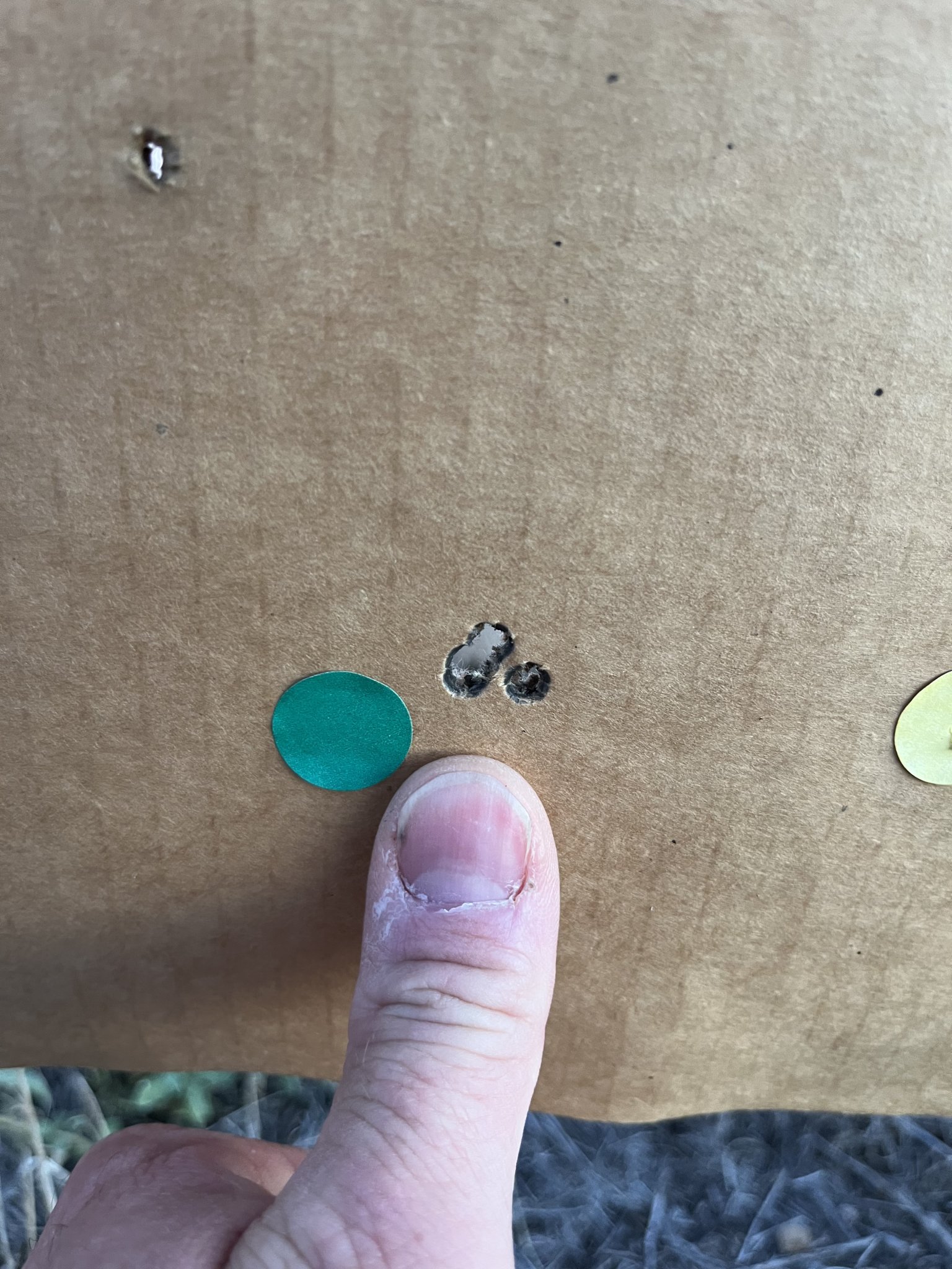

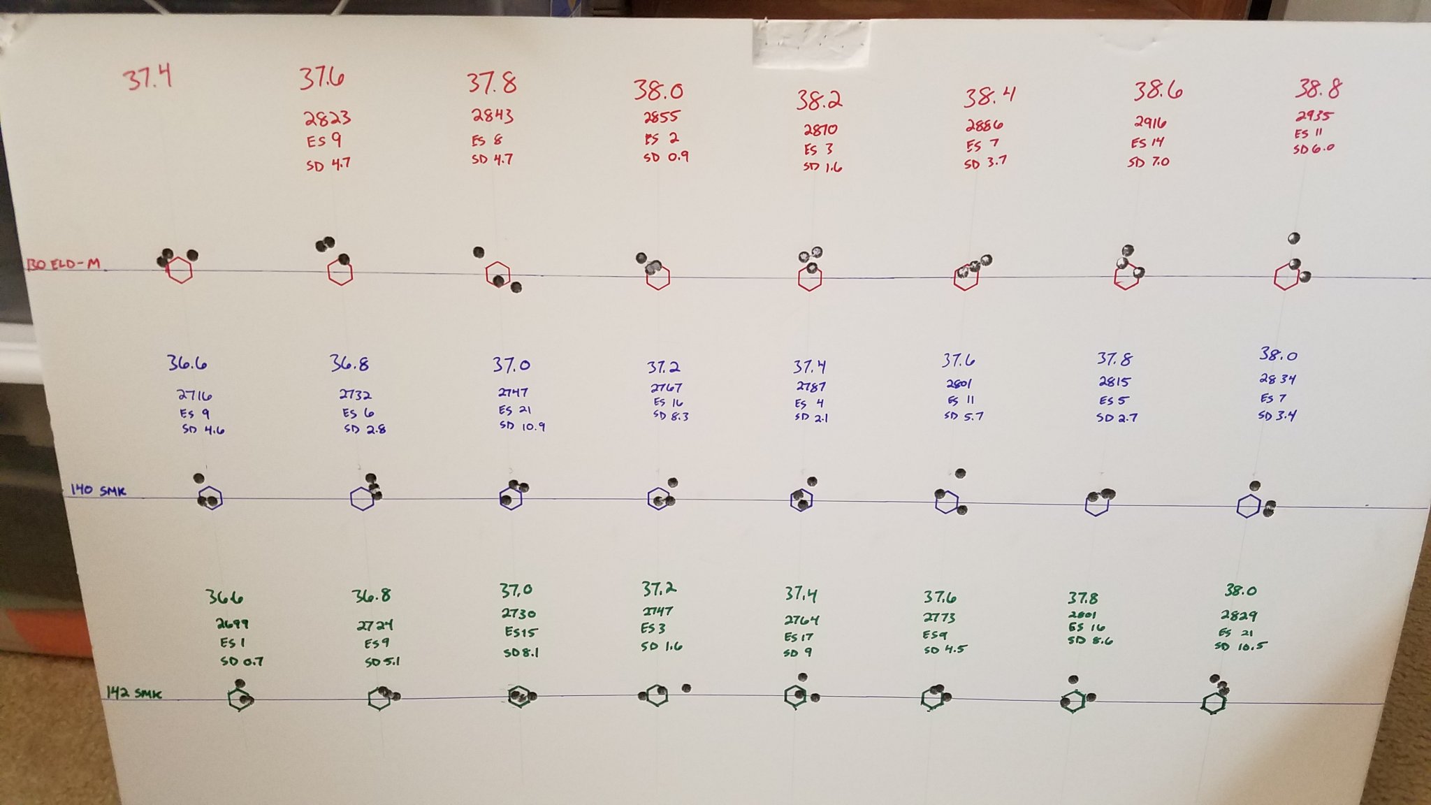

If it helps... this was with varget out of a 26" barrel (possibly 24, it's been a while). 130eldm, 140smk and 142smk. The 130 didn't hold together at 800 and I ran the 142smk at 36.8. Those targets are 1/2"

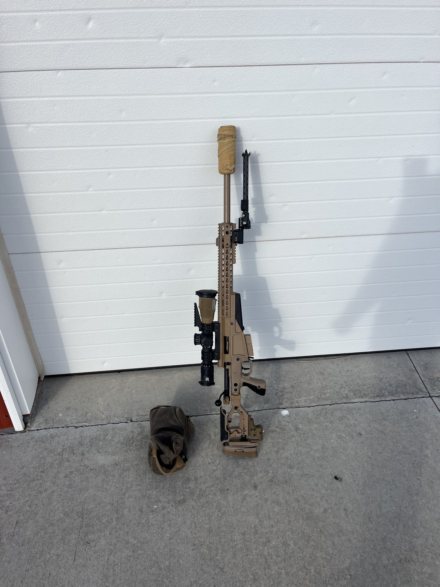

In case anyone is looking for a pale brown Cerakote color match this is what I came up with. (Grip section and trigger guard are home brew color)
H-199 ratio 13/32 about 40%
H-265 ratio 13/32 about 40%
H-187 ratio 6/32 about 18%
catalyst 15:1
My mixture was
13.5G of 199 and 265
6G of 187
Total of 33 plus 1.67G of catalyst.
Hope this helps someone as there’s no info on it out there.
