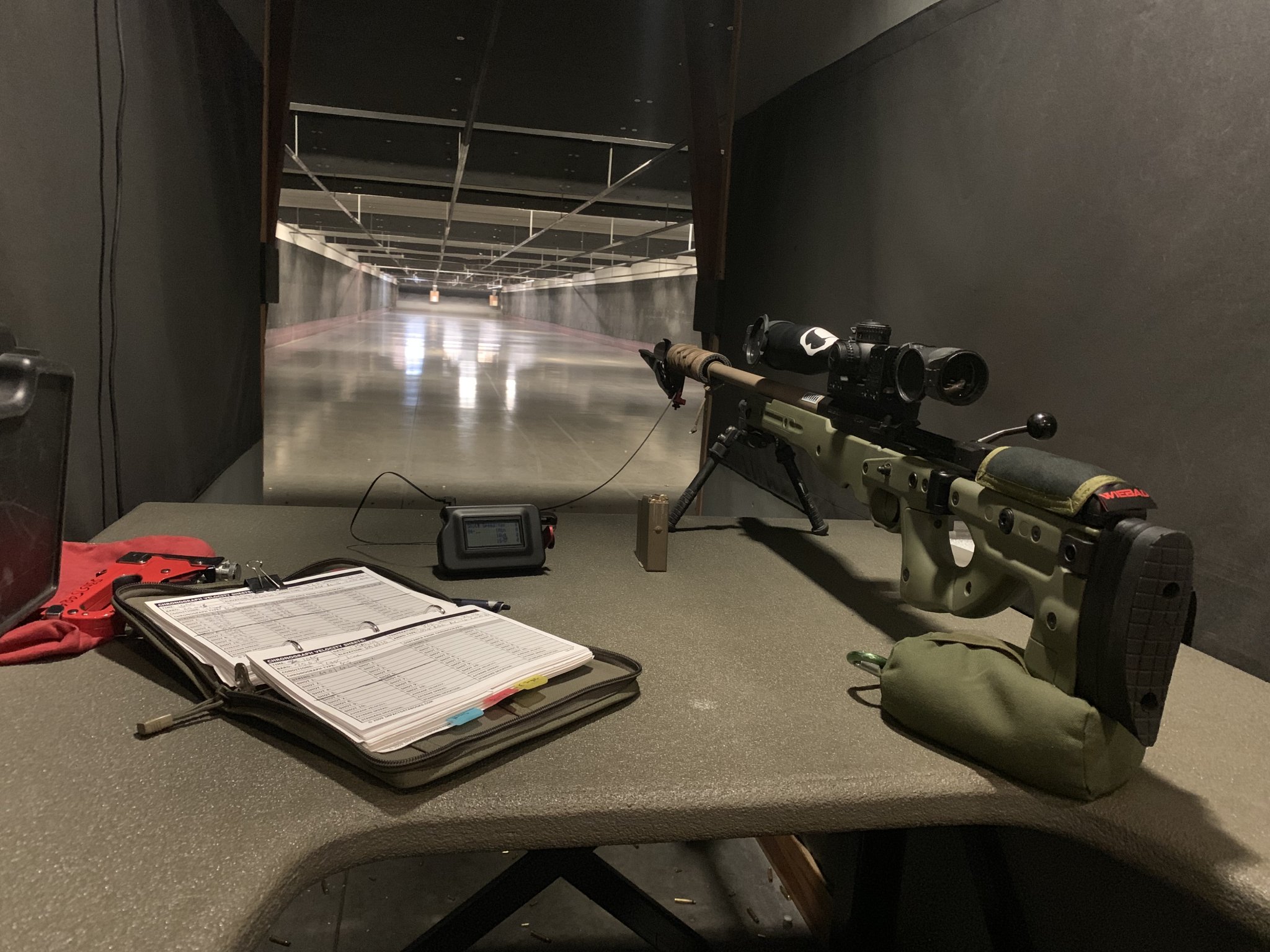

Finally joined the club! New AT from Mile High, new 6x47L barrel from Euro Optic. Asking the rifle some questions about what powder charge it likes before starting to tune for accuracy. Coming from a Tikka custom job this rifle is on a whole new level, shouldn't have waited so long.
The AT is a crazy value considering that most custom guns run around the same price or higher, Im trying to talk myself out of an AX and into an AT but the AX is sooo freaking sexy lol. Going to have to give Mike a call pretty soon and see how much I can spend ><

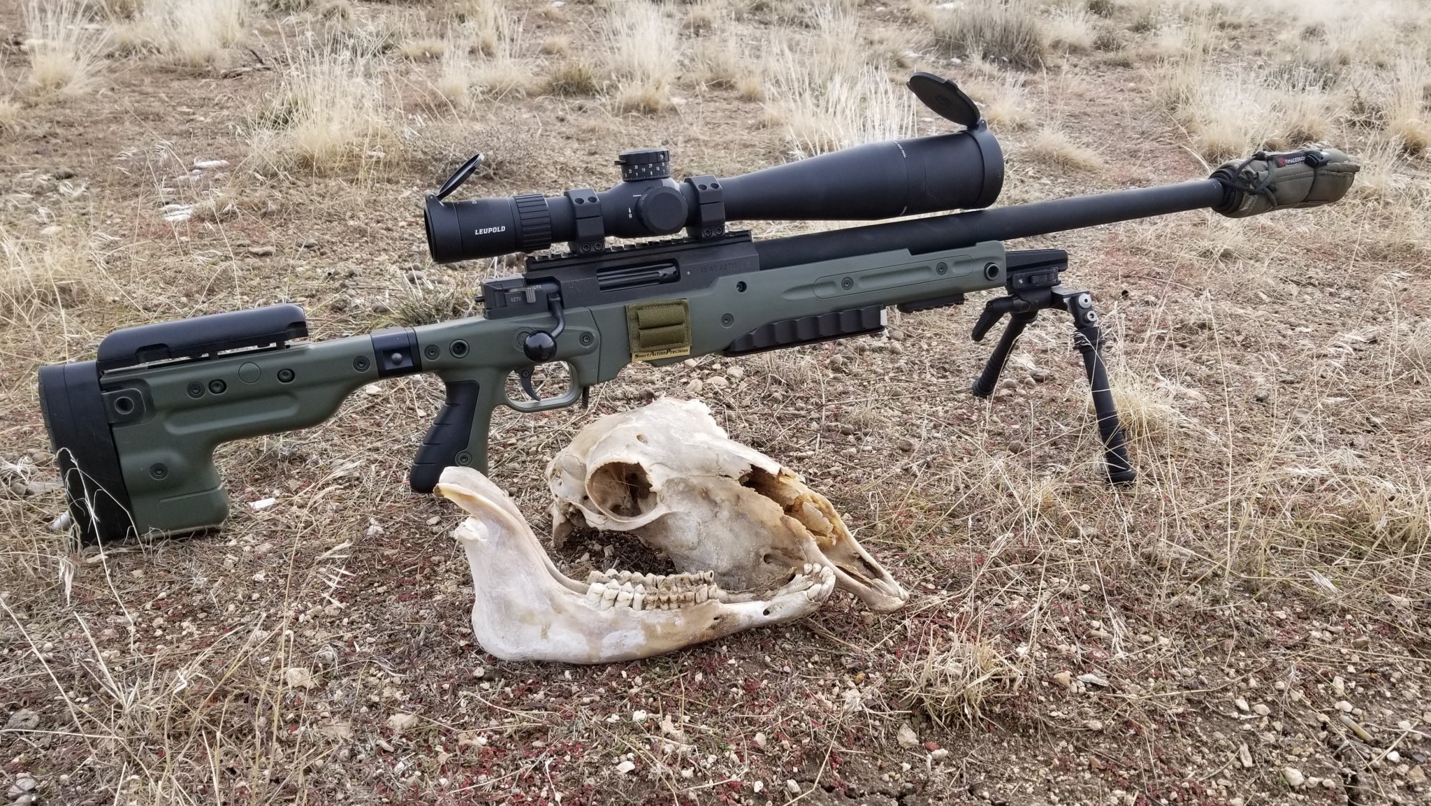

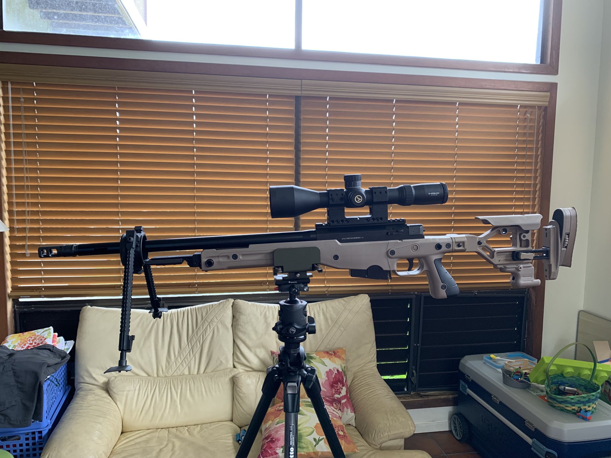

I recently joined the AI Club from over here in AUS. I've got an AI AT in 308 with a 20" 1:12 barrel. Just running some fire forming loads out to 500m yesterday. Running Sphur SR-4000 rings with a Bushnell Hdmr 2. Will be running this rifle in some local Precision Service Rifle comps this year.

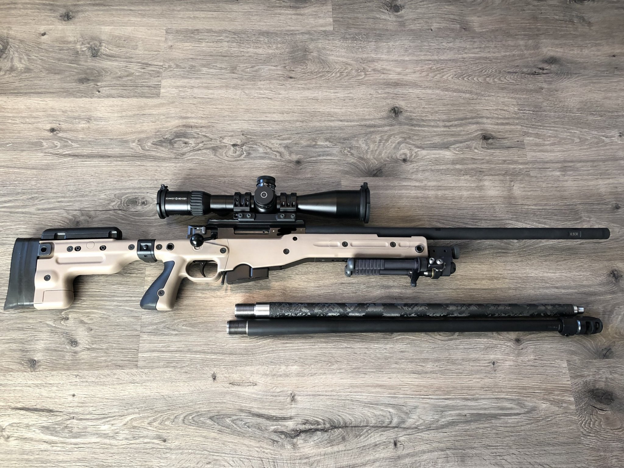

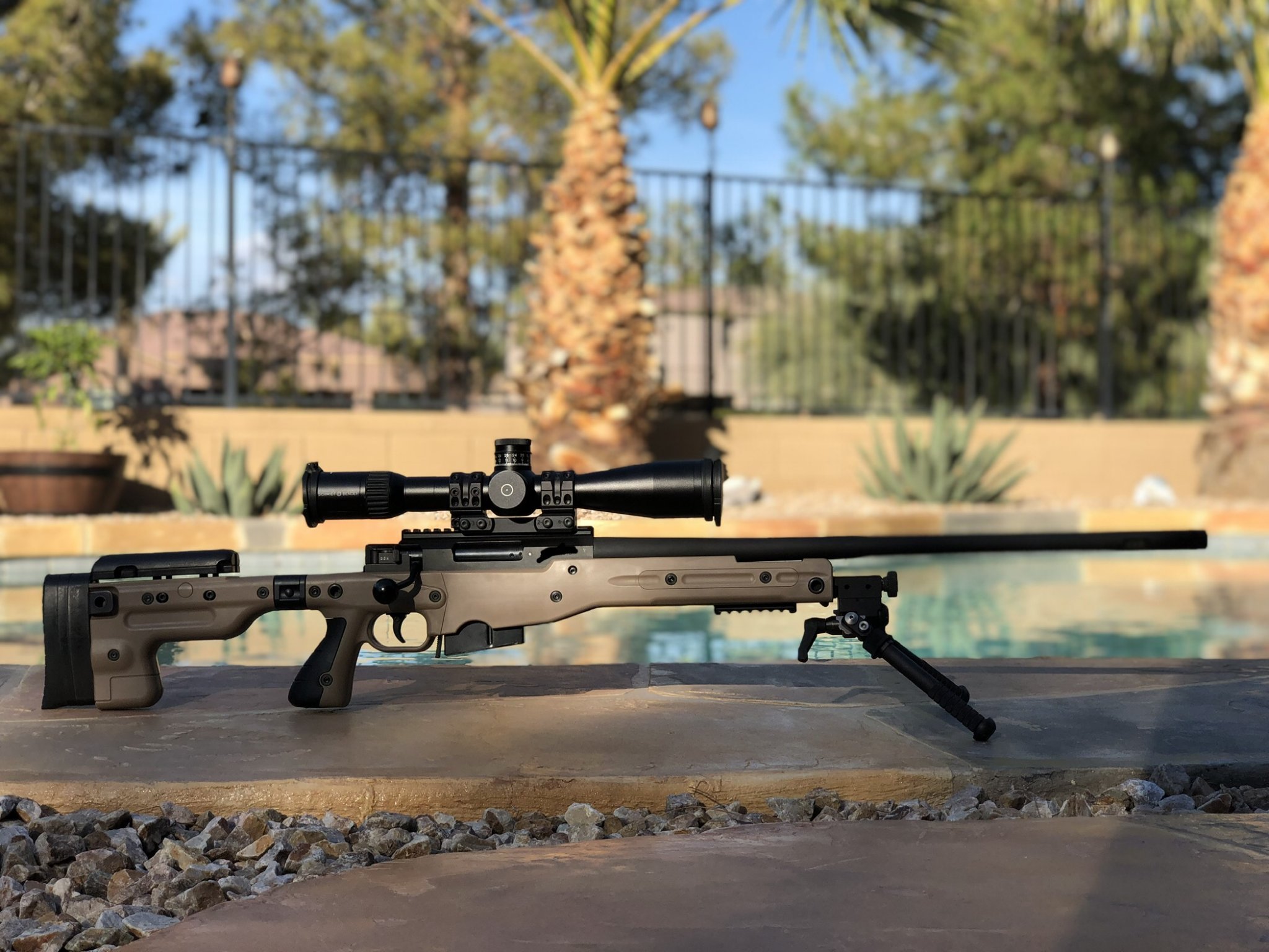

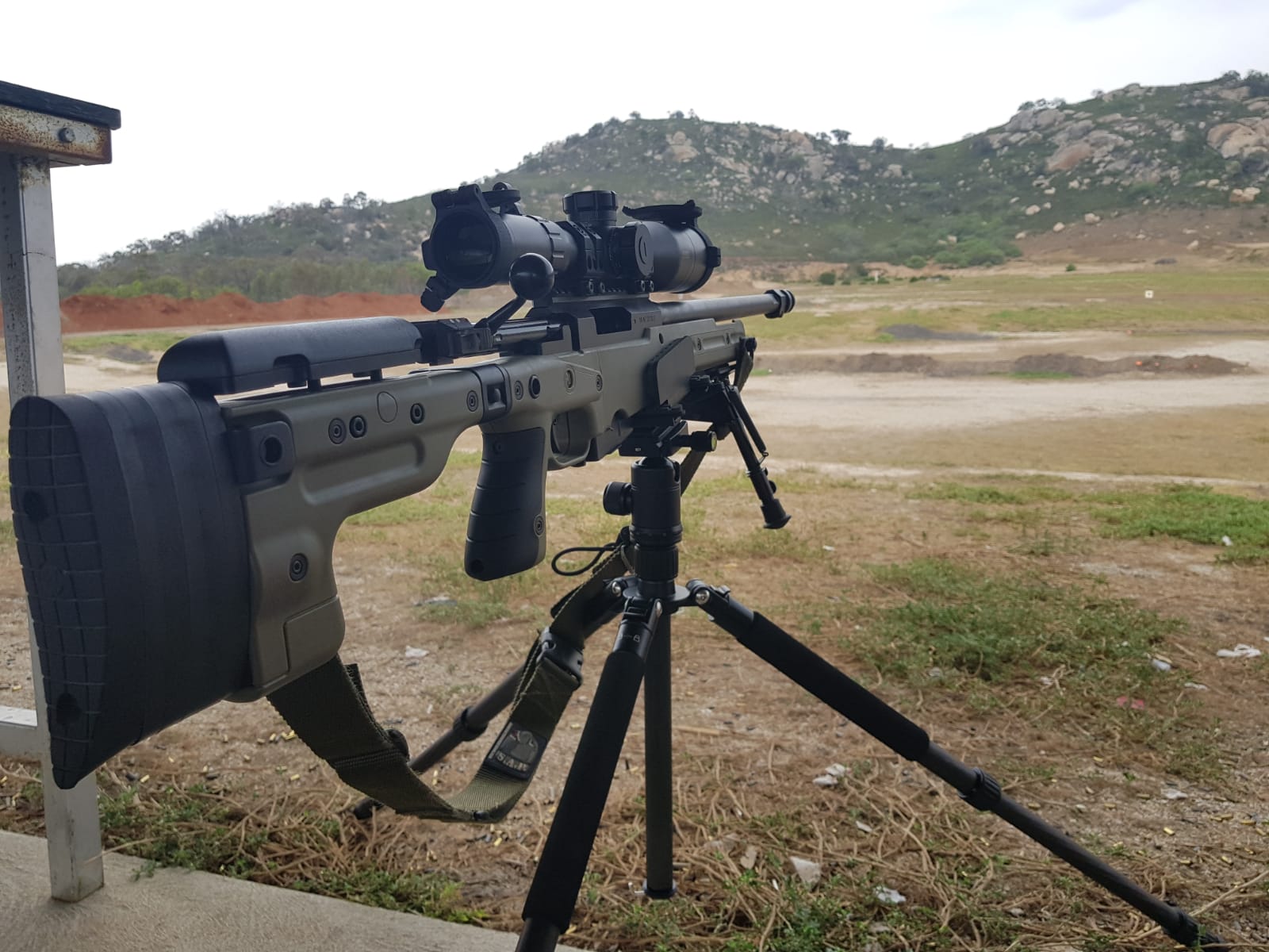

My AIAT. I’ve been wanting an AI for a long time, super excited. Thanks to all of you who took time to answer my questions in this thread. View attachment 7007668View attachment 7007667
Nice! What part of AZ are you in? I'd love to see how it handles with that Proof on there. I'm toying with the idea of getting a 20" .308 Proof and would love to give a Proof CF a test run!

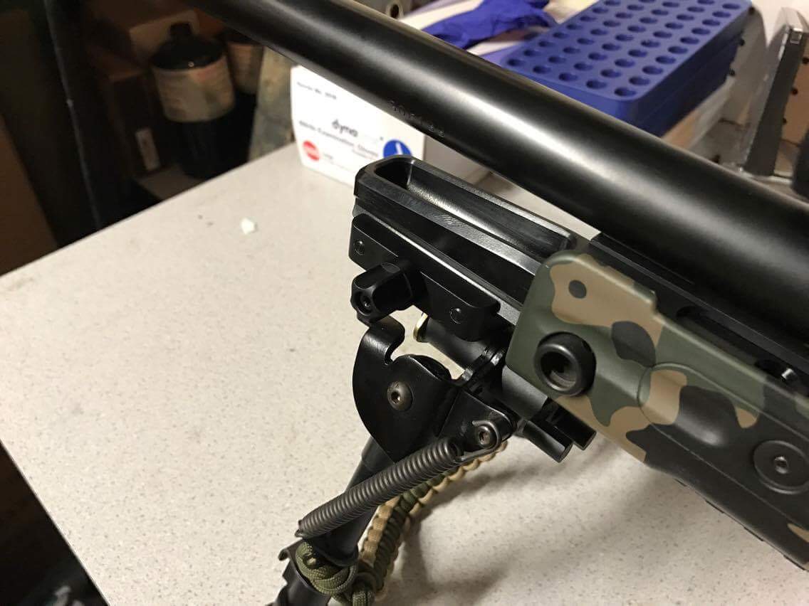

The only thing I ever managed to get to attach without any slop to the AT spigot was the Big Dog Steel picatinny rail, and I had to use a vice grip on the knob to hyper tighten it on there to accomplish it. My Atlas would come loose every single time I shot it, although I admittedly never took the vice grips to it, it might have worked, but I doubt it. The BDS rail had noticeably better lock up when hand tightened compared to the Atlas.

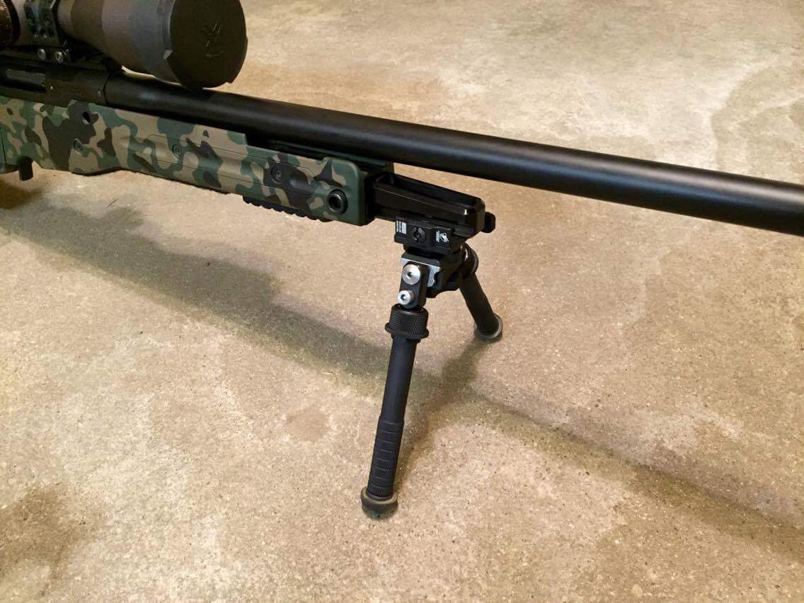

I’d like everyone’s opinions on the bipod Spigot, I can’t get it to lock up tight? Am I doing something wrong?
My BT19 locks up tight in the spigot if I mount it with the knob really loose. I have to make sure both washers on the BT19 are free. Then once it is clicked in place I tighten the knob down. The only slop I notice seems to be in the bipod itself. I’m running an Atlas PSR.
If I mount it with the knob just barely backed off then tighten the knob I sometimes will get slop between the chassis and bipod mount.
Before jamming it in, you need to undo the wheel at the front. Then be sure you depress the button on the bottom side of the stock....then JAMM it in. Screw the wheel tight and your off. Mine locks up crazy tight
