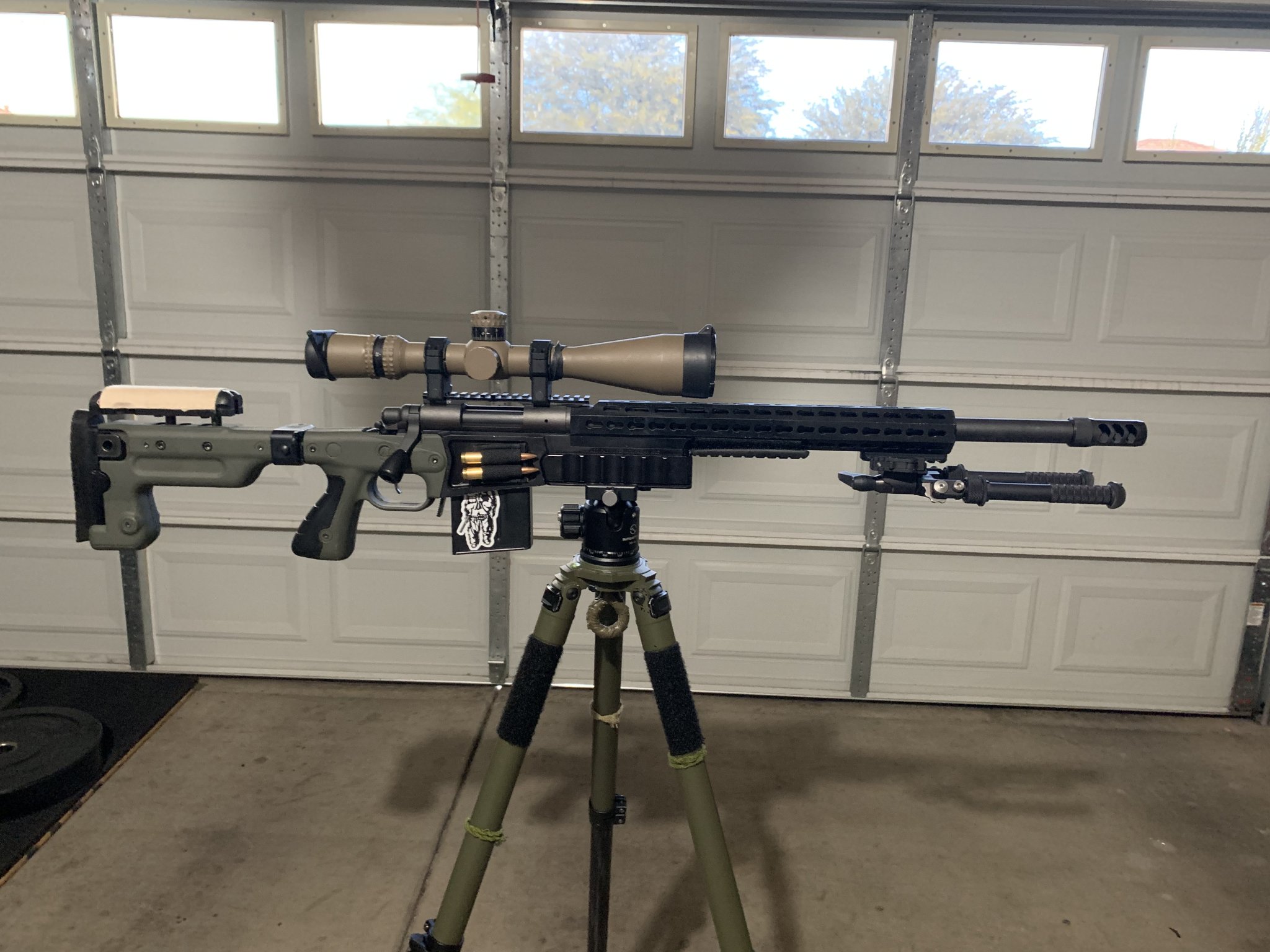

I need you to stop dunking on me by posting photos of your attached garage. I will never have one and it hurts my single feeling.View attachment 8587673
Just to appease ze poors.

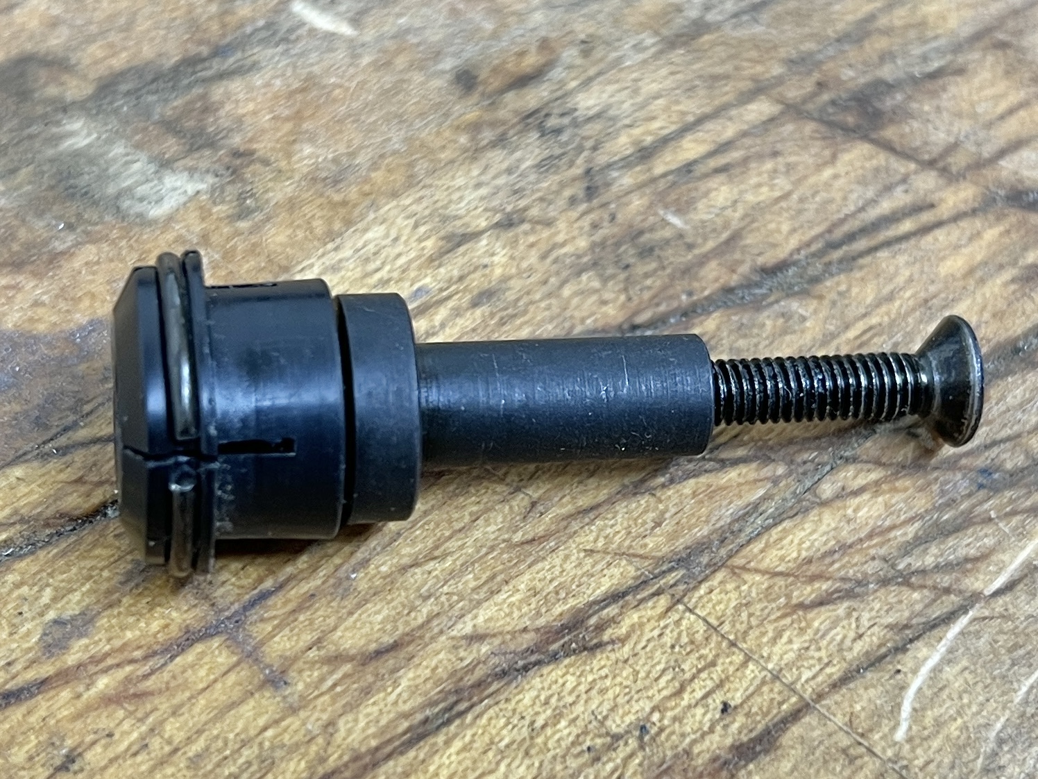

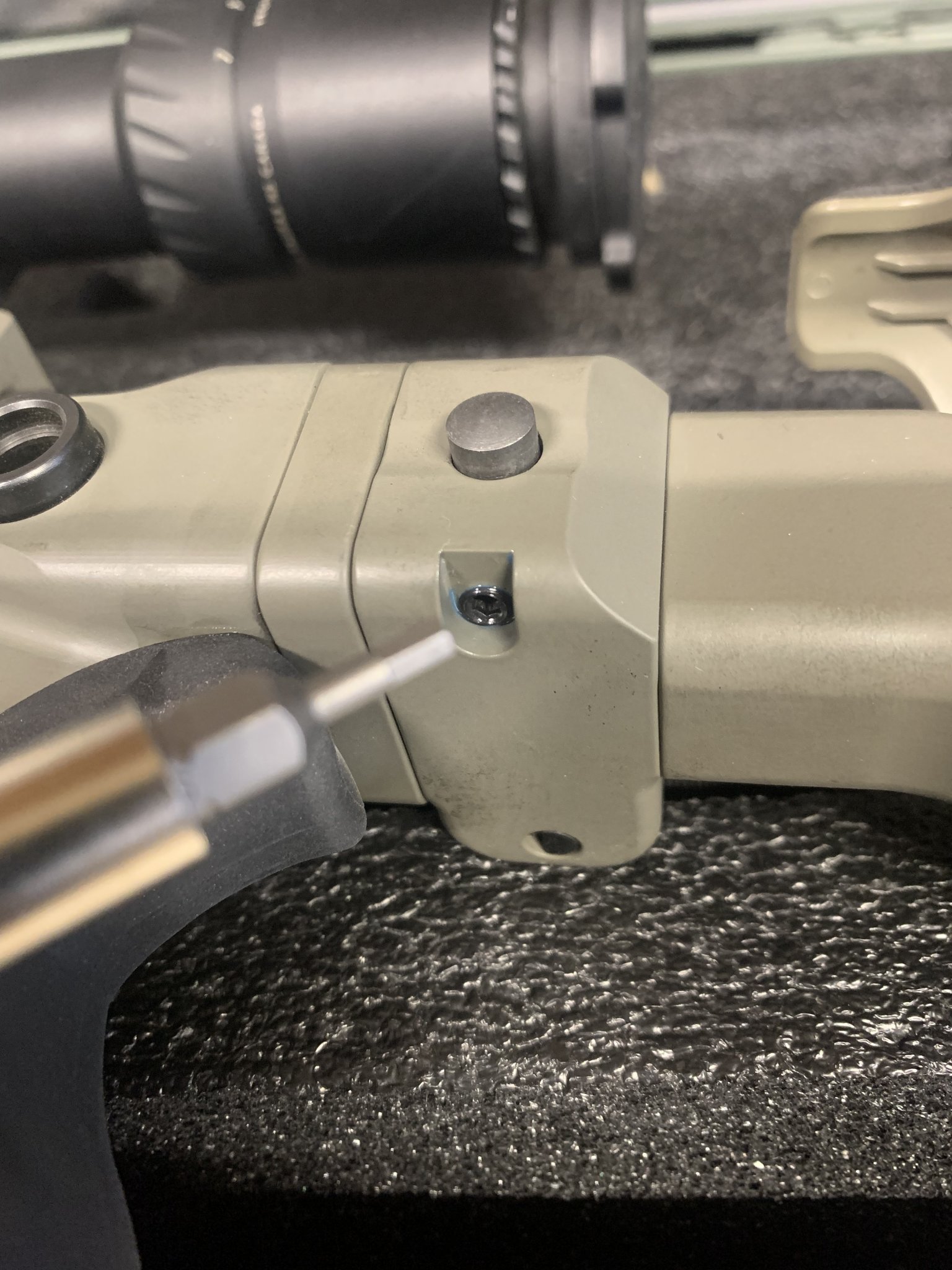

Anyone know where I can get these parts? Screw heads on both sides are boogered by the previous owner and I have OCD about this kind of stuff. It’s the folding stock/flush cup retainer and screws on an AX308. Not sure if the stock retainer side is supposed to come apart.
I called Mile High and who ever I talked to “wasn’t familiar with that rifle”. Also, I didn’t see the parts listed on Sporting Services site.
Yes, the whole thing would be easiest.Hey,
I will double check with gunsmiths. Do you need the whole set up?
Kent
Let me see if I can get the screw out of the catch side. If so, screws alone will solve my problem.Ok,
Here is what Andrew said:
We have everything but the actual plastic female catch.
26535
6821
25114
26243
3290
2477
Those are the part numbers for the complete assembly; it includes the flush cup that's missing from the photo above."
The 26243 is the only part we are missing and he is getting some ordered.
Now if you just want the screws I can get that done.
Let me know
Kent
