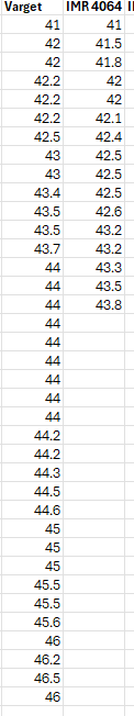

I recent looked at every thread I could find for loads in the 168gr range, IMR 4064 and Varget seems to shoot well for many people around 42gr.
I'd start be looking 41-45(maybe 46).
These are all the loads I found people using.

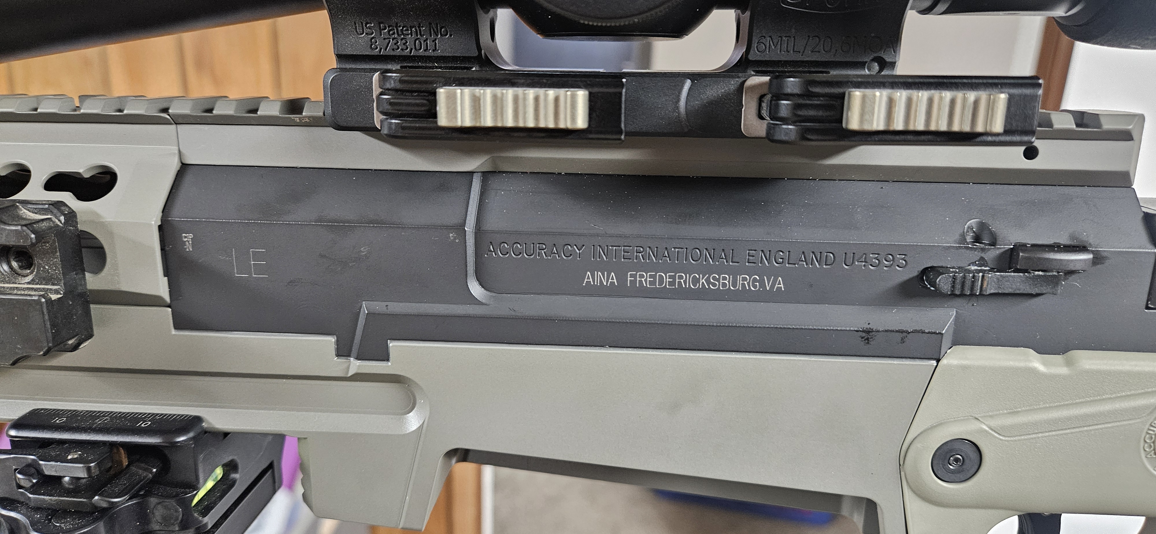

Thanks much. Wasn’t sure of the manufacturer.
The "BNP" is Birmingham Nitro Proof mark (UK not AL)
the "CIP N" means that the proof testing complied with the CIP Normal standard
The Crossed swords and B are for Birmingham proof house (there's another one in London)
The 24 is for 2024 year
the X is the ID mark for the person that did the proof test..

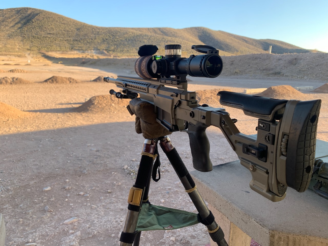

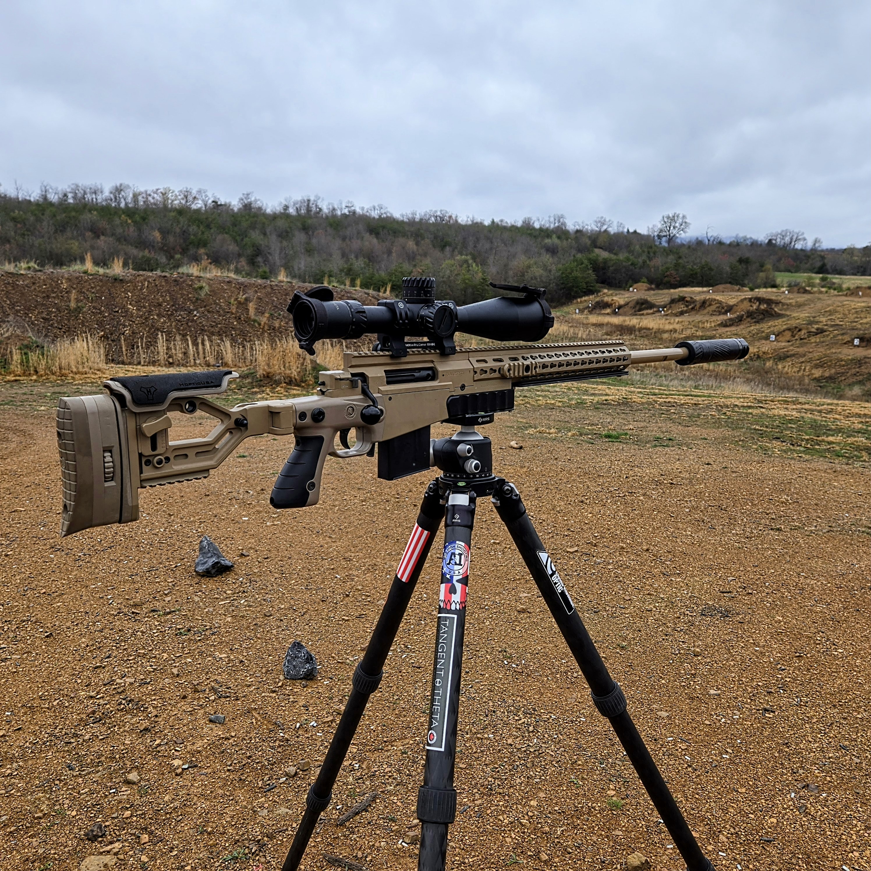

I'm picking up a 15 model PB AT this weekend and I'm wanting to add the NV bridge, but I'm wanting to make sure I can run the bridge with a 16.5" barrel and suppressor. Also, from my reading I'm seeing I need the high rail in order to line up with the nv rail, is that correct? The one I'm buying has the low rail installed. Obligatory pic of my hopefully new to me AT.
Yes the high rail for the NV mount
Reactions: CStroud
Yes you will need the high rail. I don't have a bridge but here is a 16.5 with suppressor. I believe it should be fine.

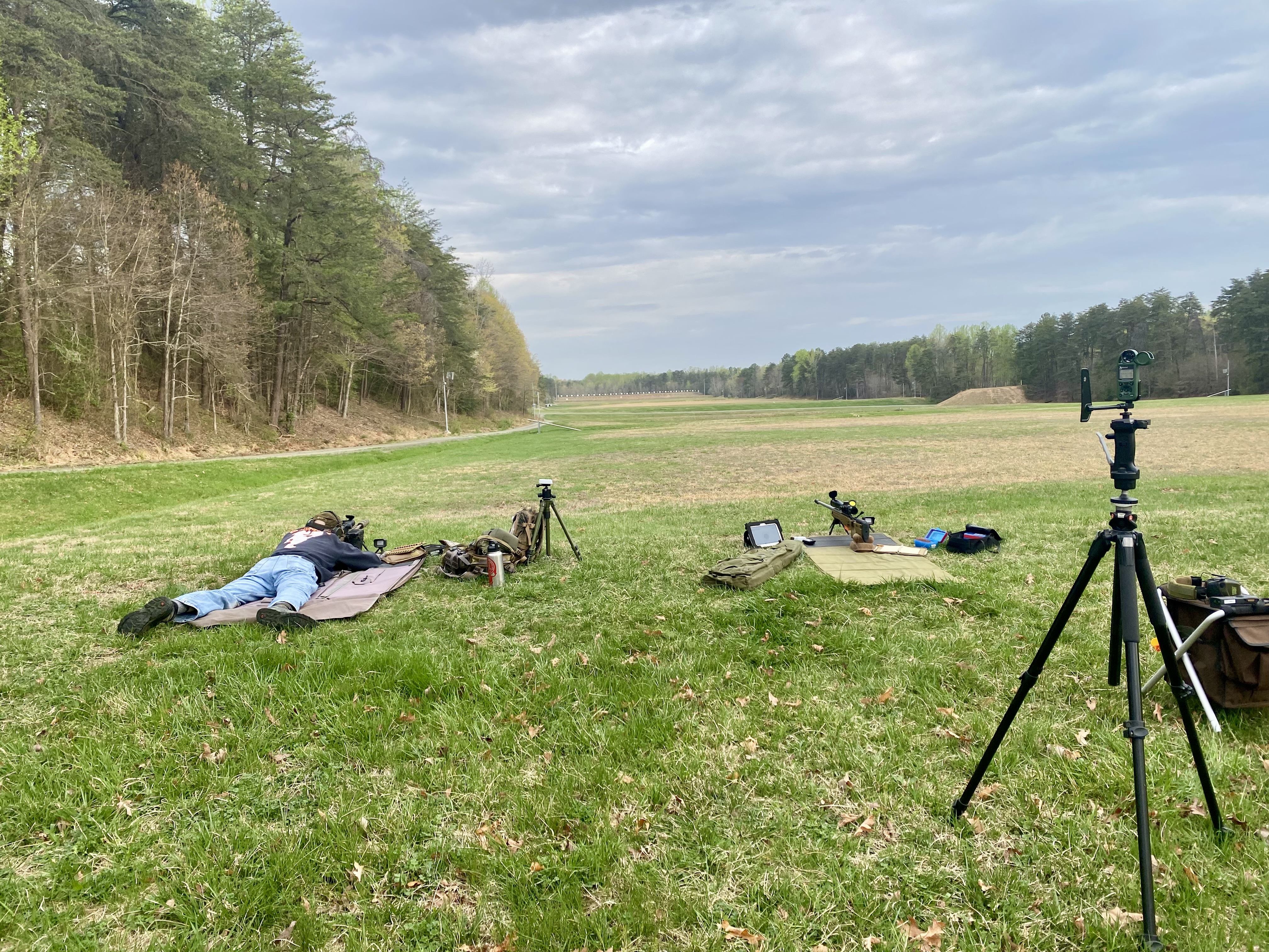

I’ll throw a tape on mine quick for you and edit this on the barrel length
Measured my 20” barrel on my other AT to make sure I put the tape in the correct spot. The tape shows about 13.5” to end of the bridge which is about the same spot the spigot ends
Here’s also an 18” barrel for reference
16.5” wouldn’t be an issue
I ran that setup on my AT-LE for a while, you'll be fine.

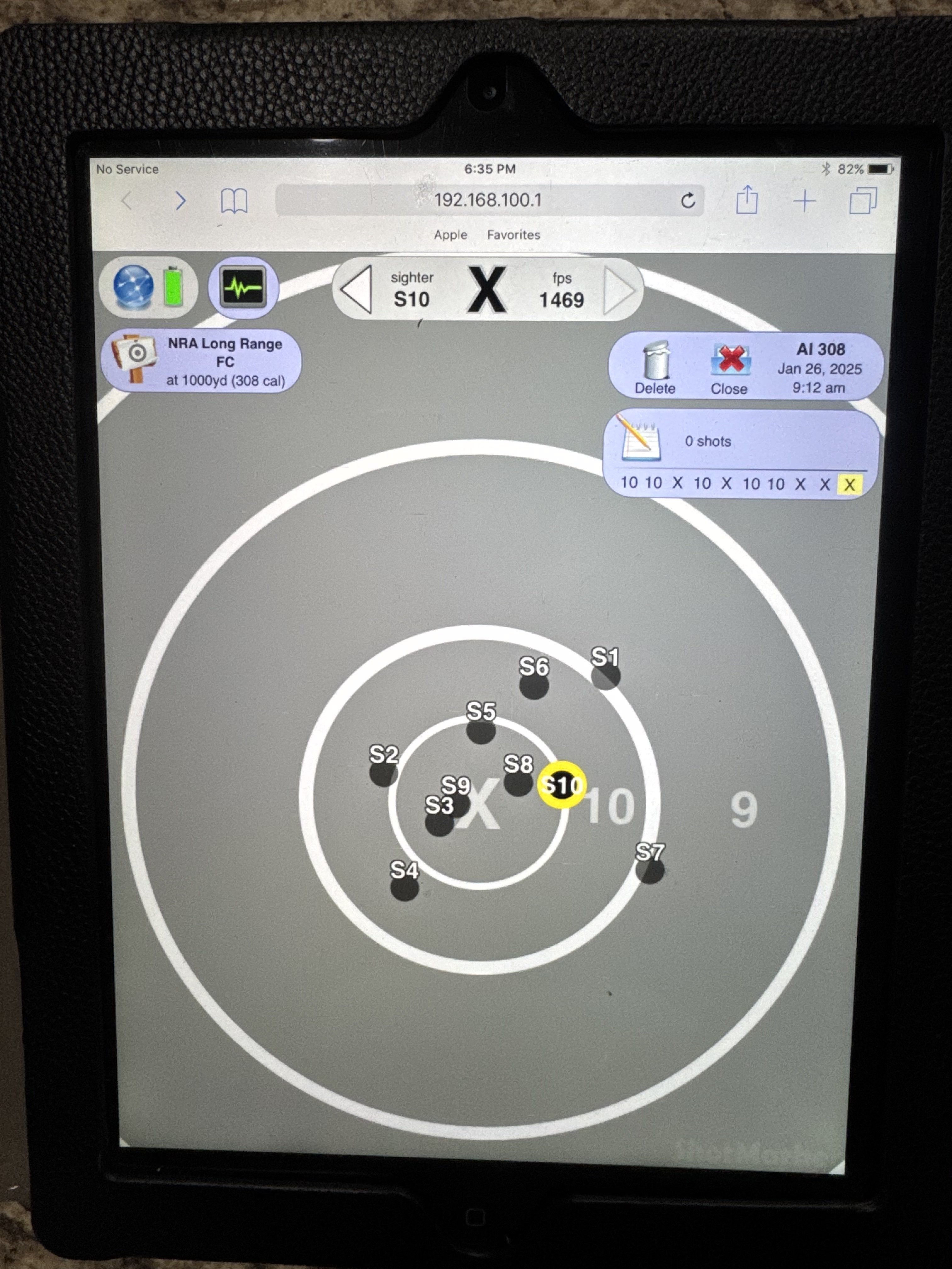

Ok, little report for the load dev for the Ai 20" barrel.
Loading off the lands 0.05 with some twice shot and annealed Lapua brass, 175 Berger OTMs and 44gr of varget seems to do the magic. Getting 2650fps at 77deg, and a Stand Dev of 14.5, the accuracy is very nice.
I tried a 42gr load, it was not nearly as promising. The 44gr of varget does the job.

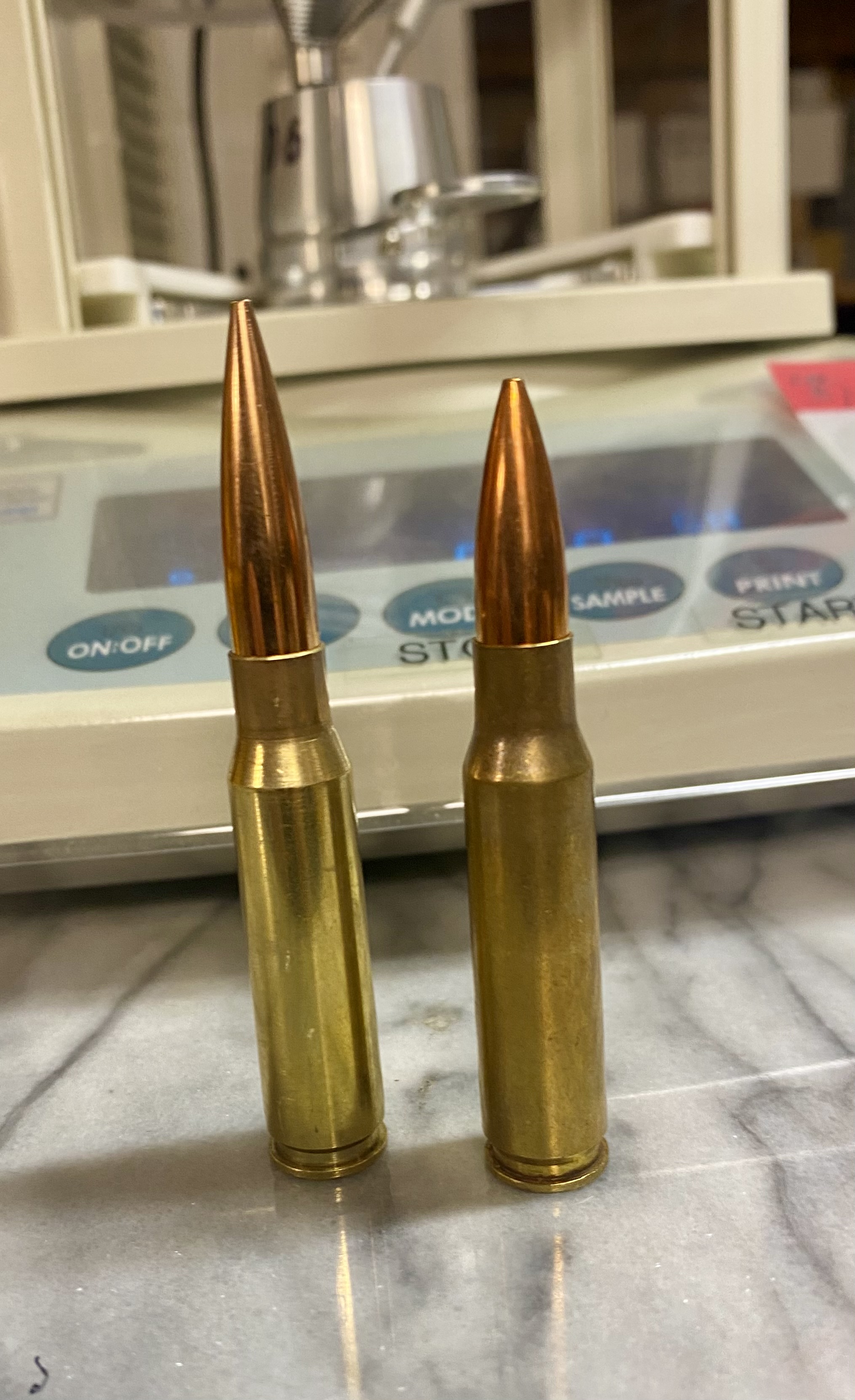

I’ve been running 44.1gr of Varget in LCLR cases with 210M primers with a COAL of 2.840 for 175SMK in my 24” 10 twist Bartlien factory AI barrel.
They run about 2750FPS or so @ 325’ ASL and are about 10 MRAD to 1K. (Right)
On the left is the 200gr 20X load I run in my 308 transgender AI. Runs about 2610FPS or 9.5 MRAD to 1K. COAL is 3.12. Lapua Palma/N150/205. Chamber has .170 free bore.
Bugholes is spinning me up a Brux 10 twist 30in heavy palma AT barrel with the same chamber for the 200 20X.
I figure they’ll be okay to load thru the port, but I’ll be fucked and probably have to fold the butt and pull the bolt if I ever have to eject a loaded round.
