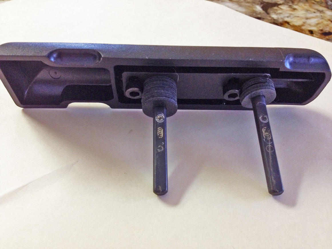

Necro solution...
Go to Home Depot hardware section. Buy the 1/4" neoprene washers; they're like $.48 for a package of 4. Stack as many as you need on the cheek rest prongs for the height you want,1/16" at time. Instant index.
