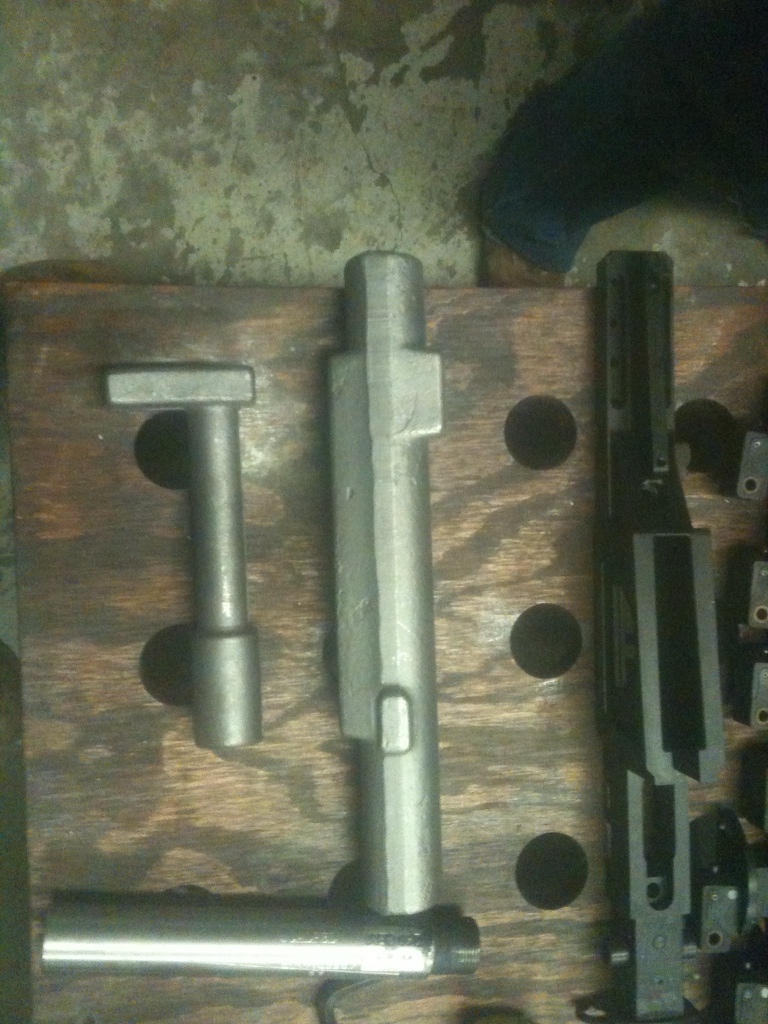

Surgeon uses a cast bolt with a stock rem 700 extractor (not that they are bad but there are better alternatives out there), plus add the fact that the bolt isn't timed correctly to the action (it doesn't cam properly for extraction). The Defiance is solid billet machined bolt, uses a mini-16 extractor and is timed for extraction, all improvements in my opinion.
That sure looks like a forged bolt to me. That is a surgeon action and bolt before machining. My cousin is a machinist as surgeon. Took this pic when he gave me a tour.
Sent from NSA wire tapped device.
The Remington extractor is less prone to failure than most if not all of it's replacements and maintains the integrity of the gas sealing. Never had one fail and all the 'improved" ones have failed me. That is one more positive for a Surgeon. I cannot speak to bolt timing. Mine simply work.
