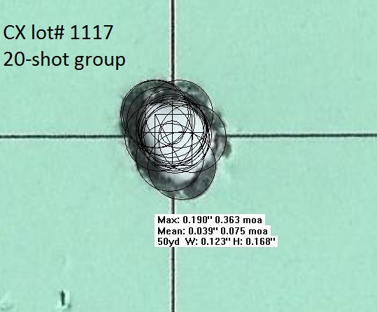

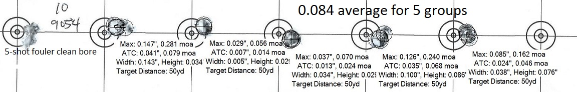

Tell me is this proof of accuracy or a waste of ammo. 50 shots at 100yds. or is these 25 shots at 50yds. or maybe 20 shots at 50yds.
Lee

Throw me a little bait and I'll bite every time! Waste of ammo as far as I'm concerned. I would rather see 25 individual shots at lets say a ARA factory class target at 100. and 25 shots at a ARA unlimited target at 50.
Yes I do too.
Lee
