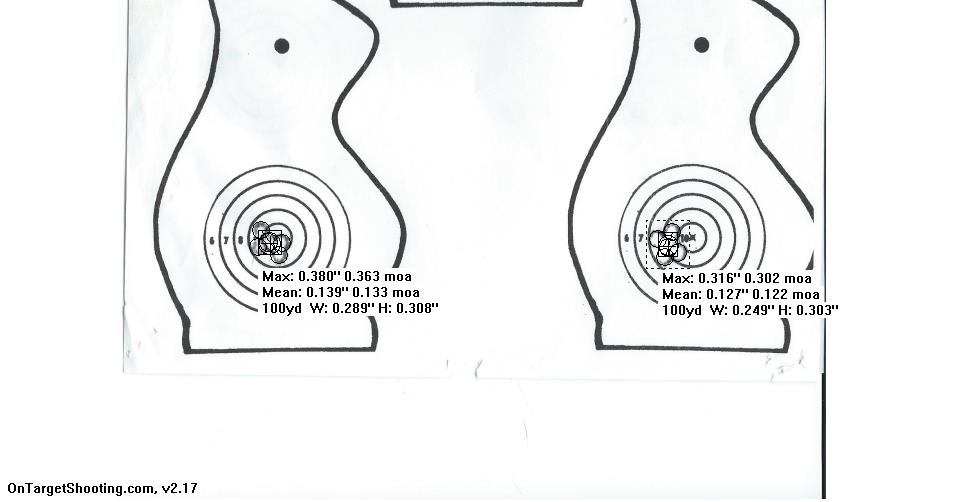

Thats pretty good. here is mine but only 20-shots. here is something most don't do try shooting groups with different lots. 5 10-shot groups shot with 5 different lots.
Lee

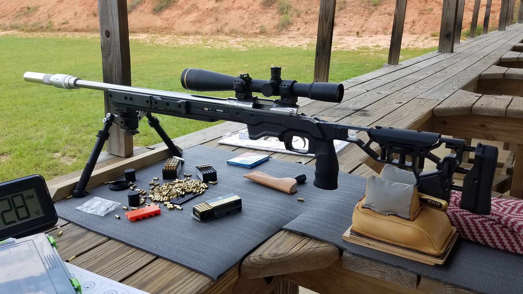

Edit: Forgot to post a pic of the trainer:
The only CZ 457 part is the action. The barrel is a Lilja match 23-inch barrel.
