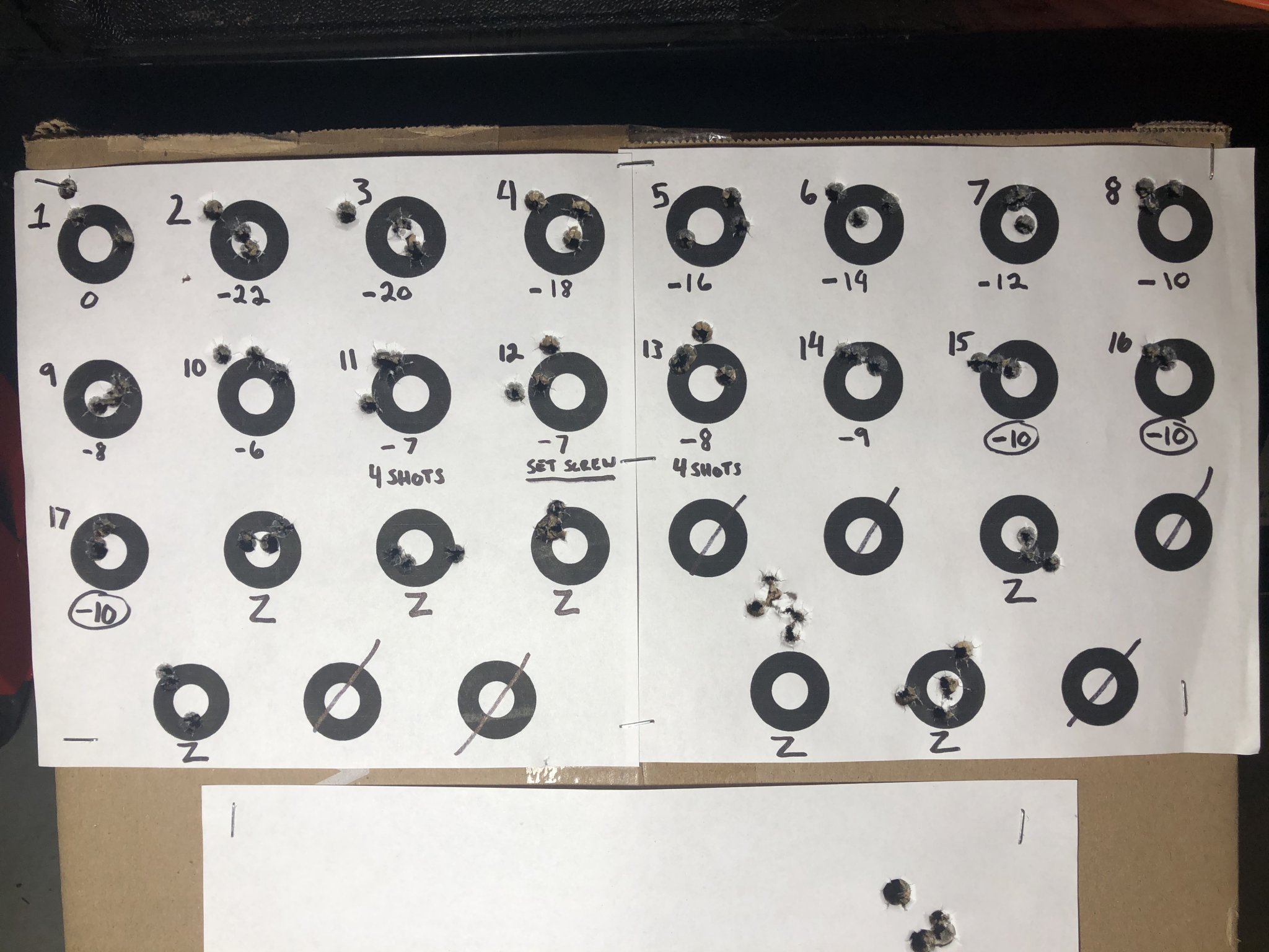

Thought I’d share my results.
I bought this because I have access to factory ammo that I would shoot in a pinch. Also liked the idea of finding a node, keeping it, and fine tuning the tuner instead of seating depth.
Here’s my results:
How to read the target:
-top left number is target number
-bottom number is indicated hash mark starting from just off flush
- targets with / weren’t used and Z we’re just zero confwith mine and other rifles.
-all targets have 3 shots except 11 and 13, which I know I made a bad shot and just put an extra one down to confirm
Started just off flush as instructions said, and started to dial 2 hash marks at a time. I chose to do 3 shot groups because I felt like 2 wouldn’t tell the whole truth.
You can clearly see the groups start tightening up as I get closer to what I found worked (-10) and then start widening once I went out of the sweet spot (-6). So I started dialing back in single hash increments and thought I had found it at -7. I shot 4 to confirm because I knew I had pulled a bad shot causing that flyer on target 11. However, I decided to double check the set screw and found it had loosened up quite a bit. My error. So I tightened it back down, went to confirm and it was opening back up. Which made sense because as you can see on the target the sweet spot in right around -10 to -12.
So I started going back in single increments to -10 and found it tightened right back up. Made sure set screw was screwed on good this time, then shot two more confirmations(16,17).
To me, it really does work. And since I plan on switching between ammo, I’m hoping to have these settings marked down for each one so I can make those changes quick, confirm, and be ready to shoot.

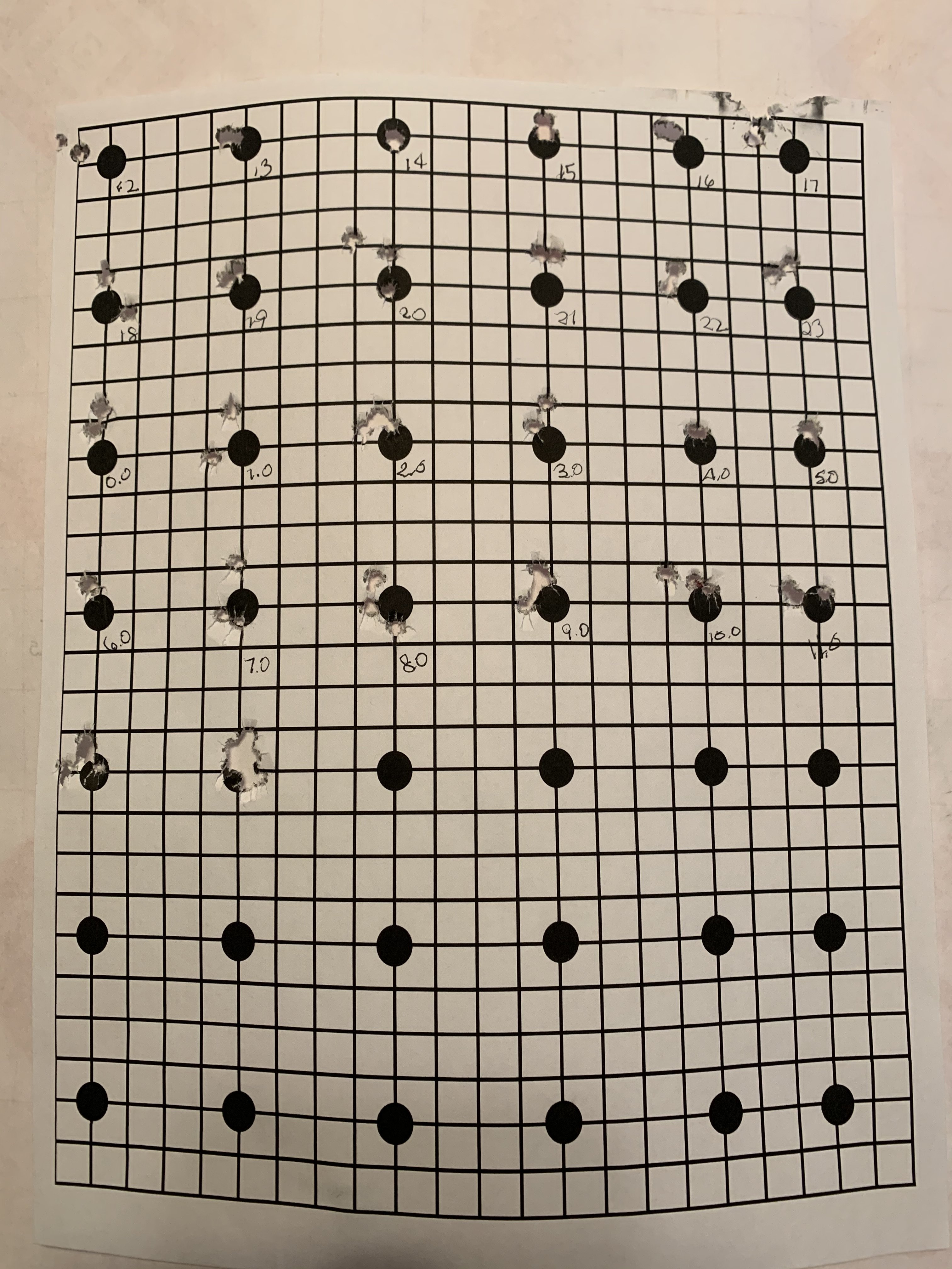

Got an ATS tuner last year from Aaron Hipp, and he was most helpful. Mounted it on an MPA BA comp rifle in 6.5 CM with the big MPA DN3 brake. Developed two optimized loads that shot under 0.25” when done. First found the powder charge in one case where the speed curve is mostly flat as powder goes up, and it was about 0.4 gn wide for RL-16. Wished for more, but that was it.
Developed the 135 A-tip load with RL-16 and did a 142 SMK load with IMR4350, without adjusting seating depth at all. Both were kept at book length of 2.810”. It went as quickly as adjusting seating depth at the range with an arbor press and an LE Wilson seating die, but was far more convenient, not having to drag all that equipment with you. And i guess most folks don’t own this type of BR gear. Took 30-35 rounds each playing with the tuner. Another 10-12 to find max pressure, then 30-50 to find the flat spot in the speed curve. Total round count probably in the 70-100 range. Similar to a traditional tuning approach via seating depth.
The idea is not to “shoot groups” (that takes too many rounds of ammo and takes too long), but to shoot only 2 shots per tuner setting, then increment by 2 (or 3) at a time (which is a lot), expecting the impacts to be quite far apart, like 1-1.5” indicating that you are getting the opposite of positive compensation. I used the black and yellow Shoot’n’See targets to clearly see my impacts at 100.
Dispersion might get (much) worse before it gets better, this happens about 50% of the time and then more rounds are expended. Or you might be lucky and every move is an improvement, with less rounds fired. If a flier is called (before peaking) then repeat the shot and ignore the flier.
Keep turning the tuner in the same direction in fairly large increments (like 2), shooting two shots every time until you see two or three fairly small adjacent “groups”, something approaching the potential of the rifle and the shooter. It should form a pattern. Sometimes a slanted vertical group will transition into a nice tight round group when you move the tuner a small amount, and then become an elongated horizontal group before opening up with a 0.5 increment.
This is the main point: A single “good” result surrounded by multiple bad results can be ignored, or shoot one more round at that setting and you will likely see a more realistic result (a larger group), indicating that the “good” 2 shot group was just luck. [We all know that 2 shot “groups” are not statistically representative of anything.]
Now investigate the good region in smaller increments of 1. Start over 1 before the first good-ish result and keep going until 1 after the last good one. I like to do 3 shot groups at this point, but some will use 2. Probably only 5 groups total, so 15 rounds. You will almost certainly find that there is a decreasing pattern followed by an increasing pattern, with a clear minimum somewhere in the middle.
If you don’t see a discernible decreasing/increasing pattern when you repeat in smaller increments, then something else is going wrong. You need to be on your best form, so try to shoot on a quiet day far away from others. Also you are breaking position every 2 shots to make an adjustment and this can cause problems too.
I picked the 142 SMK and the 40.0 gn of IMR4350 at book COAL to see if i could get a random load approximating a factory round to shoot well. It worked and returned a group size around 0.25-0.3”. I am pretty confident the tuner will work with factory ammo.
For the weight sorted A-tips i did first look for a wide flat spot in the speed vs powder charge curve, and found one. Then set COAL at mag length, and then used the tuner to optimize group size. All loaded on an FX120 after AMP annealing, Whidden non-bushing die with the button selected for light neck tension (about 1.5 thou), seating force was checked during seating operation, bad rounds were set aside, also weight sorted primers. Yes i was in full OCD mode. Worked remarkably well, with four sequential 3 shot groups below 0.1” in a low wind situation. [And yes i realize some folks will call BS on that last statement. Oh well. Best groups i ever got out of this rifle.]
Today loaded another 135 Atip batch, and when Houston comes out of its -28 F arctic freeze event, i will go try it again. We shall see how temp sensitive RL-16 is and if the tuner can recover the prior group size.
Btw: The chassis rifle has a Curtis Axiom action and a heavy straight taper 26” bull barrel and is generally accurate with almost any ammo, Berger and Hornady 140’s Match ammo deliver 0.35-0.4” five shot groups. Hand loads routinely do 0.25-0.35”.
Here’s my results:

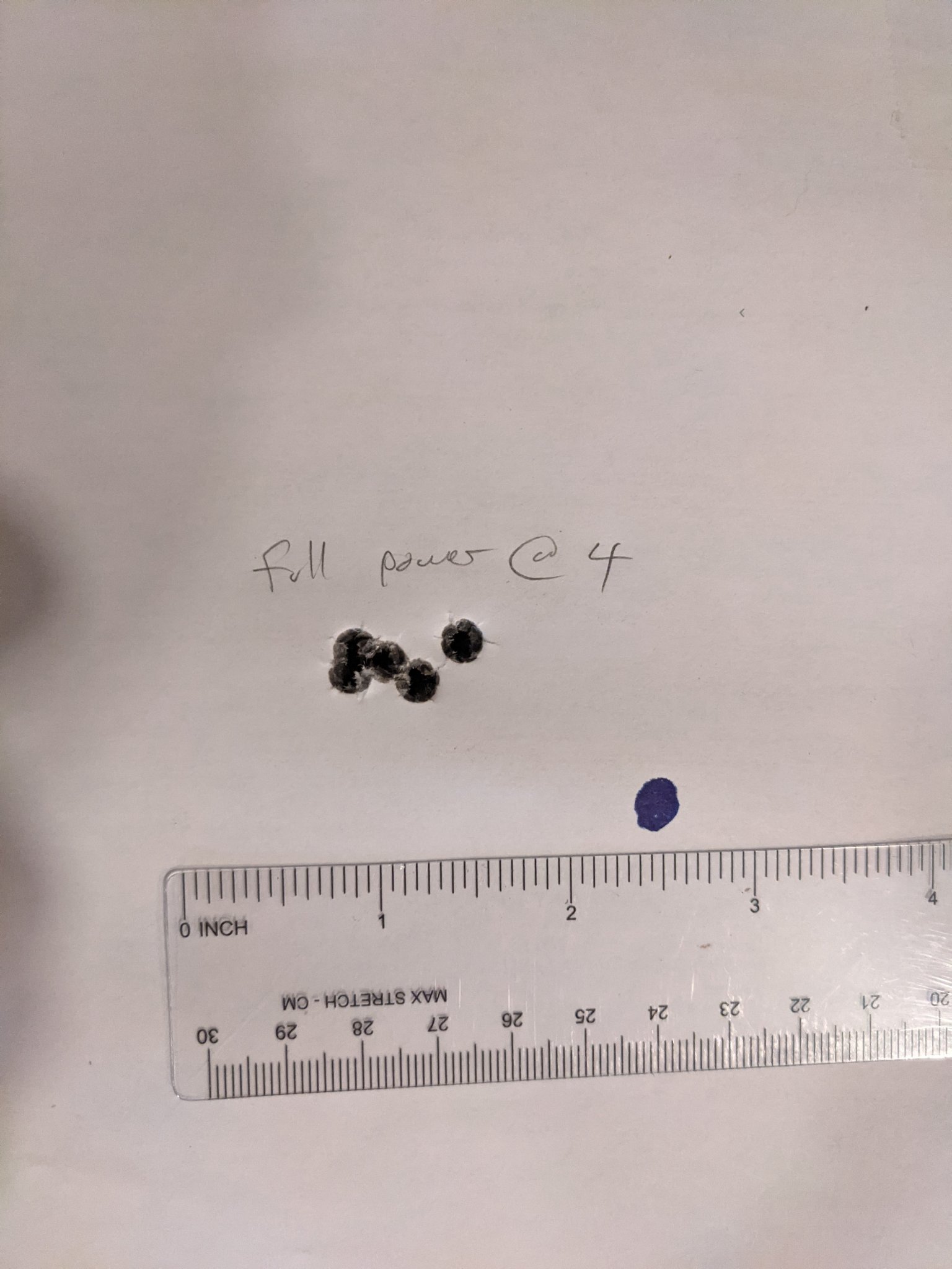

I'm waiting on a QB can to put on my rifle. Once I get the new can on, I'll re-zero the rifle.
This is the group with the old suppressor but without the tuner. It's an 8 shot group with factory Hornady 6.5 CM 147 ELDM.
I don't feel like wasting ammunition to improve on this group if it won't get any better than this. Should I try using the tuner or be content with what I'm getting?
I must have been doing something wrong with my other rifles as I could not see any improvement. I haven't given up on the tuner but just skeptical at this point in time.

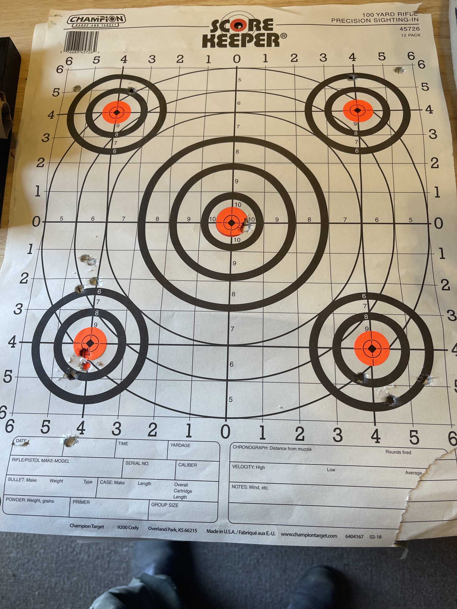

I know this is an older thread, but I've been considering the ATS tuner myself. since 2017, I've shot 6 creed factory, Hornady, federal, and this year Berger. I have a feeling I won't start reloading so the only variable to change would be a barrel tuner. I guess I'm always envious of shooters group in 1 hole or 1 ragged hole. I can't remember the last time my rifle has ever done that. I'm going to confirm my groups next time I'm out but if I'm shooting 1/2" groups, is this something I need to mess with?
I’ve had excellent results with tuners. Even the small rubber harmonic dampeners on hunting rifles. I recently used one from “without warning “ on a 300prc that I didn’t want to change coal. It shot like crap at first. I shot 2-3 shot groups @ 200 depending on if I thought I had something or maybe a bad shot. I moved it 2 spaces between groups for a total of 6 groups and then started adjusting my scope to bullseye. I like this tuner. I feel for my setup a lighter tuner might not of had the same effect. Here’s the second target and shot groups clockwise and called it done on bottom left and then fought my adjustment and zero lock to bullseye and quit on center but this is 200 yards which I like better than 100 so I can see the spread better
Reactions: rydah
The ats works great for me. Something I noticed on my 6gt barrel and my 6.5 PRC barrel , is if I change projectiles in the load the tuner setting is the same for each barrel. Kinda interesting even with a sample size of 2

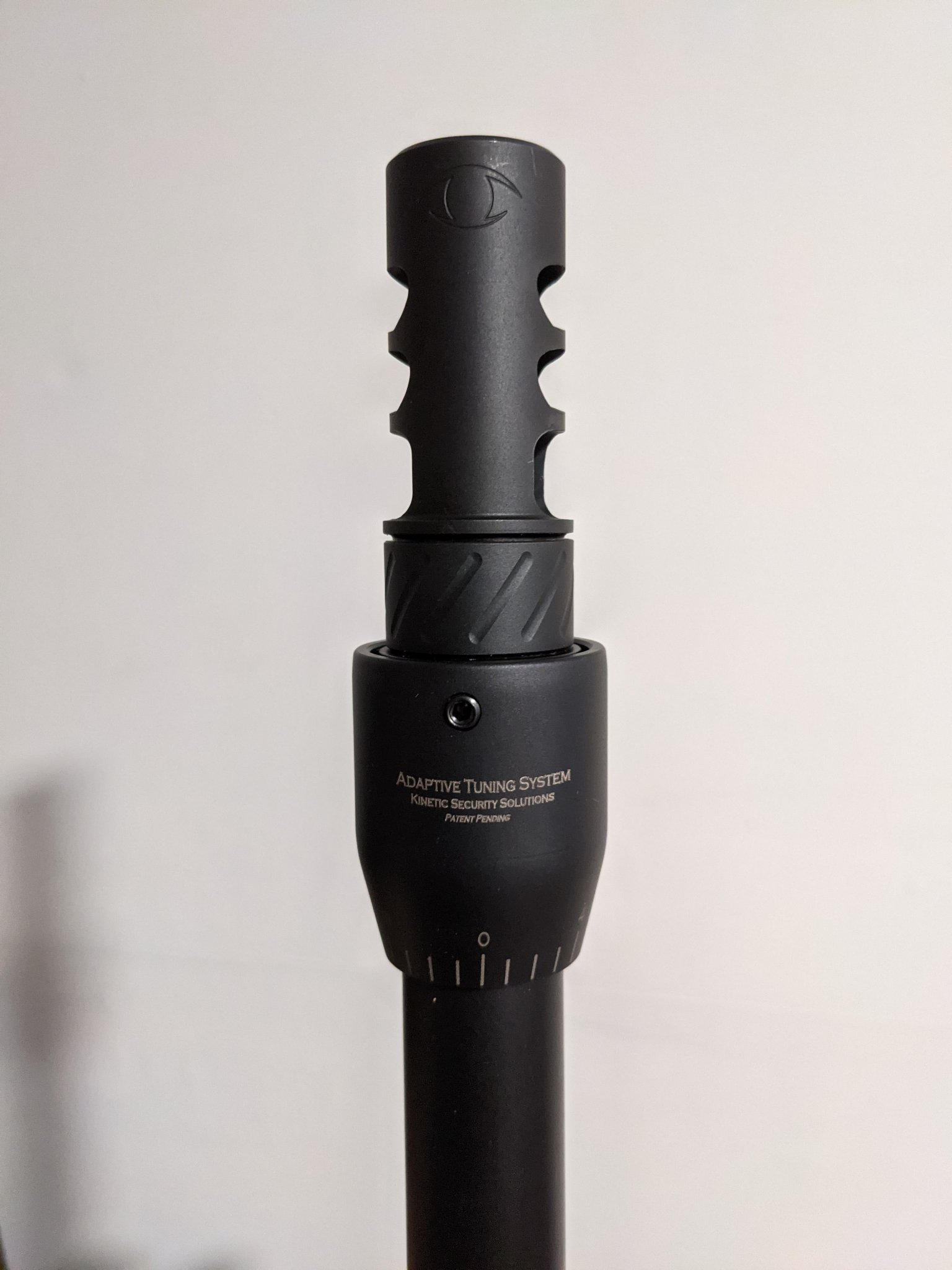

I’m not sure but I felt like the tmb tuner was the best choice for me with the heavier barrel and the larger bullets and the horrible group with just the stock brake. It definitely feels more substantial than my ats tuner but not going to experiment
I currently use the ATS tuner on an MPA bolt gun with a very heavy straight taper 26” barrel, 0.875” muzzle, and even with the limited weight of the tuner relative to the barrel, it can ‘create’ groups anywhere between 0.3”and 1”, as long as you test through one complete revolution.
Have managed to tune a new load simulating factory ammo, consisting of never-used components, cheap Hornady 140 BTHP bullets, new powder (IMR4350), book length load of 2.80” at a random 40.0 gn. No powder optimization looking for a flat spot, and no seating depth optimization trying to shrink the group. Initial group was over 0.7”. Tested the tuner in increments of 2 and the Excel graph roughly formed a sine wave. Final group was under 0.4”. Luck, maybe, but i doubt that.
Also, I have once intentionally “detuned” an optimized 0.3” load out to 1” via the tuner. So the physics works, even with low weight tuners.
But a defective rifle will never get “tuned” to shoot 1/4” groups. The rifle and the combo of components you picked need to be capable of that group through standard load development techniques. The tuner is just a faster more convenient way to get there, and it saves you multiple range trips - IF that accuracy potential already exists in your system. Pays for itself in gasoline…
I've had great luck with the ats and ec tuners. I get the powder/speed node at 500y via ladder. Shoot seating depth test in 20k increments from 40-120 off lands, pick the group with best overall accuracy and /SD. Then I tune that load. Can usually get things shooting in 2s and 3s this way.
Reactions: NamibHunter
22s are one of the best places for a tuner IMO. Aaron (ATS) makes a great one. His brake is also very well made and one of the less concussive while also being very effective. The ATS tuner really tightened the groups on my vudoo up with lapua/sk ammo.
For those that have used the ATS tuner, I have the inside collar set flush with the outer sleeve which sets it a “0”. I notice I can spin the outer collar numerous times clock wise (more than 3 or more revolutions, possibly 6-7), so how many revolutions are we supposed to make before you stop taking measures? 2 full revolutions? Or as many as you can?
