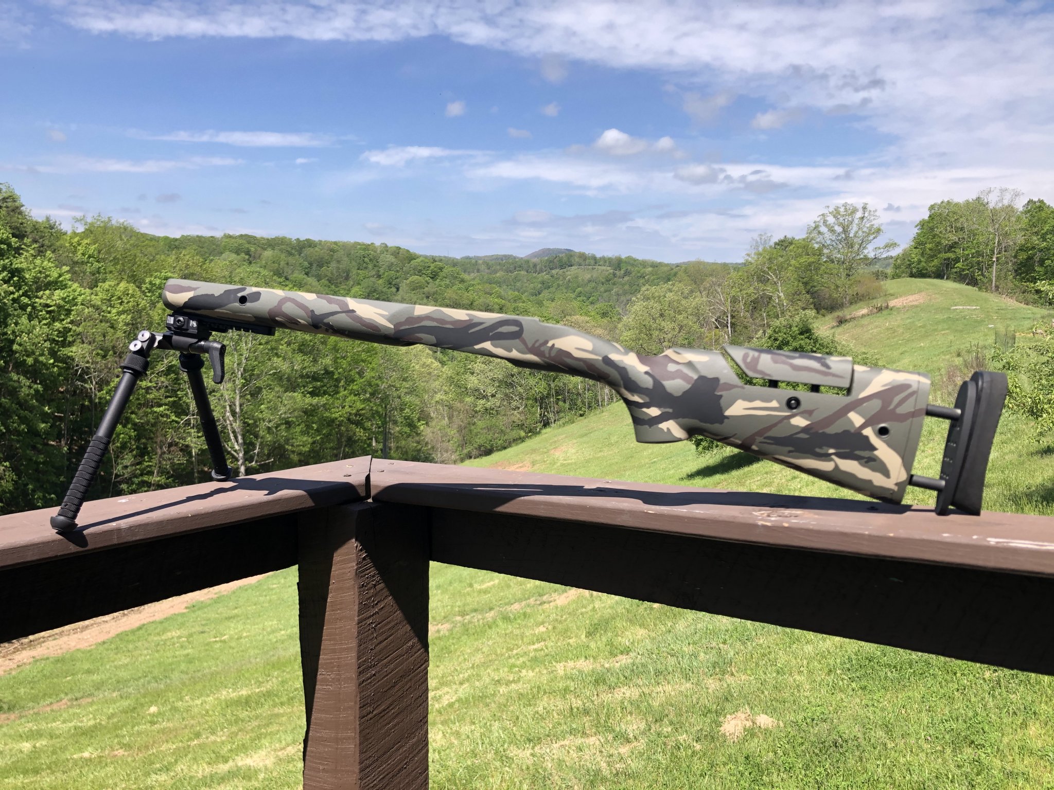

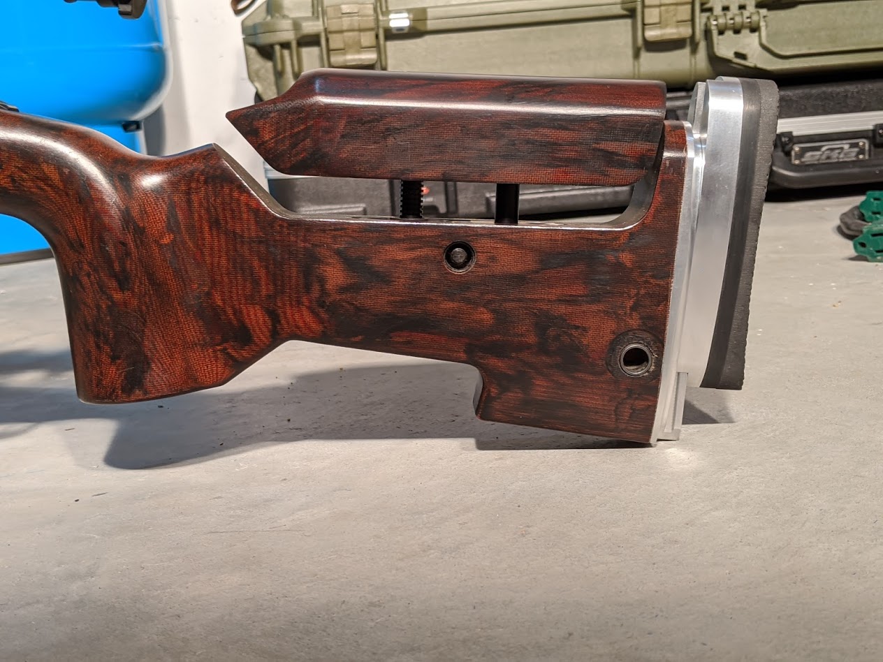

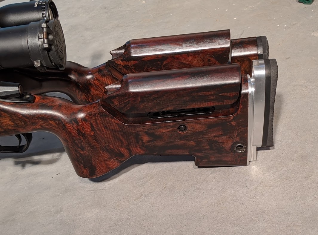

The below pictures are an unmodified stock (without spacer) and the Masterclass 2-Way installed. It dropped my LOP from about 13-1/4" to 12-7/8". He can take off less of the stock if you're comfortable with a more standard 13"+ LOP. If I find this is too short he has a spacer that can be added to lengthen as needed. However, if you have the flush cup on the bottom (I did) of the stock you have to cut on either side of it as it does not come out; or specifically order the stock without that flush cup. For reference, his 2-way piece is 1.3" I believe.

Looks awesome! Have you been out to shoot it yet? Is it what you hoped it would be? I too have a foundation and I'd like to raise the buttpad... not sure about canting it. Curious to hear a review now that you've had it.
I'm happy with it, so much so my second is getting shipped back right now. After having the adjustability on one it feels odd not being able to adjust.
I raised the buttpad up an inch or so, not a ton, but it is noticable when shooting positional stuff. That said, is it necessary? Nope, tons of people have shot without for a years but to me it was worth it getting that additional bit of comfort.
Should also note, I lowered my LOP a half inch or so which helped in the comfort in positional as well.

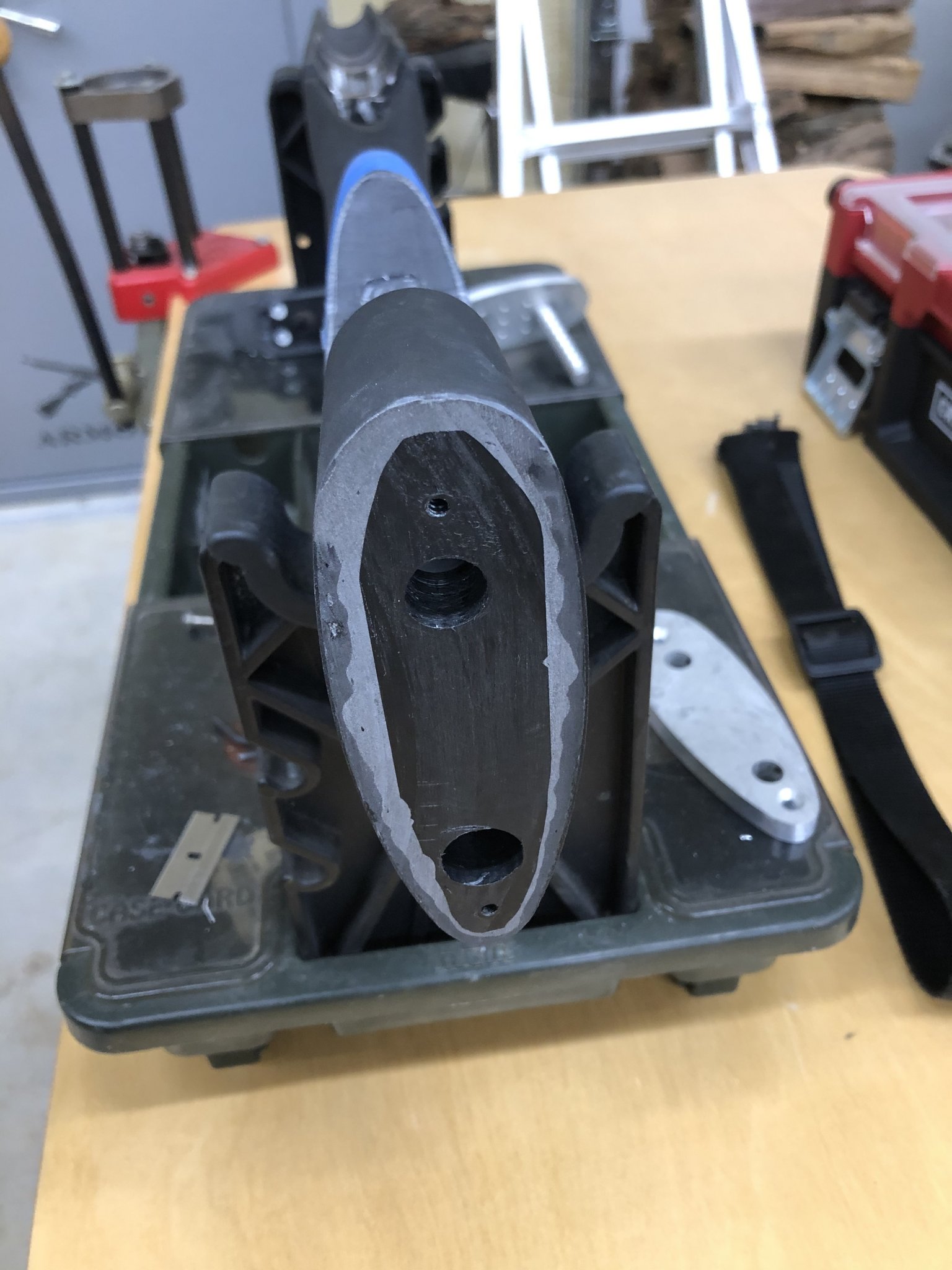

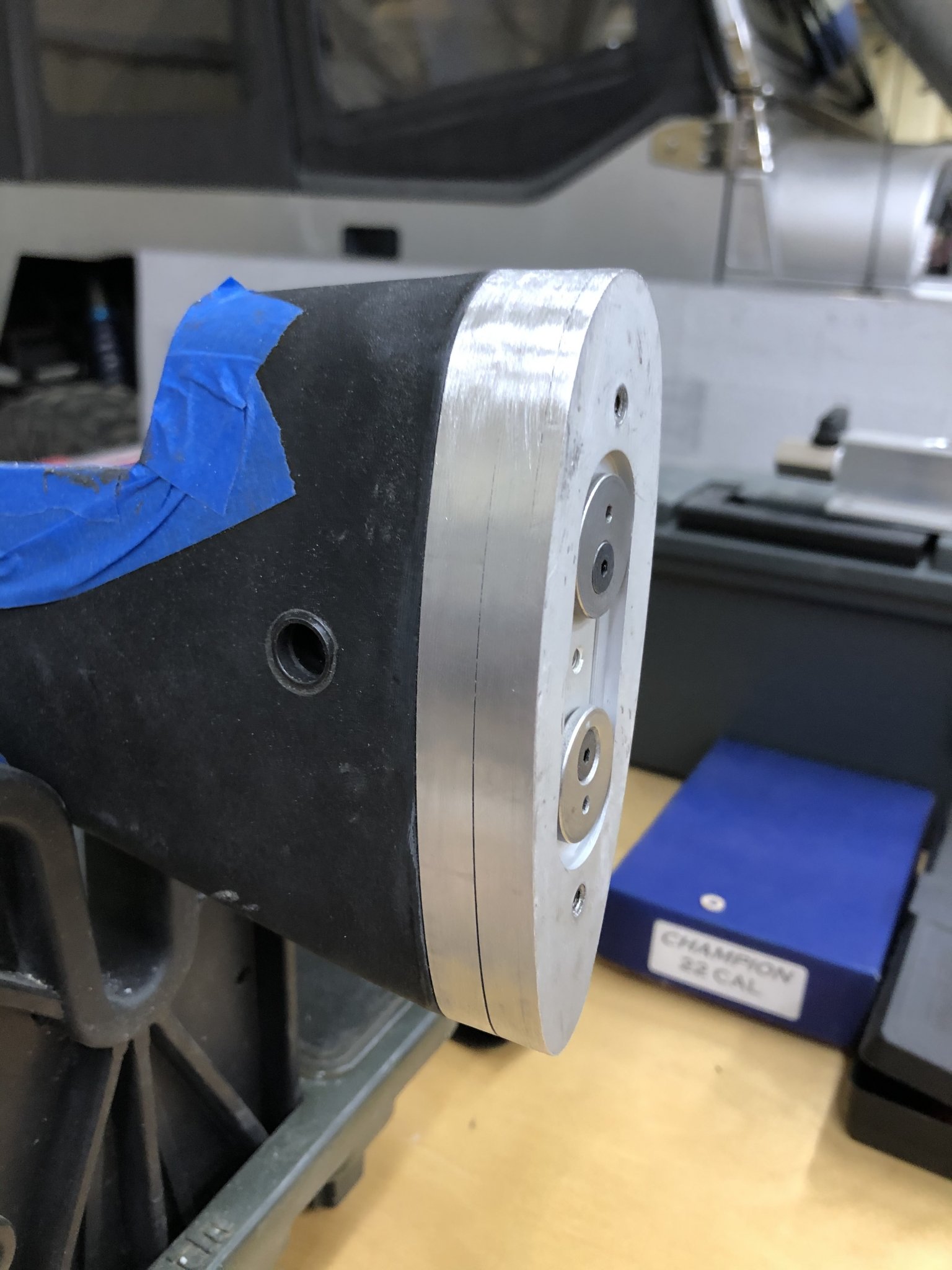

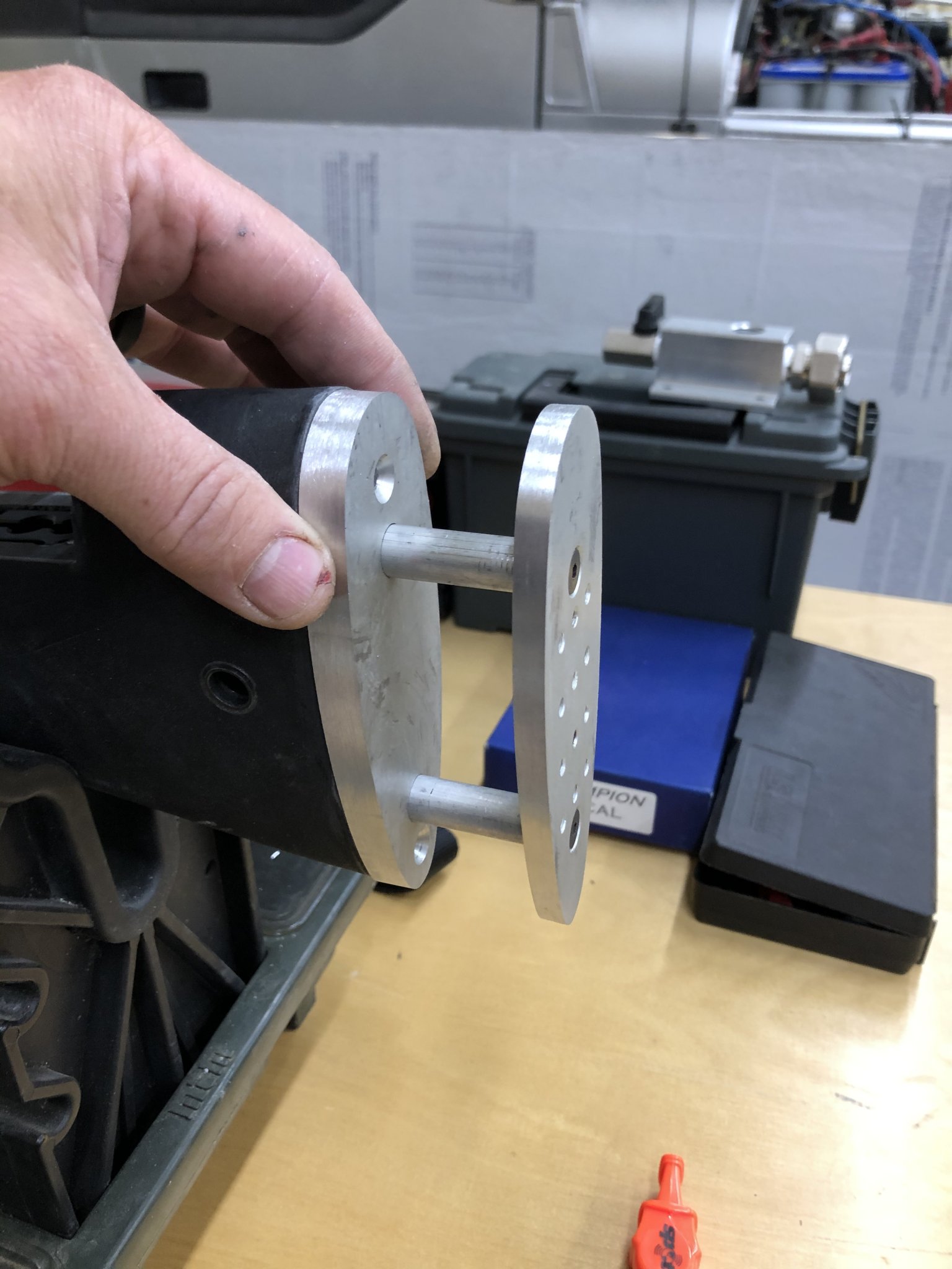

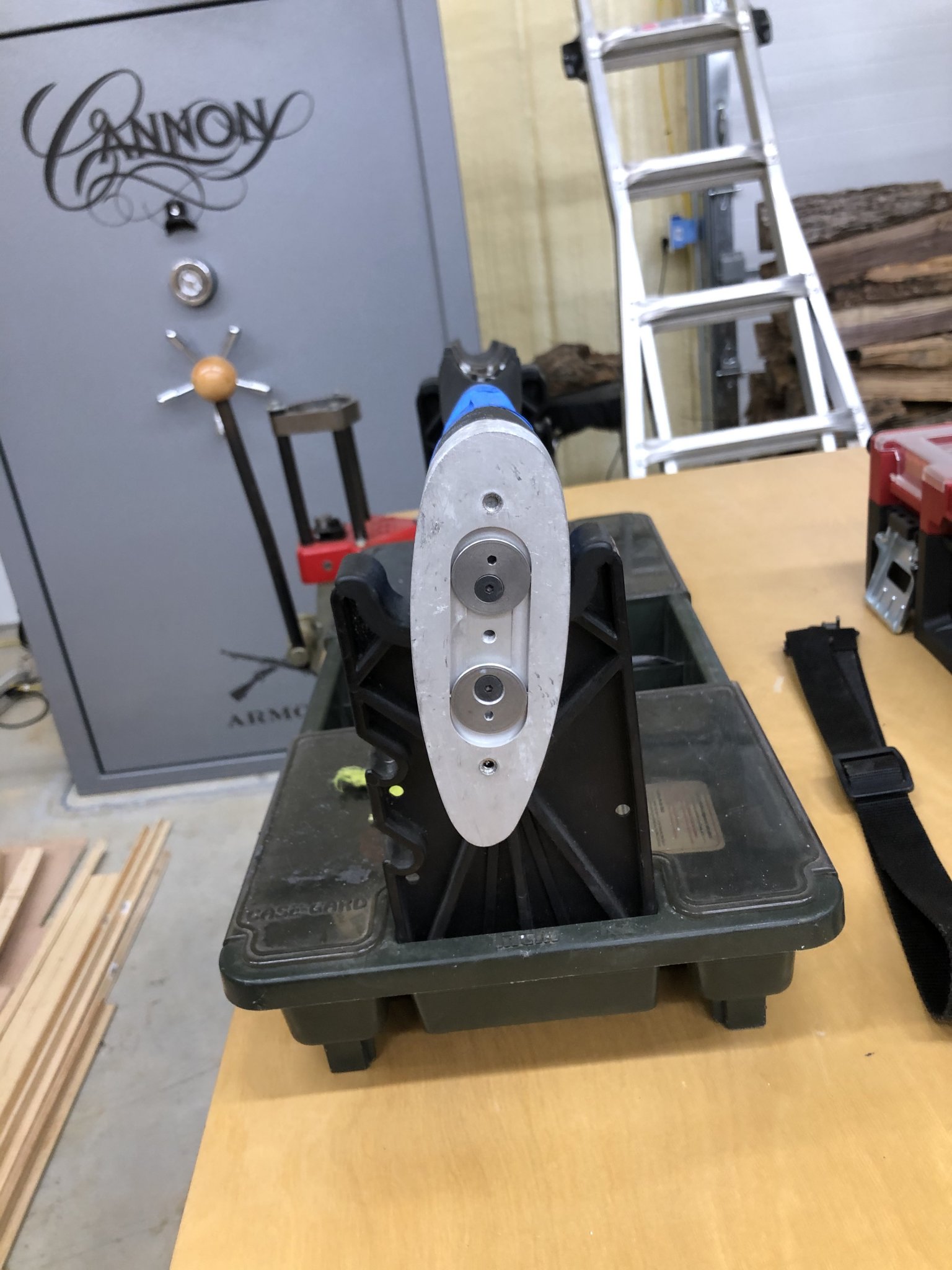

Did mine myself earlier this year and a loggerhead at the same time. Pretty straight forward for a dyi guy.

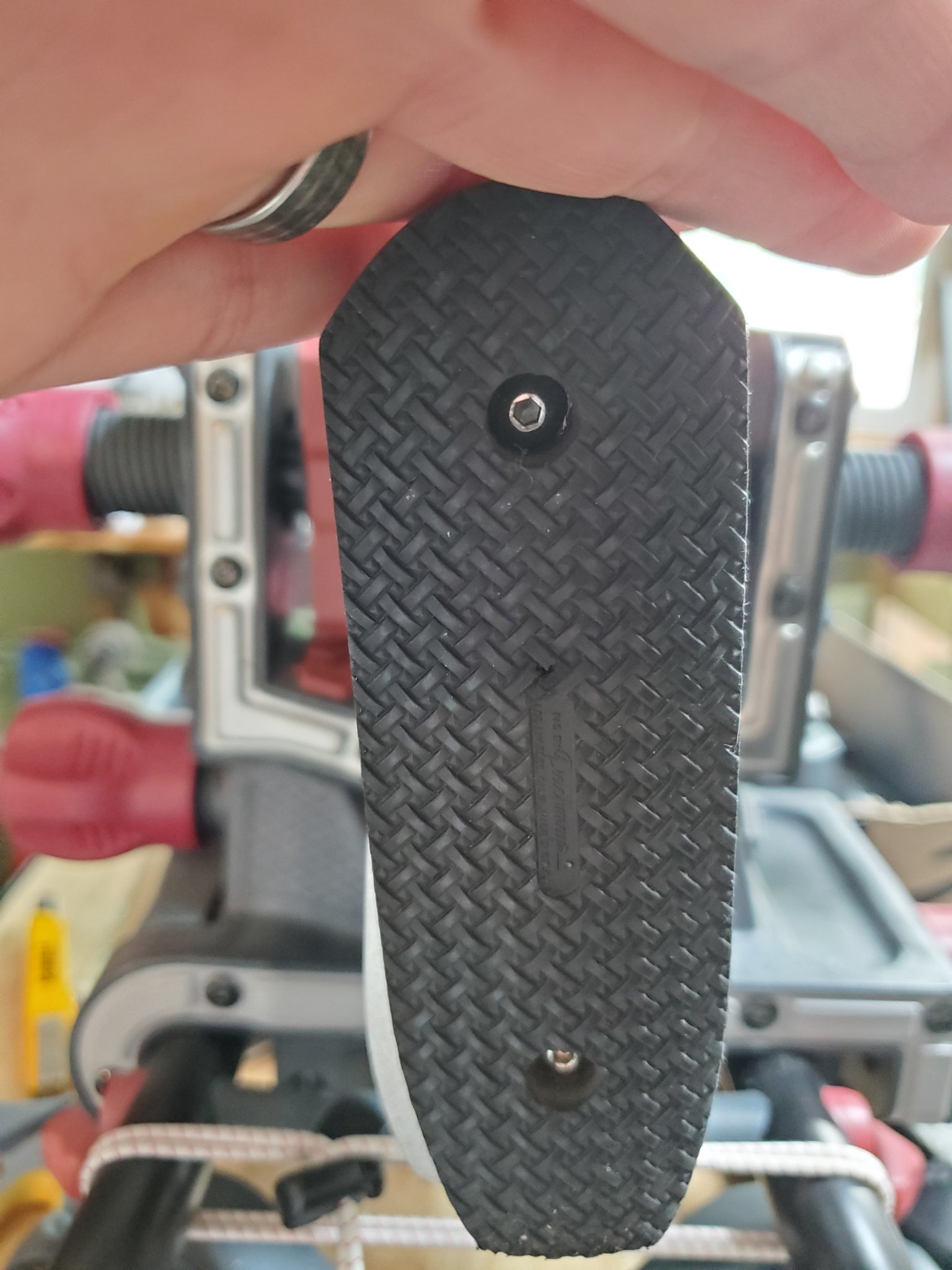

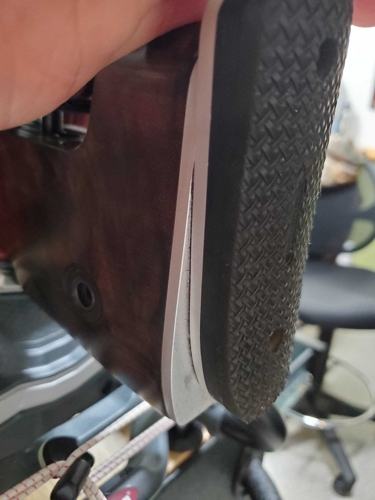

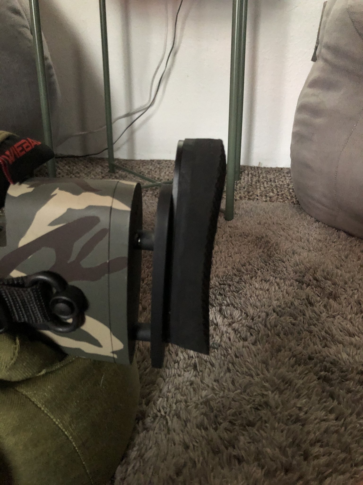

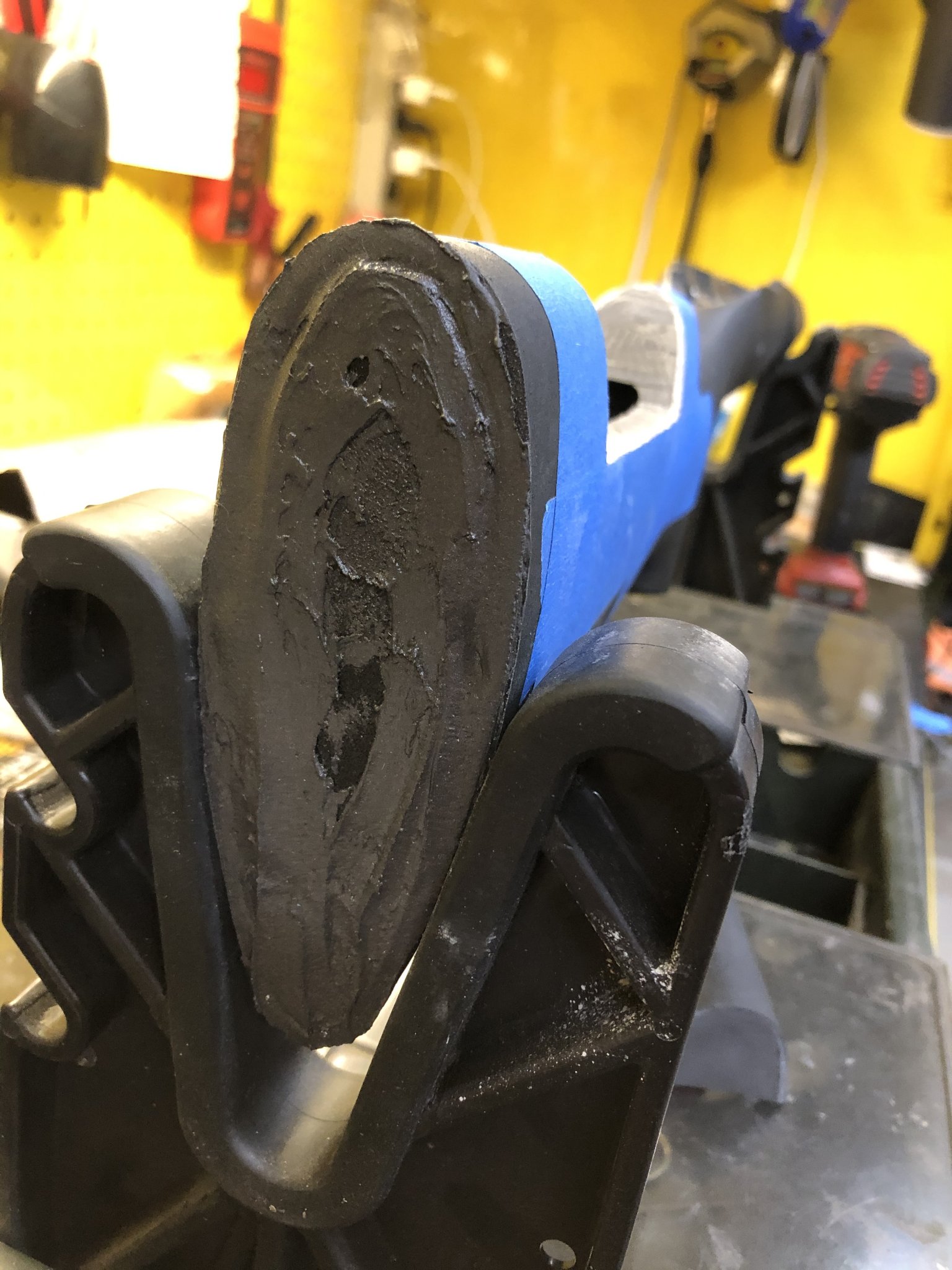

So I should have updated this thread but I kind-of forgot. I ended up picking up a couple of these cant and height adjustable plates - https://stockpositioning.com/produc...-pad-adjustable-butt-plate-assembly-black-sps. They aren't overly expensive and are thin enough to essentially leave the LOP the same which is what I wanted too. If you like DIY and have a belt sander or grinder this is super easy. I did two in about 3 hours.
I wish I would have take more pictures but I attached some of the finished product.
They are grind to fit and the process is pretty easy but I can try to write up more detail on how I did it if anyone is interested.

I'll post a couple tips for anyone wanting to do this.
1) The single bolt that locks the adjustable plate is too long to allow everything to bolt up. Very careful grinding to length allowed full thread engagement with the threaded plate and didn't require any relief cuts in the stock.
2) I wanted the uncoated version but when I ordered they only had black. In the end it was helpful because I took a hardened tip scribe to trace the outline of the stock when adjustable plate was screwed to the stock. The black showed the scribe line well and didnt wear off. Grind until the line JUST disappears and add a quick chamfer around the edge for a nice heirloom fit.
3) The black plates are SUPER slippery so even when the bolt was uncomfortably tight the plate could move with a good grip. They send a grip sandpaper type tape which when combined with a 120 grit finished on the surface of the plates, locks them together quite well with a gentle snug of the bolt. I trimmed the sandpaper with a brand new utility blade once I got the buttpad where I wanted to make it look cleaner.
Hope that helps someone!
Reactions: kindabitey and lash

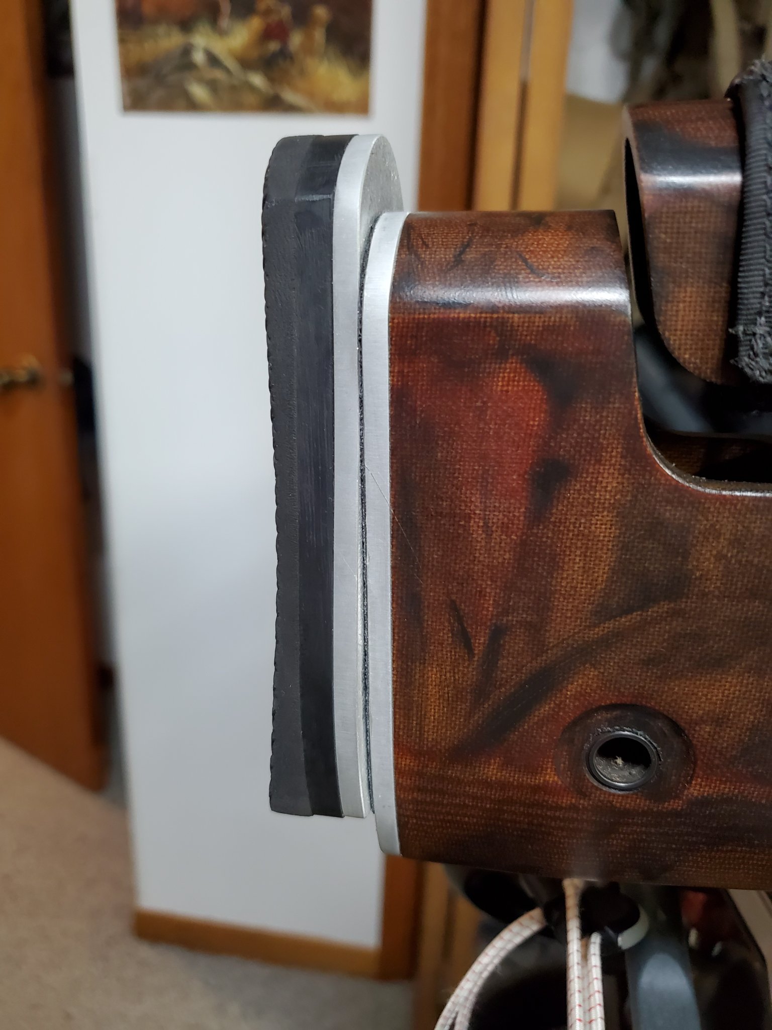

I used the sps system as well on mine. Got the uncoated as you can see in the pictures and just hit with black krylon once fitted. I cut mine fairly close to stock and then used a straight carbide bit with bearing on the router table and just let the bearing ride the stock made for a beautiful fit to stock. That was a suggestion from another hide member when I did mine months back and it worked flawlessly. I’ve experienced zero shifting with mine hope you get that figured out. After some testing I went back with blue locktite also.

Yep the coated ones are slippery. I stripped the coating and added a sandpaper grip tape and it worked great. Once I got the cant and height set I trimmed the tape to remove the exposed stuff. The edges double as a great reference point to put the butt plate back in the same spot after I move it for cleaning. 👍
