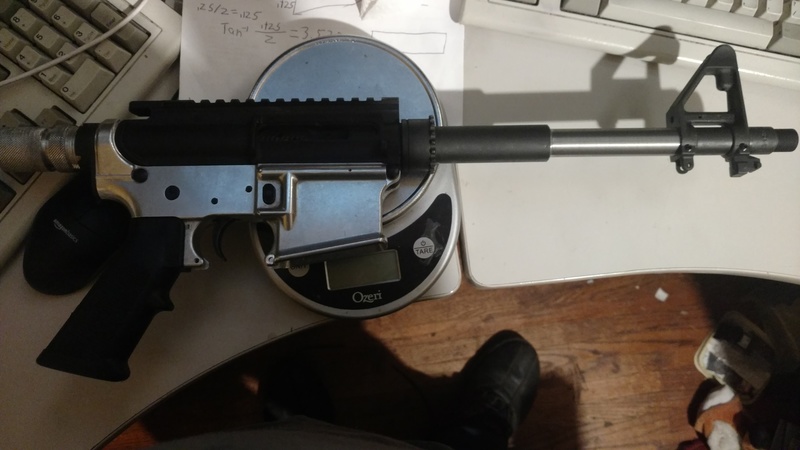

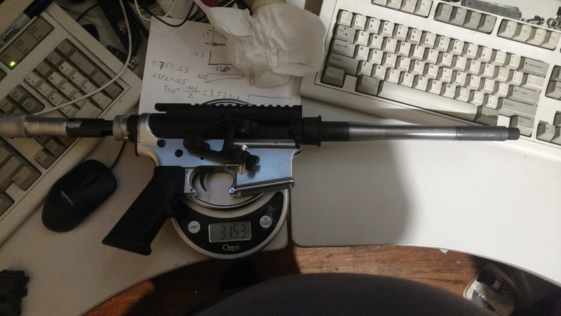

@Disfunctional_Engineer That's one crazy build you've got going on. Can't see the pics super well but definitely curious as to what modifications were required for it. (Also, props for being an 80% build, I've only done polymer so far but thinking about doing a billet one down the road)
I prefer 80s to anything else truthfully. If they made 80% revolvers I'd probably buy one. 🤣
In terms of modifications almost none. The pull handle and bushing were made on my Atlas Lathe, I punched a hole through the bolt (as said they are hardened AF) and that was really about it. I could add a buffer tube/spring/buffer, a gas block and a gas tube and it'd shoot as a semi auto.
The barrel was likewise turned on my Atlas. I lost ~6oz of weight turning it down. Just a basic bitch Bear Creek Arsenal barrel. No comments on accuracy one way or another. I haven't gotten sights where I want them yet and as said it's really just a toy so I don't care a ton. I bought dies and scored some .458 bullets for .10 each I'm going to size to .452 to reload it. With $1/round minimum for factory and locally more like $1.75 I have not had a hell of a lot of inclination to shoot it. I guess now that I have a 308 shell plate I can probably set a tool head up on the Dillon to do it.
In terms of the cartridges not coming out easily they basically fall out of mine. The inertia of the recoil impulse is enough to open the bolt up and it ejects readily with that alone. 450 isn't a low pressure cartridge either at 40K PSI but it's not super high pressure like a 308 either. I need to add a brake to my gun but I haven't seen signs of deformation on the brass so I haven't really worried about it.
