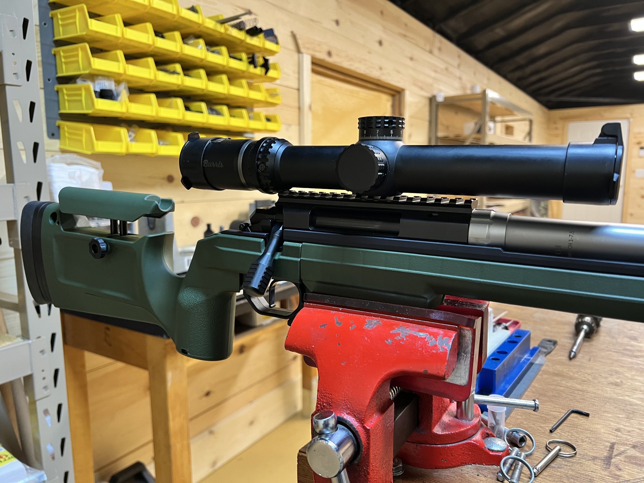

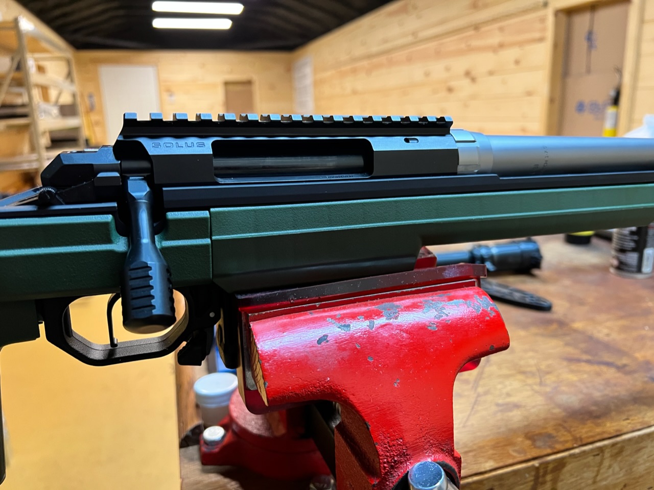

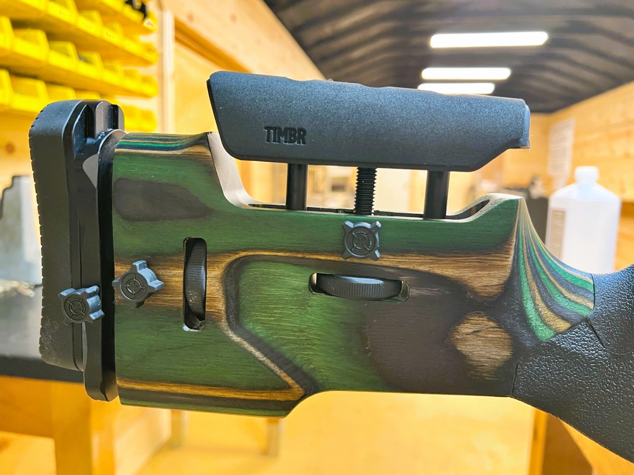

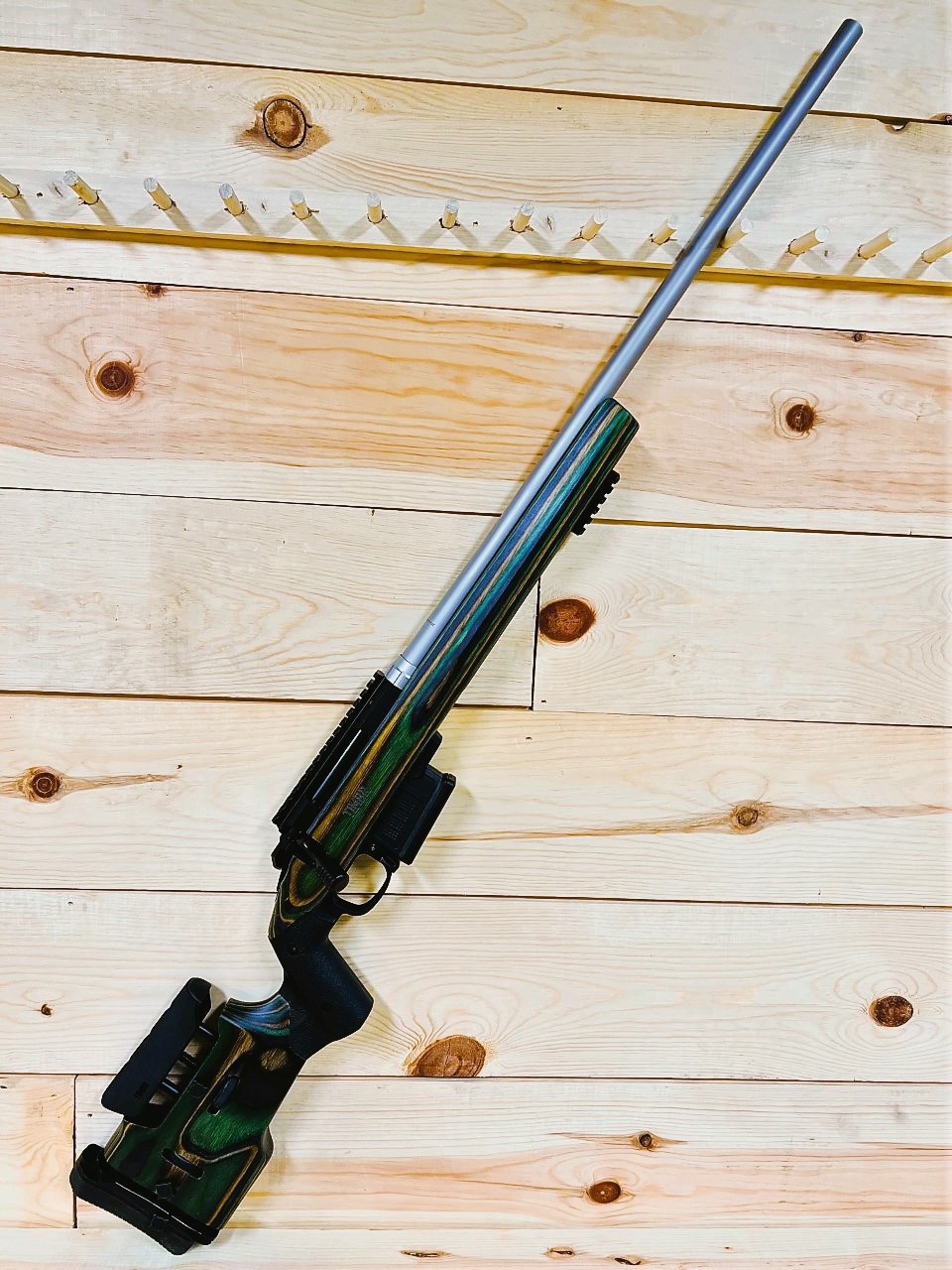

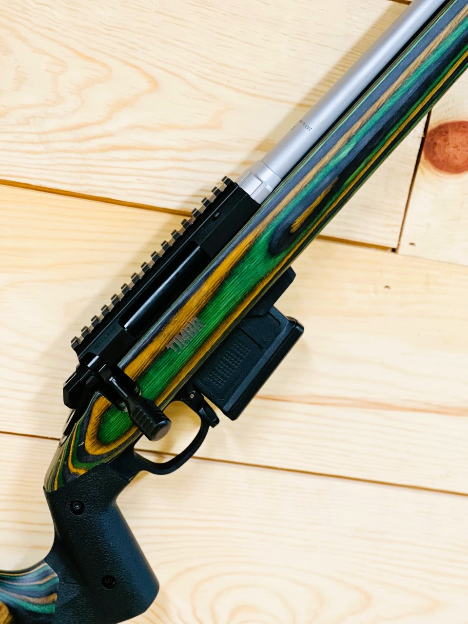

Did a soft seat of the SOLUS in MDT TIMBR Laminate chassis:

I just got it head spaced tonight. I took it out of the MDT TIMBR and dropped it into a KRG Bravo green. The SOLUS sat "clunky" high and the trigger hanger was tight on the inside of the stock. I called MDT and they said their stock will best fit something without a trigger hanger, unless I really wanted to modify with a Dremel.

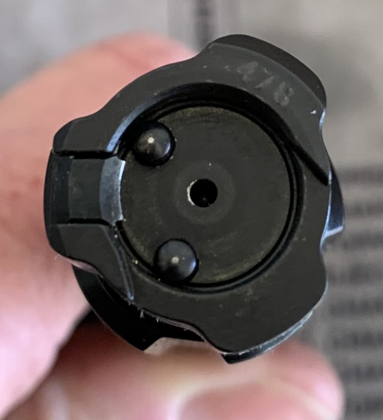

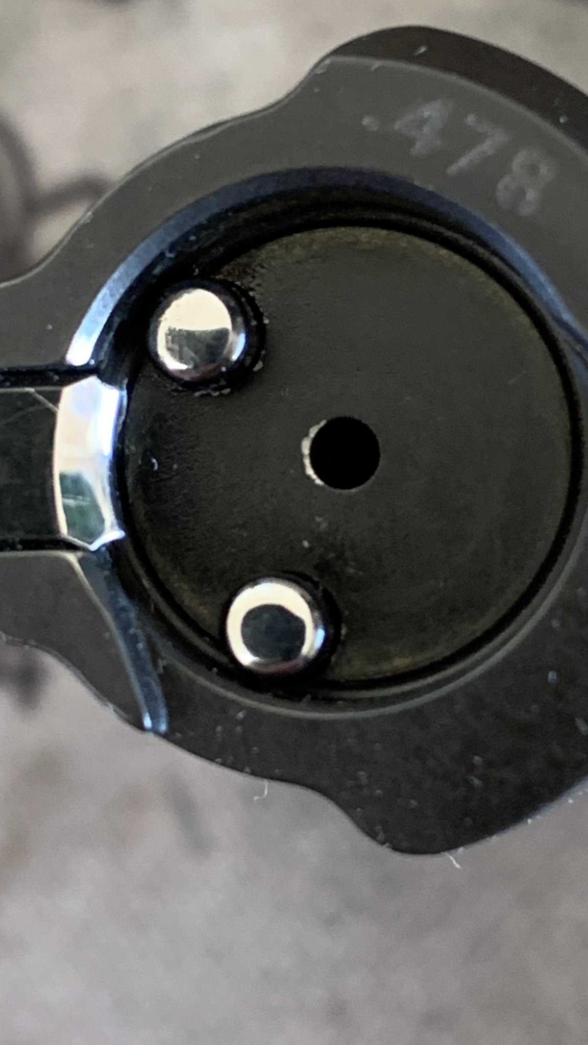

I did some tuning on the extractor and ejectors to smooth up bolt locking. The action has a fair bit of cock on close. Overcoming both ejectors and snapping the extractor over the case rim at the same time took some effort.
The factory ejectors are “pointy” on their face, note the tiny brass colored specs on them. Thats the only point of contact. The extractor moves in its slot pretty easily, but its face is sharp on every surface.
From the factory.
Wider radius on the face of the ejectors and mirror polished. I also removed a coil from each ejector spring. If you do this yourself, be very careful as doing it unevenly would cause wonky and unreliable ejection due to the case trajectory being too high or too low.
Bolt closes great now, and the ejectors dont pick up any material off the case heads. Noticeable improvement in smoothness.
From the factory.
That’s awesome! I just feel like these home remedies shouldn’t be necessary with an action at this price point, but I guess that’s why other actions cost twice as much for similar features.
I agree 100%. My eyes are wide open to the fact that im a guinea pig. Even if it was a train wreck, dicking around with new actions is enjoyable. Happy that its nowhere near a train wreck.
This is nearly universal to all early adopters. There aren't many popular actions on the market today that didn't experience early production teething issues. There are multiple comments suggesting ARC over the new Aero action which is ironic considering pretty much every new ARC action has been littered with early problems. I absolutely love ARC, and they are as stand up as anyone, but I think they sent me several sears, springs, and bolt internals along the way.

What grit did you use for this? It looks great.
