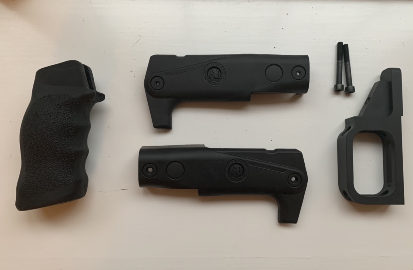

What does it screw in to in the chassis? Do we have to get our backbones drilled and tapped?
There are no modifications needed to the chassis to fit the conversion. It screws into the action so a strong connection. The rifle can be returned to standard at any time without needing heating up to soften bedding or locktite on threads.

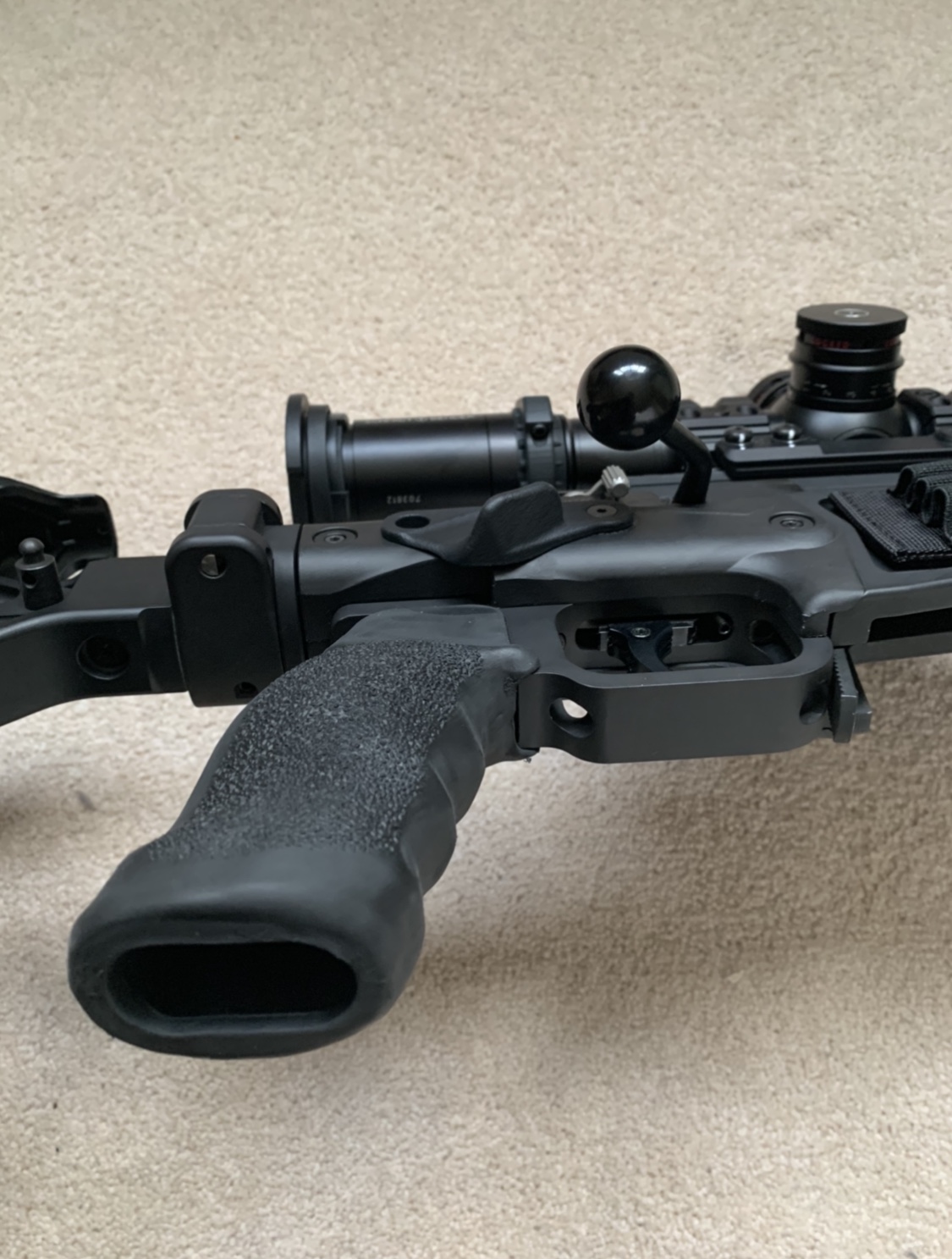

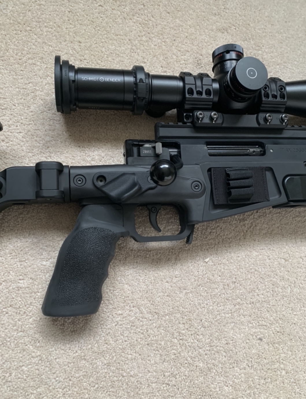

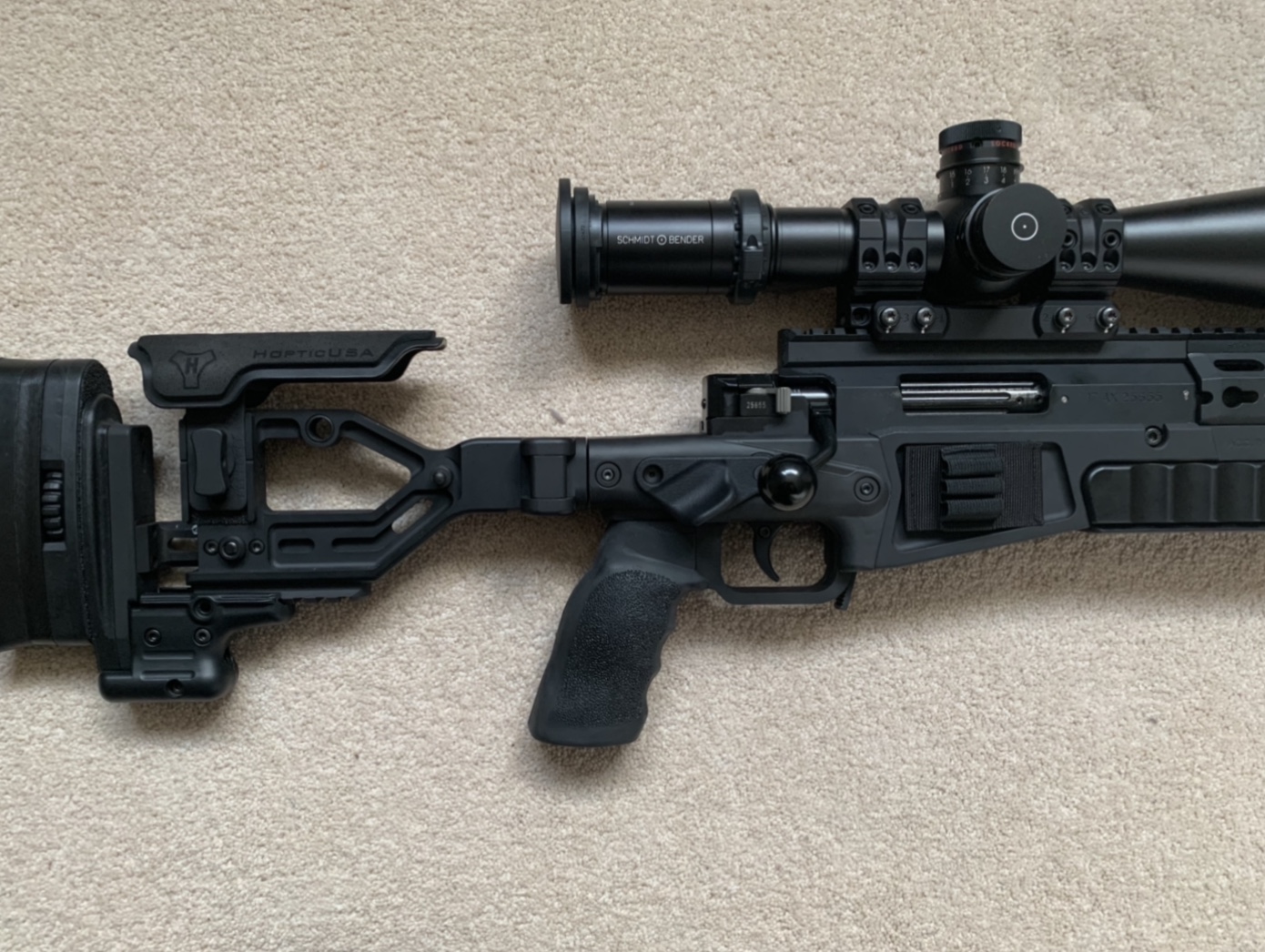

So got mine today, for anyone who is interested.
A decent set of instructions and very easy to install. In all perhaps around 20mins from start to finish?
Excellent design, well made & engineered.
Pics show ergo grip obviously that isn’t included, UK sales come with an A2 standard AR grip.
What I particularly love that it looks like OEM and as it should from the factory rather than some after market frankenstein Bolt on.
My only annoyance is that I’m quite OCD and a stickler for torque values. I wasn’t able to torque up the screws to 35 inch lbs using my fat wrench or fix it sticks as holes weren’t big enough to support the bit. So just had to guesstimate it. Not an issue with the product but most likely my limited selection of tools at my disposal.
Is it worth the cash or “value for money”.... only you can decide but I’m certainly very happy at first glance and excited to hit the range and try it out properly.
Any questions feel free to ask.

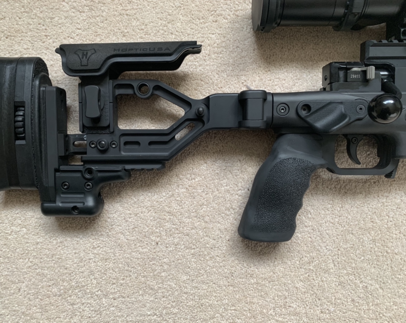

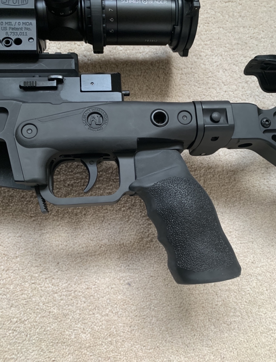

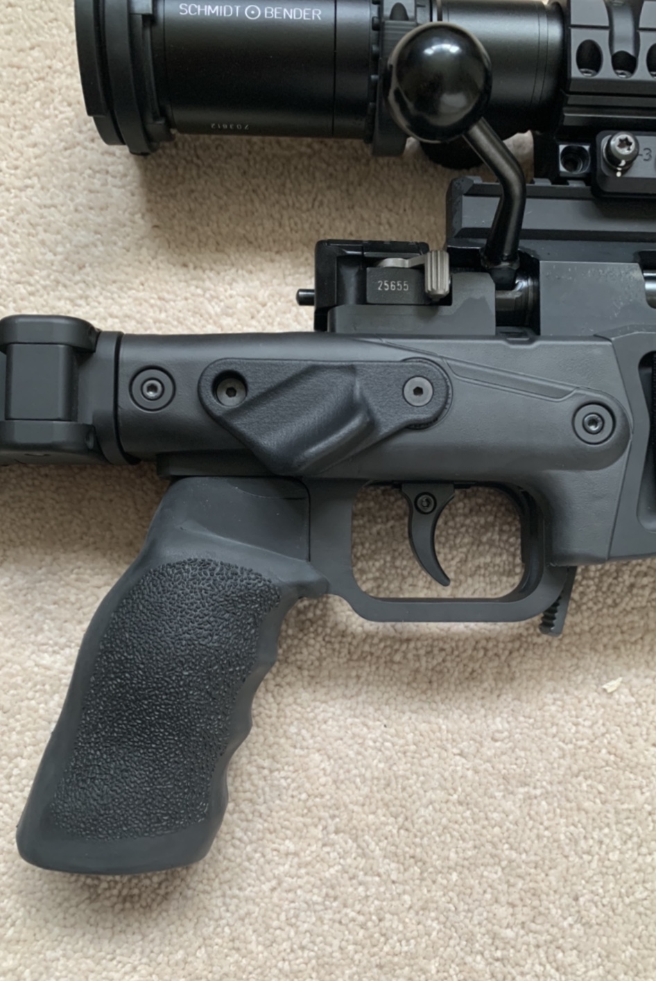

Looks awesome man. Looking forward to hearing how ya like it.

Very nice indeed

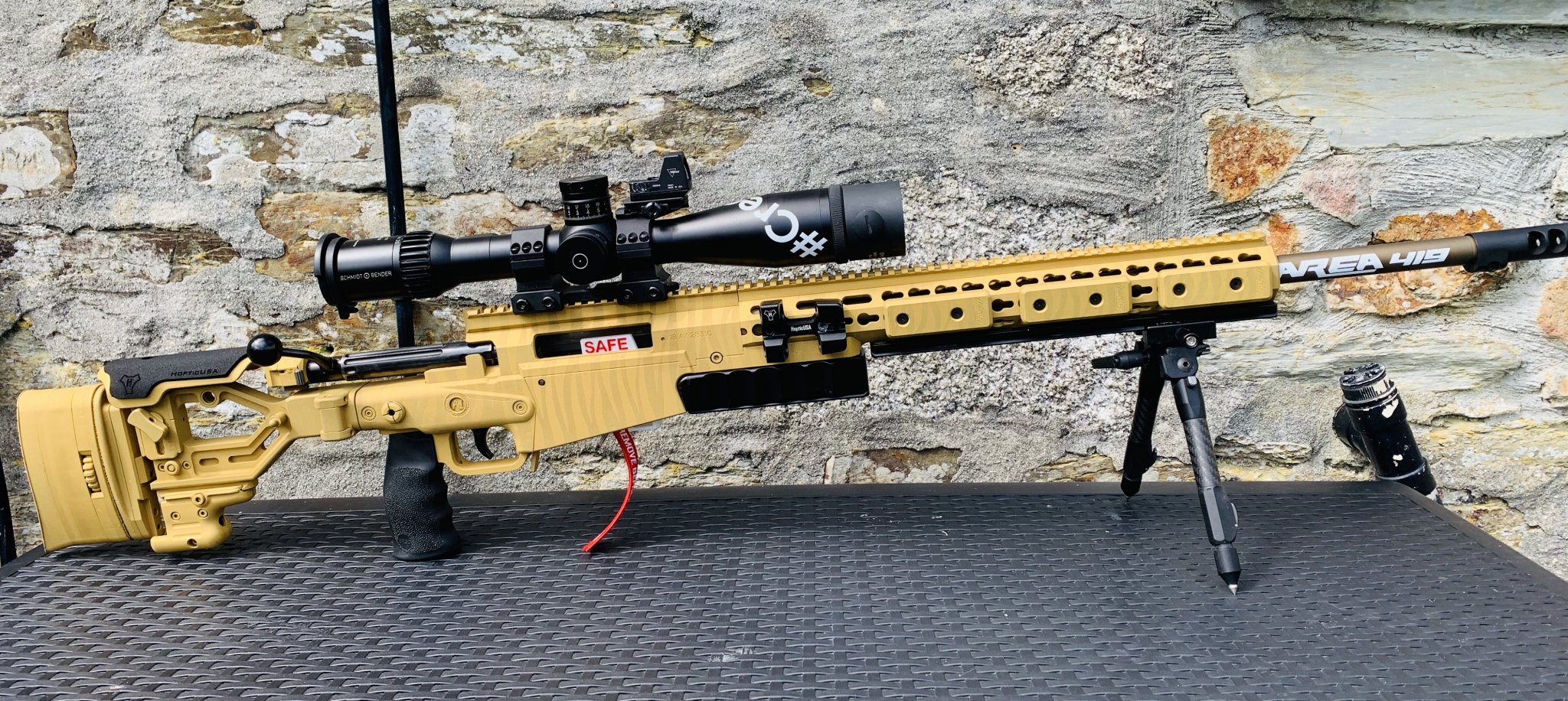

Looks great! Patiently waiting for my FDE set to arrive. Hard to tell from the pics but did they refinish the plastic skins as well?
Thanks for posting pics gentlemen! Would one of you mind taking a pic from the bottom looking up with the skins on...and also some pics with the grip plate mounted, but the skins off?
Thanks!
Also @clubsportmark ,how does it feel with Sam's thumbrest? Do you feel you have to move your thumb too far to the side compared to the grip, or does it feel pretty natural?
Thanks!
In my personal opinion it feels slightly further to reach to get on the thumb shelf but still comfortable. The standard grips I would always float my thumb and hardly ever full wrap. With the new grips it’s very comfortable using full wrap, and as mentioned a slight stretch using the shelf. What I what will end up doing long term I don’t know. This is only my thoughts in my house while not shooting it.
But certainly ambi shooting in my eyes now instead of only one way which was comfortable. Later in down the line I would be tempted to try the zero angle version of the same grip.

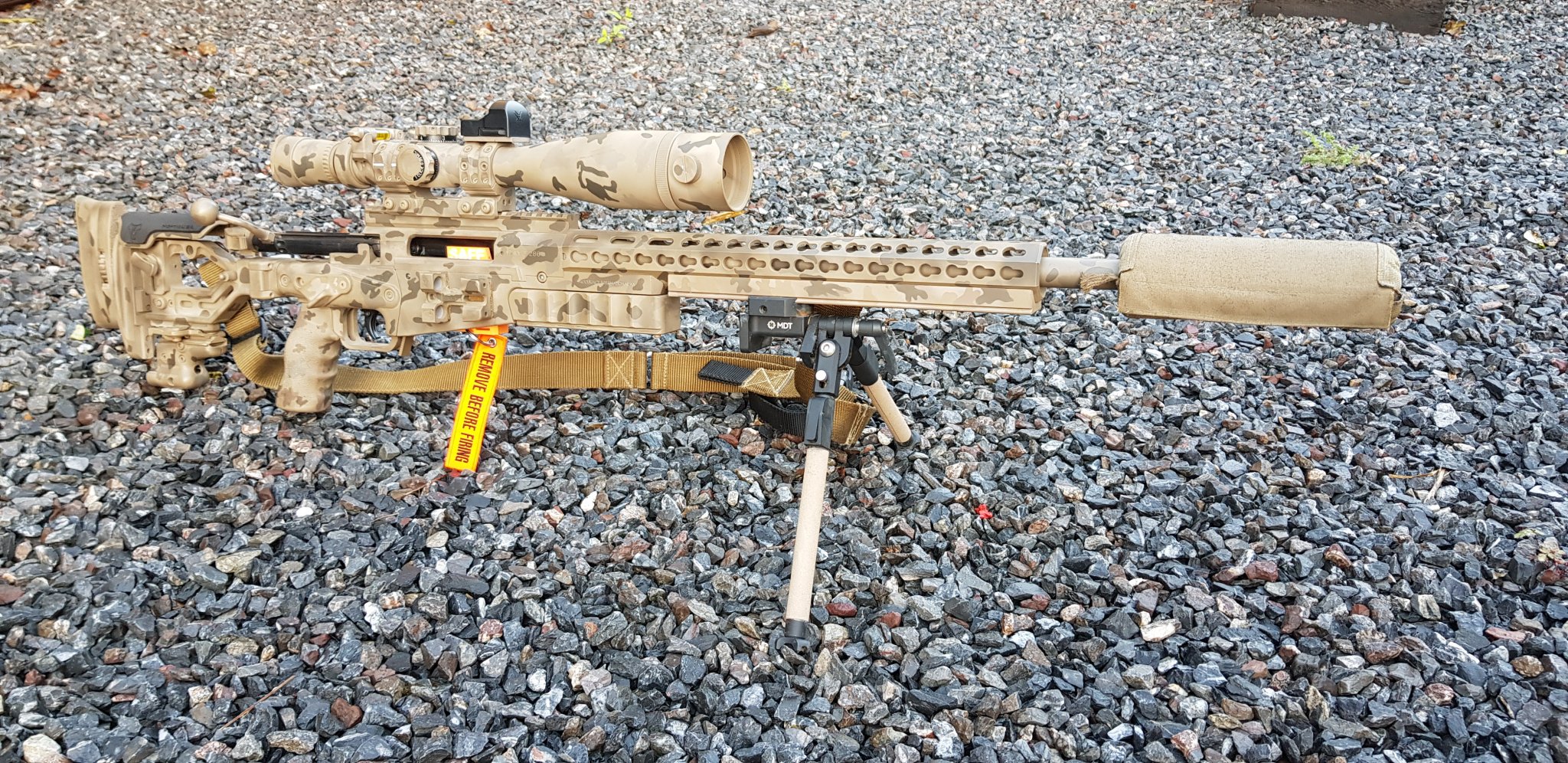

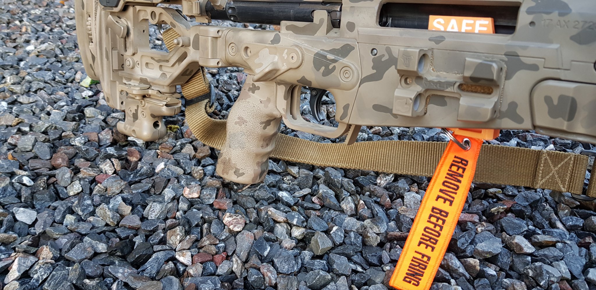

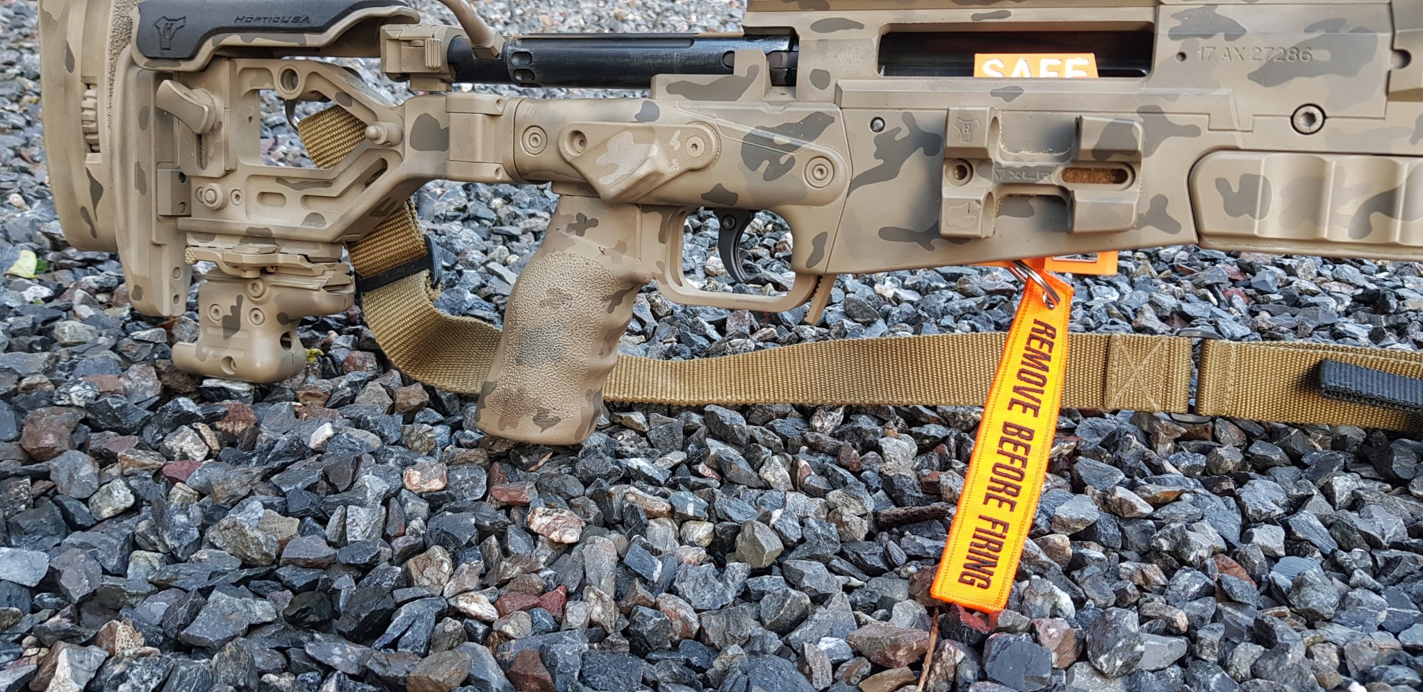

Mark did it himself, he’s one of the best cerakoters in the UK
Thanks Raging Rocco84, finally got the hang of Cerakoting after 10 years 😂
This is the 2nd colour scheme on the rifle. Probably change it at the end of the year as I use it for showing colours and styles for my business.
I do like this one a lot though.
Looks good with the new ergo grip, didn't realise how awkward the stock grip was until I changed it.
Mark
Reactions: M8541Reaper

The AI grip conversion is machined from an aluminum 6082T6 billet.
The trigger guard is bolted to the AI action through the chassis as the original trigger is mounted.
I have tested this and the previous grip conversions on my own rifle and also have provided the grip conversion to others in the UK for initial tested.
The grip conversion is as strong as the original AI grip which is made from injection moulded plastic.
Drop tests have been carried out by me without issue.
The grip conversions have been used in UK PRS competitions and hard field use without issue.
The grip conversions are available in standard AI colours, as per my original email.
