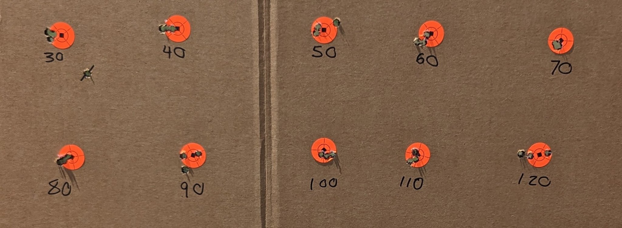

300NM, Factory Barrel.
220 LRHT
Lapua Brass
Fed 215m
N570, 86.5gr.
Velocity was 3005fps or so when newish; last time I chrono'd I was down about 50fps. I'm not sure if a combination of that was from cooler weather or just from N570 use, I only have 452 rounds on the barrel so far.
30k - 80k off jam shot consistent POI:

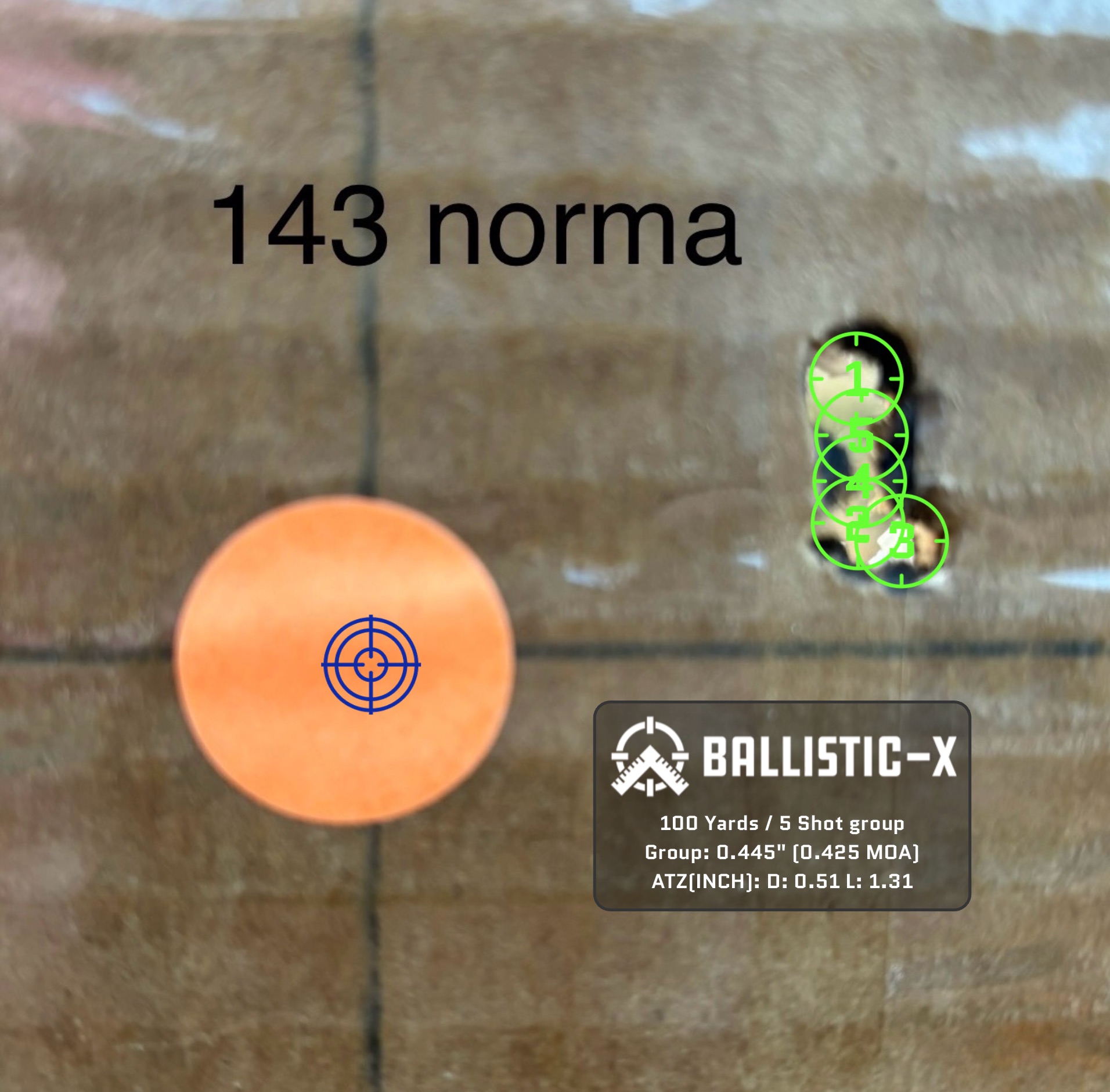

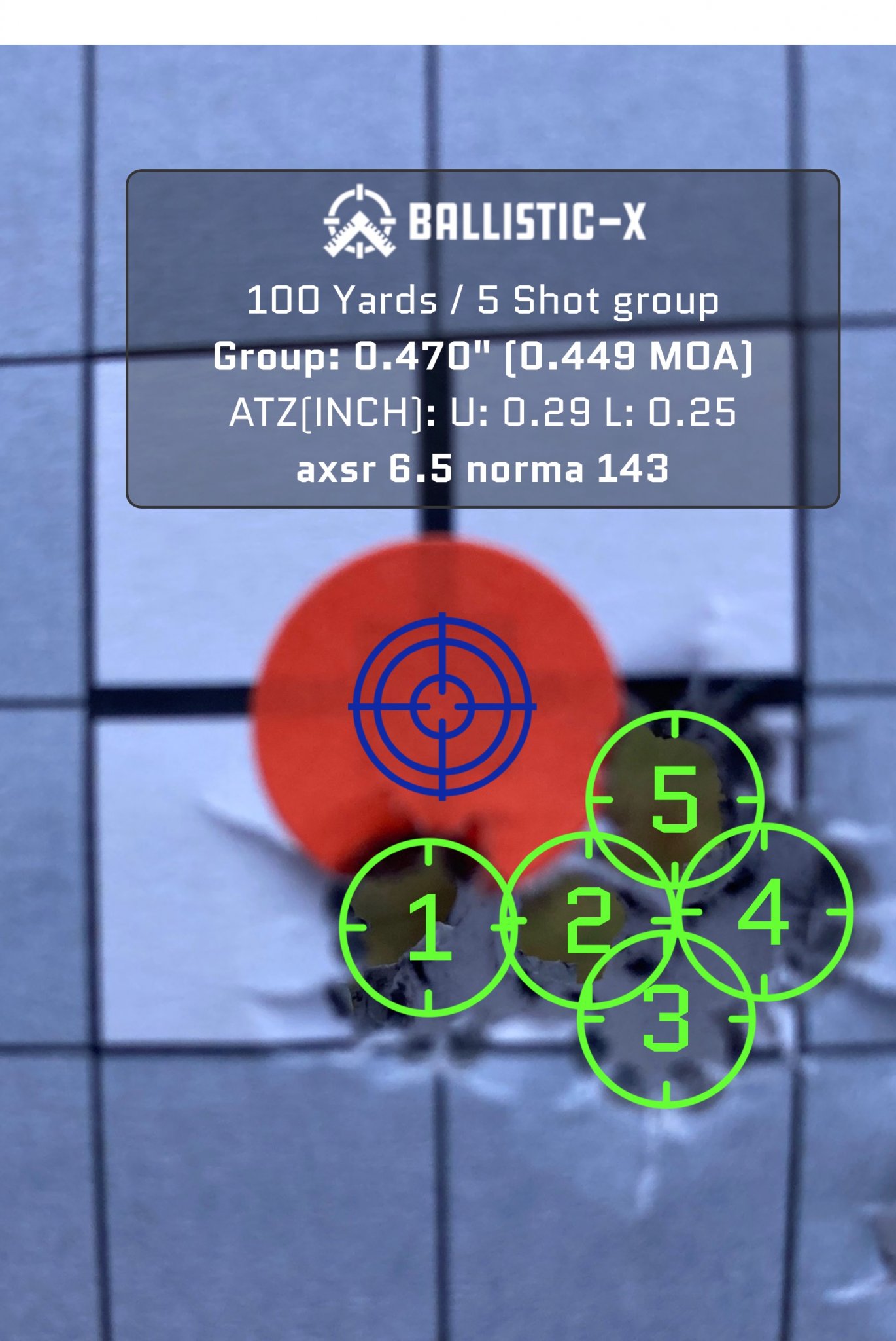

bought a proof stainless 6.5 creed barrel for my axsr.
Only fired 20 rounds through it so far but it was pretty accurate.
Poi shift was .8 low and .3 right from the 300nm barrel.
Norma match 143gr
2593fps.
Kgm R30K

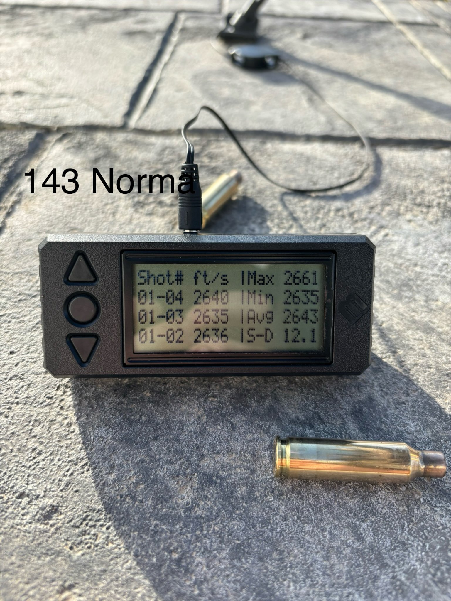

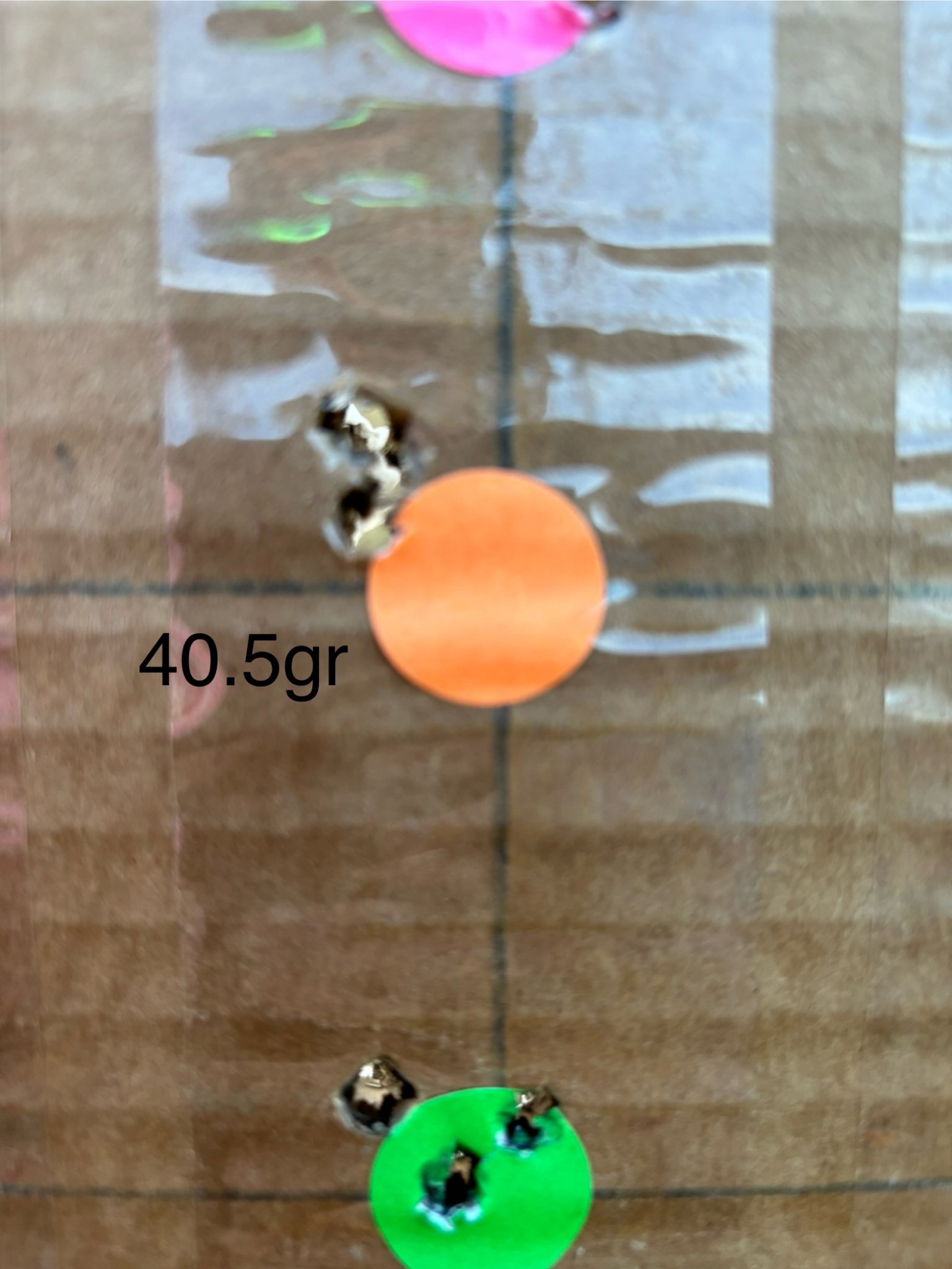

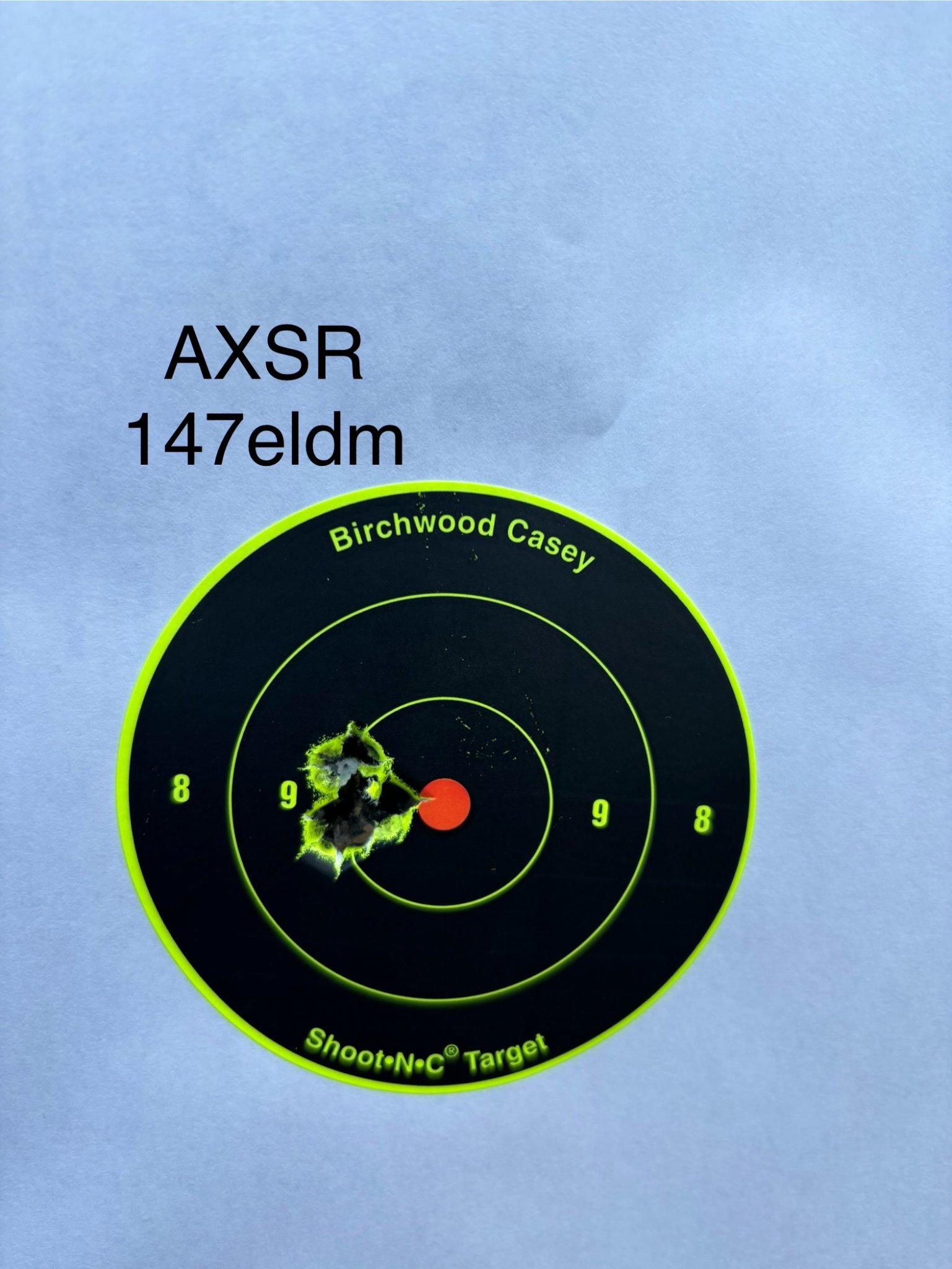

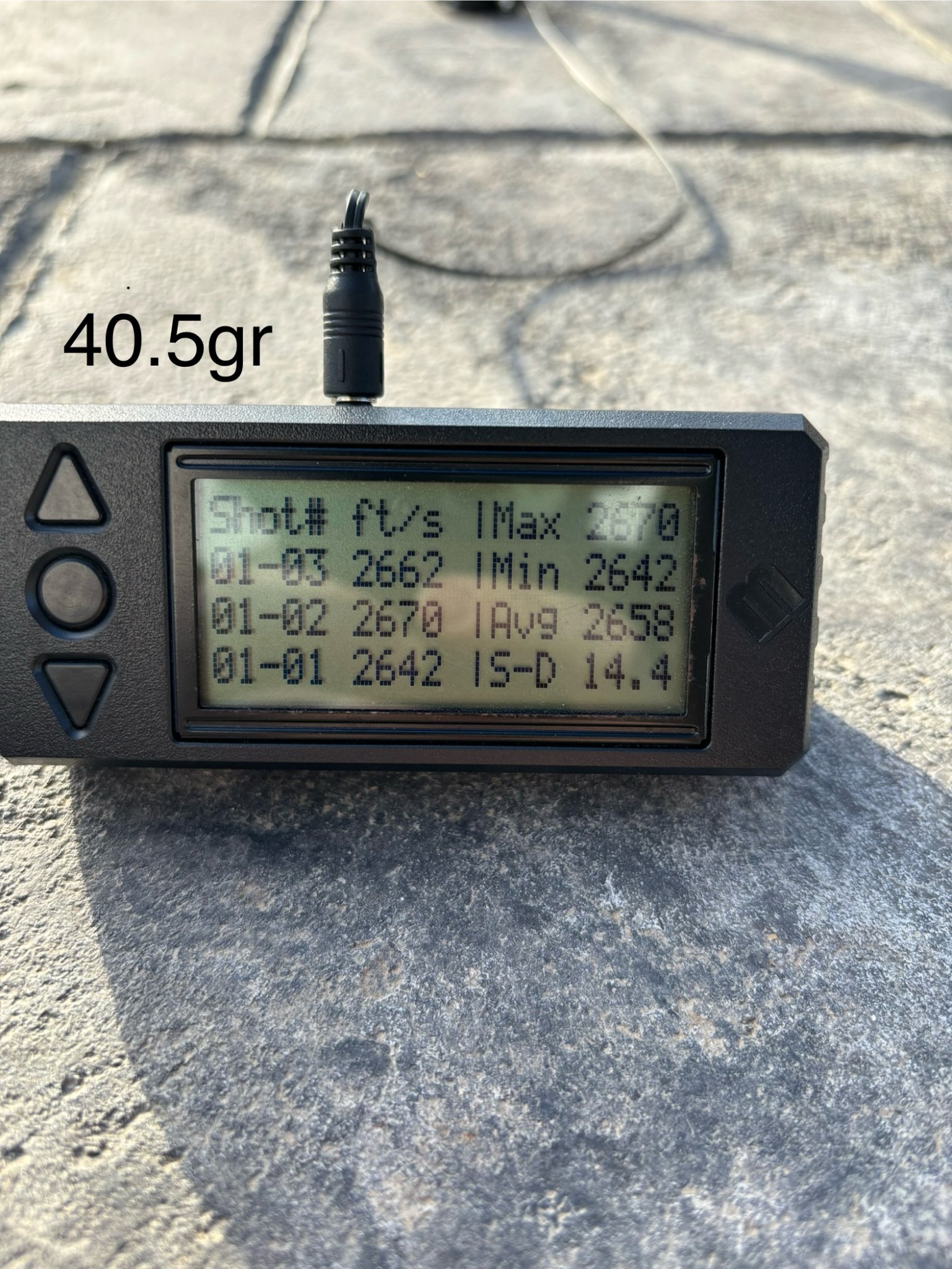

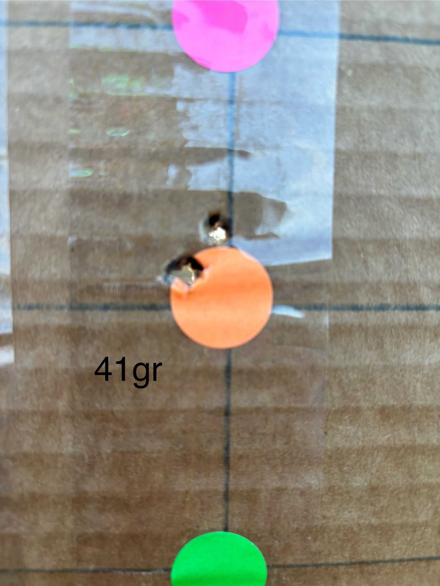

Worked on this a little more.
The barrel now has 100 rounds on it and I’ve started load development with 147eldms and imr 4451.
I shot 5 rounds of the Norma 143 box ammo to check zero and see how much the speed has changed over 100 rounds.
From 2593fps to 2647fps.
Pictures below. This ammo shoots very well and I had consistent groups at 983yds on steel.
For the 147 eldm I backed off the lands .030 for a starting point and it ended up shooting well.
Charges with imr 4451( don’t use my data make sure to start low and work up.)
40,40.5,41 & 41.5.
All charges shot under .5” @ 100yds
41.5 was giving some stiff bolt lift
40.5 & 41 seemed to be where I want to be.
41 is what I’m going with.
2698fps. The group was shot with a magneto on.
40,40.5,41 & 41.5.
Continuation-
Proof 6.5 Creedmoor prefit
147 Eldm’s
40.5gr 4451
2711fps
.39 moa 5 shot groups at 100yds
