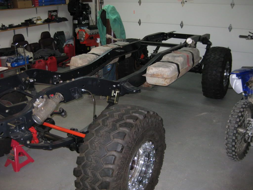

Here's a pic of the Jeep for reference

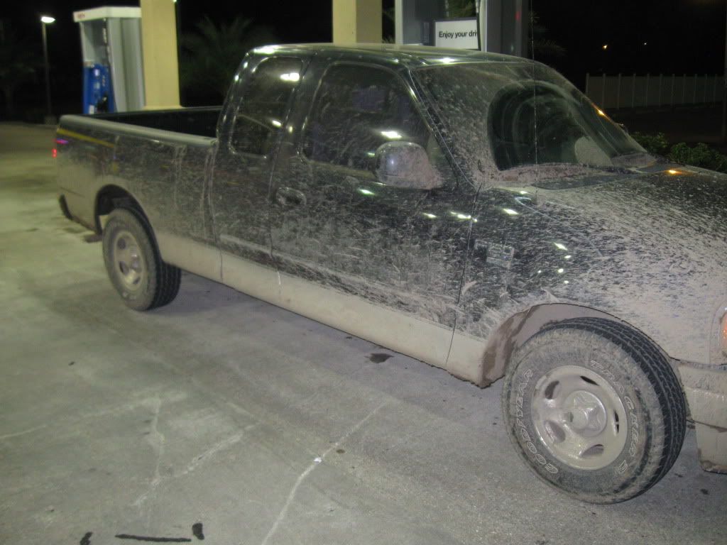

I'm looking for new tires for my '99 ford f150.
off roading with street tires wasn't the best idea i've had
planning on 6" body lift, new suspension, new tires, flood lights
(sorry for the hijack)
