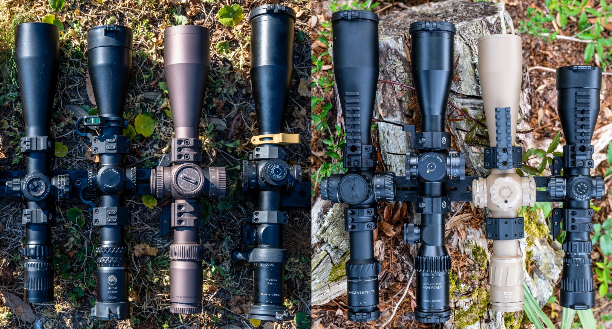

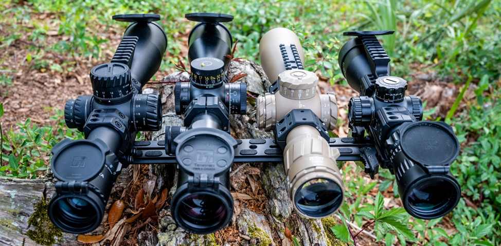

    THE SCOPES​
    Tangent Theta 5-25x56, ZCO 5-27x56, Schmidt & Bender 3-27x56, Schmidt & Bender 5-25x56, Vortex Razor G3 6-36x56, March Gen2 5-40x56, March 4.5-28x52 and Burris XTR III 5.5-30x56
    Why only these, how come brand X or model Y aren’t in here, well plain and simple I am limited on funds and I have to purchase most of the scopes for my reviews, so I’m limited to my own personal collection as well as what may interest me at the time so I do apologize if a scope you were really hoping would be included is not in here, maybe a possibility for a future review… True - the Burris XTR III 5.5-30x56 is not an "alpha" class scope, but I thought I'd include it mostly because it was my rimfire trainer scope prior to this review and I was curious how a $1k class scope would compare to the alpha class which cost a considerable amount more.

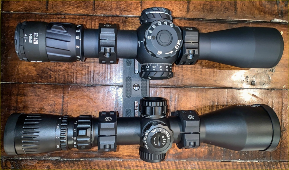

    A couple years ago I reviewed the March 4.5-28 alongside the Tangent Theta 5-25, not because I thought it would be a “fair” comparison but out of curiosity to see how well the March could hold against what many consider to be one of the best scopes on the market today. I also had the March with my ZCO 4-20 and am providing those two images below to give you an idea of the size comparison, what is unique with the March is that it is the only “ultra short” scope out of all these reviewed here which does put it at somewhat of a disadvantage (short focal length scopes with high magnification erectors tend to be more finicky with eyebox, DOF and Parallax).
    Keep in mind this evaluation is based on my own personal observations based on what my eyes “see” when looking through the scope. I pay meticulous attention when setting up my diopters for each scope making sure to fine tune them to my eye. My eyes are very sensitive to CA while some people cannot or have difficulty seeing CA when looking through the same scope. Everyone’s eyes are different, and my observations will undoubtedly be different from others. That being said, I try to be as objective as possible but, like all of us, do have my bias’, though I try my best to inform you of my own personal preferences so you can make judgement calls based on your own preference. It should also be noted that I am not paid by anyone to do these reviews, I do have some relationships with dealers and some manufacturers that help out some, but by no means am beholden to any particular manufacturer and those that I do work with are well aware of this. Special thanks go out to Mountic Oudtoors @MOUNTIC (https://mounticoutdoors.com/) who is a Hide sponsor and dealer in Tangent Theta, ZCO, March, Manners, Spuhr and more, I’d also like to thank Jason at eurooptic.com with the Schmidt 3-27.

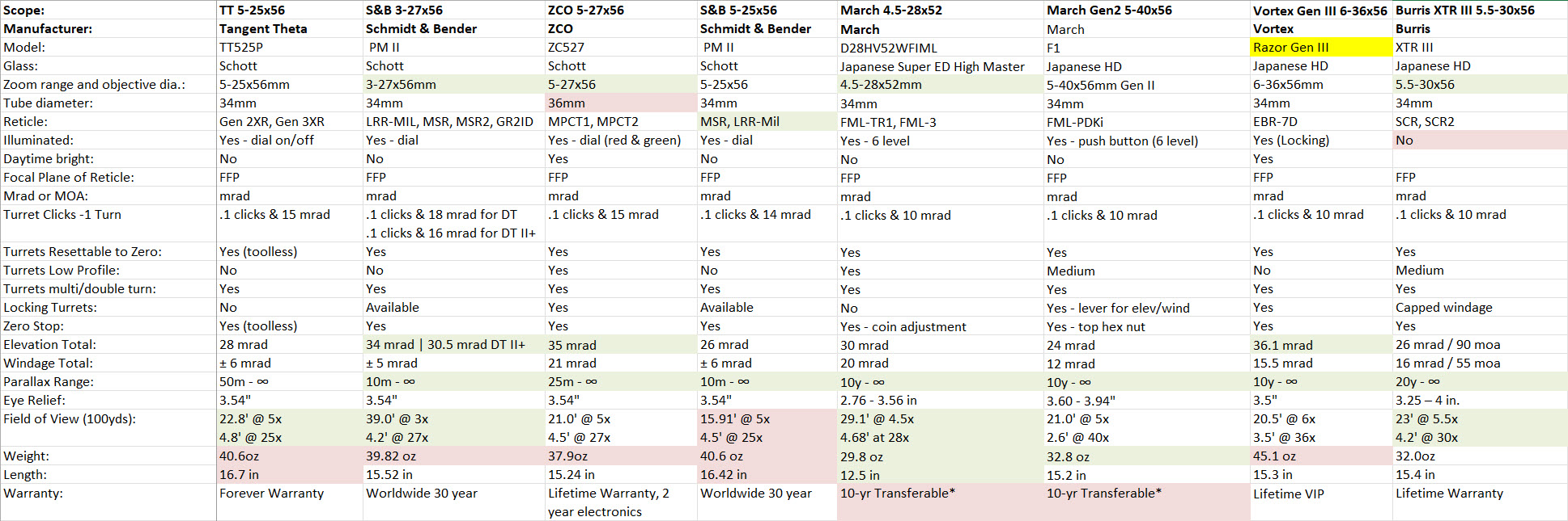

    SPECS​
    The below specs are provided by the manufacturers which provides a good baseline for what these scopes offer. Vortex is highlighted in yellow as it is new for 2022. Highlighted in red is a potential drawback and in green is a potential benefit.

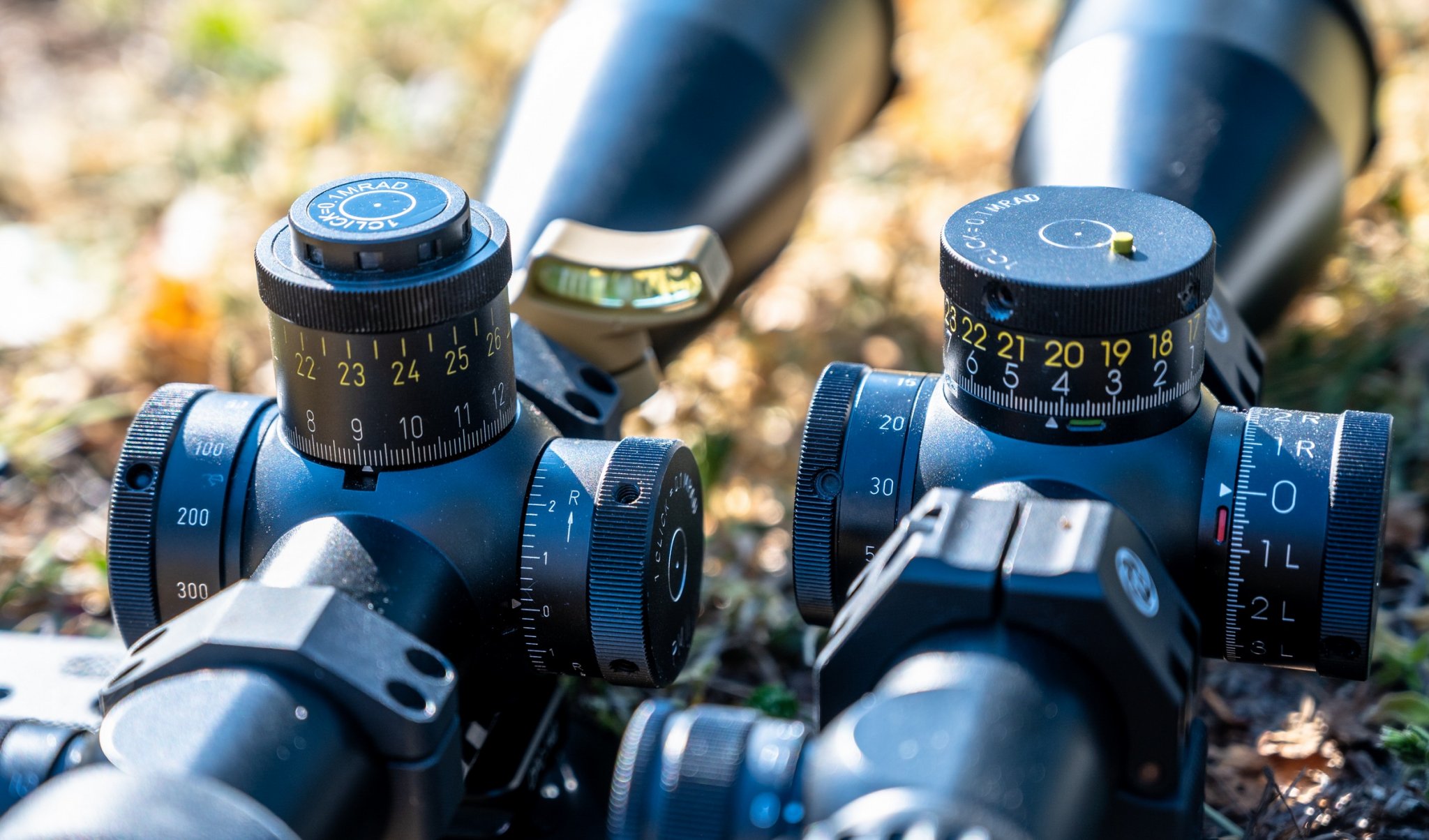

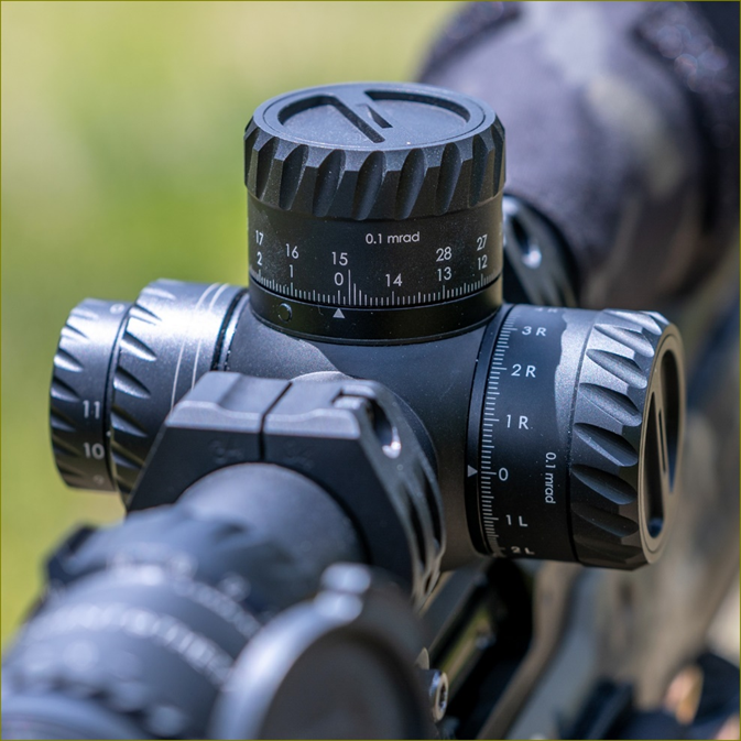

    TURRETS​
    This review does not cover the accuracy of each scope but covers the functionality – since any manufacturer is capable of producing a lemon it’s always a good idea to test your scope to ensure its mechanical accuracy.

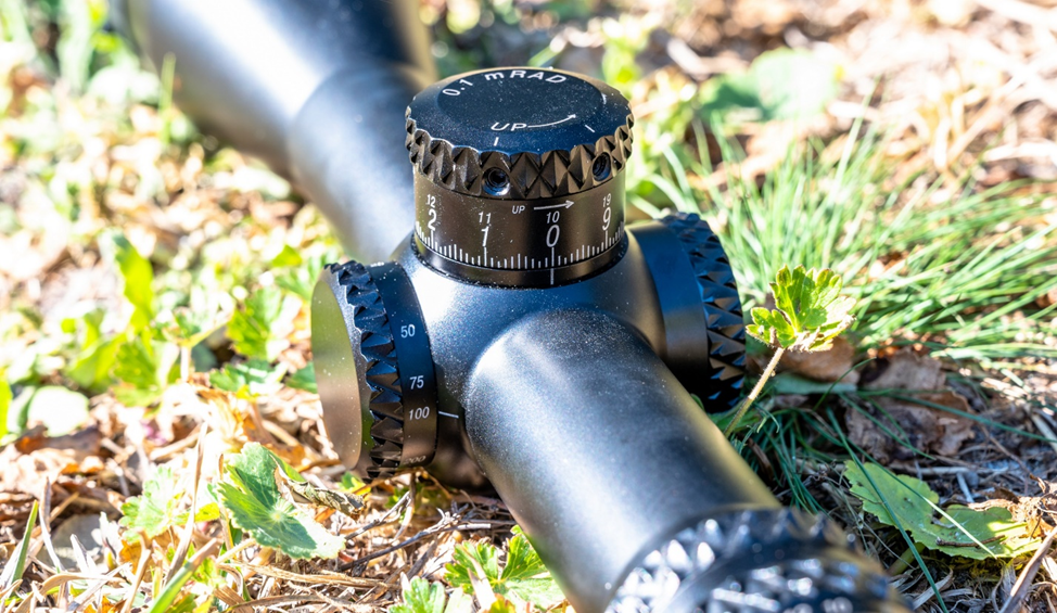

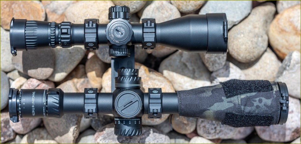

    Tangent Theta​
    I wrote the following in my previous review and will repeat it here - I have never considered myself a turret purest, having had many other scopes by numerous manufacturers over the years I could never quite understand what the “fuss” was all about with regard to turret feel. My general rule is – can it get me where I want to go quickly? If the turret can do that and is repeatable then it is a win in my book. That being said, I have experienced some somewhat lackluster turrets that leave much to be desired, so I assume we all have a threshold we are willing to accept. All that being said, if turret feel is your game, then Tangent Theta owns it – very distinct, no play whatsoever and a nice clunk between each .1 mrad gives you a sense of confidence anytime you spin the elevation or windage. Keep in mind these are 15 mrad per rev, and sometimes the spacing can be too tight when mfr’s try to pack so many clicks into one rev, but TT decided to give you something more akin to a Ferrari stick shift to grab onto – it is meaty and with a diameter that allows for refined spacing throughout the 15 mrad of travel for each rev. Another unique feature is the toolless zero, something else that is unmatched in the industry. Have you ever found yourself at the range and forgot that tiny little hex wrench? What usually follows is #@&^%#$. With the Tangent you simply use your fingers to loosen the top plate of either elevation or windage and then you pull up slightly and spin to wherever zero is, push back down and tighten the top plate, that’s it, no hex wrenches needed. The Zero stop is always .5 mrad under 0 so this is automatically set wherever you set zero. Something I wish every manufacturer would introduce and if you don’t have that feature then do what Kahles did and stick a magnetic hex wrench inside the illumination battery cover so you have easy access in the field. My one and only complaint is that for such a massive turret housing, TT opted to put little tiny numbers, for young eyes this may not be a big deal, but ZCO got this one right with their large numbers and bold lines, something I wish TT and others would offer. Having had several Tangents now I can say they still reign supreme but that mountain is being climbed by other manufacturers (see below) that some may consider just as good if not better than TT. Turrets are non-translating which means the turret does not rise or fall when spinning through the different revolutions.

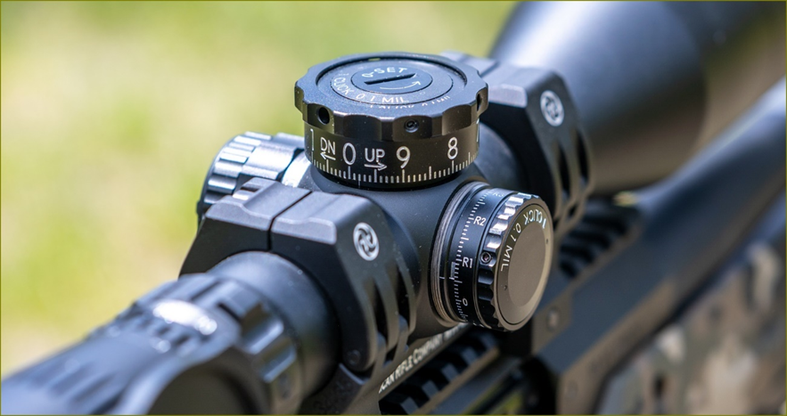

    March FFP Gen II 5-40 turrets​
    Having reviewed the March 5-42x56 HM a couple years ago I fell in love with those turrets, not just for their locking mechanism but for the superb feel that is one of the closest to Tangent Theta I have felt to date. March has essentially put the same turrets in the 5-40 scope and labeled it “Gen II”, like the 5-42 turrets before, these turrets excel with extremely positive clicks and nice wide 10 mrad per rev spacing, even if you do not need the locking mechanism, these turrets are a refinement over March’s standard turrets that is hard to describe – it is a very distinct click with excellent audible feedback. The locking mechanism is unique and sits atop the turret as a lever that you can switch on to lock or switch off to allow it to freely spin, both elevation and windage share this design which is an advantage. I prefer this (and Schmidt’s DT II+) design over the up/down mechanism of the Vortex and ZCO. To set the zero stop there is a small hex nut at the top of the turret that you tighten but be careful not to over torque, my only gripe is that if you don’t tighten far enough it is easy to move past the zero desired which may limit its repeatability. Turrets are translating which means the turret rises and lowers when spinning through the different revolutions.
    Schmidt PM II 5-25 DT turrets​
    These represent some of the traditional turrets that Schmidt has offered for a while, they are somewhat muted and close together, but no noticeable play between clicks. Setting your zero is done through traditional hex screws on the periphery of the turret. Turrets are non-translating which means the turret does not rise or fall when spinning through the different revolutions.

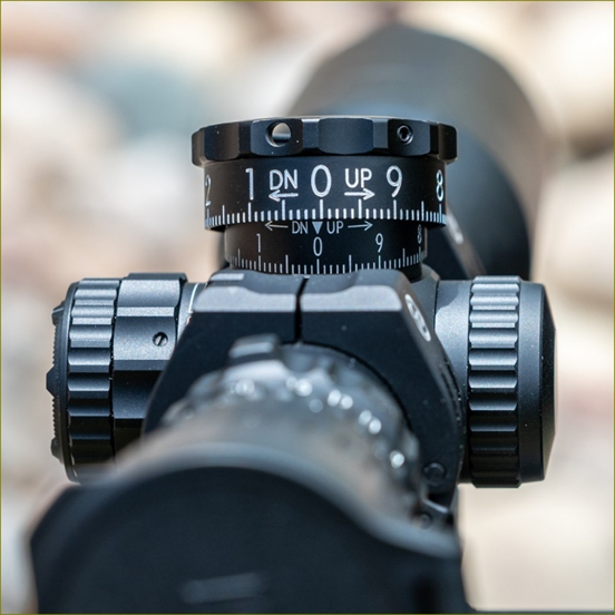

    Schmidt PM II 3-27 DT II+ turrets​
    These turrets are completely different from the traditional design Schmidt has offered in the past, they are somewhat lower profiled and a bit larger in diameter, but the main difference is in how they function. These turrets have a very solid and distinct click value with minimal play between clicks – Schmidt engineers did their homework on this one. The added benefit of the DT II+ system is you have a lever for both elevation and windage that allows 3 settings: Locked, Unlocked with MTC and Unlocked without MTC (for those who may not know, MTC stands for More Tactile Clicks which means every full mrad value the click is stiffer than the rest providing a “more tactile” response). When in the locked position there is no play or movement in the turret. It should be noted that I had issue with previous generation MTC turrets, the full mil stronger click was so strong it would cause me to inadvertently overtravel by .1-.2 clicks coming out or going back (for example: if I had a solution of 5.1 mils I would overtravel to 5.2 or 5.3 and would then have to dial back causing delay) the DT II+ MTC has rectified that and feels like the ideal resistance without having to jump forward to get out of the full mrad value. The Schmidt turrets are non-translating which means the turret does not rise or fall when spinning through the different revolutions. I would rate these turrets as the best yet from Schmidt and Bender and arguably close to Tangent Theta in quality.

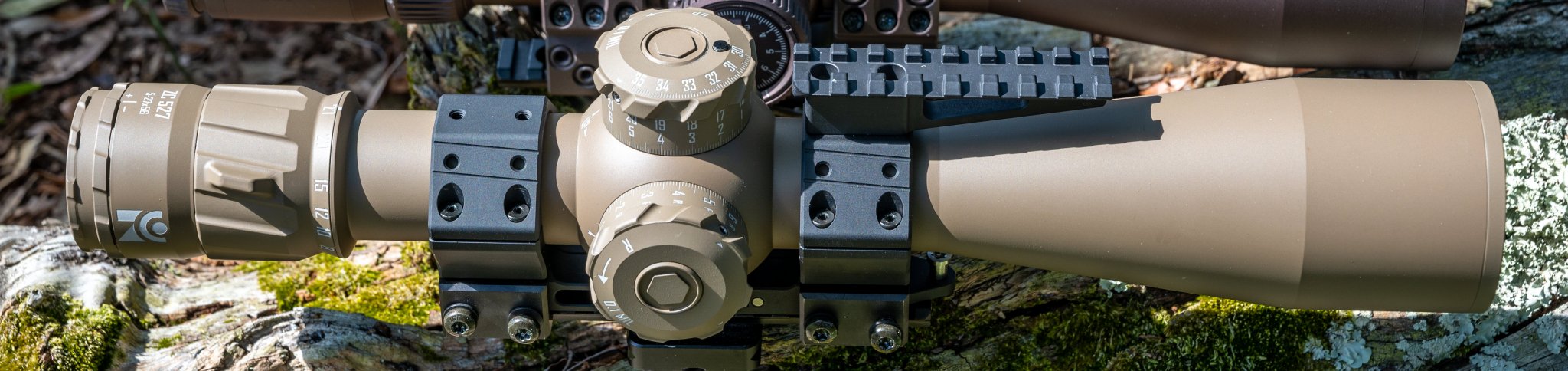

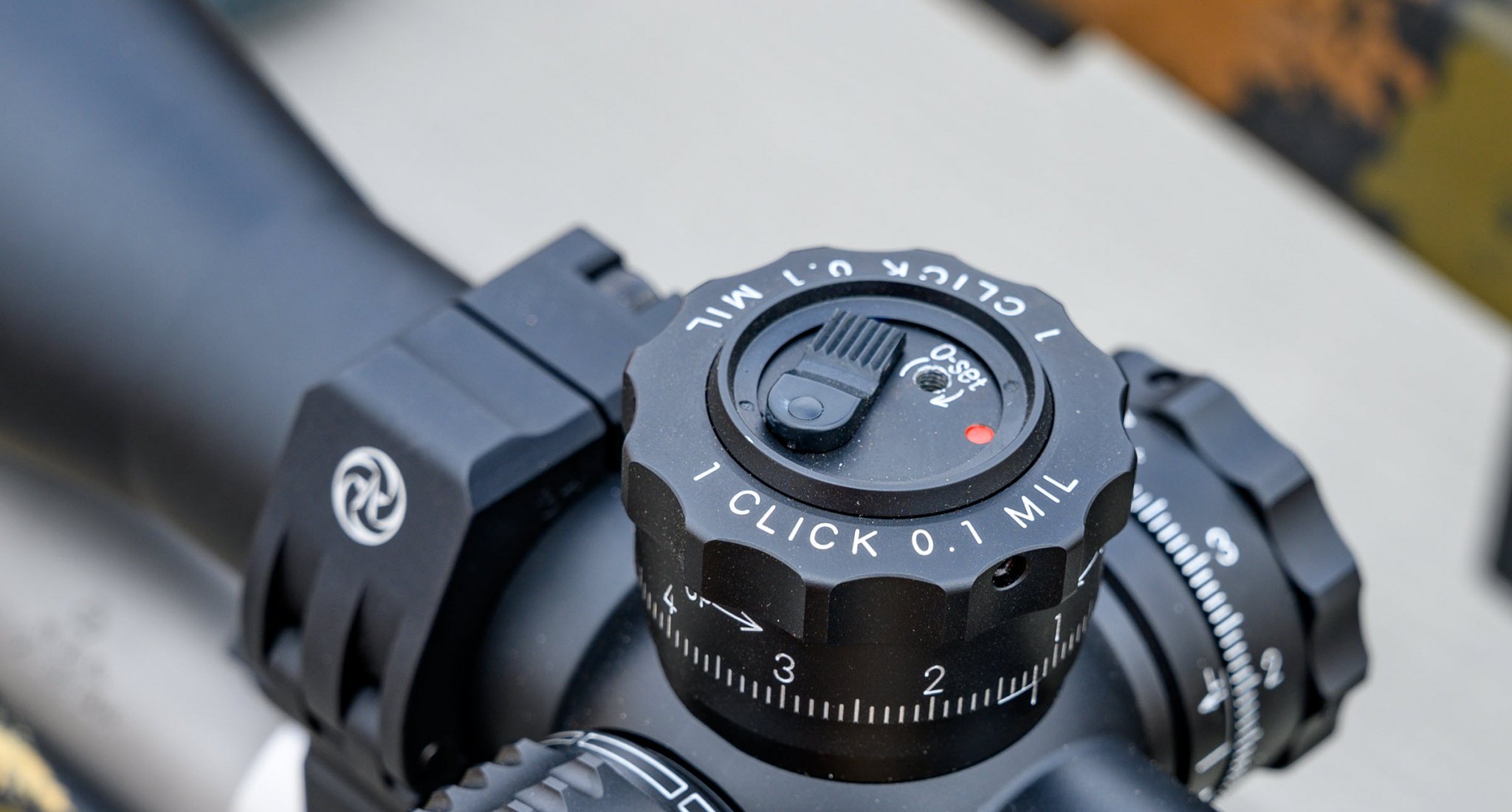

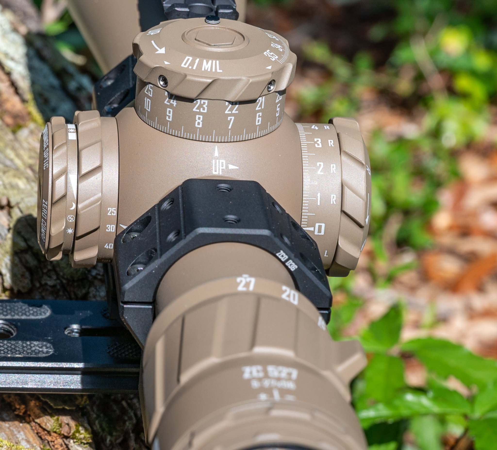

    ZCO 5-27 turrets​
    ZCO offers a double bearing design that is supposed to provide more even clicks throughout the travel. The clicks are slightly muted, a little soft (compared to the best) with slight play but very accurate where each click lands. ZCO offers a locking mechanism where you have to pull up on the turret to unlock and spin and then push down to lock. Recently ZCO has offered a non-locking design called NLE (Non-Locking Elevation) which is preferred by some. Turrets are non-translating which means the turret does not rise or fall when spinning through the different revolutions. Overall the turrets are very nice but not at the level of TT, Schmidt DT II+ or March (from this review).
    March 4.5-28 High Master turrets​
    Having owned some March scopes previously, I had an expectation the turrets would be about on par with that experience; however, I have been pleasantly surprised with the latest turrets from March as they have very little play and very distinct clicks. An interesting feature that March has had for a number of years is the 0-Set (or Zero Stop) which is “almost” toolless – if you have a coin or a key in your pocket you should be able to turn the 0-Set to define your zero stop after you have reset zero which does take a 1.5mm hex key. While it’s not toolless, and it’s not like Kahles with the key hidden in the illumination cover, March does give you a little key chain sized hex tool that doesn’t take up too much room on the key chain. The zero stop is a friction design and can have overtravel if you twist hard enough, but most of the time will fall on where you’ve set it. The windage does come capped on the 4.5-28; however, it does have a nice feel so those who prefer to dial for wind can simply remove the cover to have a nice exposed windage turret that is still big enough to grab and spin even if gloved. Turrets are translating which means the turret rises and lowers when spinning through the different revolutions. Something else unique to the 4.5-28 scope is that March is providing a larger diameter turret shroud that can be bolted onto the fixed housing, I do prefer the larger numbers and diameter but because the turrets are translating I’ve found it makes it a little harder to determine center unless you are completely centered behind the scope.

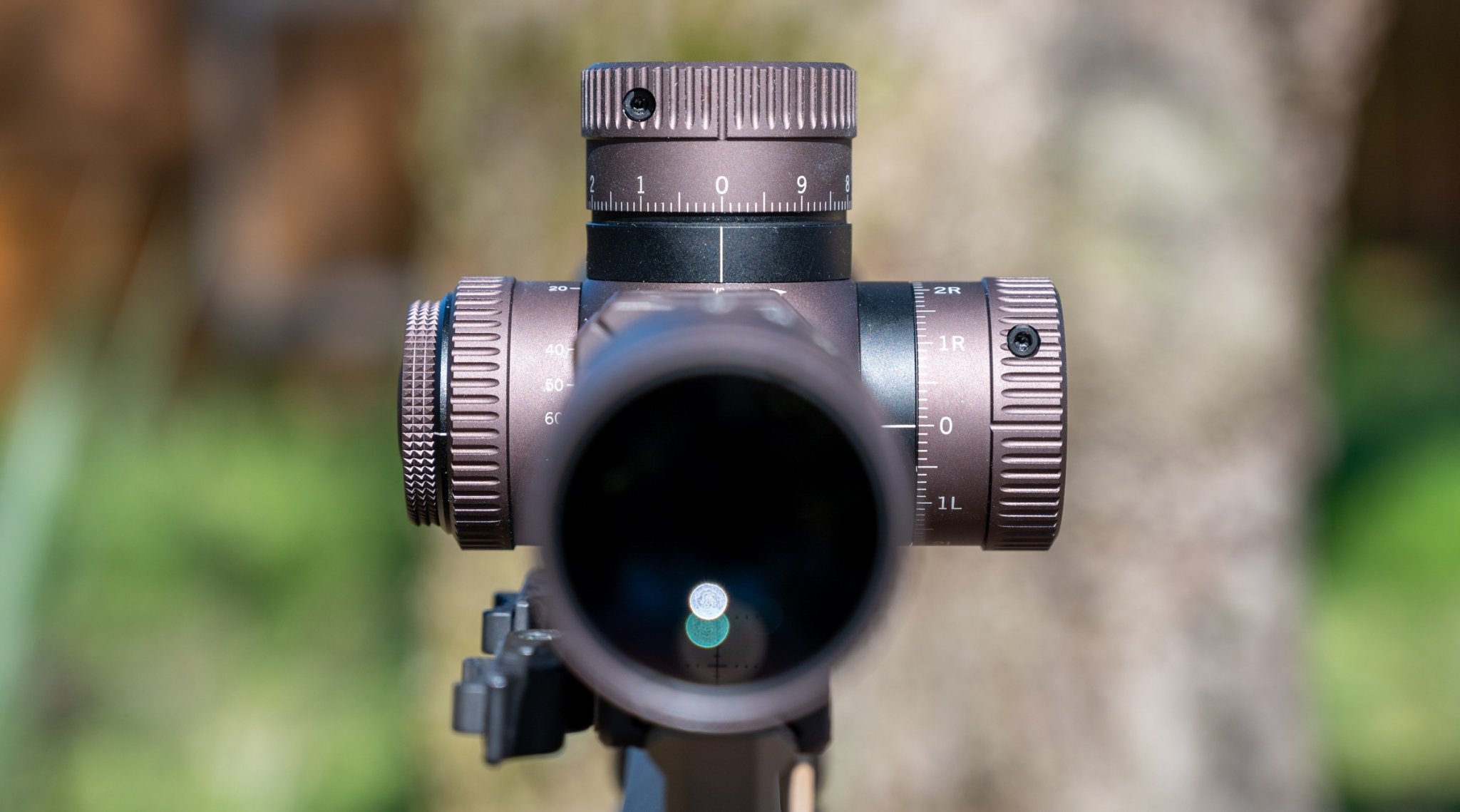

    Vortex Razor HD Gen III 6-36x56 turrets​
    The Razor Gen III represents the top of the line scope from the vast array of scopes that Vortex offers to the public. Similar to ZCO, Vortex offers a locking mechanism that must be lifted up to unlock and spin and then pushed back down to lock. There have been a number of complaints from the community on the inconsistency with turret function and feel between scopes, something it would seem Vortex is trying to rectify through their stellar warranty program; however, even after servicing - my turrets are still pretty muted, a bit mushy and with a slight bit of play, but they do manage to fall on the appropriate hashmark each time. These turrets will probably not win any awards, but they do get the job done which is what matters most. Turrets are non-translating which means the turret does not rise or fall when spinning through the different revolutions.
    Burris XTR III 5.5-30x56​
    Resistance is a bit tight on the USA model I had for this review, that along with the sharp knurling can make for a somewhat uncomfortable experience when spinning these turrets. They do have a good sound and there is slight play in between clicks. Turrets are translating which means the turret does rise and fall when spinning through the different revolutions.
    Turret Mechanical Assessment criteria (ratings: = (equals) > (greater than) ranked highest to lowest):​
    Turret Click Spacing Ranking:​
    March G2 5-40 >= TT = SB DT II+ > March 4.5-28 >= ZCO > Burris XTR III > SB DT > Vortex G3
    My rankings for turret click spacing have to do with both the distance between clicks and the resistance between those clicks. This is more or less a personal preference, but my hand feels better with wider spacing and good resistance but not too much.
    Turret Click Feel Ranking:​
    TT = SB DT II+ = March G2 5-40 > March 4.5-28 >= ZCO > Burris XTR III > SB DT = Vortex G3
    This can be very subjective, but I am drawn to more distinct click feel and audible feedback with very little play between marks.
    Turret Alignment Ranking:​
    TT = SB DT II+ = SB DT > ZCO = Vortex G3 > March G2 5-40 = March 4.5-28 > Burris XTR III
    I define turret alignment by the ability for the turret hash marks to fall directly on the indicator mark and not being offset while running the turret out to the extreme and back. Because of the nature of translating designs, they do rise pretty high above the center mark which gives a slight perception you are off mark if your eye is not perfectly centered. I much prefer the non-translating designs that do not rise and fall so preference is given for these designs.
    Turret Reset Zero and Zero Stop Ranking:​
    TT >> March 4.5-28 > March G2 5-40 > Vortex G3 > SB DT II+ = SB DT = ZCO = Burris XTR III
    In order to reset zero on the March, Schmidt, ZCO and Burris scopes you have to loosen the side hex bolts on the turret housing, then spin the turret to align zero and re-tighten, this is typical of most long range scopes today (zero stop on S&B is around 0.6 mrad below, ZCO is 0.5 mrad below and I can’t remember with the Burris and have since sold the scope) and is only bested by the toolless design of the Tangent Theta turrets. March offers the coin/key adjustable zero stop mechanism on the 4.5-28 and a hex key adjustment on the G2 5-40; however, some may find an issue as this feature does not always stop below zero at the same spot – depending on how much torque you give it (with your fingers) you may stop short or overtravel from where you intended to set the actual stop. Tangent is always fixed at .5 mrad below zero and that is something you can count on every single time which has its advantages for night shooters and those who prefer to count up after hitting the stop vs. visual recognition. Vortex is unique in that the Razor G3 turrets are zeroed by loosening one hex head screw and then turning the center of the turret, there aren’t clicks when turning the center of the turret so you can set it exactly where you want for a precise zero (zero stop is always 0.5 mrad below zero), you can even mark the center dial for switch barrel platforms to easily change zero between barrels.
    Total Travel Adjustment (Elevation) Ranking:​
    Vortex G3 36.1 mrad > ZCO 35 mrad > SB DT II+ 34 mrad > March 4.5-28 30 mrad > TT 28 mrad > SB DT 26 mrad = Burris 26 mrad > March G2 5-40 24 mrad
    Pretty self explanatory. There is variation of windage adjustment but as I almost exclusively hold wind with the reticle, this does not play a factor for me and therefore is not evaluated (however, the spec sheet above shows the exact amount for each scope for those who are interested).
    Turret Locking Mechanism Ranking:​
    Schmidt DT II+ >= March G2 5-40 > ZCO > Vortex G3 > Burris – NA = March 4.5-28 – NA = Schmidt DT – NA = TT – NA
    Some of these scopes do not offer a locking mechanism so I am going to rank them NA (Not Available). The Schmidt DT II+ and March G2 5-40 locking mechanism is the best I’ve seen as they allow you to turn the locking feature on or off with a mechanical lever separate from the turret housing itself; whereas, the locking mechanism of the ZCO and Vortex G3 are the pull up to unlock and push down the turret to lock, this method can “fall” into lock depending on how you spin the turrets, of these two the ZCO feels to be more distinct and possibly has less ability to “slip” vs. the Vortex.
    Overall Turret Mechanical Assessment Ranking:​
    TT >= Schmidt DT II+ >= March G2 5-40 > March 4.5-28 >= ZCO > Burris >= Vortex G3

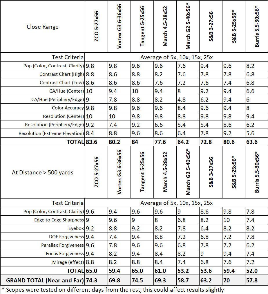

    Optical quality Test Results (higher numbers are better)​
    Field of View (FOV) in mrad​
    We can look at most manufacturers specs and see that scope X offers XX feet at bottom magnification and XX feet at top magnification at 100 yards. This is great for knowing the extremes of your scopes magnification range, but what about in between, the results are not always linear. Some scopes have pretty poor performance at the bottom but end up doing much better than other scopes at the top (NF ATACR scopes are notorious for this). I should note that the diopter can have an effect on how much (or how little) FOV is seen; therefore, the results for each shooter with different eye correct may yield slightly different values. My measurements here are from setting up each scope for my eye and then using my spidey senses to determine how much mrad of the reticle can be seen at a given magnification. Measurements were taken using the magnification indicator listed on the magnification ring and is prone to error due to mfr tolerance as well as my own ability to set perfectly. As such, take these values as a “general” rule, not as a hard fast rule.
    UPDATE 09/16/2023: I've had the FOV values confirmed for the ZCO 5-27 +/- 0.1 mrad which tells me that the FOV numbers given for ZCO on their website are not correct, based on the AFOV (apparent field of view) calculations, the ZCO should be at 23.20° while the TT is at 22.92° and S&B 5-25 is at 21.48°, of these three, the ZCO has the highest spec but multiple sources owning the scopes are measuring the width between ZCO, TT and Schmidt and both TT and Schmidt are showing higher FOV. This is purely conjecture but this may be because ZCO is manufactured in Austria and it was discovered that Swarovski (an Austrian company themselves) has a patent in Europe and in the USA which may hinder scopes imported from Europe to the USA utilizing a wide angle eyepiece. The patent was apparently challenged by Leica in Europe and they won so the patent is not enforceable there; however, no one has been willing to challenge the patent in the US thus far. This came to light mostly with the new Schmidt & Bender 6-36x56 and if you look on Schmidt's spec page on their website they show the USA version of the scope to have 21.66° AFOV while the same scope anywhere else in the world has a much wider 25.8° AFOV. Oddly enough, the brand new TT 7-35 scope, while being a newer design has a narrower FOV spec vs. the 5-25 and if you run the numbers you find it is right at 21.66° which is the same as the neutered USA version of the S&B 6-36. So how did the TT 5-25 and Schmidt 5-25 get to have wider FOV, and I'd venture to say that since the TT is an inherited design from Premier Reticles and the Schmidt design is from circa 2005, they predated the Swarovski patent (which apparently went into effect around 2010). Keep in mind these AFOV numbers are being calculated by the top magnification and are not always linear as you move to bottom magnification.
    The below values are from center to edge
    MagMarch 4.5-28TT 5-25ZCO 5-27Vortex 6-36S&B 3-27S&B 5-25March 5-40Burris 5.5-30
    5xNA33 mrad33.2 mrad*NA40 mradNANANA
    10xNA20.5 mrad18.1 mrad*21 mrad20 mrad19.5 mradNA20.8 mrad
    15x15 mrad14 mrad12 mrad*13.5 mrad?13.5 mrad13.2 mrad11.4 mrad13.8 mrad
    20x11.2 mrad10.6 mrad9.1 mrad*10.5 mrad10 mrad9.7 mrad8.5 mrad10.6 mrad
    25x9.2 mrad8.4 mrad7.8 mrad*8.4 mrad8 mrad8 mrad6.8 mrad8.4 mrad
    * I completely botched getting numbers for ZCO, not sure how I made that mistake but sold the scope before I figured it out (these numbers are provided by @Huskydriver who graciously spent the time to obtain what his 5-27 shows at each spot.)

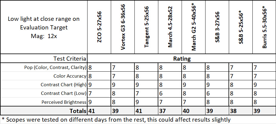

    Twilight Transmission (low light performance)​
    I set all scopes to 12x to allow for a larger exit pupil yet still give my eyes a challenge in the failing light. From about 20 minutes after sunset, I begin testing both scopes side by side as the evening becomes darker and darker. These results are very subjective and as I have aged I believe my eyes low light acuity has decreased. You may have very different results depending on your age and how good your eyes are.

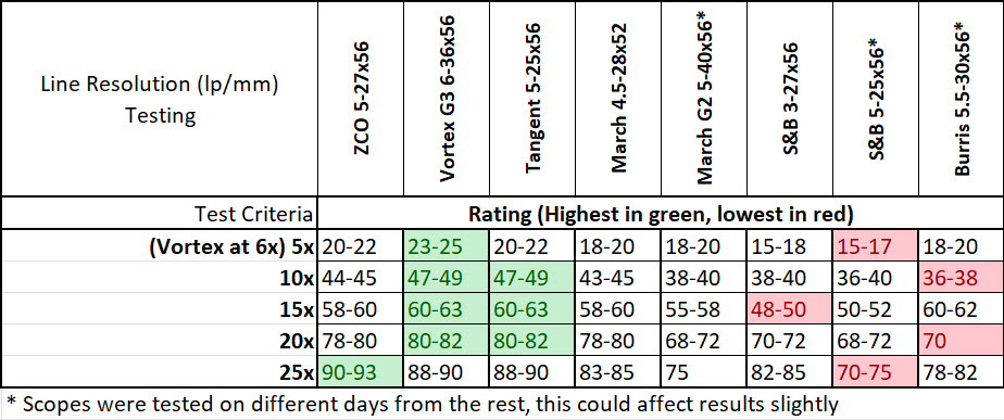

    Resolution Line Chart (LPI)
    It’s one thing for me to look through a scope and judge resolution based on a 1-10 ranking, but it’s quite another to look at line charts and determine how many lines I’m able to resolve at a given magnification, my resolution testing above is a good “first impression” but the line chart does not lie and provides a more quantitative result. For most results you’ll see a range – it is hard to resolve exact values with your eye and I would try to narrow it down as best I could but sometimes eye strain, perfect alignment, etc. would get in the way.

    Overall Optical Assessment Results:
    TT > ZCO > Schmidt 5-25 > Vortex G3 > March 4.5-28 > Schmidt 3-27 > March 5-40 > Burris XTR III
    There were a few surprises for me in my testing so I’ll try to comment on the rankings above. It is no surprise to me that TT came out on top, I have owned multiple TT’s and multiple Minox ZP5’s (a sister design to TT) and they have consistently outperformed every single scope I have put up against them, that is until this test where I found the ZCO to be practically neck and neck and the fact it is only 0.1 points behind the TT essentially says that on any given day it could equal or possibly outperform the esteemed leader in optical excellence. The big surprise was how well the 16 year old (design) S&B 5-25 came out, putting the tunneling aside this scope is still a competitor in this highly competitive field, I think of it like father and sons – where the Schmidt might show some wear and tear but can still teach the adolescents a thing or two, the Schmidt is definitely not past its prime and with the 2022 updates S&B has made to the 5-25, it has brought new life into this aging design. The next surprise was how well the Vortex faired against these big name and high price tag scopes, at around ½ the price of the TT, ZCO and Schmidt, this is the kid coming from the other side of the tracks and steamrolling through the defenders, sure there is room for improvement but Vortex found the magic formula with this optical design which has proved to be the best glass I’ve seen from Japan to date, and that brings us to the other Japanese scope maker whose name has become synonymous with quality – March. The March 4.5-28x52 is the shortest scope of the bunch and has the smallest objective as well, this would put it at a deficit from the get-go but this scope performs more like the “Little Engine That Could”, puff, puff, puffing it’s way up the ranks and beating out several other scopes. I would say the biggest disappointment comes from the Schmidt 3-27, looking at MSRP this is the most expensive scope of the bunch at $5500 and I expected optical performance to match this price tag; however, one must also consider this scope has the highest erector magnification range of any alpha scope out there, and while the Schmidt did not get as high points as many other scopes – no other scope can do what this scope can, and that is offer a very impressive 3x at the bottom end and 27x at the top, if you need a scope to do everything and don’t expect it to compete with the best of the best then I think you’ll be pleasantly surprised. The March 5-40 G2 comes in second to last compared to the rest of the alpha scopes which I consider it to be part of, it is still a decent contender and has some admirable attributes but it just can’t keep up with the other scopes in this class. Not much of a surprise, the Burris came in last, but given it’s price point (now under $1300 street) this scope shows outstanding price/performance which is why it is almost always at the top of my list for budget FFP scopes.

    ZCO
    I am not a fan of the 36mm tube, I understand they say it was necessary for uncompromised performance at max elevation, but I’m not convinced. Anyone who’s read my previous reviews of ZCO will know I am not a fan of the MPCT series reticles, this is very much personal preference, but I would sure like to see a less intrusive tree design. Every competitor offers some kind of scope caps, whether they be proprietary or Tenebraex but all ZCO offers is bikini caps, not saying I don’t like bikini’s but a little more coverage would be nice.
    March
    The first item that comes to mind is for March to design non-translating turrets, that is - turrets that do not rise and fall as you spin them up or down, almost every manufacture not named Nightforce does that these days. I would also like to see a similar locking turret design with larger diameter turret as is on the 5-42x56 HM. Get a brighter illumination module like so many other new scopes that have excellent low light quality with no bleed but also bright enough to be used when the sun is out, and a different design (illumination) for easier manipulation of settings especially if wearing gloves.
    Tangent Theta
    Get a daytime bright illumination module. Larger and more bold numbering and dashes on the turrets, maybe even reduce the height of the turrets. Reduce spacing on turrets to 12 mrad per rev and increase the travel to 36 mrad total. Tangent should invest in better multi-coating to help eliminate flare when the scope is pointed towards the sun, depending on position there can be significant flare and ghosting which shouldn’t be there at this price point, sure you can put on the ARD to help eliminate this, but many will not be using that part for most of their shooting – I would be happy to tell TT to not put an ARD that the majority of users never use in the box and instead use that money to invest in better multi-coating to prevent flare in the first place.
    Schmidt and Bender
    Get rid of that illumination tumor – oh wait, someone at Schmidt finally listened and a couple new models in 2022 offer illumination in line with parallax – left-handed shooters rejoice! The new 6-36x56 could prove to be a superb scope that has the potential to best them all, question is whether or not it actually will, we’ll have to wait and see as Schmidt is not known to be fast to production after models are announced.
    Vortex G3
    Fix those turrets. Well, some could argue that they work as designed, that is to say they do work; however, the feel and function seem a bit lacking compared to even the predecessor Gen2 model. Not sure who it was that thought a dog poo brown anodization color would be a hit, but most buy these scopes for their price/performance, not for their looks. Larger and more bold numbering and dashes on the turrets – take a queue from ZCO and Nightforce.
    Burris
    Get a daytime bright illumination module. Loosen up the mag ring and parallax, do some more investigation with your knurling and what is comfortable. When a customer says mag or parallax needs to be loosened – fix it, don’t just say it’s in spec and send it back.

    Next up - I had the Schmidt 3-27 side by side with a new March 3-24x52 with FML-TR1H reticle and a Nightforce NX8 2.5-20x50
    My reviews aren't for the faint of heart :LOL: They are designed to help put you to sleep at night...

    Thanks for the review. The only complaint i have about zco is the 15mil turrets. Its tough to tell exactly where you are on the clock and always cost me a few seconds to make sure i dialed right. Id gladly trade them for razor turrets. Everything else about it is on point.
