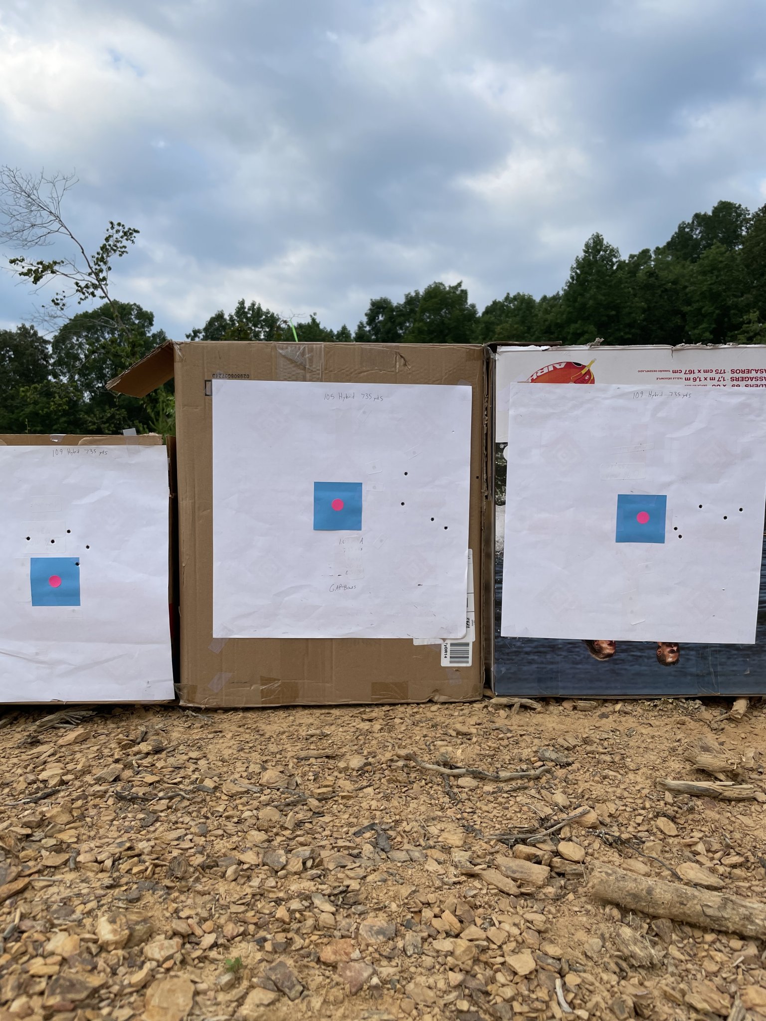

Last range trip I was able to resolve 6mm bullet holes in paper at 735 yards with the Razor G3 on 36x under ideal conditions. I’m not sure I’ll ever “need” better resolution than that.
Reactions: Glassaholic
No, resolving .15” holes in paper at 735 yards is spectacular.
I agree and I was amazed that it happened.
It was ideal conditions but still surprising. Bright white paper, on top of a clearcut ridge right at sunrise (zero mirage) and the sun hitting the targets. I’ve never looked through an “alpha” scope so I can’t understand someone being disappointed in the resolution of the G3. I purchased it from liberty optics and am not sponsored by Vortex so I have no reason to embellish the truth.
On 36x I could see all the holes in the white paper but not the one in the blue or the cardboard box.
