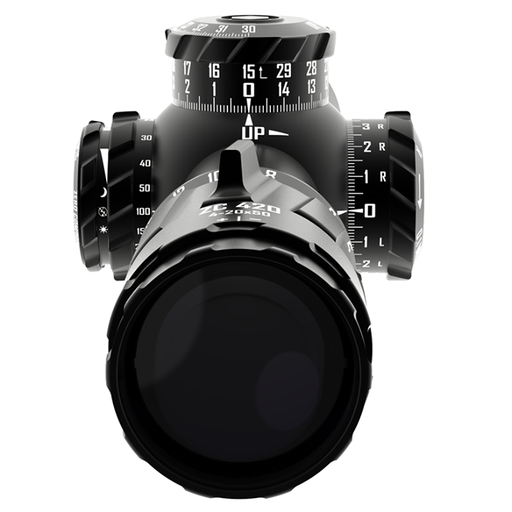

To be known as an Alpha scope is quite an honnour for the Designer/manufacturer.
But at the same time, much is expected from an Alpha scope and up here in Canada, that's a $5K scope !
Looks real good from this angle in the picture !

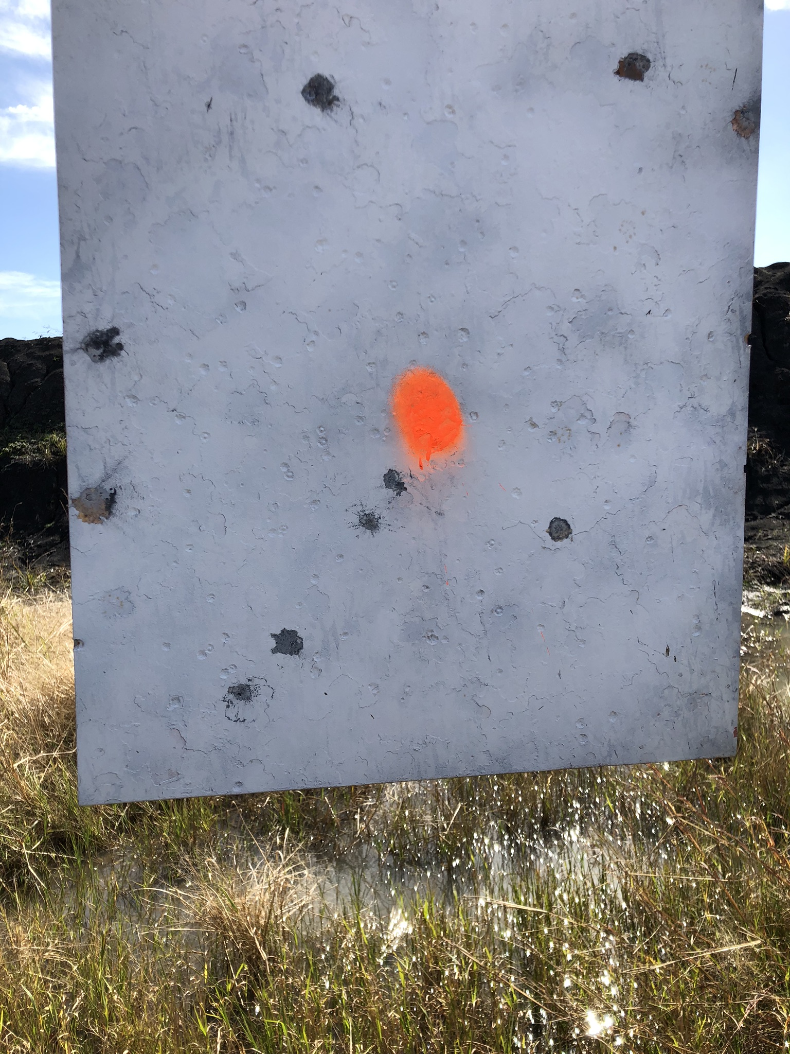

To me, this is the most important attribute of glass. It is the difference to me of being able to observe the direction of plate movement at 950 yards in mirage. I am not talking to the guys who say, 'this glass never caused me to miss a target'. Yes, I hear you dude. But this glass in this test is different. If you're reading, I'd assume you think this kind of investment is reasonable and worth it. To me, this sampling of scopes is some of the best on the market to choose from.
First, Schmidt is the gold standard for a reason. I think it is one of the best values on the market at this standpoint. It is incredibly clear especially now at the price point you can find them. It is very clear at 15 and a slight degradation as you increase power to 25. I found it held its own with the ZCO in a lot of ways. Everything was clear, detail is apparent and defined, and true to life representative of what is actually going on in terms of conditions. I am a big fan of schmidt glass.
IE: I have a 66% ipsc at 950 yards on our range that had a 2-3 " group on the shoulder and then had a full size ipsc at 1000 with a few scattered 6mm/ 223 (low energy impacts) shots on the belly of the target. I used all scopes at 15 and 25 x mag to observe during the afternoon, moderate mirage. For a base line of comparison - In a Gen2 razor or a Kahles 624i - I could make out one black blob on the 950 target, but unable to see anything on the belly of the 1000 (remember mirage). With the Schmidt - i can see the target borders clearly, minimal edge distortion, I can make out a large spot with slight differentiation of individual shots, but nothing finite, the shots on the belly are just faintly visible. I don't have to work hard to question they are there, but not as obvious as other options.
The ZCO picks these shots up a bit better with a touch more resolution while at 15 x, but it is nearly a wash between it and the schmidt at 25 x mag. The ZCO is impressive especially at 15 x in terms of clarity / resolution, but I found it left a bit to be desired while at 25 x. Full magnification gives way to very slight blurring on the target borders while introducing a bit of general fuzziness and less light transmission than the tangent. I would say it is very much in the range of clarity at 25 x as the Schmidt. I would still put both of these in front of a 7-35 ATACR in terms of clarity alone. But this is where the TT really exponentially separates out in front. I found most of the clarity to be similar at 15 power between the three, but still would give it to TT with the ZCO right behind it.
Tangent is still in another league in terms of clarity- I can see each individual bullet splash in that group as well as the scattered belly shots are all directly obvious. General vegetation is much more clear, and the plate boundaries are much better defined on 25 x. Compared to the other two. This is where the money goes in my opinion. Tangent glass has the most clarity not by a long shot, but obvious enough in mirage. It is like that moment you get behind swaro binos for the first time, and kind of forget you are looking through a device. Everything looks as it should, just magnified. Nothing is synthetic about the picture quality it's just quality crystal clear. The ZCO has a lot of that, but not to the same degree. All of them are elite. But once mirage is introduced, the TT is the clear winner as it gives me very 'useable' and layered mirage to scan through. You can do that with all of the above, but Tangent does it best making the least compromise on one specific quality.
