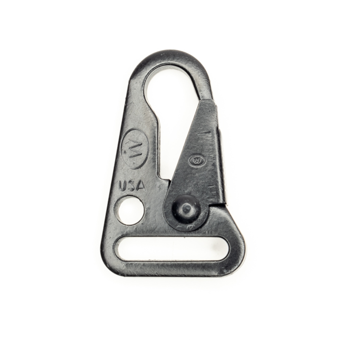

We all have been using HK style hardpoints on our gassers for years with none of the above issues.

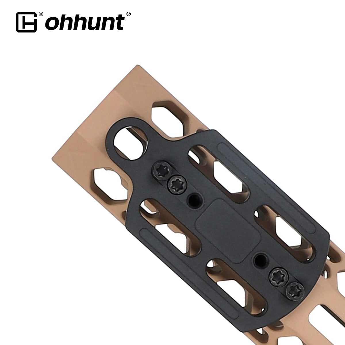

Standards for qd's can be rather loose. I've found ill-fitting qd/socket combo's between different brands. Here's some alternatives that I've been using.
Pic rail (or Mlok) mounted sling loop or

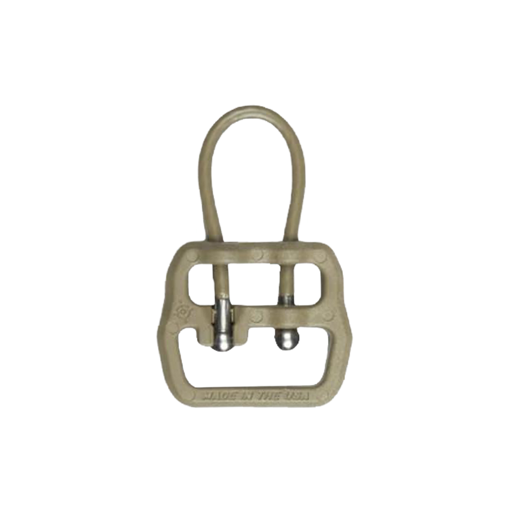

Already been using these with good results. User can position the front attach point in the best preferred position.
Would be a viable solution but not easily released/removed on demand if needed.
go old school and tie the sling to the rifle with paracord or bungie cord if you don't want to listen to the clanging sound of hk hooks. If quick detachment of the sling is top priority. Hk hooks and qd sockets are king in that realm. The only alternative I see would be a purpose made sling with ITW buckles at the attachment points. But imo, that would just be a rube goldberg solution to the qd's and hooks.
Already been using these with excellent results. Quiet, lockable and superior to the old style HK hooks in every way.

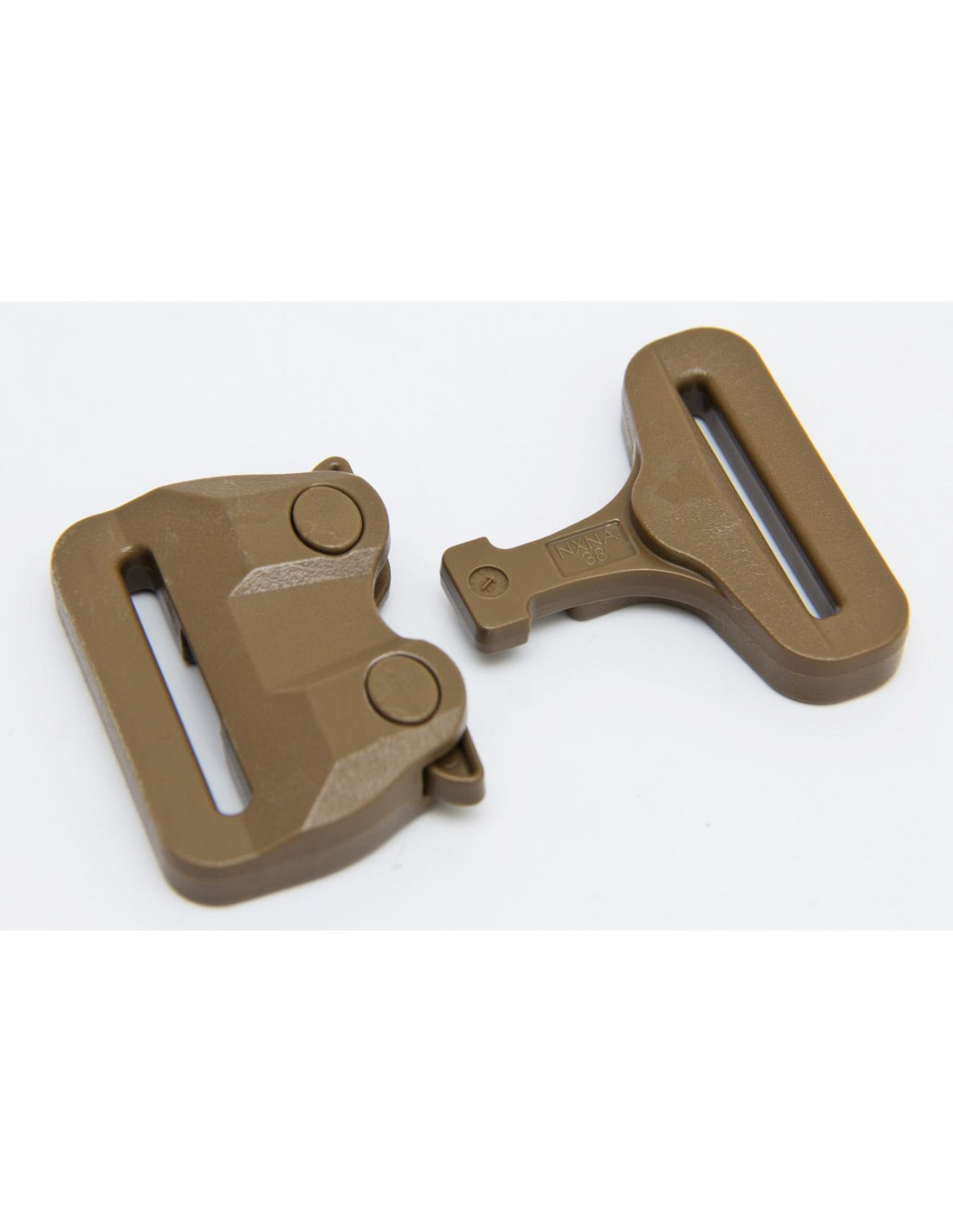

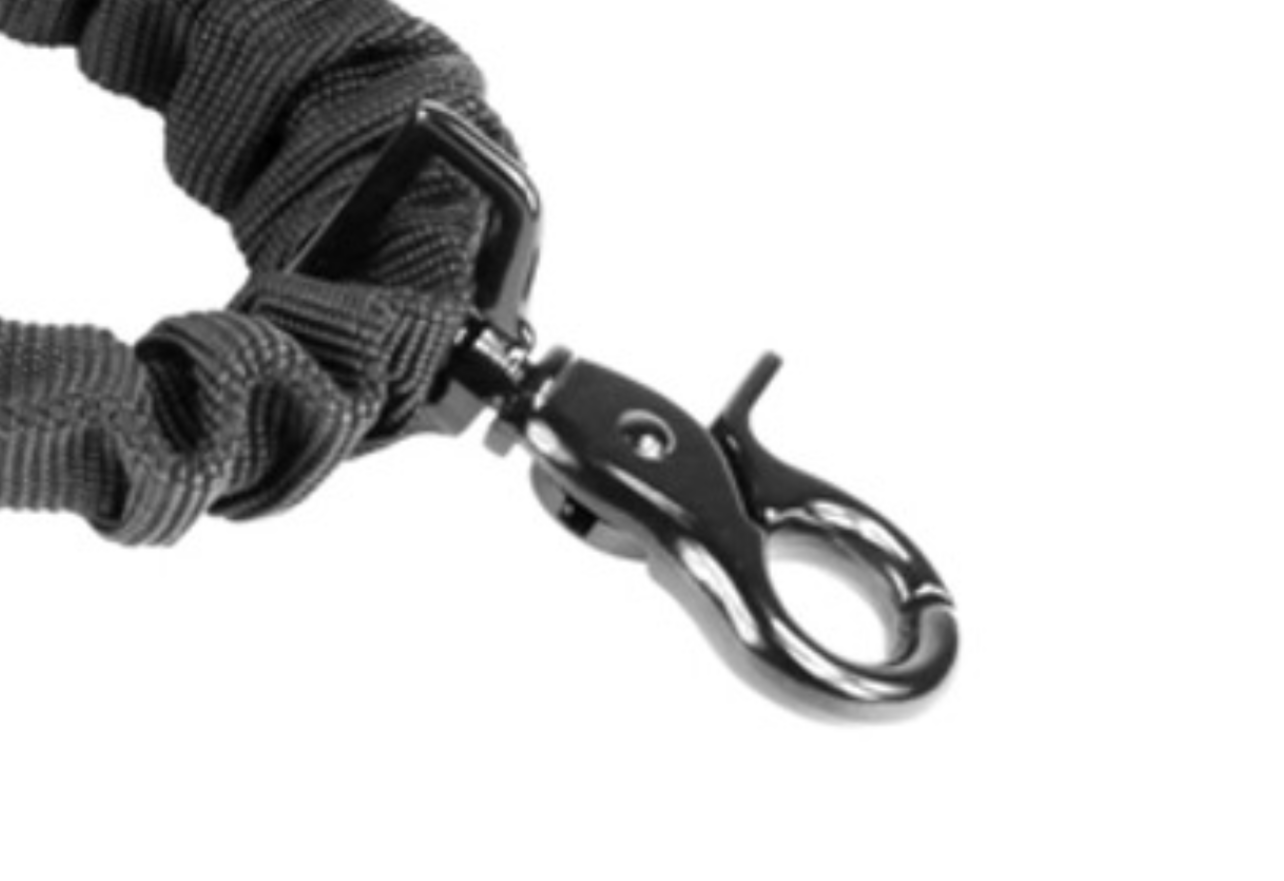

As mentioned above, the Para clips are seemingly the ticket.
I would just ship a set of 2 with each stock/rifle by default or at least offer them as an peripheral option when ordering.

If a guy were to incorporate an HK style hook that also accommodated a push button stud (as mentioned above) - it would be the best of both worlds.
Those have not been on my radar. But, it's been a couple years since I last looked on the sling market. Have you seen, heard of, or had any of those fail yet? I wonder how well the plastic holds up over time, exposure to the elements, and the wear and tear of usage.
But, integrating sling attachment points on the chassis would be a bonus in my book. Especially if a 6:00 attachment point can be integrated without interfering with a bipod.

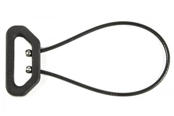

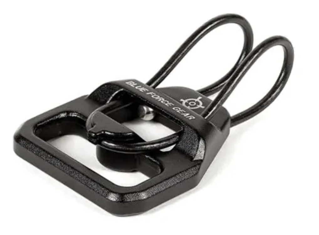

I am not a hard user, but even I have had failures in Grovtec push button/flushcups. I’ve sworn them off very, very recently and went to QD paraclip adapters for female flush cups, and MLOK paraclip adapters for, uh, MLOK.
On the sling I went to uLoops, which are NOT the old-style wire loops btw. They are also made by BFG, but are QD (not quite as fast as a flush cup, but fast-ish).
I haven’t used my new system enough to have an opinion on reliability.
ULoop below. See vid for how to quickly attach and remove from the gun.
Below, the BFG regular wire loop, slow to attach and remove as the wire loop is fixed.
I can't speak for years of usage yet but they have been doing nicely with 14 to 18lb rifle rigs getting banged around. That would include the occasional getting the rifle caught on shit and other shock/shear type spike loading to the part.
Not 100% sure of the construction. It appears to be some type of glass reinforced nylon/polymer material. May have some type of metal or glass spine that the part is molded around. I haven't cut one in two yet to find out.
Most of the material science seems to already be proven and hashed out with everything else including pistol frames, stocks, etc.

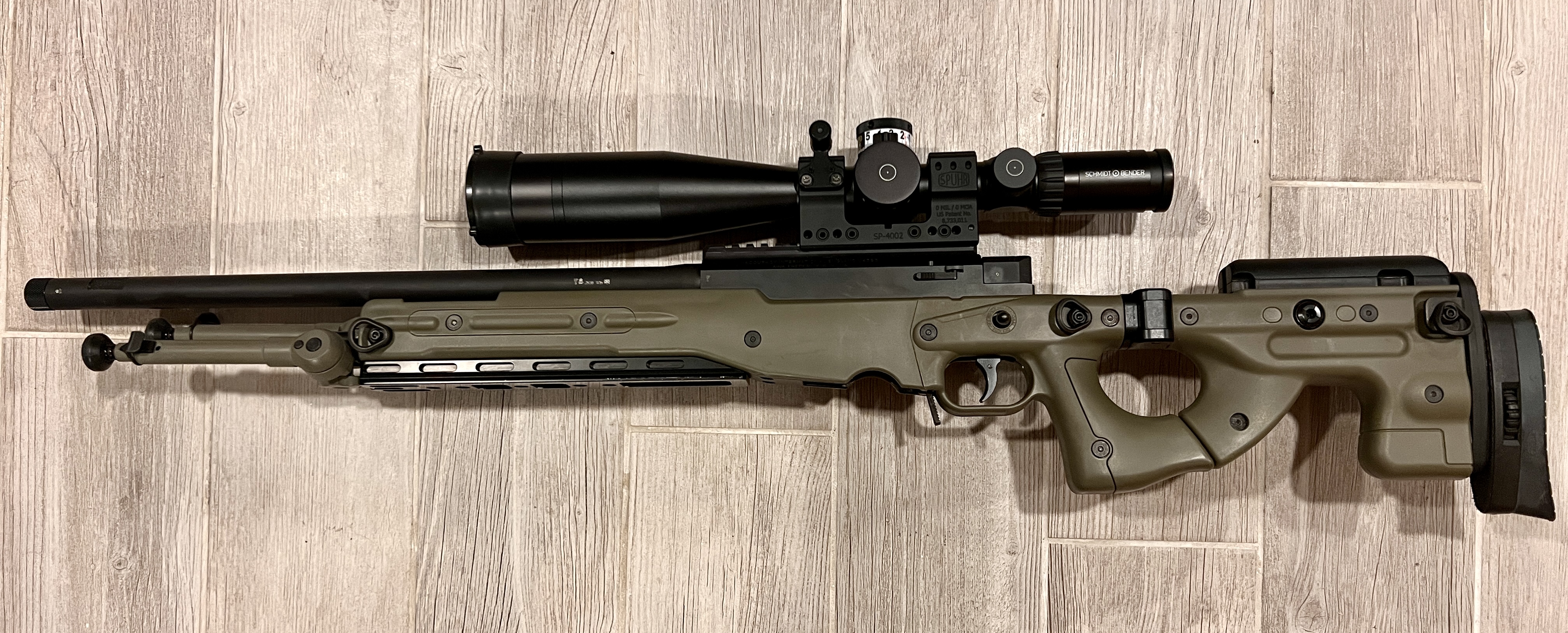

Not saying the paraclips are great-looking (flush cup versions here), but here they are on my AT.
The buttstock one is pointed down, otherwise it hits me in the jaw.

Huh. Mash hooks failed too? Never used those but they always looked pretty bomber. Dang.
The dog leash snaps simply lacked the spring tension
Do Hk hooks = dog leash hooks?
If my QD uLoops don’t pan out, I guess there’s always the metal BFG Belt-Fed Loops to try.

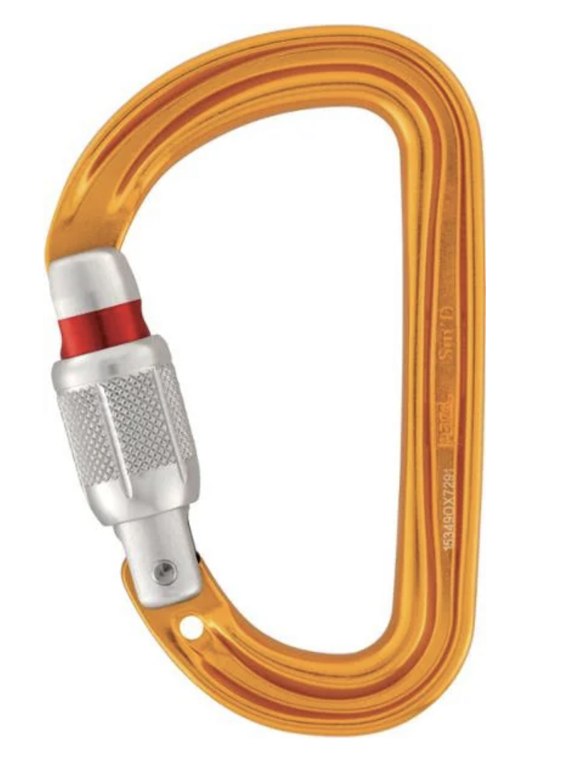

Or locking carabiners lol.

Reference the dog leash-better named snaps, popular with the single point bungee slings. On the Mash Hooks, they separate under hard use, like a key ring and it then eventually "unthreads" from the weapon mount.
Totally get what you’re saying. Just didn’t know if you were using maybe a generic name for HK hooks. Sounds like you’re not?
Just trying to learn something.
Maybe you mean these types of connections:
Those look sucky.
Those look sucky.

Your post about Fastex buckles made me remember Cobra buckles, and the fact that they partnered with ITW to also make a poly version.
No idea how great either the metal or poly versions are, but just throwing it out there for ideas.
Cobra buckles have many of the same issues as push buttons; debris, rust, hard to use in duress, etc. Very good for equipment that needs rated capacities in limited exposure. Not great for gear used throughout infil, on x, and exfil (personal opinion only).

I have not been recommending Cobra buckles on slings for work guns. The Cobras cannot be undone when under a load. If you are in a bind, it is entirely possible to not get enough slack to clink out of it.
If the user has to un-ass his rifle via popping the sling in half, Fastex is the way to go for me.
