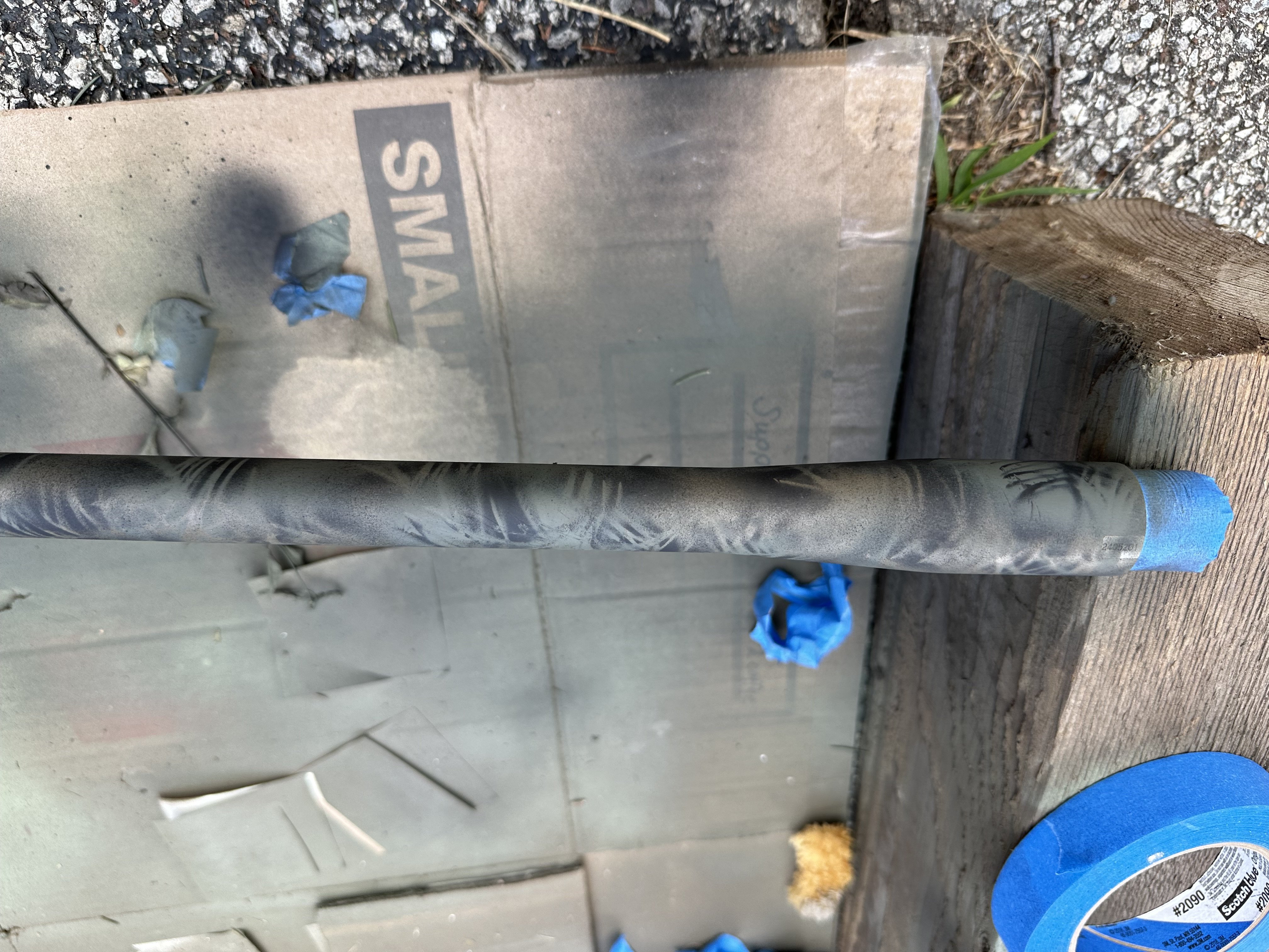

Blasted stainless Benchmark barrel MTU.
Degreased with Gunscrubber
Earth Brown color
3 coats with heat gun in between
Will hang for a few weeks
I shook the can for 5-7 minutes prior to each coat. Turned can upside down to clear pickup tube each time. Spun on an A2 flash hider to hang by 550 cord.

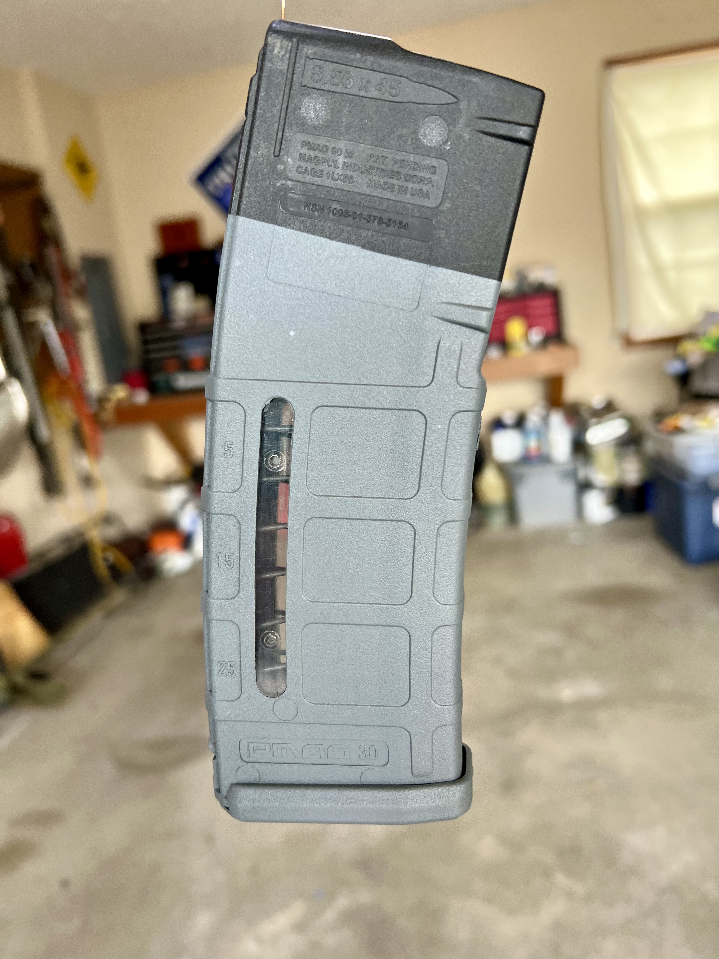

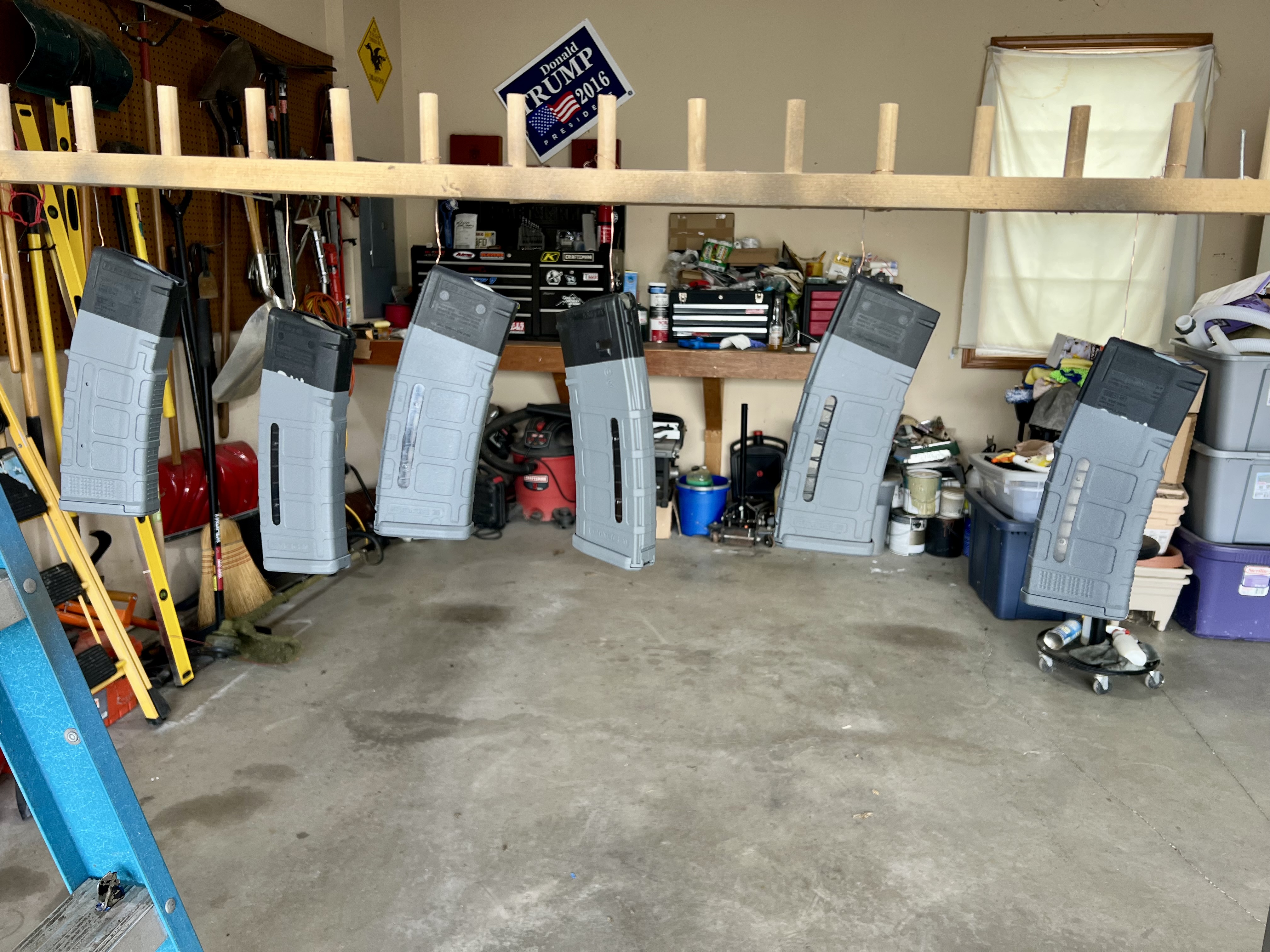

Now I have about 25 Pmags to spray....I'm just going to lightly wipe with acetone and spray. Hang by wires on a piece of metal mesh supported by a couple ladders or some shit. I want to do about 10-15 at a time with all the waiting periods between applications. I definitely will only do 2 coats on the mags.

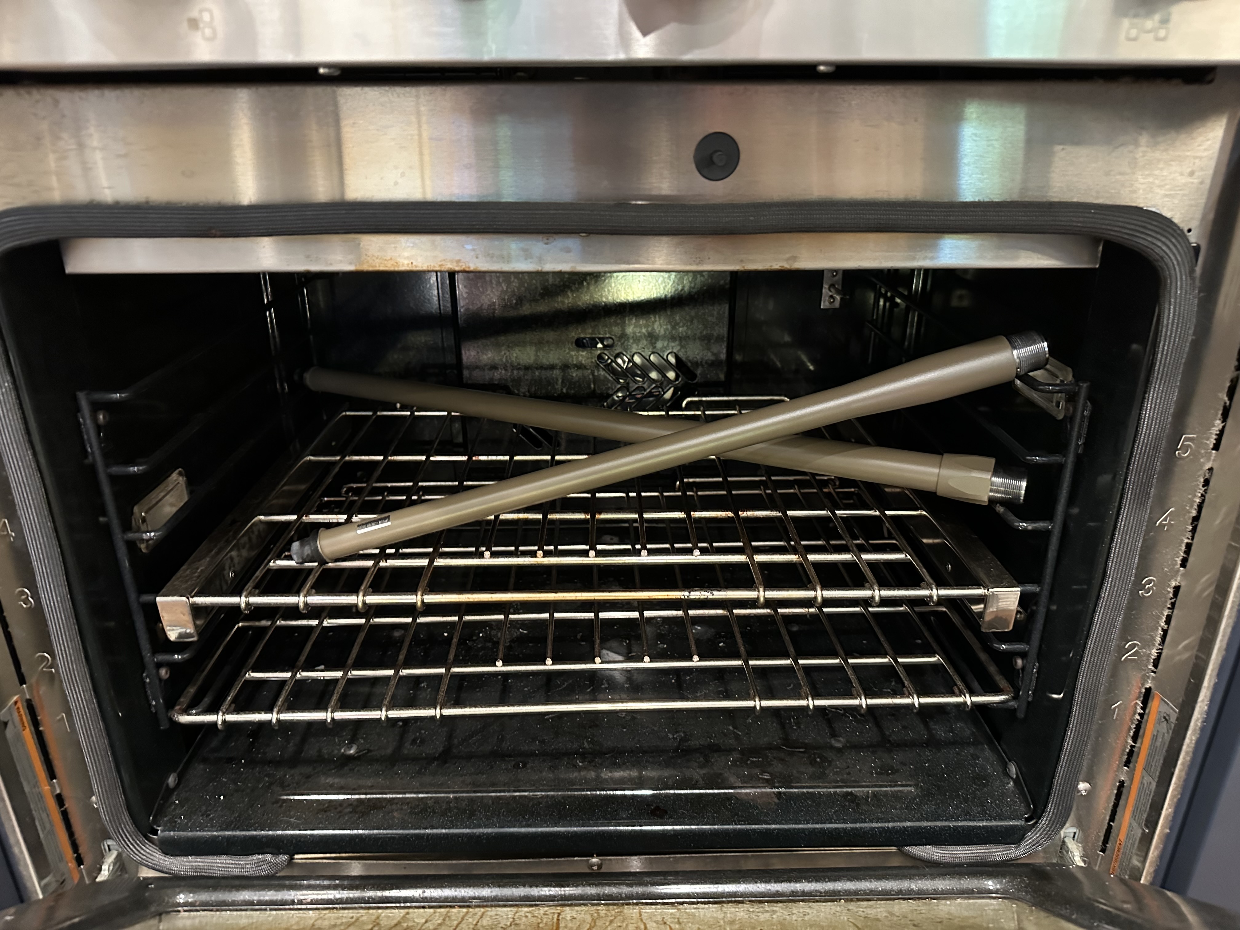

I used that color on two barrels, both from PVA. It turned out great. I baked them in the oven at 200 degrees to cure for the recommended time; no fumes……..wife had no idea when she came home 😂. Brownells was out of other colors I needed, so I rattle canned Rustoleum on top.
I'd planned to heat gun the barrel daily for a week and then let sit a couple/few weeks, but if there is no smell the oven cure...Bro, I'm all in for that! Seriously, no smell? I suppose the oven must be clean with no food stains?
Seriously, no odor. I think it’s because it’s a coating that either doesn’t have VOC’s or doesn’t have much; that’s why it takes heat or a long time to cure. Literally did it in the morning, baked it for 2-3 hours, and no odor.

If hanging, make a knot with a tail, run through the barrel, loop and hang. Receivers, roll up heavy paper, tightly coiled, insert into receiver and let it uncoil.Cut it to length in order to get the tang, etc. For barrels short enough to fit into the oven, cut a wooden block for balance, post a rod into that and insert into barrel ends, allows you to hang for painting but transfer to the blocks. If you have a week, this time of year it is plenty hot in the attic or make a small box or piece of flu pipe, etc. to act as an oven in the sun. If painting anything with joints, clean, degrease, heat, degrease and wipe down with 90% alcohol or acetone as lubes will weep from them. Remember, certain rubber, plastics, etc that may need to flex do not play well with AH II.

If doing mags, unless you already have the AH II, just use Rustoleum.

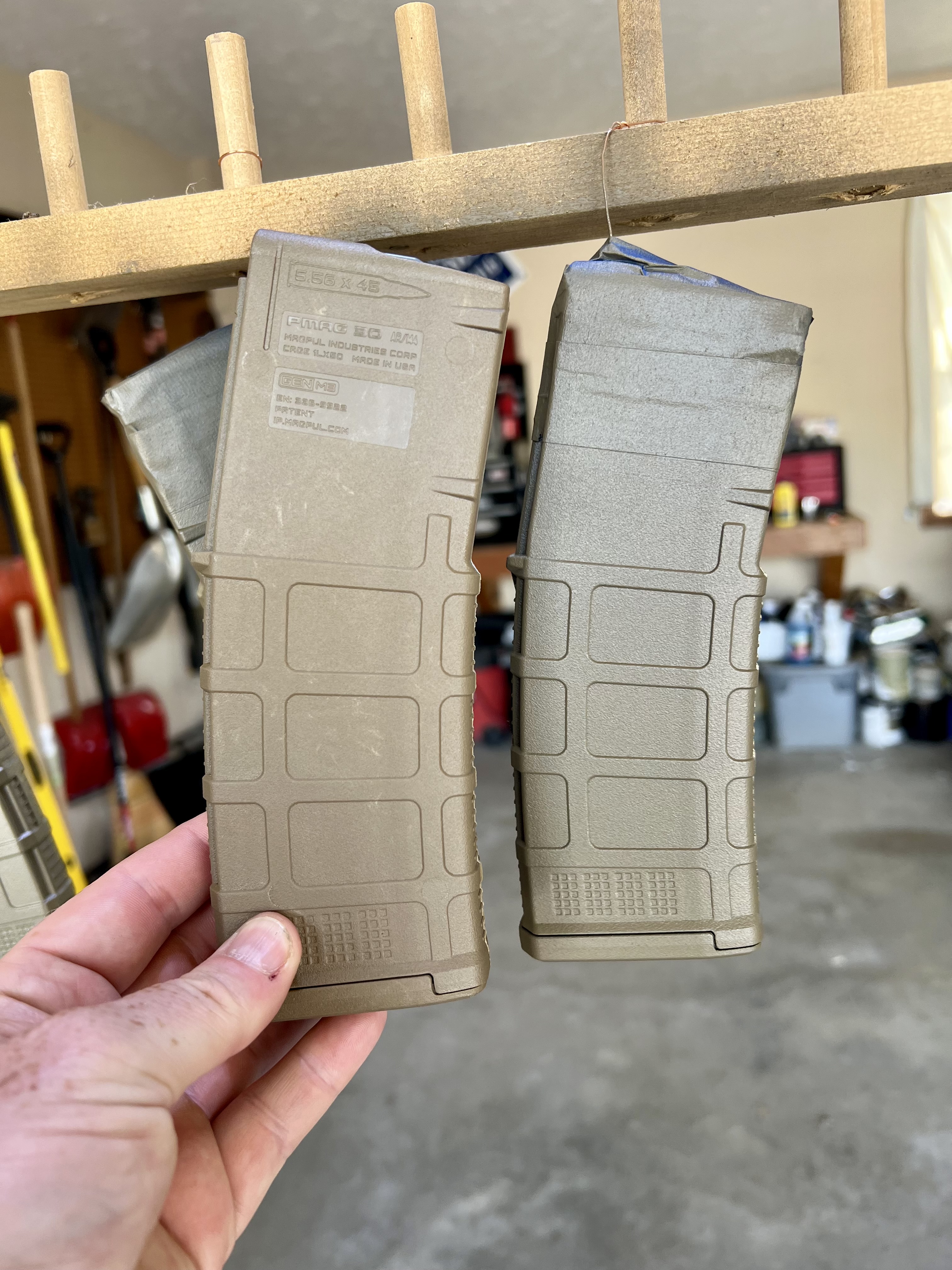

Some more observations:
One can did:
2 barrels
Magpul D60
6 Pmags
16.5” rail/handguard
2 coats is all that’s needed on anything. 3 coats just gets shiny and starts looking like thick spray paint. So fuck that third coat.

- shake a new can 10 mins. Seemed to need less shaking as the can got used.
- Always turn can upside down and clear the tube/nozzle after each coat.
- Definitely start spraying off object and end spray off object. Lessons spatter/specs
- Heat gun sessions bringing the temp up to 125-140F. Gets all the smell out. Used kitchen oven for multiple bakes of parts and no smell. There was a noticeable smell in the garage when heat gunning.
- 22 ga jewelry wire worked great for hanging parts.
- regular blue painting tape worked fine. No bleeds
