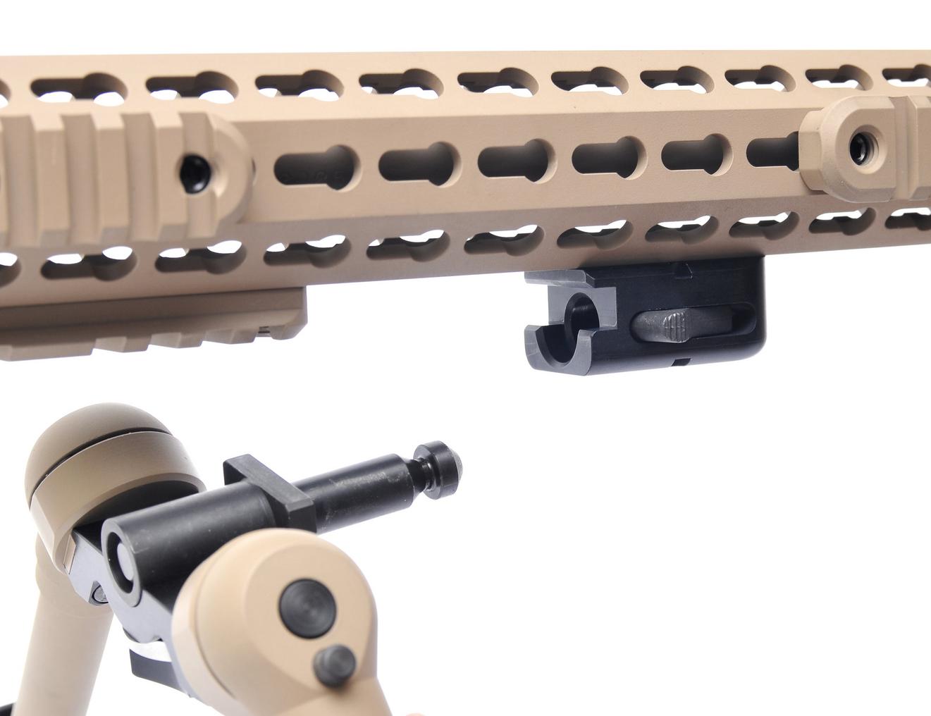

Attached pic of ax bipod , have one here and it seems good for the money. Fairly solid feature set.
