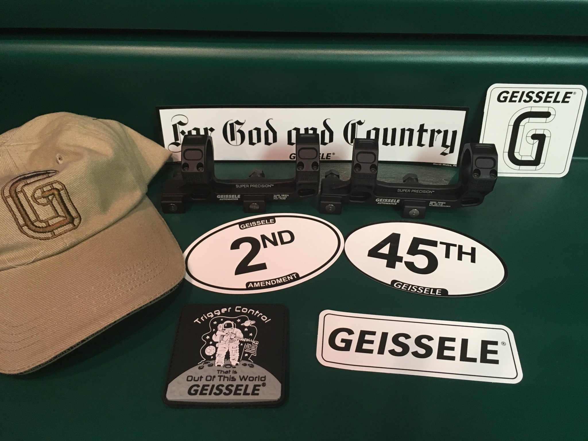

Well, I took advantage of GA Precision / Bushnell LRHSi deal, and then bought a Burris XTR 2-10 and needed mounts.
Someone mentioned the Geissele super precision mounts and they happen to be on sale ($260) from the factory over Labor Day weekends.
Compared to most, Geissele doles out the swag. Yeah, it's just free advertising, but what kid didn't want an STP sticker for their bike in the 60's. Even if we didn't know what it was.
