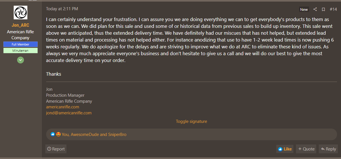

Huh this is all pretty confusing. I contacted ARC on Thursday about timeframe for a Archimedes to ship if i ordered today, was told 4-6 weeks. Now you guys are talking 3-4 months? Dang......I'm tempted to just buy a Falkor 7even now.
At least they communicated the longer wait time to you.😀
On four separate occasions. LOL
Oh shit, yeah I'm way off base, I'm ordering Monday, so hopefully it'll be no more than the quoted lead time. Thanks for clarifying!
Don't cancel!!
My first 2 delays were due to the stocks waiting on coating. This last delay is because they didn't account for the number of barrels (6mm Creedmoor) they needed. Wonder if anyone who ordered after November 29 has gotten a 6CREED barrel.
Doesn't seem to be as long a delay on the Arch or Nuk actions.

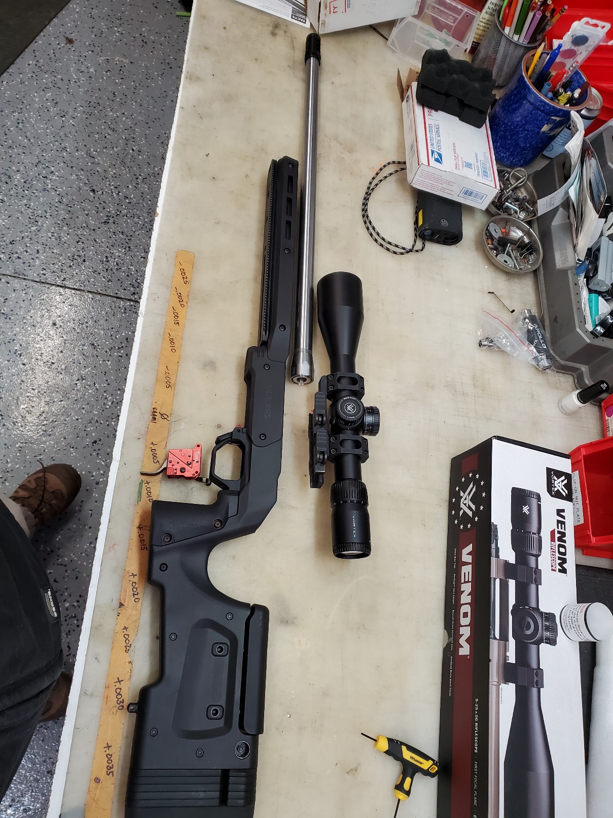

That's looking to be a nice build.
Thanks!
I'm really excited about the biuld.
There's only couple of things I may consider changing on the rifle. Maybe the trigger and swapping out the brake. But I really won't know until I get some time behind the trigger.
I'm already looking on placing an order for a 25 cal Brux barrel to chamber into a 25 Creedmoor. I wanted to have the rifle in hand to decide if I like the contour it came with, or order a different one for the 25 Creed.
