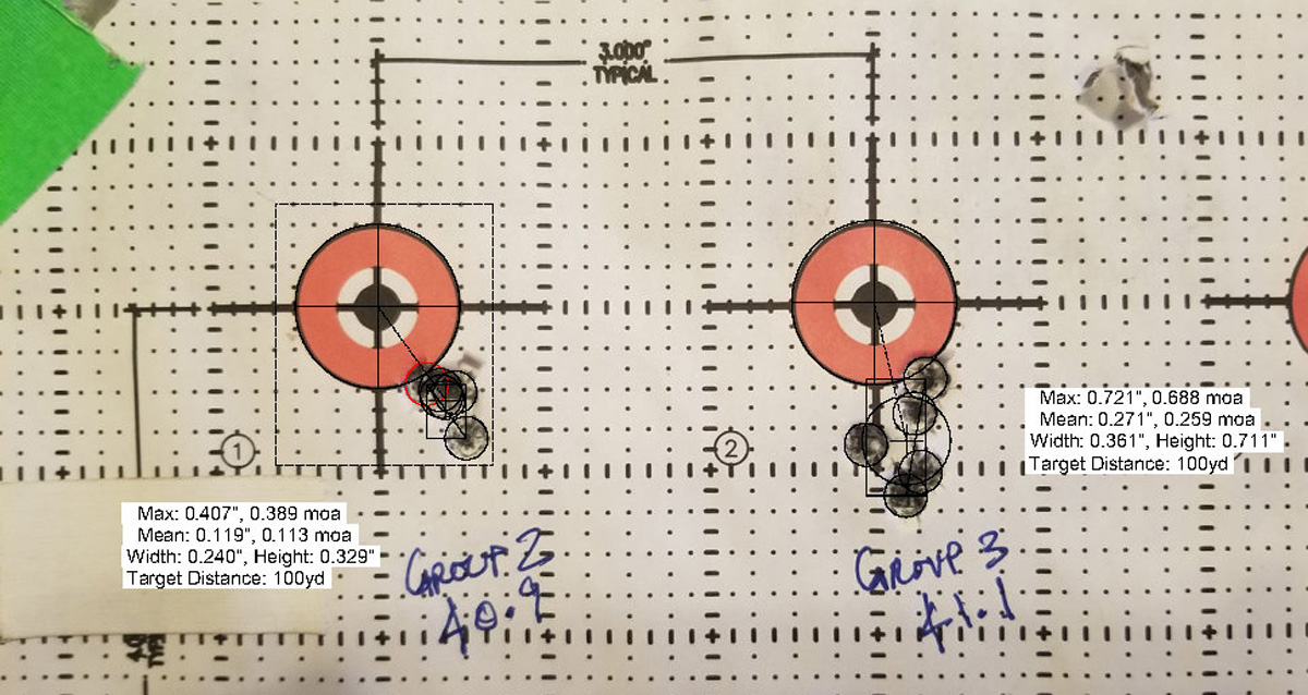

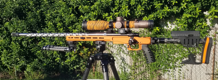

After 8 months, a new NRL Light Open Build is a reality. 11.3 lbs as it sits on the tripod. This was/is an experiment. Carbon Fiber vs Heavily Fluted barrel for weight. Only 20 rounds through it, but I think it's a keeper. If there's any interest, I'll post the details. 5 shots bore sighting / 5 shots group 1 = 0.76 MOA. 5 shots Groups 2 and 3 as shown. Jury still out on the Leupy scope. Reticle is a little too fine for my eyes. But we'll play around with it.
Tiger stripe vet tape on the scope decreases dispersion / increases accuracy and precision by 33.45%. Or so I'm told by very reliable sources. And yes, this is a bit of a vanity post.
I’ve been looking at steel barrels for the next barrel on my hunter rifle. What barrel contour, weight, and length is that barrel?
