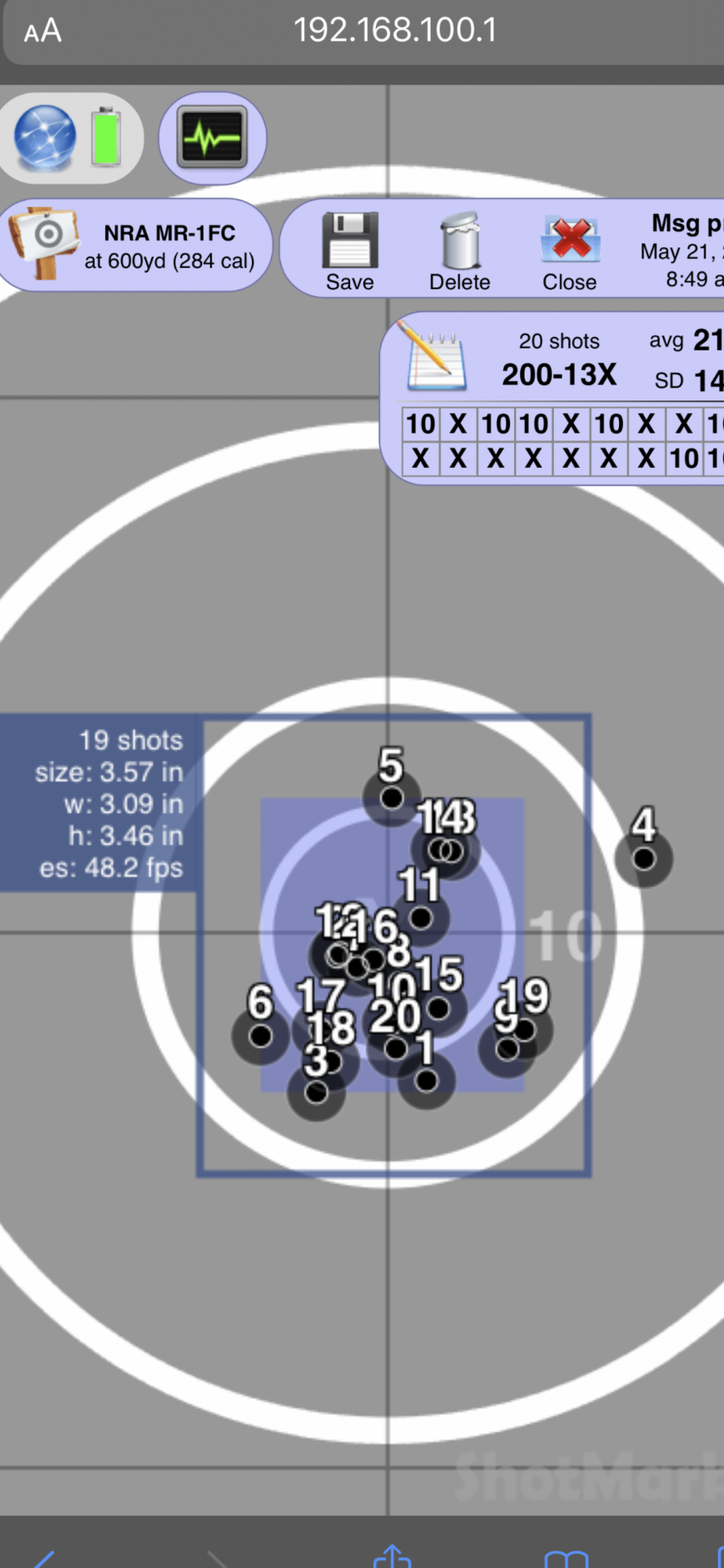

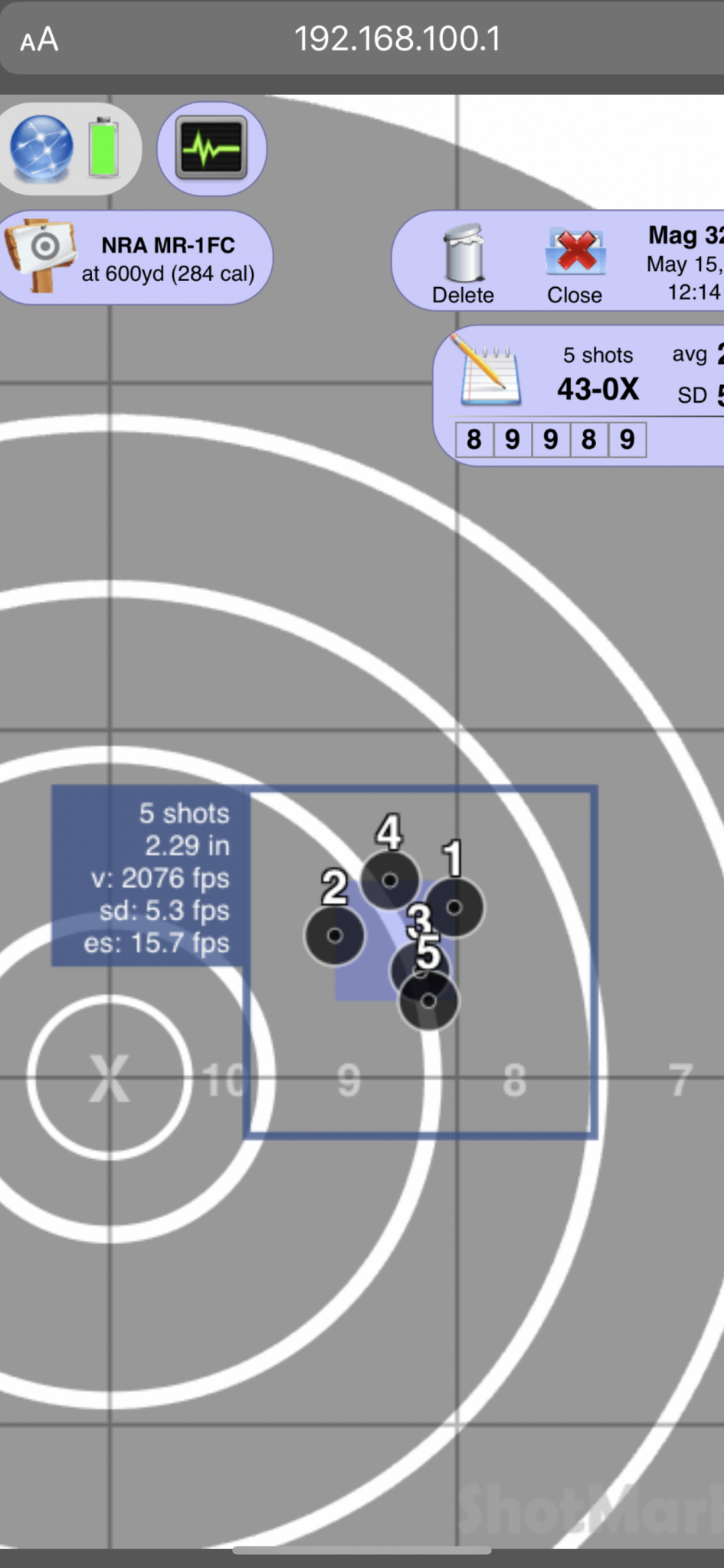

Ahh deflection. We aren’t talking about targets. We’re talking about reloads. And if you can’t understand how those graphs and numbers affect long range shooting I can’t help you. But even when I post targets you find ways to dismiss them.
That's all we need if he is just illustrating a lack of velocity change over firings without annealing.
I don’t know shit about shooting targets. Just reloading. Let’s see how you guys dismiss this

Because everyone is just telling people to anneal with no proof and no suggestion they know what they’re doing reloading. You didn’t need to see targets to know that I’m shooting a very high level but there Now you have them. don’t play defensive because they weren’t what you expected when you showed up to say prove it with targets.

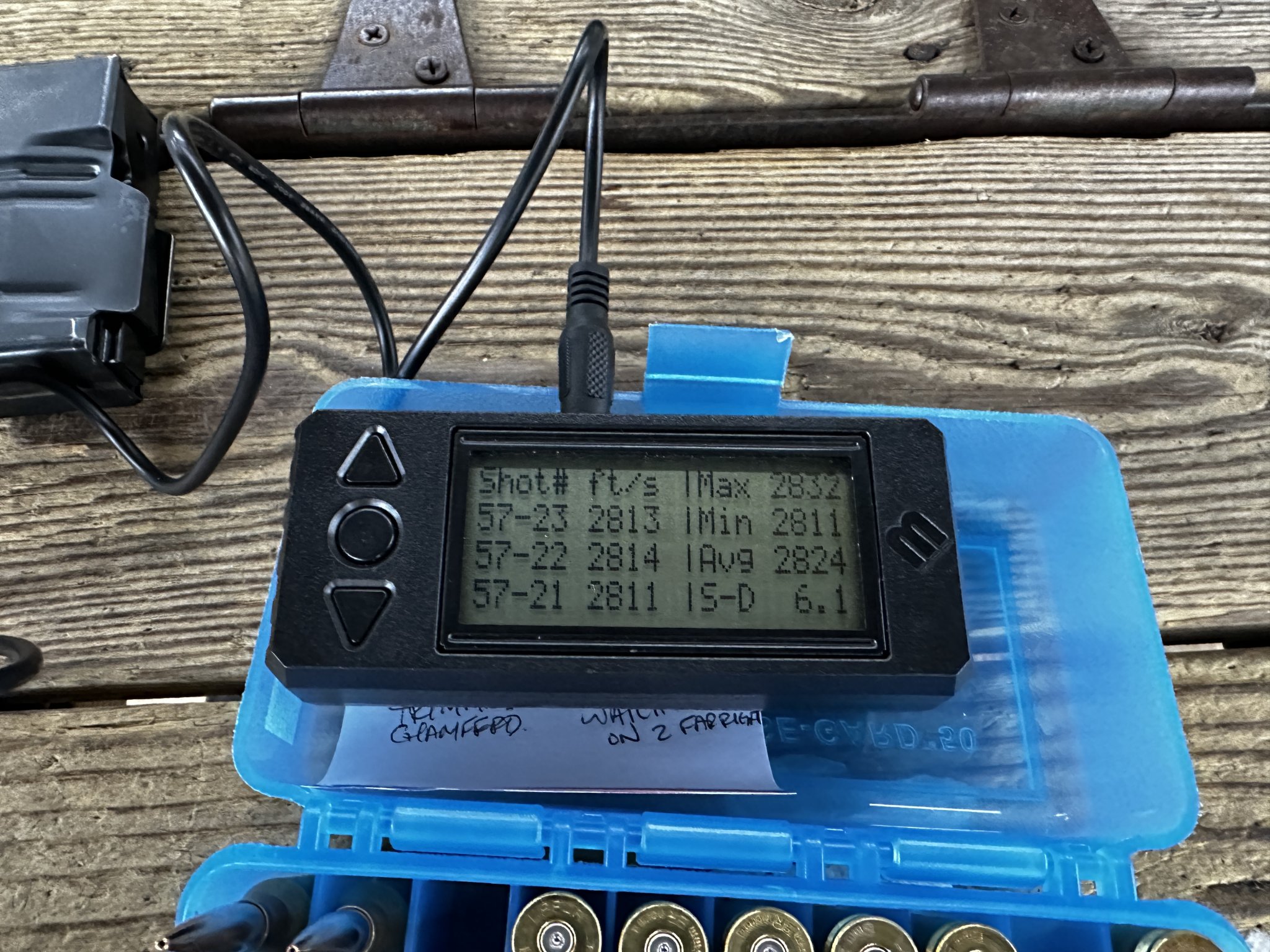

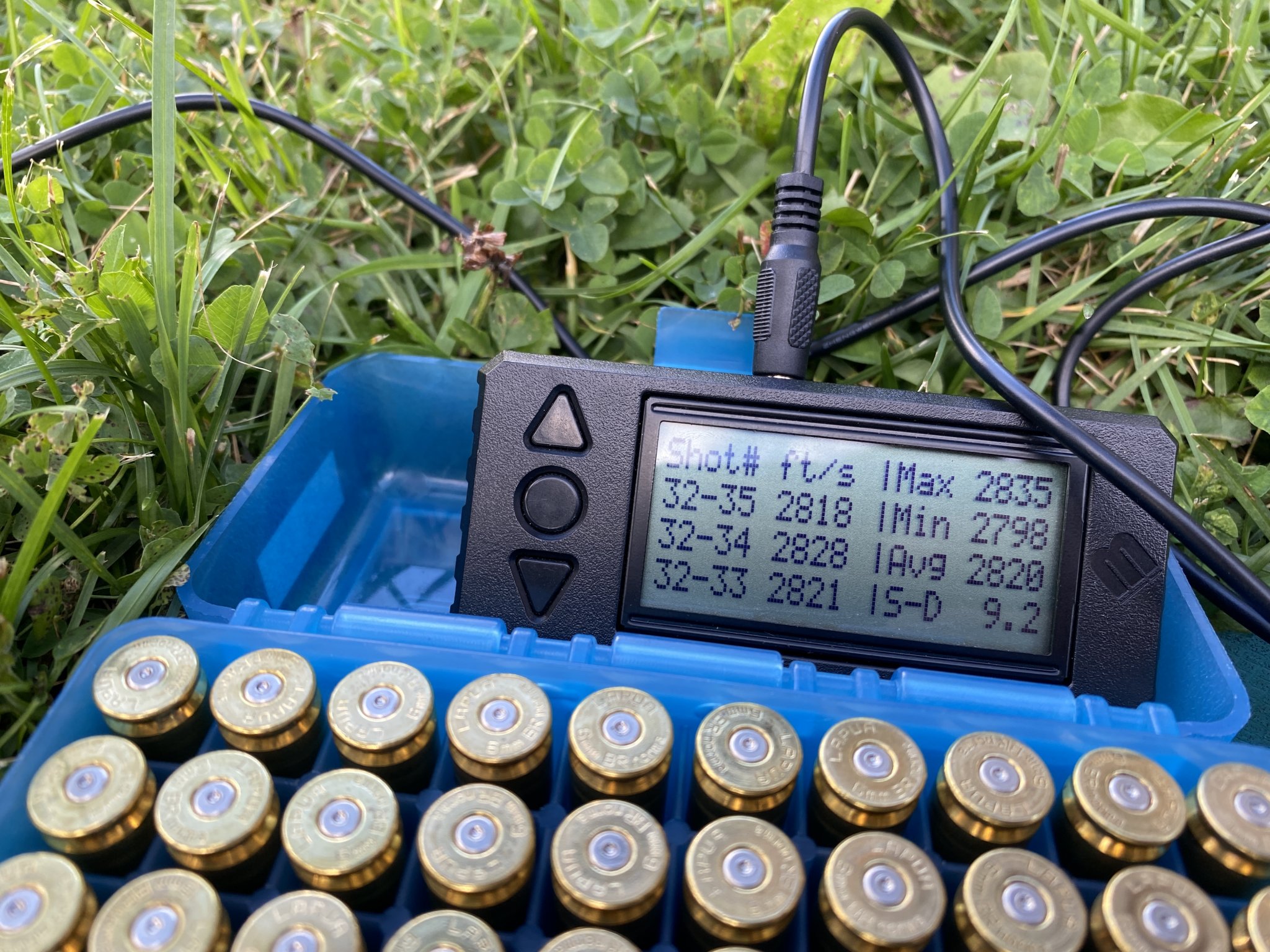

20 firing. Annealed every time. Average velocity is always the same. First shot on this barrel is historically and documented slow. It says in the data set anyway. 60 shots. An actual sample size. Go fuck yourself.
Reactions: FNG1001
Different day, different weather, same brass, same process.

Different day, different weather, different country, different year, same brass, same process, same average speed +/-4 fps.
