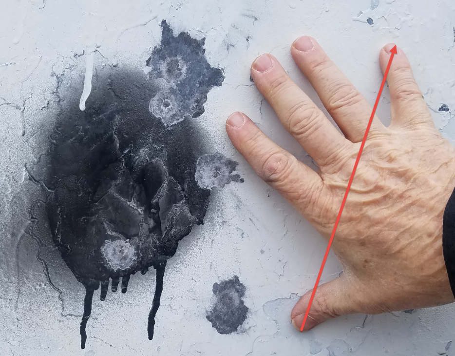

The target is one of the 36-inch plates at Youngs Longshot, range was 1,000 yards, it was shot two days ago. The red arrow is about 7.5 inches. That was an unusually good target for me at 1k; those hits will fit inside an A-zone. After shooting this group, I drove out to the target and took the picture then drove back and, less carefully, put 5 more rounds on this target. The 10 hits could be covered with a dinner plate - still good by my standards with a 308.
I was shooting a 308 off a bipod and a bench inside a building with a space heater. I'm using LC LR brass, 175 SMK, and 4064. COL is 2.820, rounds feed out of a magazine. Air temperature was about 32F, wind 1 to 2 mph from about 9 o'clock. The scope is set for a 100 yard zero. Muzzle velocity is about 2,620 fps. I dialed 12 mils up and 0.5 mils left then held between 0 and 0.2 mils left depending on mirage. I was shooting moderately fast - trying to stay in the condition. I think that my less than perfect hold and the fact that the bullets were subsonic accounted for some of the vertical you can see. That particular rifle has about 1,500 rounds through the barrel.
I anneal after every firing. The brass used here was annealed at least 10 times, probably more. I use a flame annealer. I turn out the lights then adjust flame and time until the brass comes out of the flame with a glow that disappears within about 1 second. Then I turn on the lights and anneal the batch. I don't adjust the flame or time during an annealing session. I don't know the temperature and I have no hardness measurements. I anneal for two reasons - subjective consistent seating pressure and vertical on targets. Since I started to anneal, seating force is more uniform and vertical at 800 yards runs about 2-inches. I can't shoot groups like some of you guys and this is a bit of "blind squirrel finds acorn" but 10 rounds under 12 inches at 1,000 yards with a 308 is acceptable to me.
Heating the brass until it glows does not damage the brass. If it did, this brass would not shoot this consistently after many annealings. After annealing, I cannot pinch the mouth of the case - they are oxidized but not soft. I expand necks before seating. Subjective seating force is mostly good.
